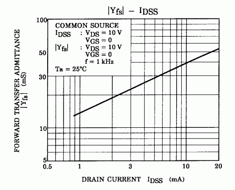

.... I just use the SK170 and I like to try a substitute with higher Gfs.
This is the graph from 2sk170's datasheet. It shows a correlation between Idss and transconductance. Look at it carefully and be aware that 2sk170 comes in three Idss groups (GR, BL and V), ranging from 2.6mA to 20mA...
They price it 11.5 CHF (11.4 US$) a piece??? 🙄
Same Yfs as BF862 but 7.5 times higher Ciss and 5 times higher Crss with 40 times higher price - not a good deal at all... 😉
