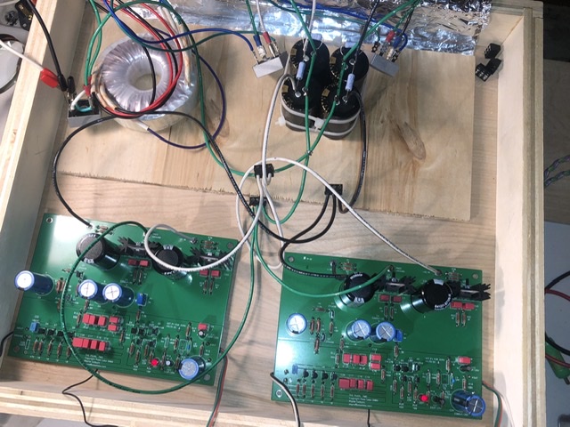

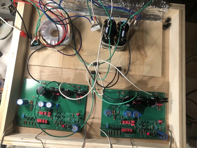

Strange voltage at P1 zero volt test point. Please help!
Hello there,
Thank you in advance for your expertise.

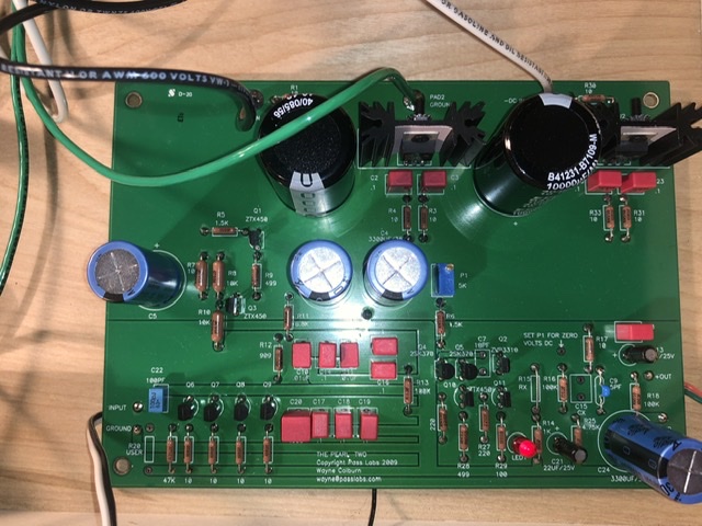

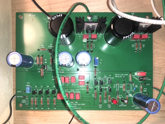

I have been studying this Pearl 2 phono stage project for quite a while, looked at almost all of you guys’ discussions, detailed instructions, and beautiful pictures. Finally, I plunged myself into this diy project and encountered very strange (probably serious?) problem. I followed Jim’s advice and got Antec AS0522 transformer. Then, through 2 full wave bridge rectifiers, two banks of 2 x 10,000 uF caps (total of 40,000uF), 2 bleeder 22kOhms resisters, and two 0.47 ohm PI resistors, I got + 28.8 V and + 29.3 V unregulated and about the same voltages for regulated.
Then, when I checked the P1 test point (the pad that has “set P1 for 0 volts DC), I got negative (-) 23.4 volts (yes, volts and NOT mV). Turning the P1 trimmer dial did not change the above voltage at the P1 test point.
The same high voltage reading at P1 test point was also noted at the other PCB as well. Adjusting P1 trimmer on the second board didn’t not change the voltage at all. As far as the resistors and capacitors, I did check there values carefully prior to stuffing the boards. I didn’t check the transistors prior to assembly however.
My questions to you:
1. Did I install the P1 trimmer wrong? I did order a “similar Value” 5K Bourn trimmer with 3 pins in a straight line (instead of the one with the center pin offset a little bit). Both Mouser and Digi-Key didn’t have the trimmer with central offset pin at that time. Moreover, I thought these trimmers were interchangeable, just bend the center pin over a little bit to fit. Maybe I am wrong.
2. What else should I check to troubleshoot this problem?
3. Did I damage other components (i.e. the chip set) by having such high negative voltage at this point?
4. Were the regulated and unregulated DC voltages too low for the transistors to function properly? How can I increase these voltages?
Thanks a million. I will post some pictures of my boards and PSU.

Are SJ74 BL92 transistors interchangeable with SK370 transistors?
Hello Gents,
I saw a post on this forum dated a few years ago regarding the matched transistors shipped with the Pearl 2 boards from PassDiy website.
I got 2 sets of J74 BL92c (12 in total), which were installed and soldered into the 2 boards shown above.
Are J74 BL92 transistors interchangeable with SK370 transistors? Their datasheets show quite a big difference in polarity and voltages.
Could this be the source of my problem? Wild voltages at P1?
Quan
Yikes! They are most definitely not interchangeable. 🙁
It seems you were shipped the wrong jfets.
2sk170 can be used in place of 2sk370.
This is rather unfortunate. I expect the jfets you got are
very well matched (I know mine were) but, alas, the wrong
part.
Please contact passdiy and see if they can send some replacements.
In any case, I suggest you carefully desolder the 2sj74 and then
test them to see if they're still ok.
I hope you have this resolved soon.
