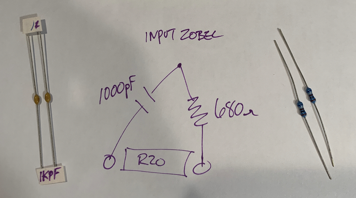

As it sounds like you have things pretty well buttoned up, it might be worth trying that Zobel mod on the input resistors. See photo for values and instruction (photo is from 6L6 - he’s the real master at troubleshooting this stuff!)

I took a look through that. I did not install the input cap or the R20 resister which looks like where one would install the input zobel.

I think R20 might be the optional input resistor spot. If that one’s empty, then your input resistor would be the 47k next to it.

So I added the zobel to the empty R20 (680 ohm and 1k pf) slot and my woofer pumping has stopped. Unfortunately it still hums audibly if the volume control is at a quarter or more. Listening levels are below that so it isn't bothersome while listening but I would love to get it a bit quieter if possible.
Also, anyone else who put the zobel in does the sound seem a bit thinner after? I hadn't listened much to the system with no zobel so I could have a poor sonic memory.

I noticed no change in sound with the Zobel, and I think Wayne adds it to their commercial phono preamps. You can always remove it as it only affects one cartridge that I know of (SAE1000).
