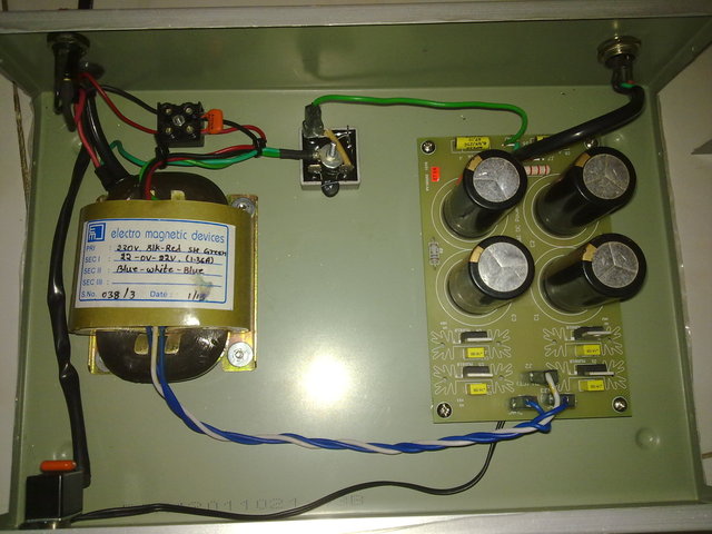

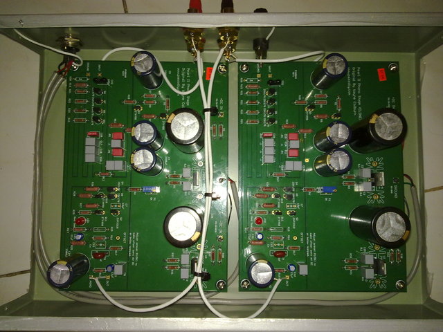

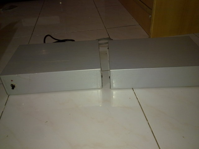

My build completed:
Pearl 2 boxed -
Dual unregulated 33V Power Supply -
Using 22-0-22, 30VA r-core CT transformer.
PS connected with umbilical 3 core shielded cord with chassis ground (mains earth ground) connected through shield of the cord. 3 cores carry +v, 0, and -ve of PS. PS Cord length is 3 Ft. Somehow I misplaced Ferrite bid to be placed on mains power cord.
Waiting for face plates.
Impression - Very silent, clean and rich. Gain is very much, output is near to CDP level.
Two things amazed me.
1. How there are lesser clicks and pops compared to another phono? This is simple class A, there is no filter apart from passive RIAA network. I think somehow other phono circuits make it to resonate and amplify where these are here to the actual quantity.
2. Subsonic roll-off. Some records used to move speaker cone with 1-2 time /sec. That was inaudible subsonic waves. I was forced to use damping brush of my Shure M97xe cart. Now they are reduced and I can play without damper brush of my MM phono cart.

Pearl 2 boxed -

Thanks! I read on this forum to exclude C7 - that's all. Only problem I faced was - settling 0 mv at output test pad where it was varying between +10 to -10mV within 30sec duration. Still worked fine. I kept it as is because though inputs were shorted still boxes were open for adjustment.Wonderful! Congratulations on a beautiful construction!

Thanks, R-core transformer is built by local exporter from Hyderabad India whose name is written there. That guy saved my money by avoiding label print cost too. It cost little under $10 USD each for batch of 10 pieces.@omishra a very nice build.
From where did you obtain the R core transformer?
Now waiting for wooden faceplates and some heatsink to regulators, they are more than warm.
Those rectifier diodes are MUR860.
+/- 10mV is very good. Mine sometimes runs away to + or - 60 to 80mV. Most of the time it is between +/- 20mV though. This is with the inputs open.
