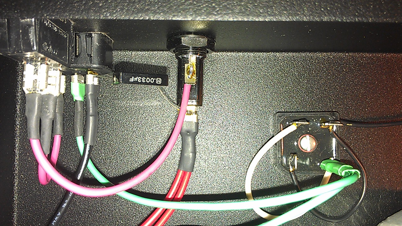

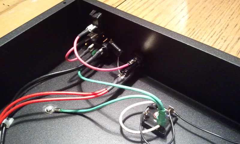

Hi folks,
I have what is probably a dumb question, most appropriate for budwiser, as it is his picture, but I am guessing many can answer it. The link is to a picture of budwiser's power supply, which I am trying to copy. This is my introduction to electronics projects.
http://www.diyaudio.com/forums/atta...d1329711222-pearl-two-2012-02-19-22.59.04.jpg
My question: in Wayne's schematic, he runs the hot line from the wall into the fuse, than to the transformer. It looks like in this photo the neutral is running to the fuse. I assume I am missing something obvious, but would appreciate it if someone would tell me what. I am a trial and error kind of guy, but not when it involves 120 volts. Thanks!

I think if you look closely the hot wire goes from IEC connector to a switch and then from the switch to the fuse holder and on to the transformers.

Yes, the hot comes out of the IEC plug, into a switch, thence to the fuse.
Always fuse the hot.
