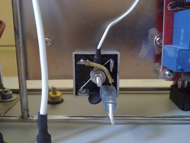

Look here -
Wire ending in the central bolt of 35A bridge block is coming from mains IEC socket. The wire with sleeve on connector is coming from PS ground. Just connect diagonal pins of bridge blocks together. Both the connecting wires are isolated from each other. One connection connects to chassis and IEC earth ground from mains together. Another connection goes to PS output Ground.
PS: in above diagram there is one 10Ω, 10A NTC (black part on the bridge block ) which could be safely omitted. But I kept it there to help bridge block (in case catastrophe).

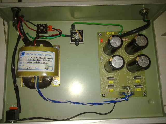

Another example from my build is here -
In two chassis construction isolation bridge or resistors, thermistors etc. are not necessary. Mains safety earth should be directly connected to power supply enclosure . Signal ground is connected to audio circuit chassis.
Purpose of isolation bridge or any isolation device is prevent hum induction in audio ground. Audio component with the highest signal level, like power amp or headphone amp should have direct connection between mains earth and audio ground. All others should have no connection, if it is dual chassis approach, or some form of isolation between signal and safety earth if use single enclosure.
Two or more directly earthed components will produce hum, while avoiding only one component with direct link between signal and mains safety earth will produce buzzing. Transformer should be of split bobbin construction or should have electrostatic screen tied to mains earth if toroid.
It was recommended by well known audio expert Ben Duncan a long time ago and is well proven in practice.I always have hum and buzz free reproduction using this method. Some factory made power amps have isolation between audio gnd. and safety earth. Remove it and make direct link. Same for the headphone amps.

I kept both the chassis - PS and Pearl 2, grounded to earth. Same time PS, DC ground was kept floating and connected to mains through isolator at only one place. DC ground never connected to chassis and same was supplied to tonearm ground.
Your approach is same as used in Pass two chassis preamps and phono preamps. Good, but could be simpler . In this case, DC connector case shouldI kept both the chassis - PS and Pearl 2, grounded to earth. Same time PS, DC ground was kept floating and connected to mains through isolator at only one place. DC ground never connected to chassis and same was supplied to tonearm ground.
be in good electrical contact with both chassis. I have never seen another preamp using that Pass Lab approach.
