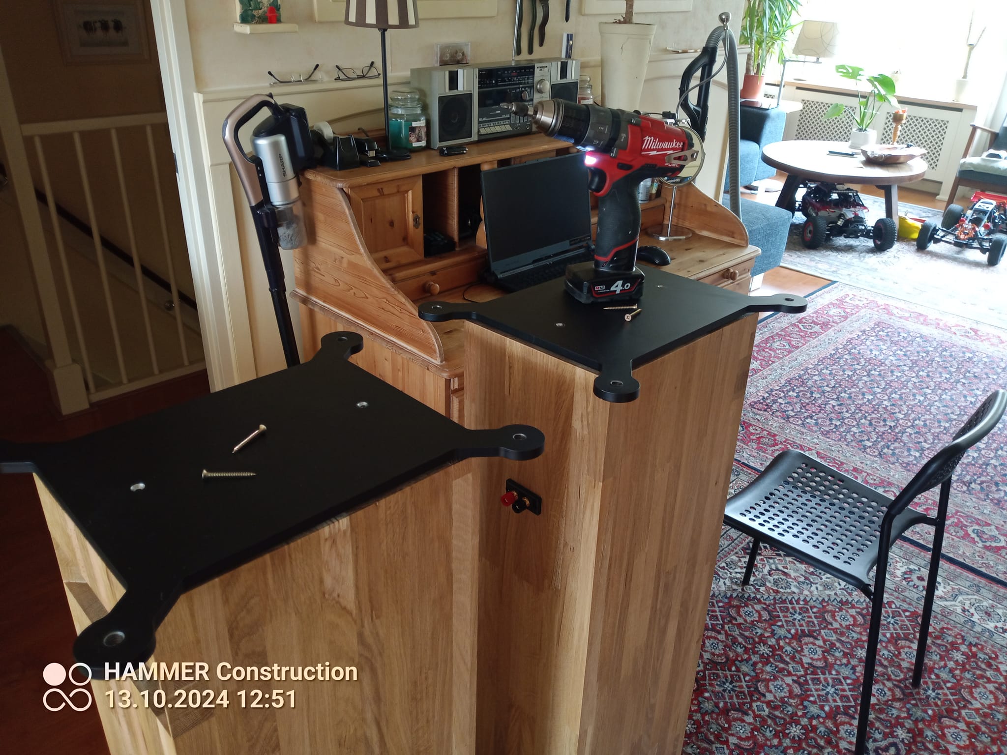

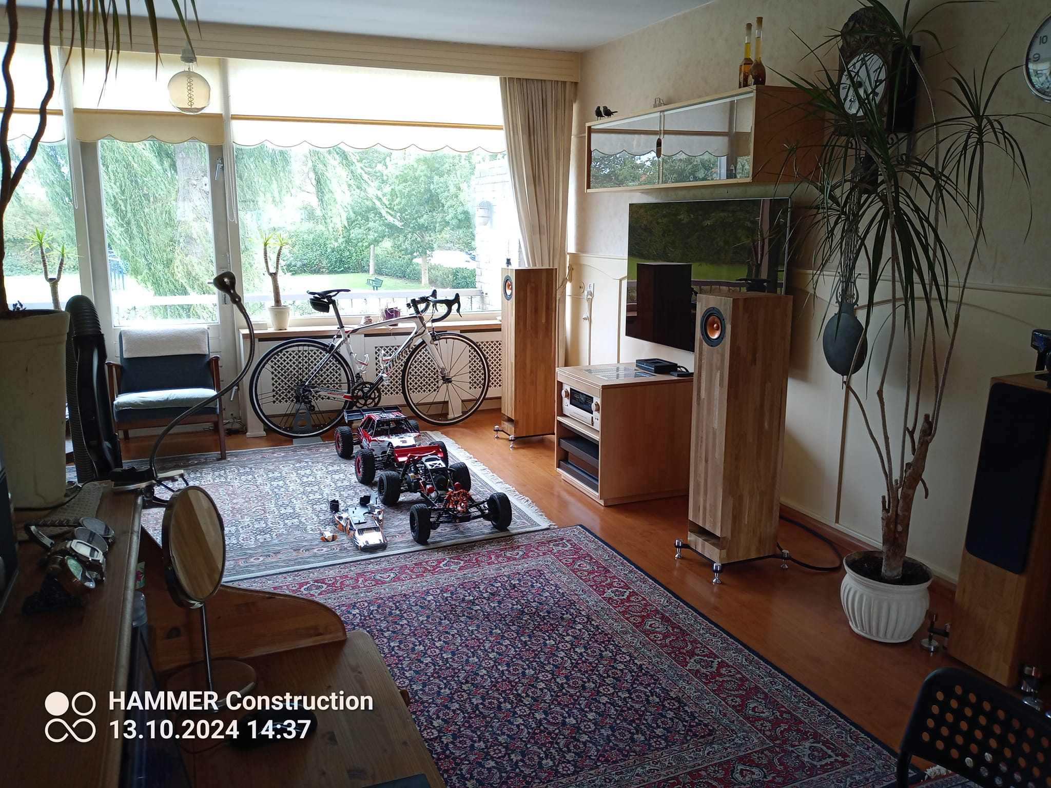

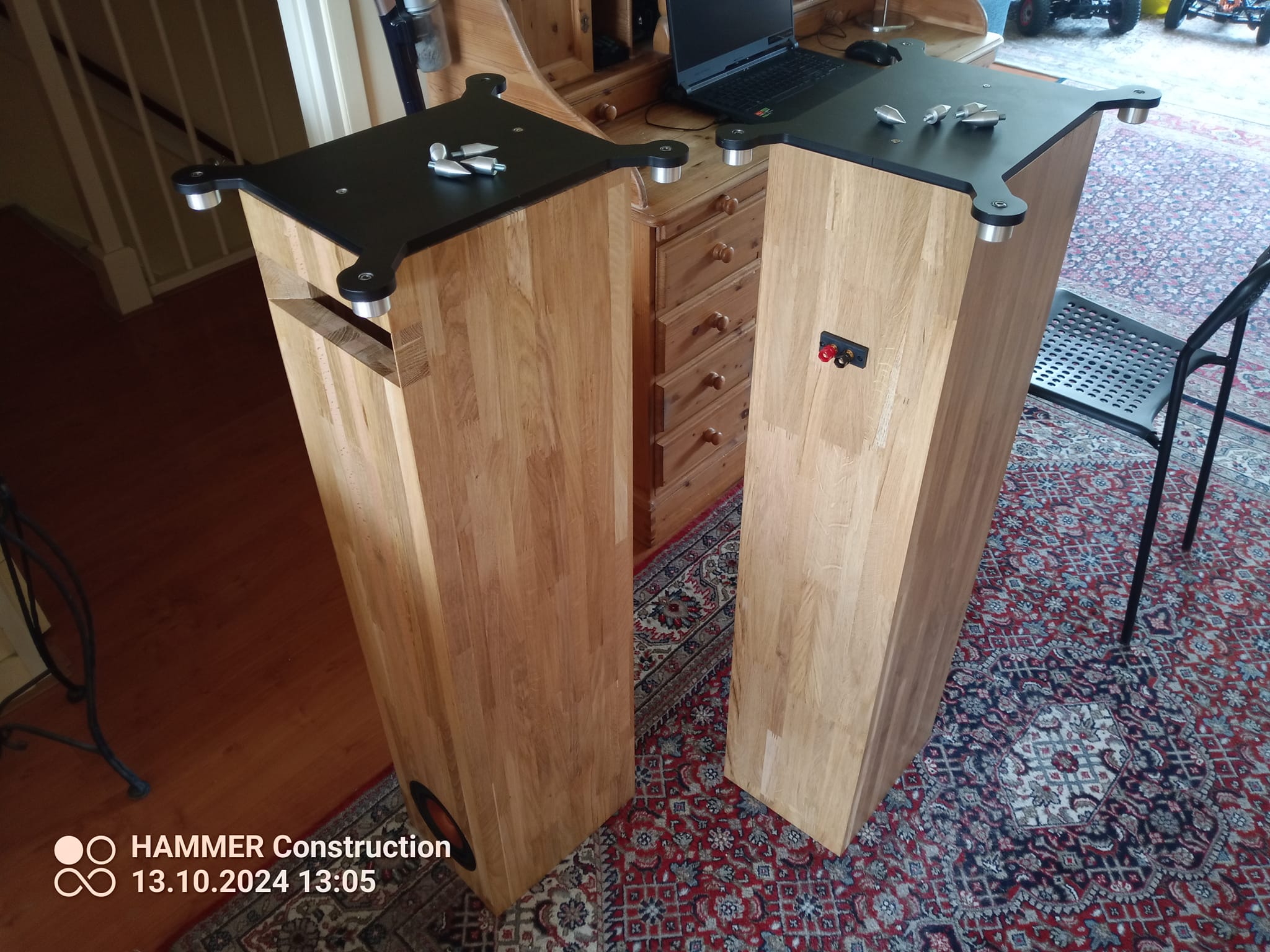

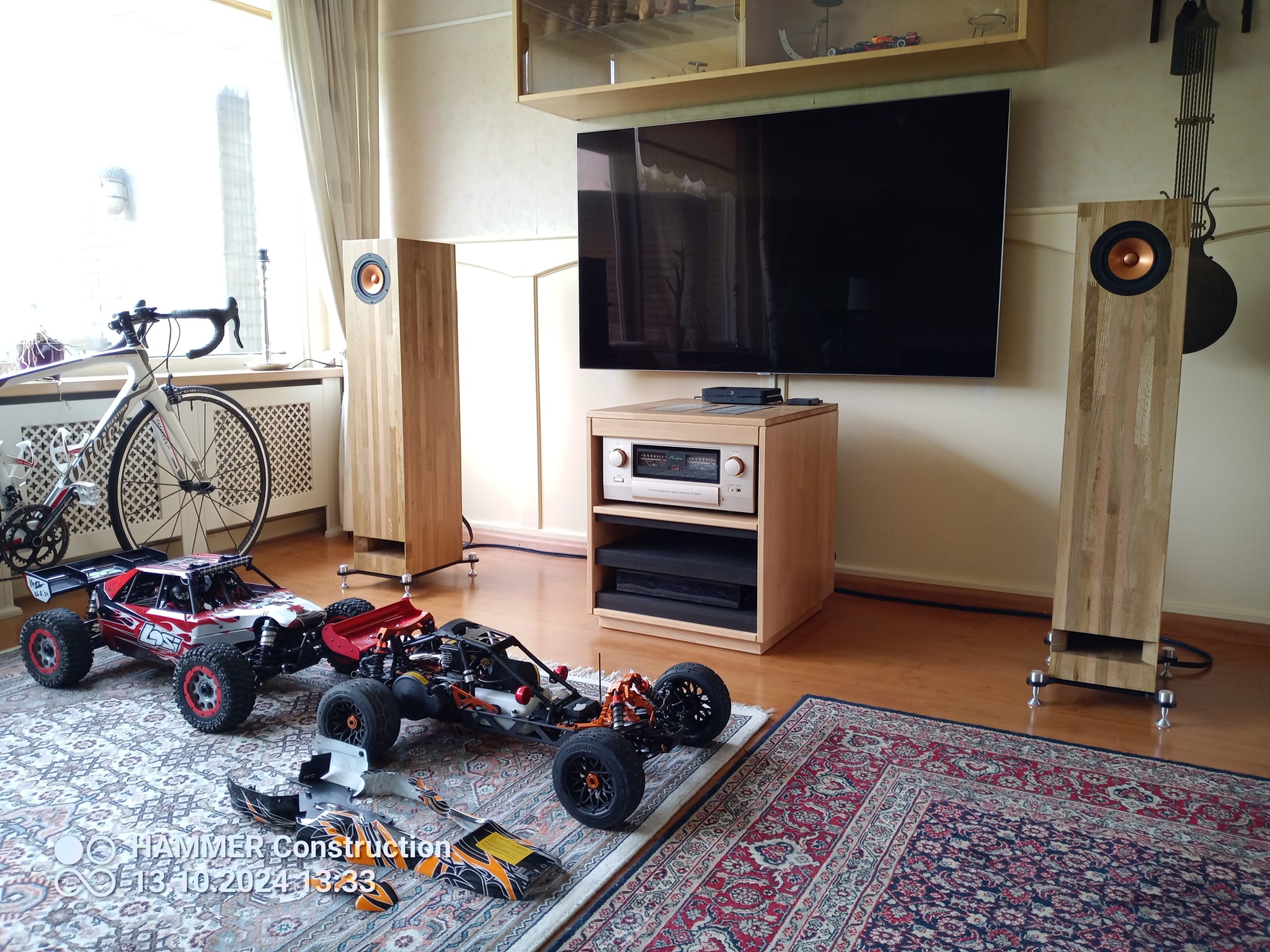

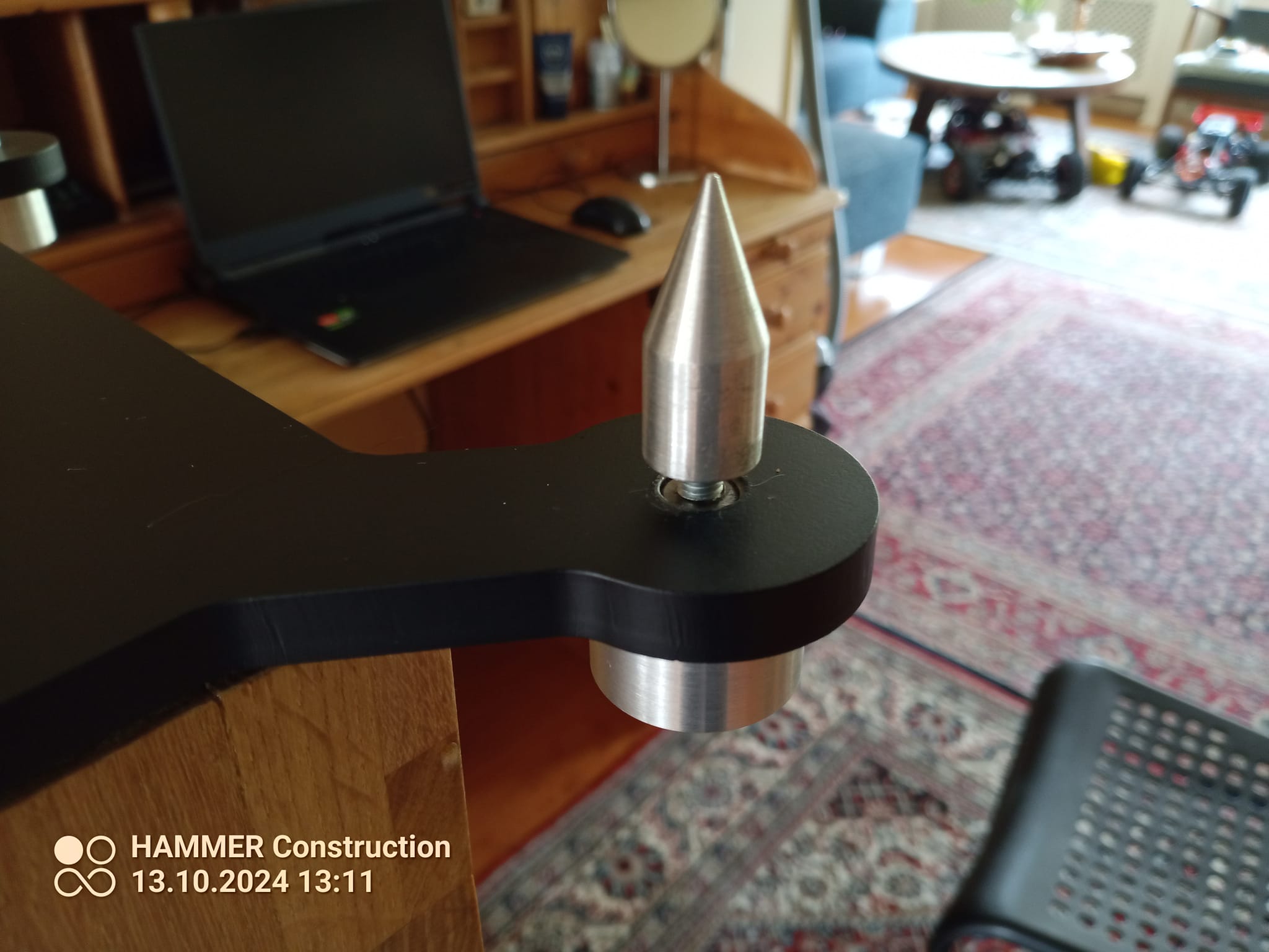

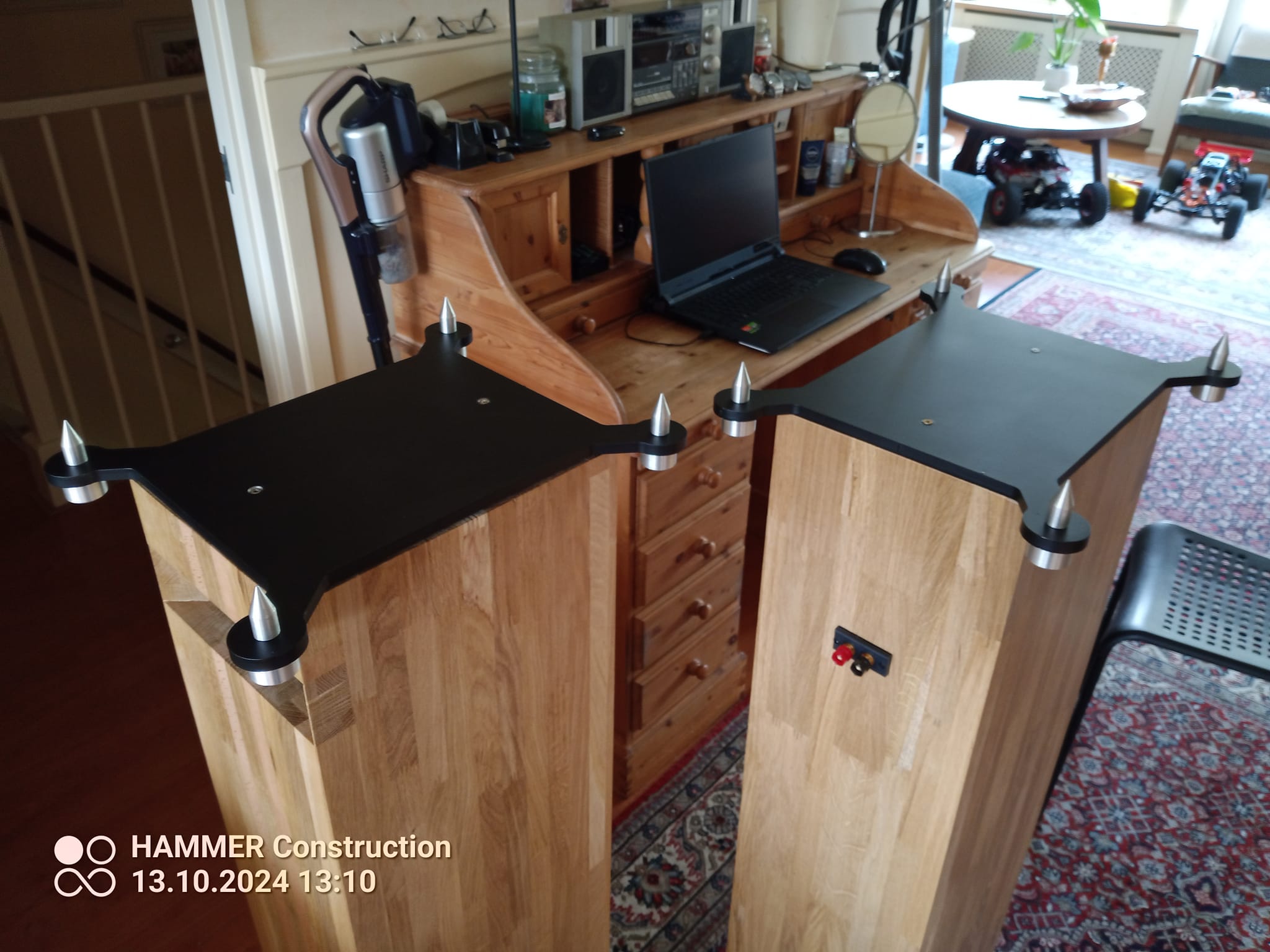

Pearl Acoustic Sibelius

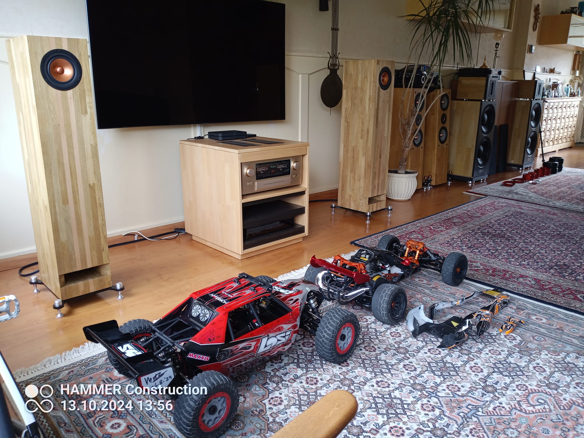

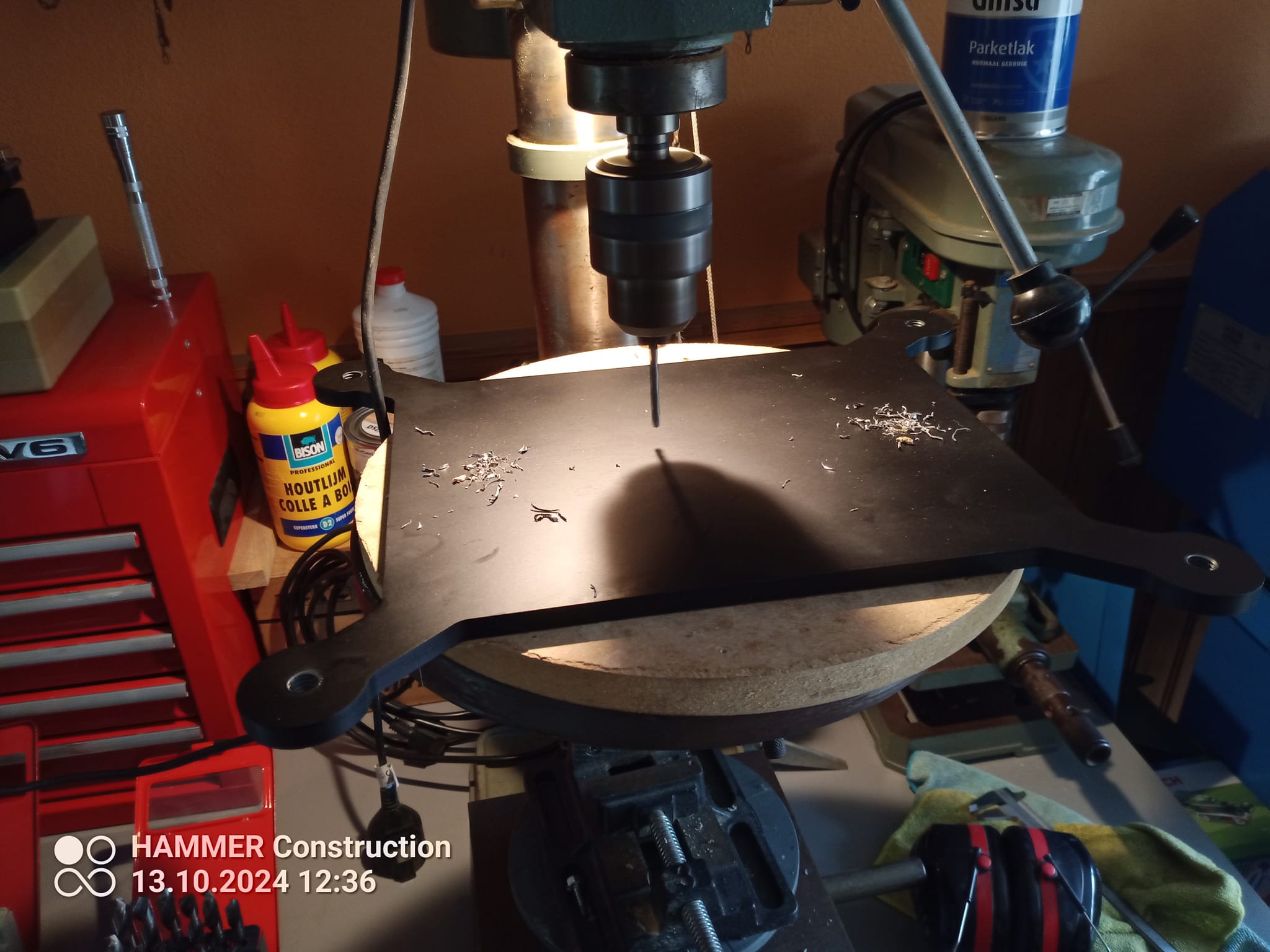

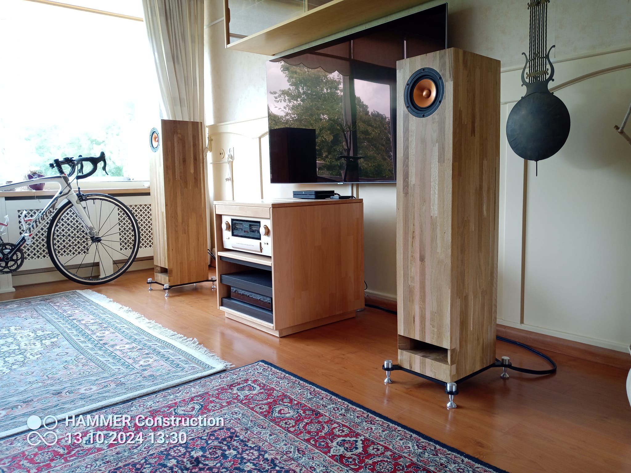

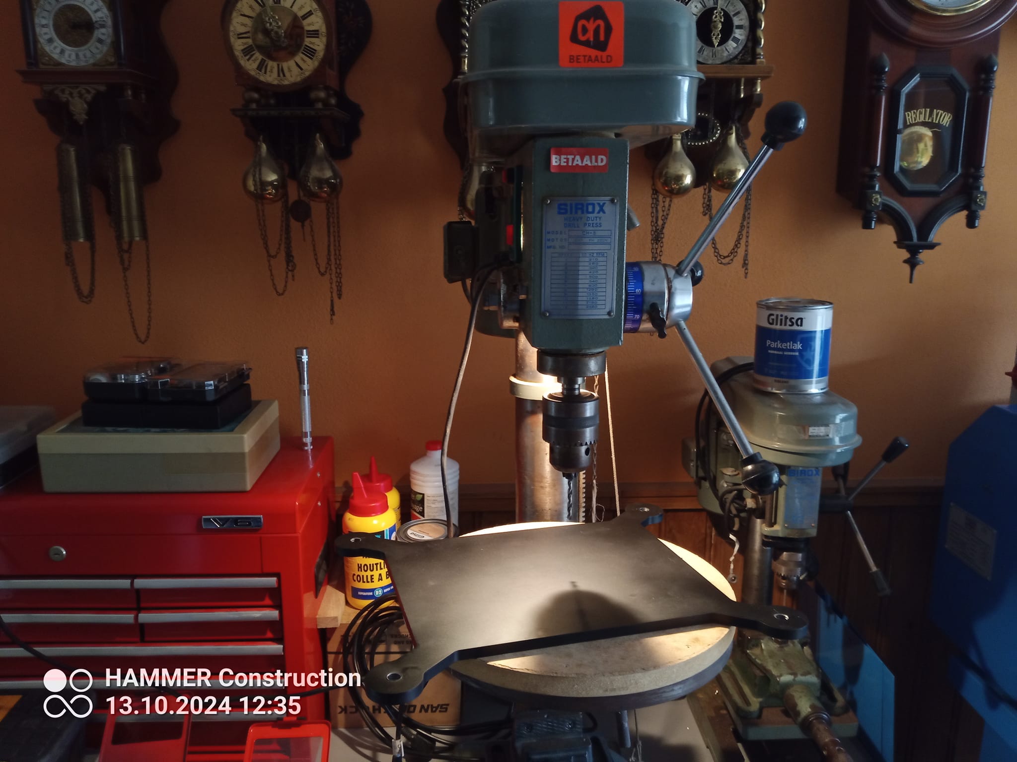

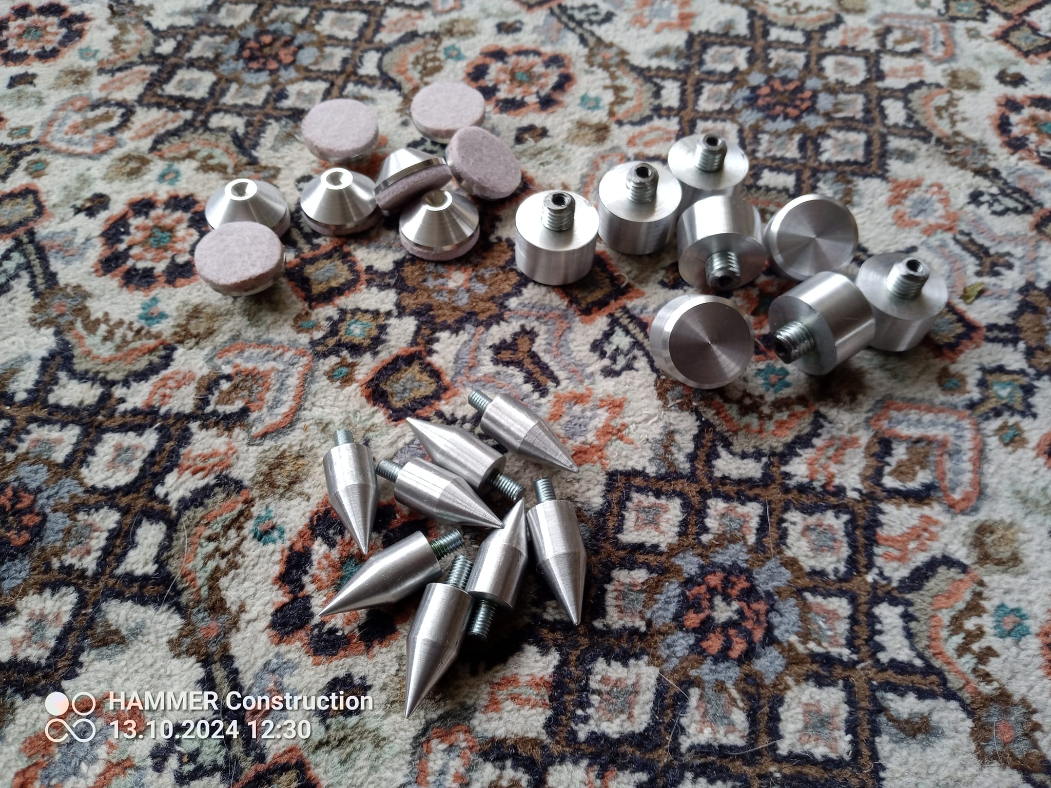

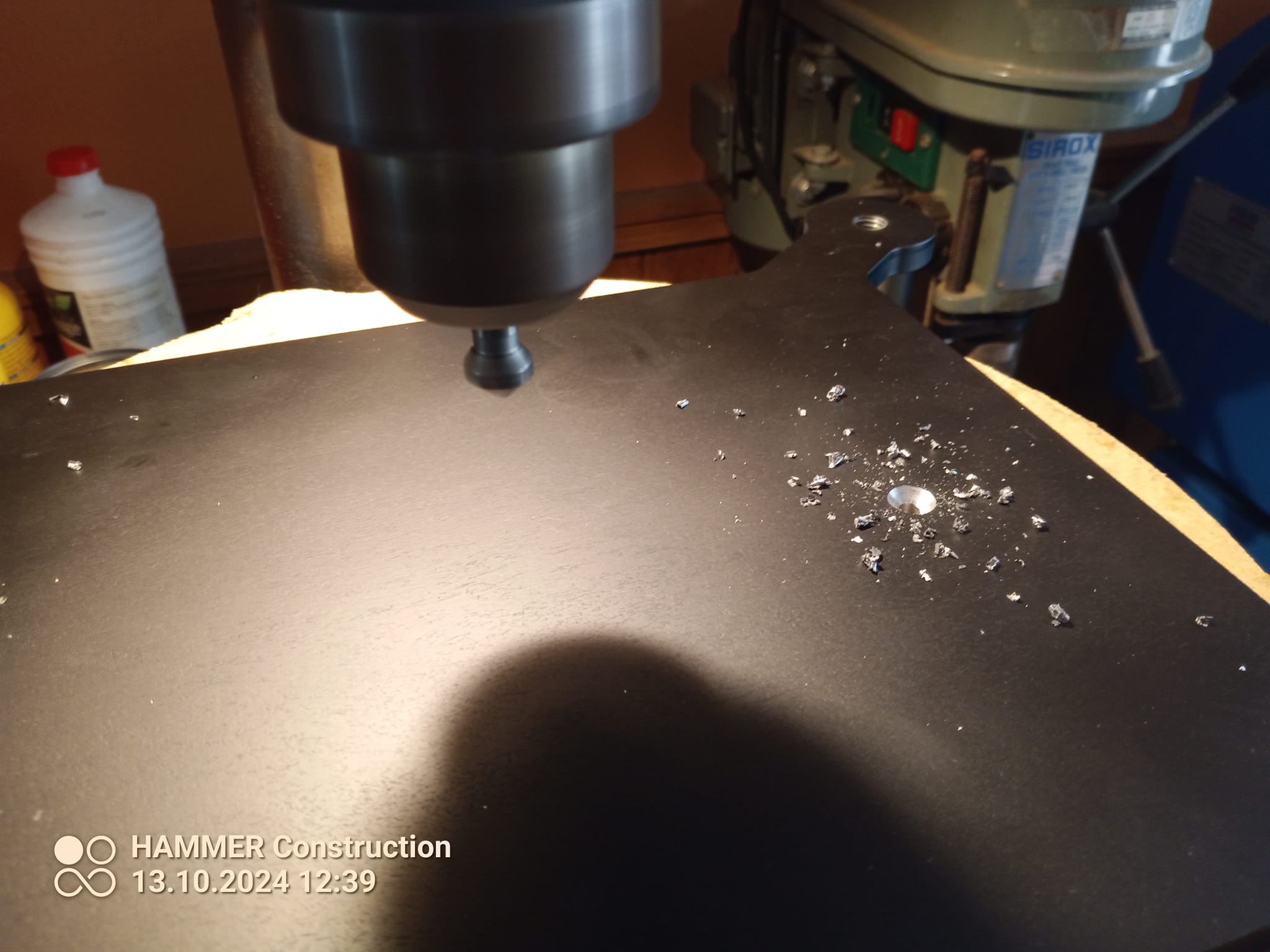

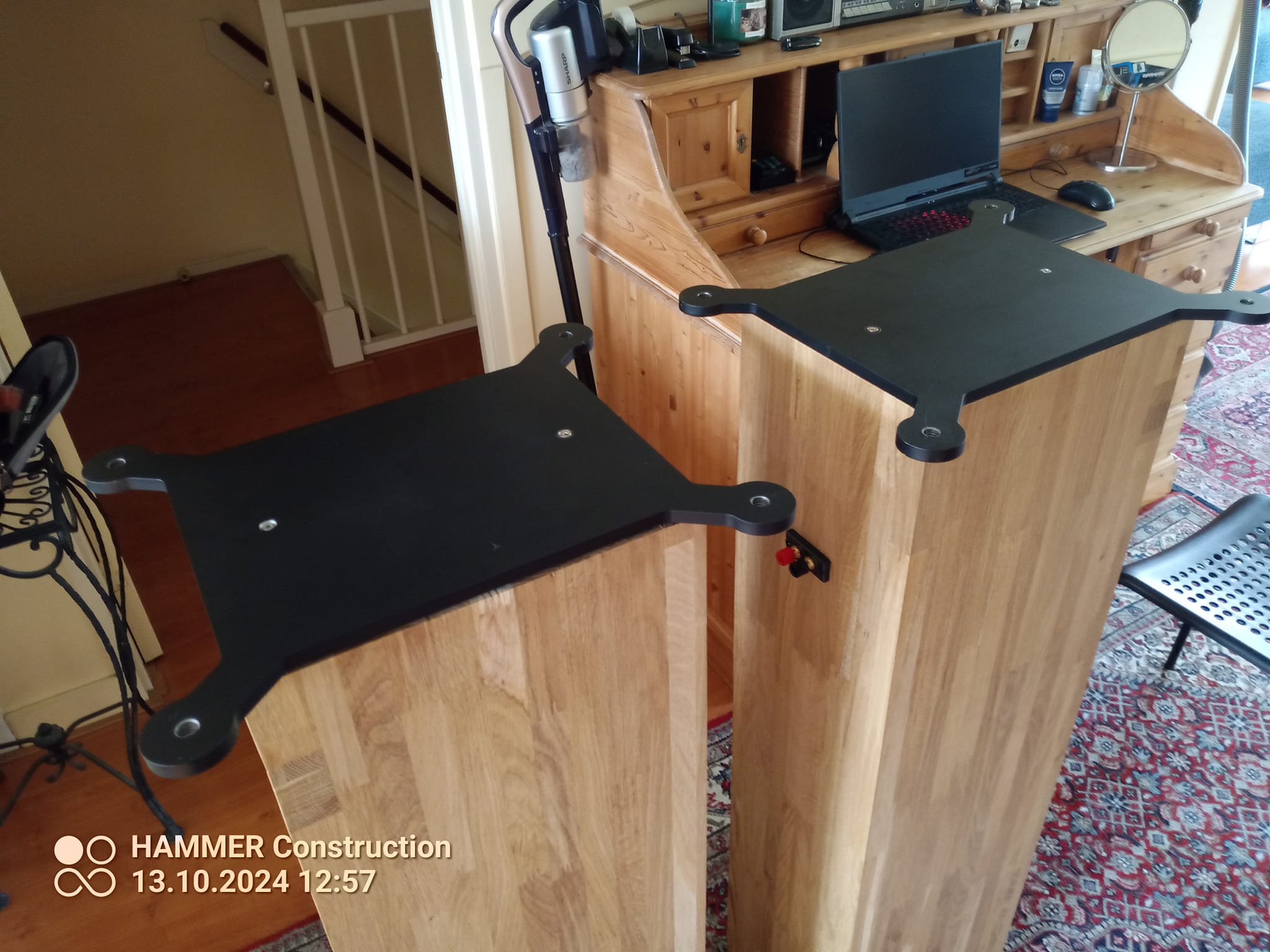

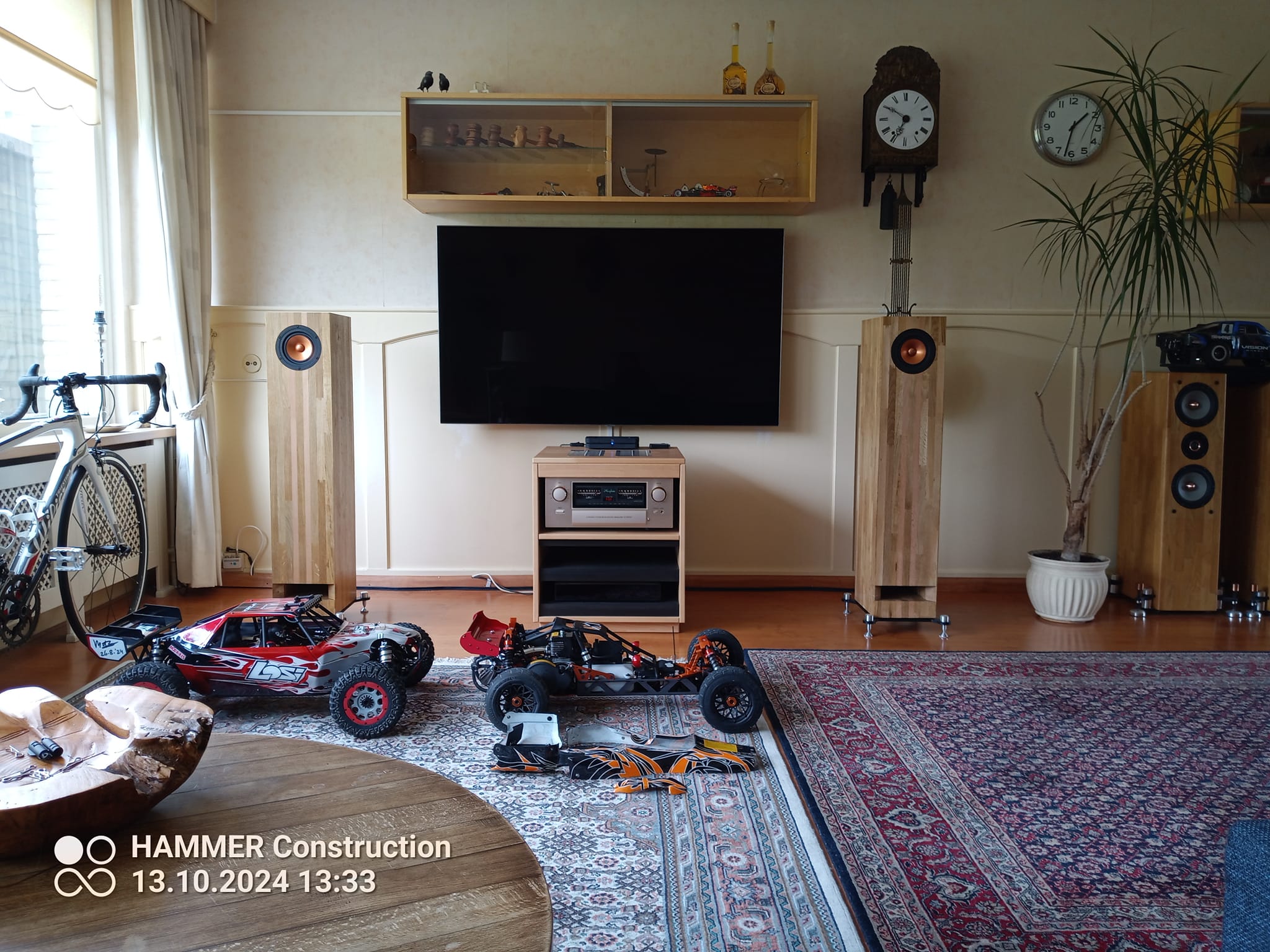

And the Sibelius clone is completely ready.
Performed with the 10.2 😃😉😋👌🏾.
Would like some power but there is no shortage of that here 🤣😋😋👌🏾.

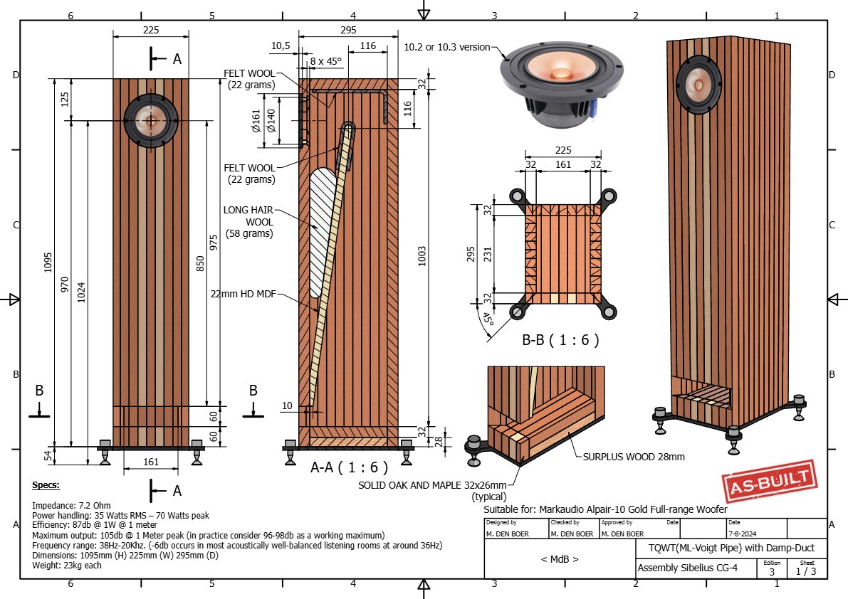

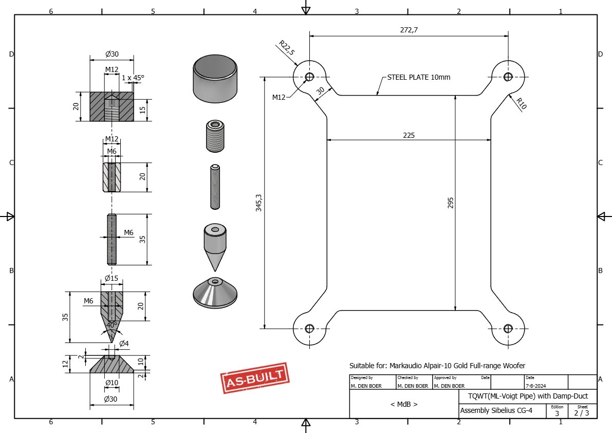

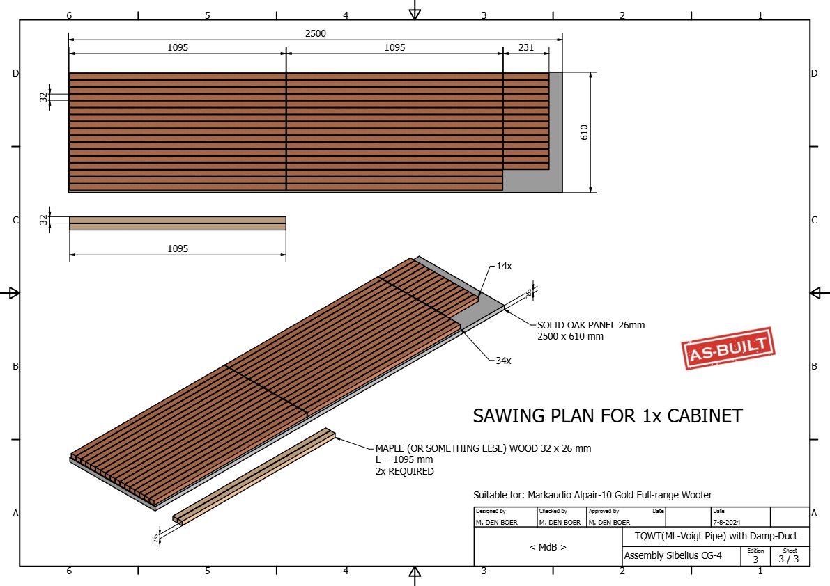

As a former participant in the A&E universe I applaud Hondasni's publication of "As-Built" drawings. Good on you. mate.
As-Builts record exactly what was built and accuracy -- and even precision -- is a hallmark (or should be!)

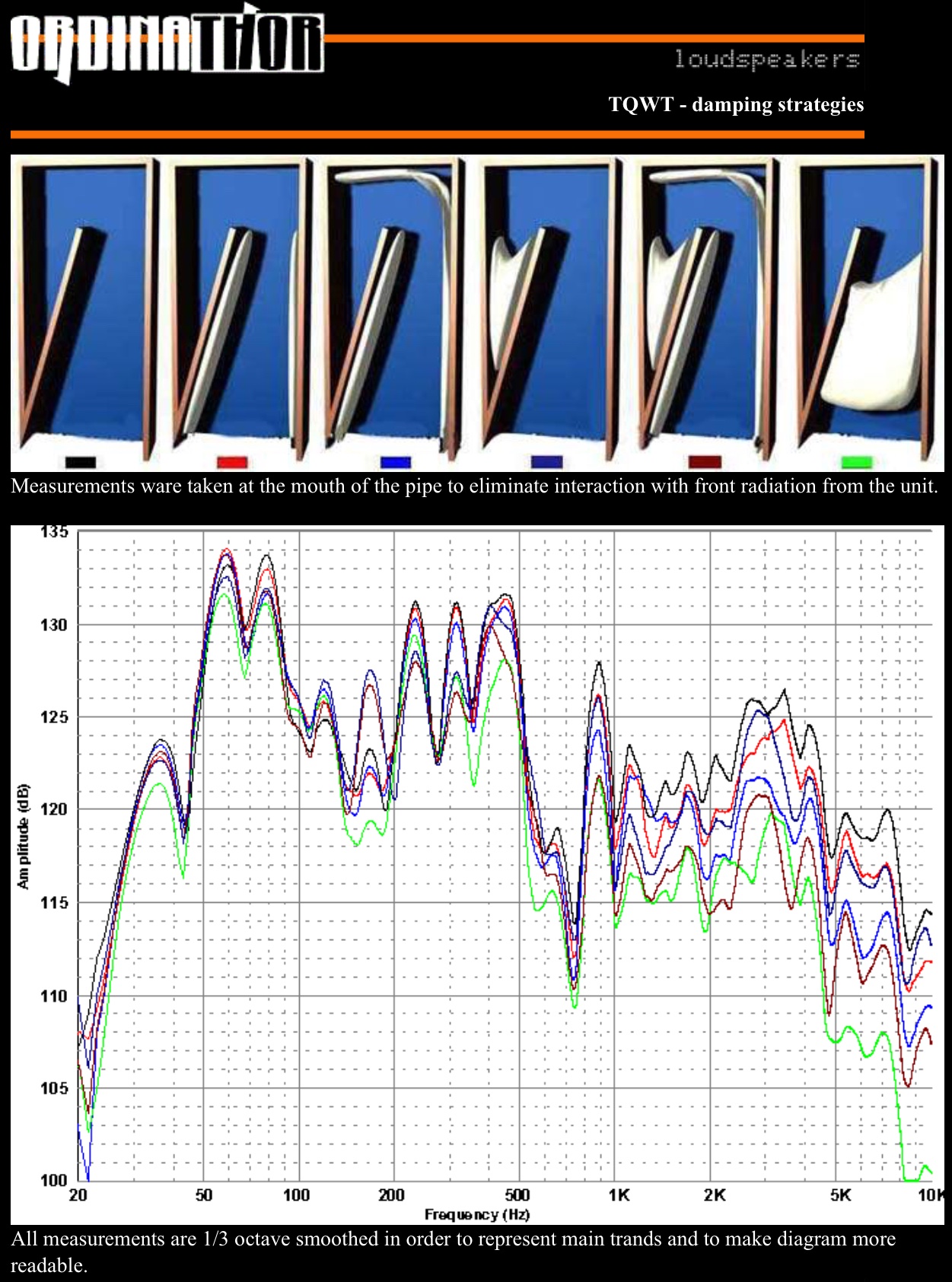

The question, qbas, should be how did he settle on those amounts.
@Hondasnl In your drawings you provide quite a precise amount of felt and long wool. What is the source of this information?
I think the right amount can be determined by measurements at the bass opening. If it is good, the high frequencies should be more than sufficiently dampened and the low tones minimally attenuated. When my enclosure is ready, I want to perform these measurements.

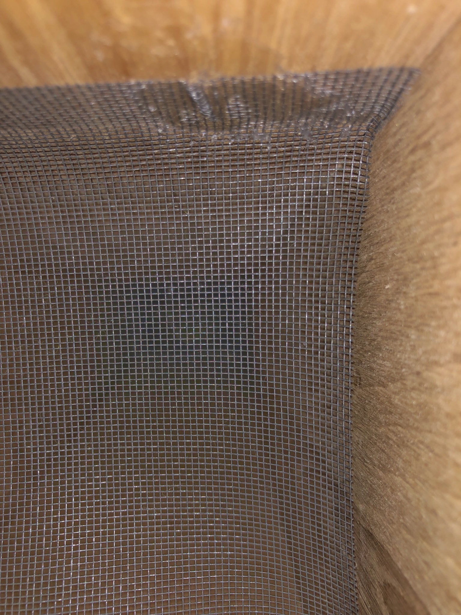

I once took a picture of the inside of the Sibelius and you can see that there is a mesh mat glued in. Possibly to be able to add damping material later via the driver opening??? Or to hide the inside…
