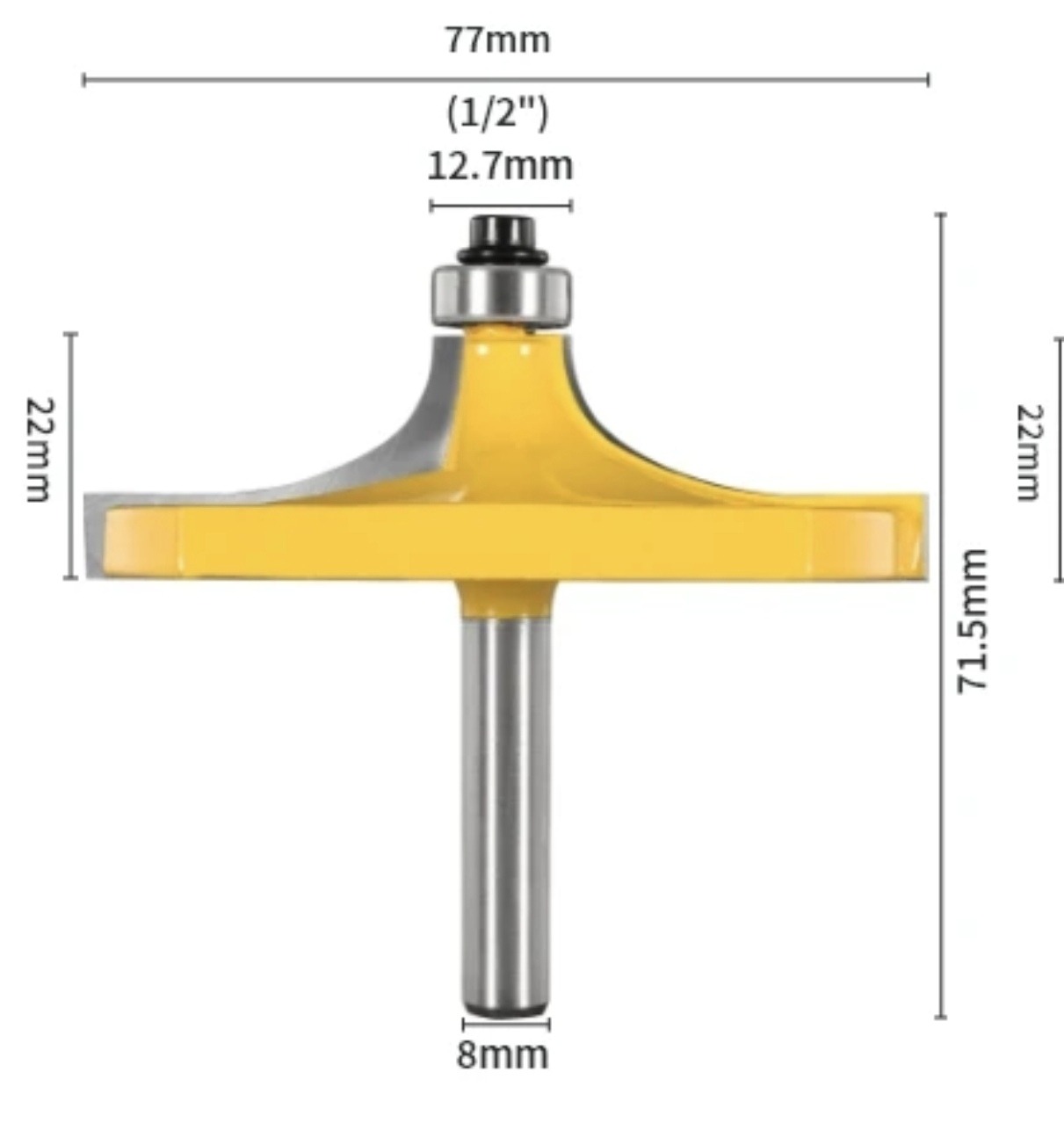

If the outside dimensions were a bit different, bigger size (because I have raw oak boards 50mm thick, about 45mm would be finished), keeping the inside dimensions entirely and I would round the corners with oval shape roundover, dont know proper terms sorry, but its not simple radius. The idea for roundover would be to lessen difraction.
Any thoughts for this ?

That's been my idea too using a large "thumbnail" router bit. It makes sense to me.I would round the corners with oval shape roundover
I've asked a wood worker chap about doing this on a prospective pair of FHXLs but haven't heard back if he's willing/able to it.
I have this bit, approx. 16mm would be on face and back, about 32mm on the sides.
Gotta be super careful tho, its a huge bit, so far not used heh...
@Dario123
That's the idea. And, yes, you'd have to be very careful. You don't want to engage that sharp outer blade edge and gouge the front baffle.
But my thought was that the roundover would start gently -- the largest radius section closest to the drivers -- and the small radius portion 'round the corner of the baffle... like the old Thiel loudspeakers.
