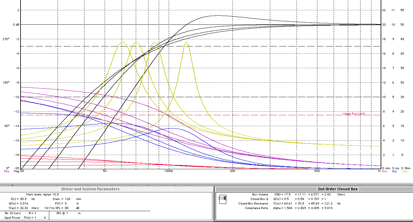

If you try to create a Sibelius copy with a similar driver (Alpair 10.3), you have to adjust the dimensions in the box. Of course it is possible to put the A10.3 in a Sibelius box. But you can't count on it to sound exactly like the original. Maybe you'll like the sound anyway.
Here you can compare the parameters of gen.2 and gen.3
Fo is a little lower for gen.2.
SPLo= 87.988 dB little higher for gen.3.

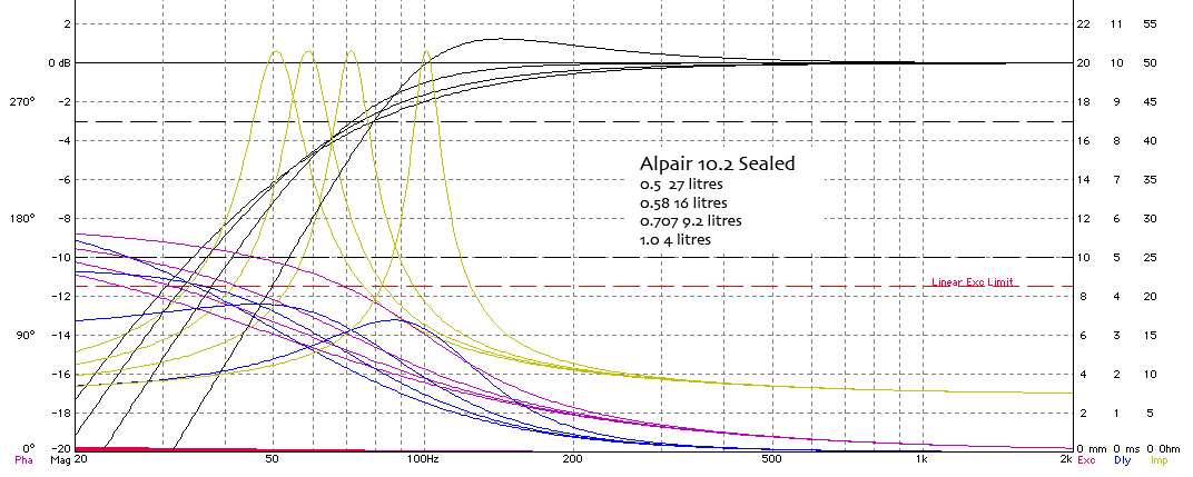

How do they compare to 10.2 and 10.3?
Alpair10p se pdf.
Maop 10.2 : Can't find a pdf file

Many thanks! and where can we get similar information for the newer CH series? How do they compare with the previous generation drivers?
All of the driver data is on the Markaudio website. Just go to the relevant unit and download the data sheets -see the 'specs & box plans' tab on their individual pages. The only partial exception are the MAOP units, which are hand built & pair-matched, so come packaged with their own individual printouts. Free (for personal use) enclosure designs for each driver can also be found under the respective 'cabinet plans & resources' link on each page.Many thanks! and where can we get similar information for the newer CH series? How do they compare with the previous generation drivers?

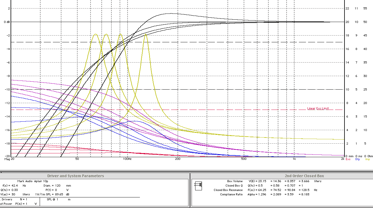

I typically classify bass extention potential by looking at their extension in a sealed box.
1. 2. 3. Look at F6 and F10, ignore F3.
And for reference A10p.
