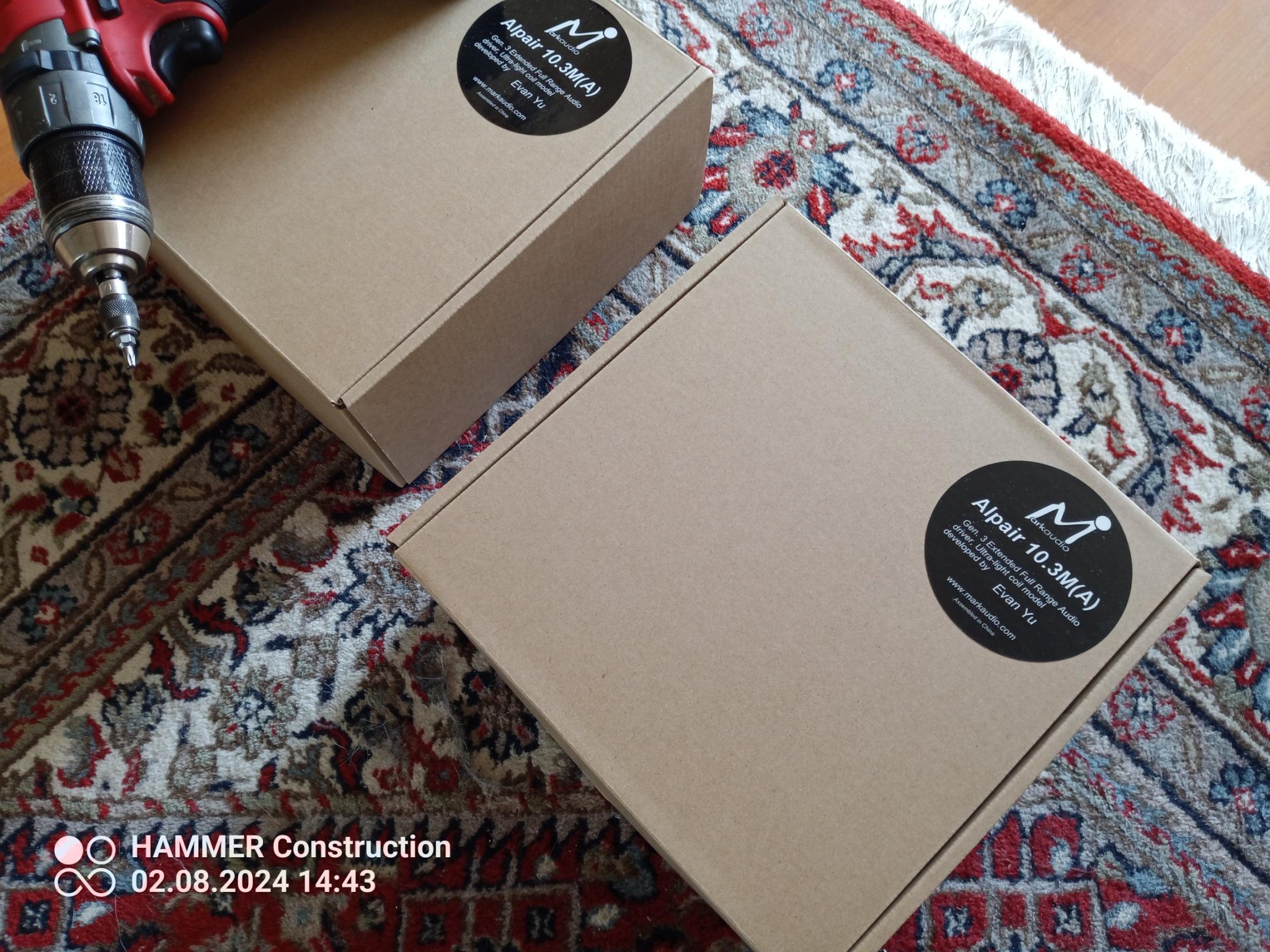

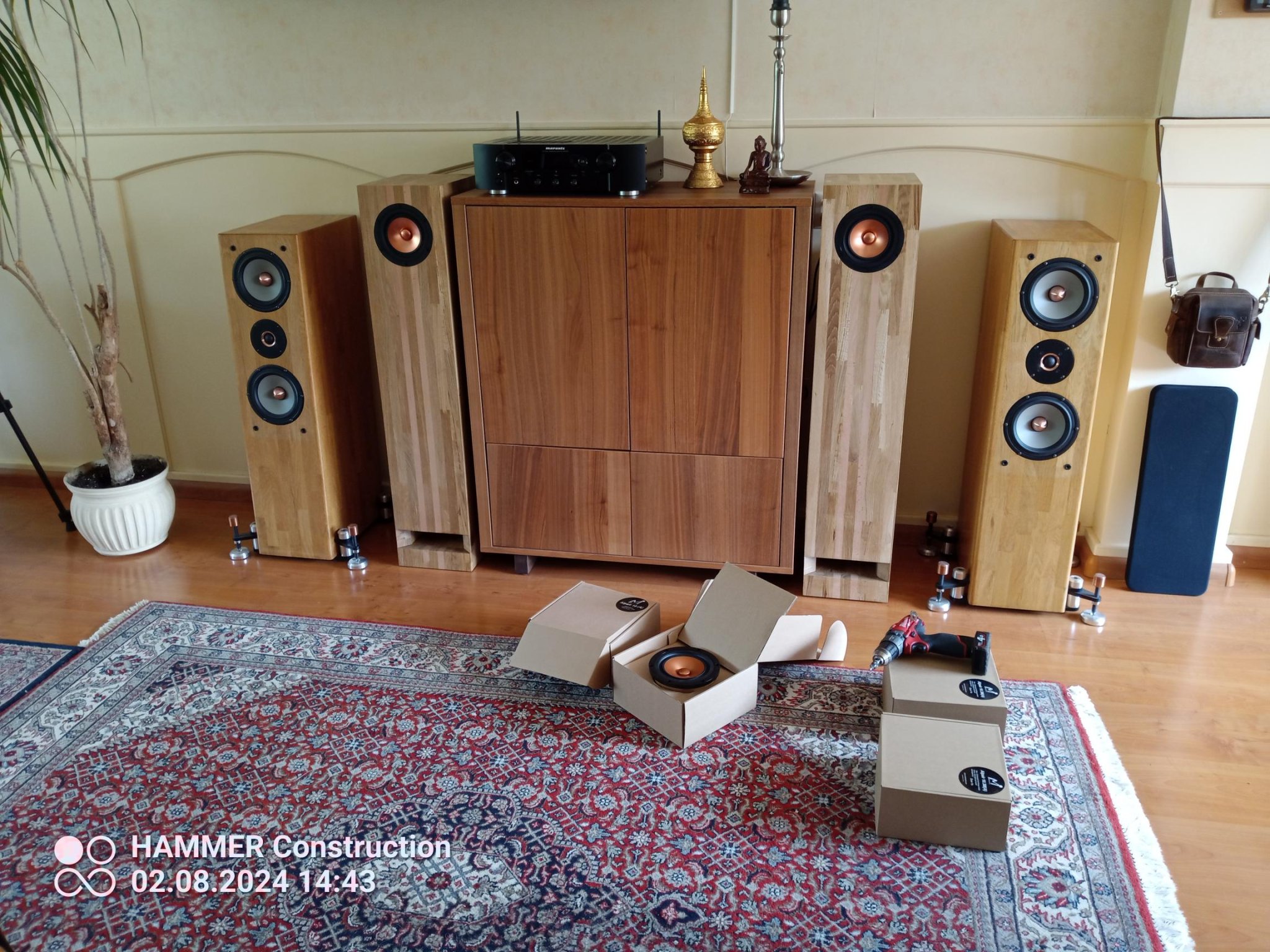

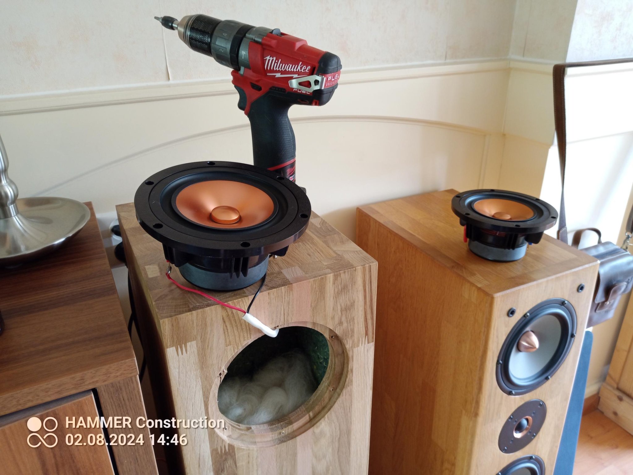

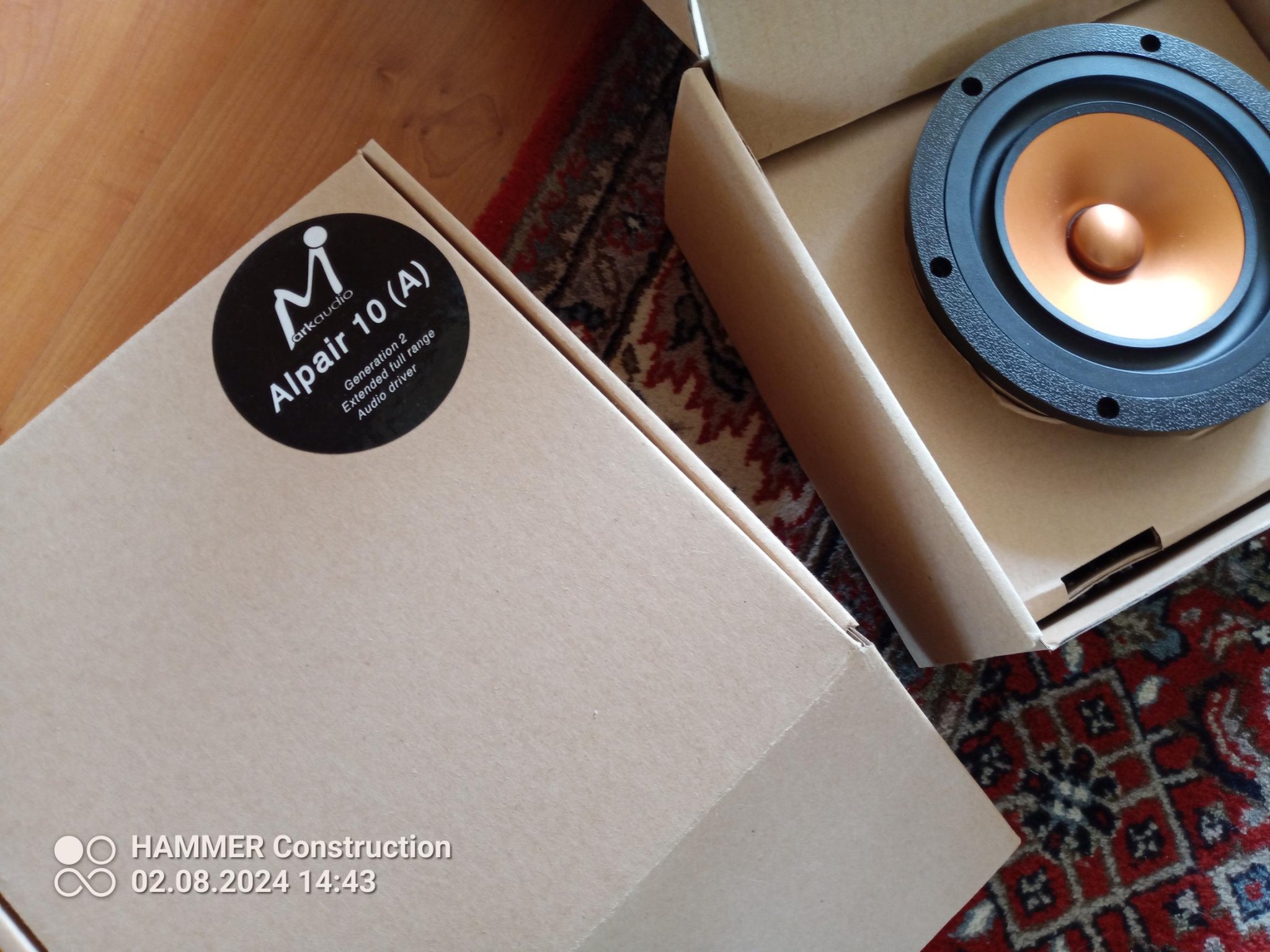

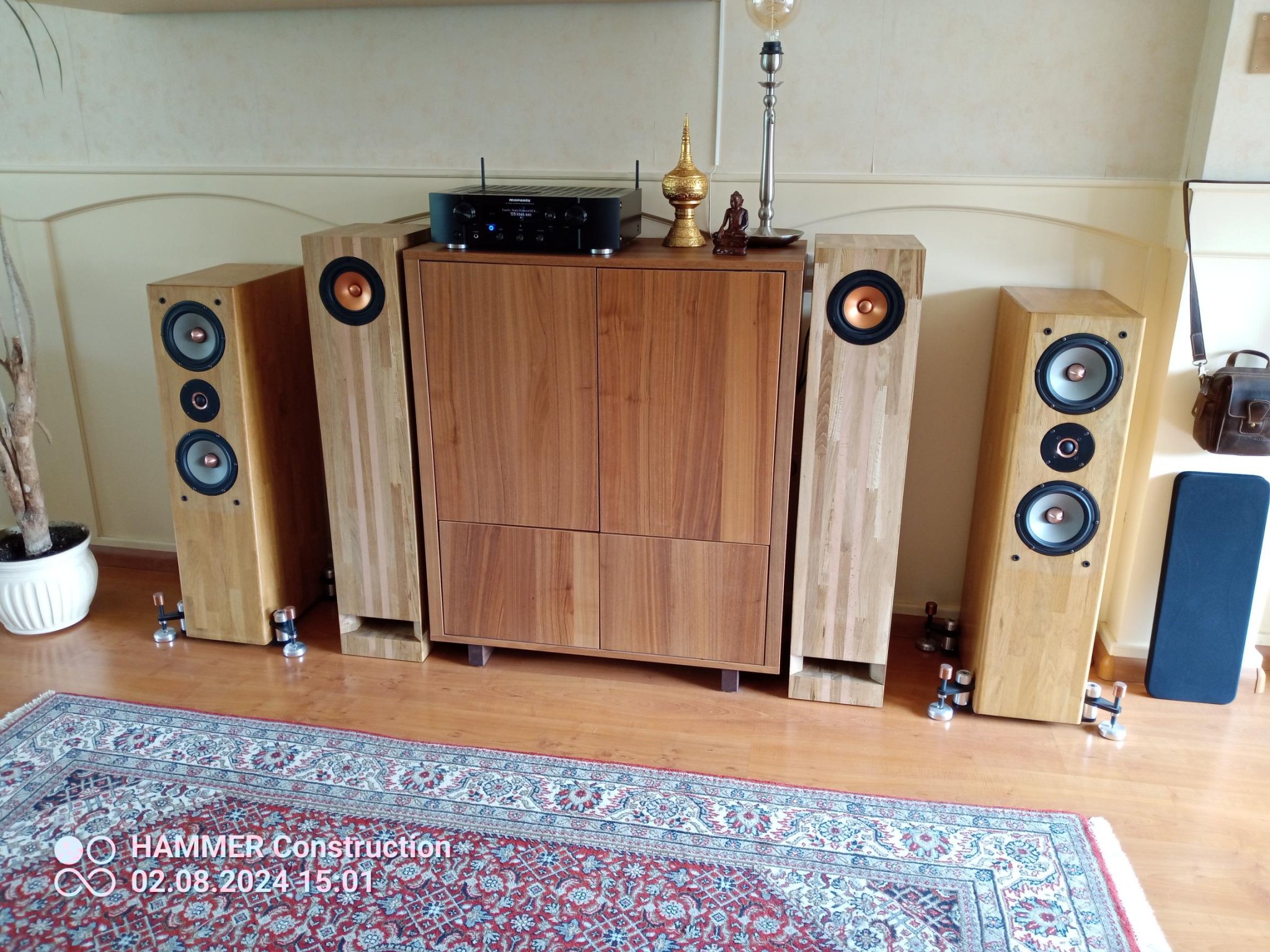

Swapping the drivers from 10.3 -> 10.2 🙂.Next week I will install the 10.2 if I have the time.
Now let them play for several days.
The bass is already fine 👍.

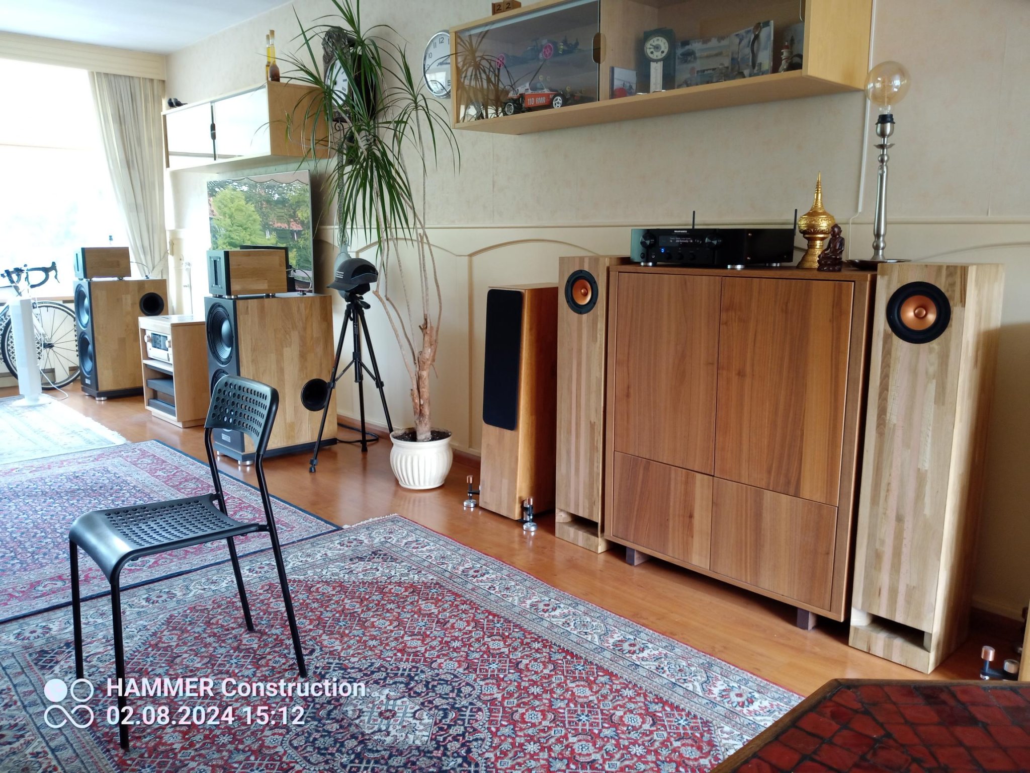

So many different systems !!!!
I may have missed it, how do you feel about your Sibelius clone ?
