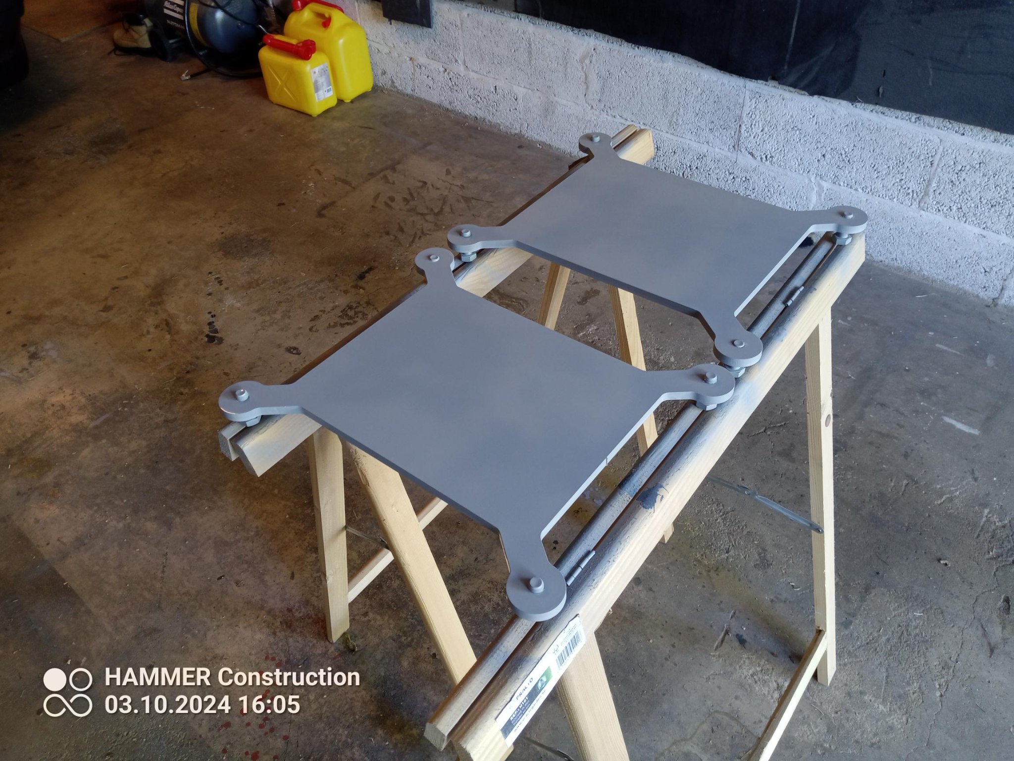

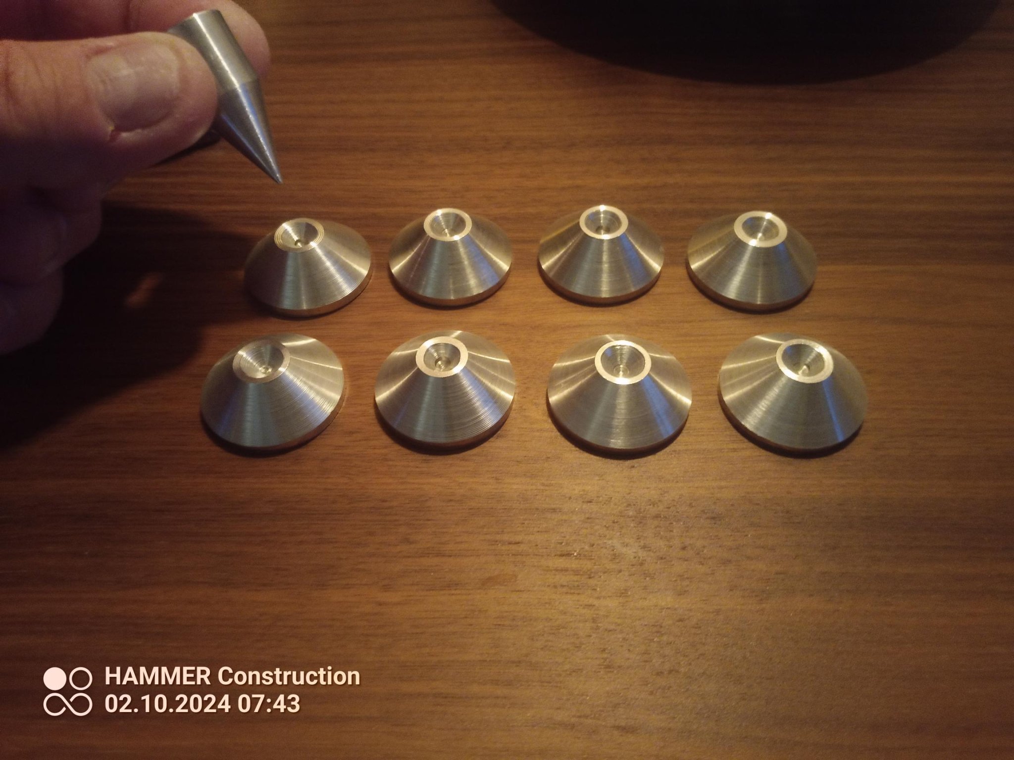

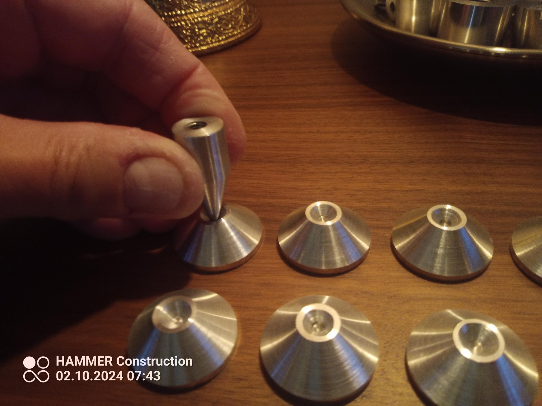

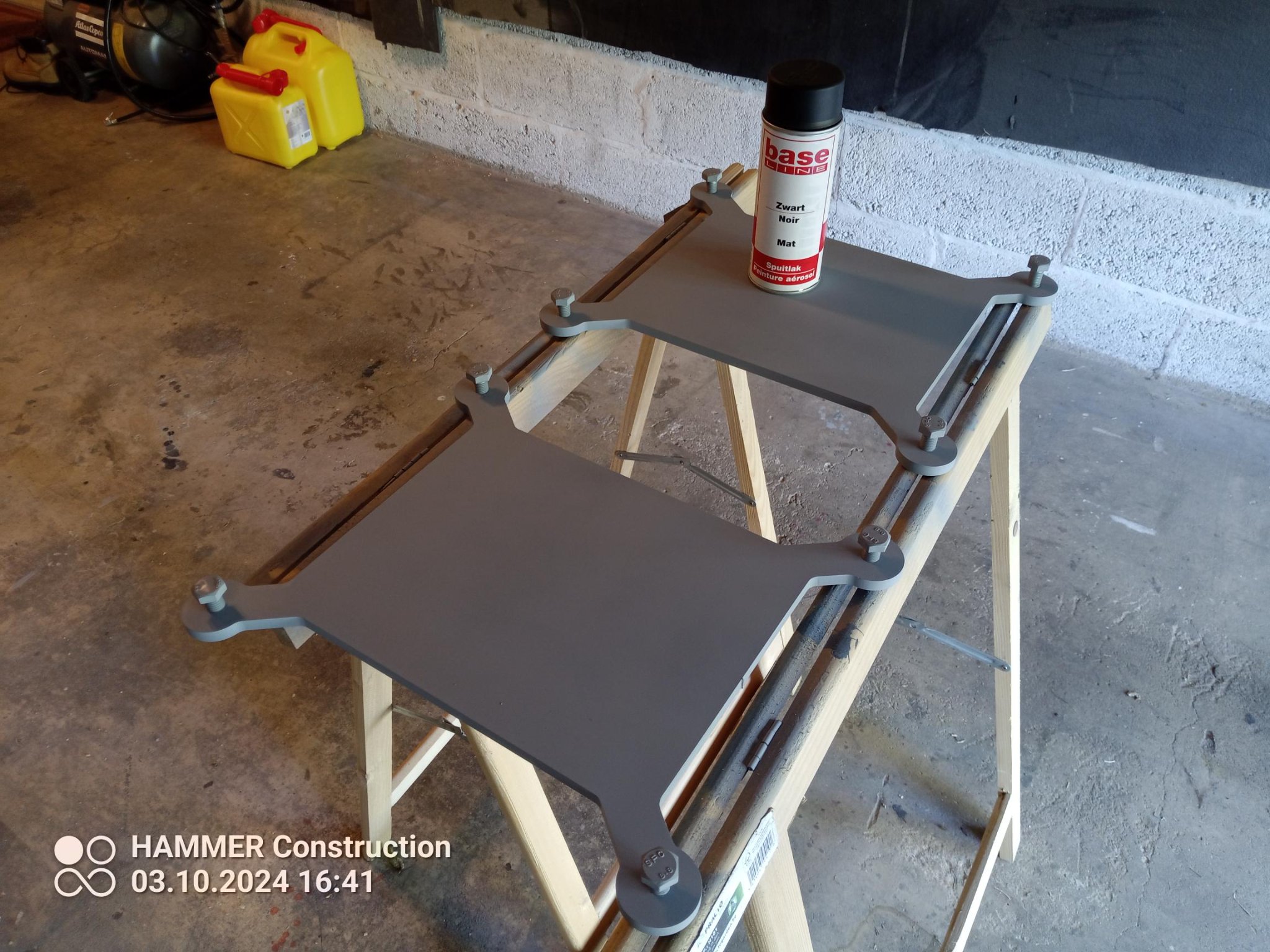

Today these 10mm base plates are equipped with M12 thread holes, carefully sand blasted and forseen with a good primer.
Ready for a matt black finish. 👌 👍

Hi Wil I like to build them as much as according the original.a simple solution for nice stands for the Sibelius….View attachment 1364162 under the Sibelius….

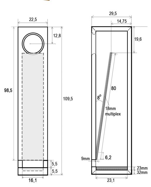

Hi Hondas, for me it's also important that the cabinet is a exact copy. In my research of the photos and the original speaker I came up with slightly different sizes than you. For example, the slanted plywood in my case becomes 80cm long.Hi Wil I like to build them as much as according the original.
Thanks Wil, I gather this tilt arrangement has something to do with alignment of drivers on the vertical axis for other types …Hi acko, I spoke with Harley and since it is a single driver, the vertical listening position is not important. It is therefore not necessary to tilt the speaker to the listening position. Gr. Wil.
I try to make a perfect clone of the Sibelius and
analyzed several photos in my own way and came up with my own construction drawing. I think I'm very close to the original, but it would be nice if it was confirmed by more builders. A little further back in this thread Kotlos analysis comes close to mine. Here are my measurements. The 18mm birch plywood was confirmed by Harley himself...
