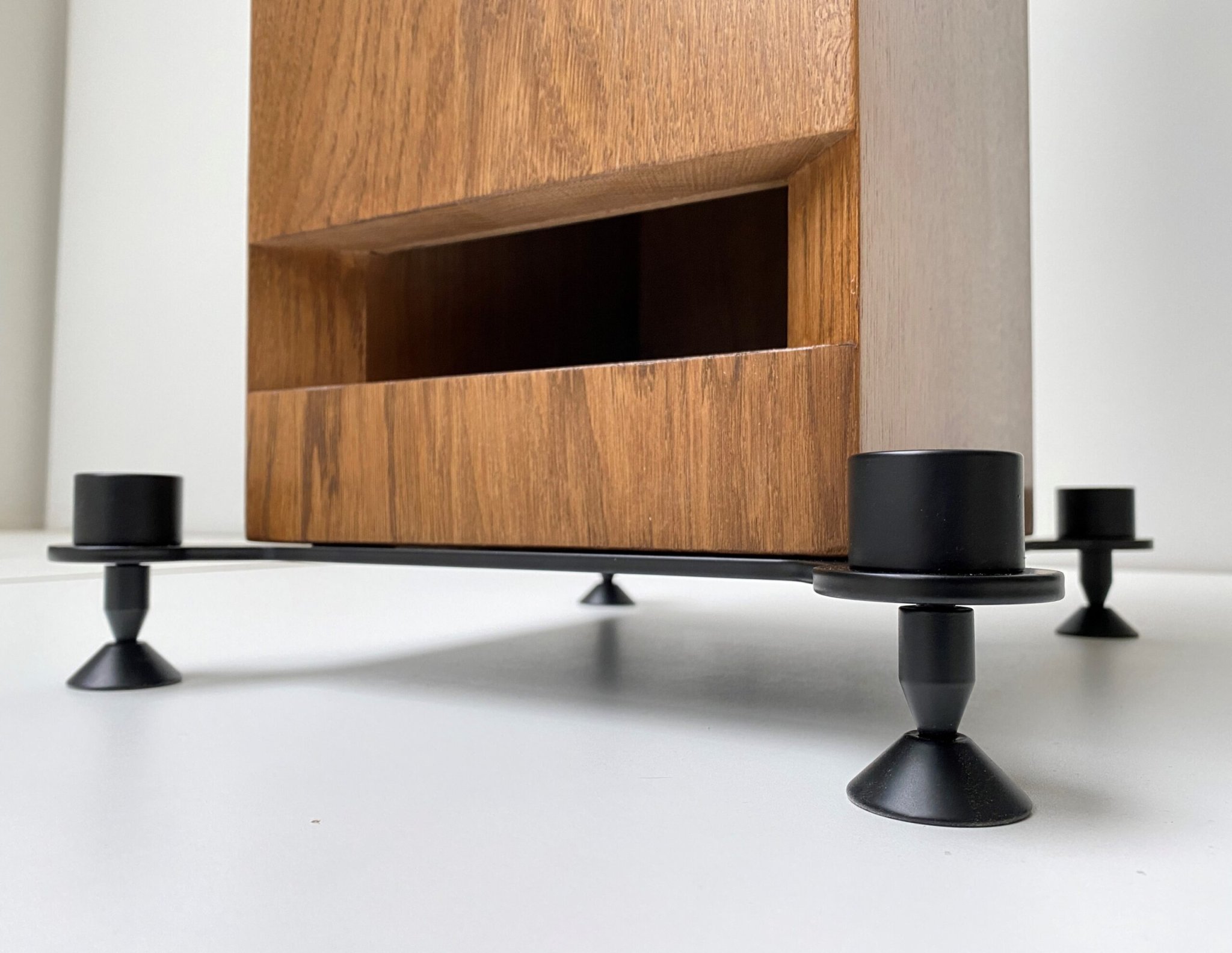

The Sibelius I heard were on Townshend podium stands and I think this helped that bass/room interaction.Last week I installed the terminals.
Nice small terminals for doing the job.
Material for the stands I also have.
For the hi-fi racks I make, I have found a very good (and fairly low cost) solution for isolation/coupling using stainless steel ball end grub screws and zirconium balls. It could be good and easy to try out (removable if needed) in your stand if you wanted the details.
In the Pensils we trialed (I still preferred our A7.3 to the actual Sibelius) I used some well-nuts to isolate the cabinet from its plinth that was permanently attached, I never did an A/B but the customer did and much preferred it with the added isolation.

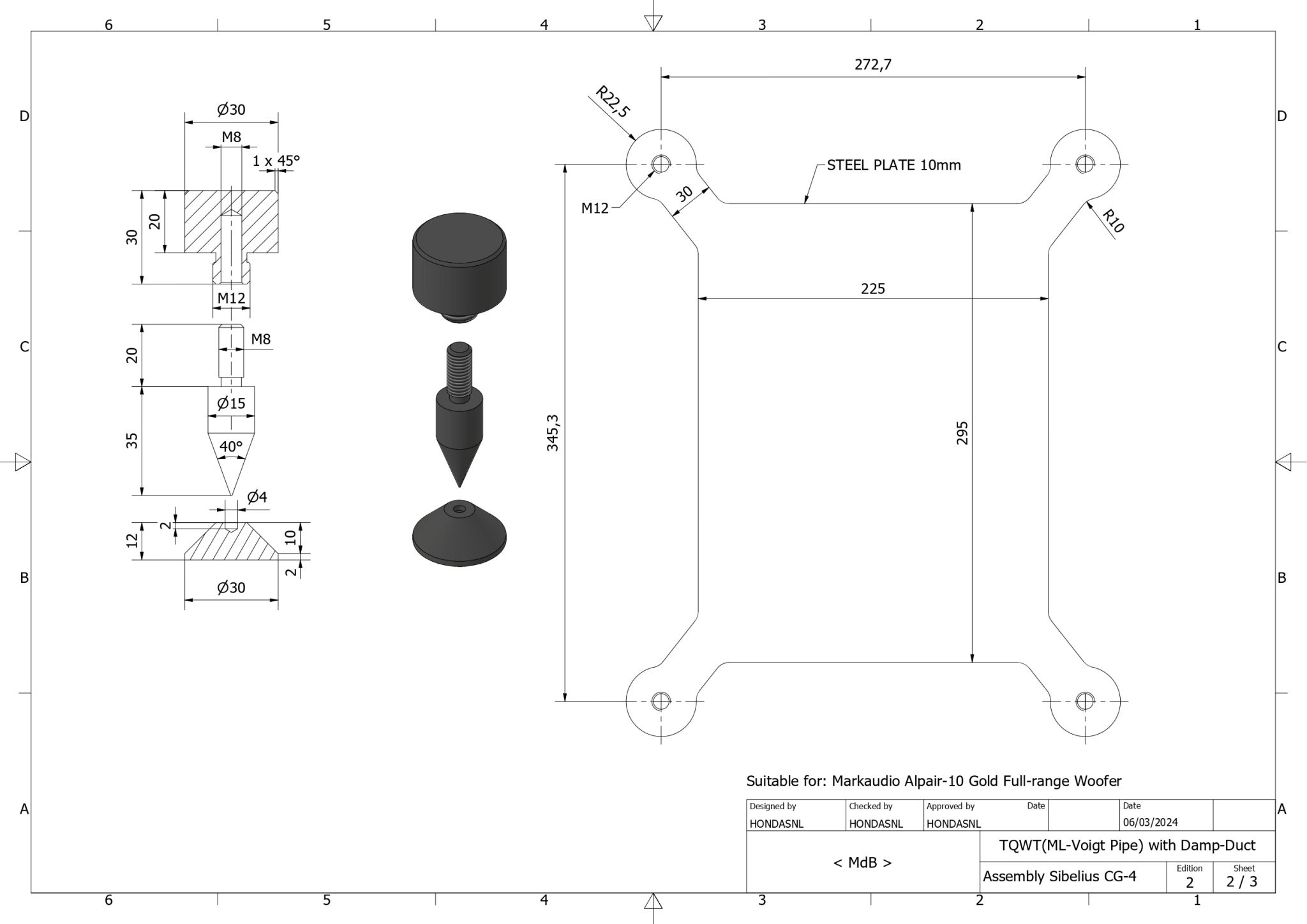

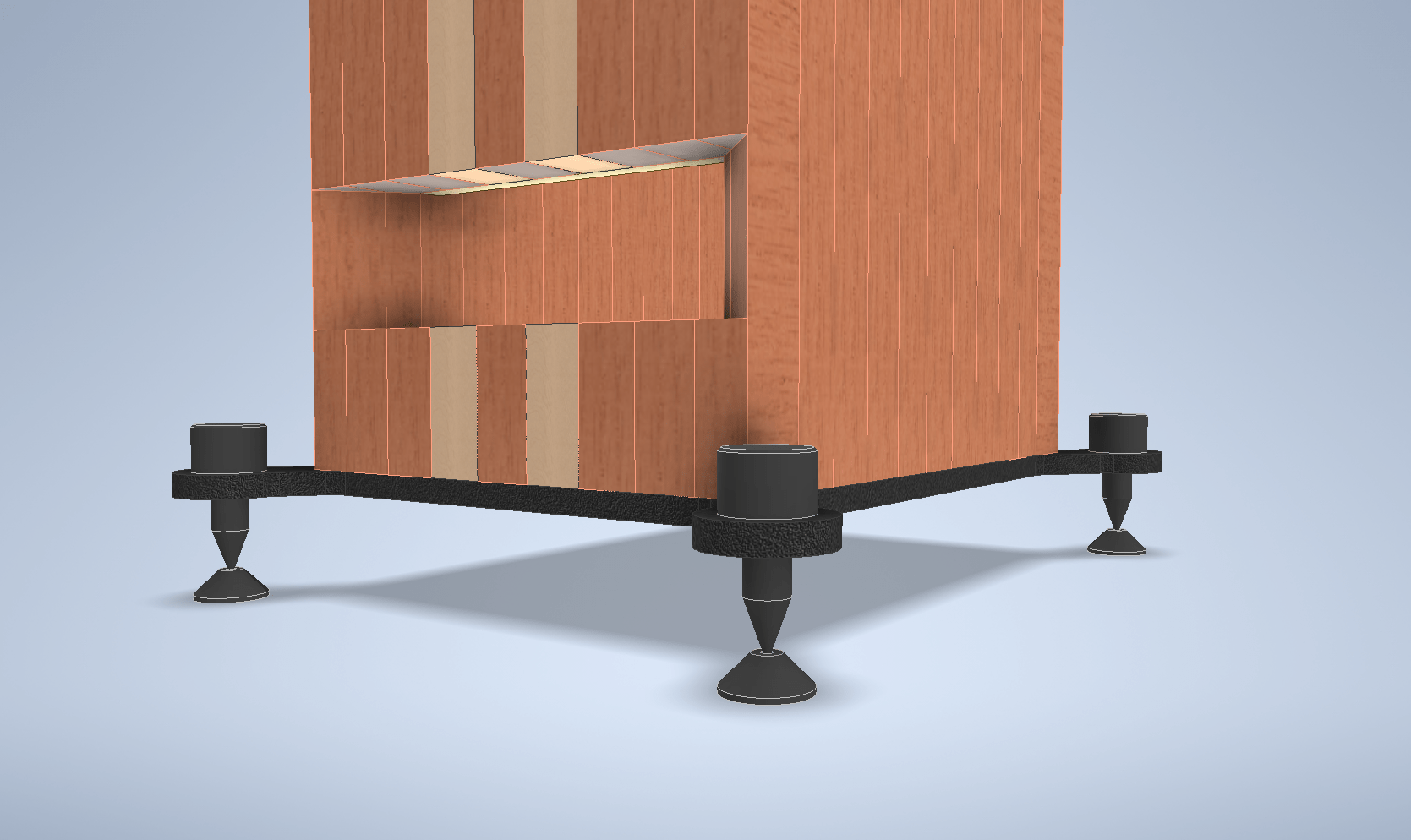

the stands will be as much as possible a copy of the originals (clone).The Sibelius I heard were on Townshend podium stands and I think this helped that bass/room interaction.
Only the base plate I use has a thickness of 10mm.
