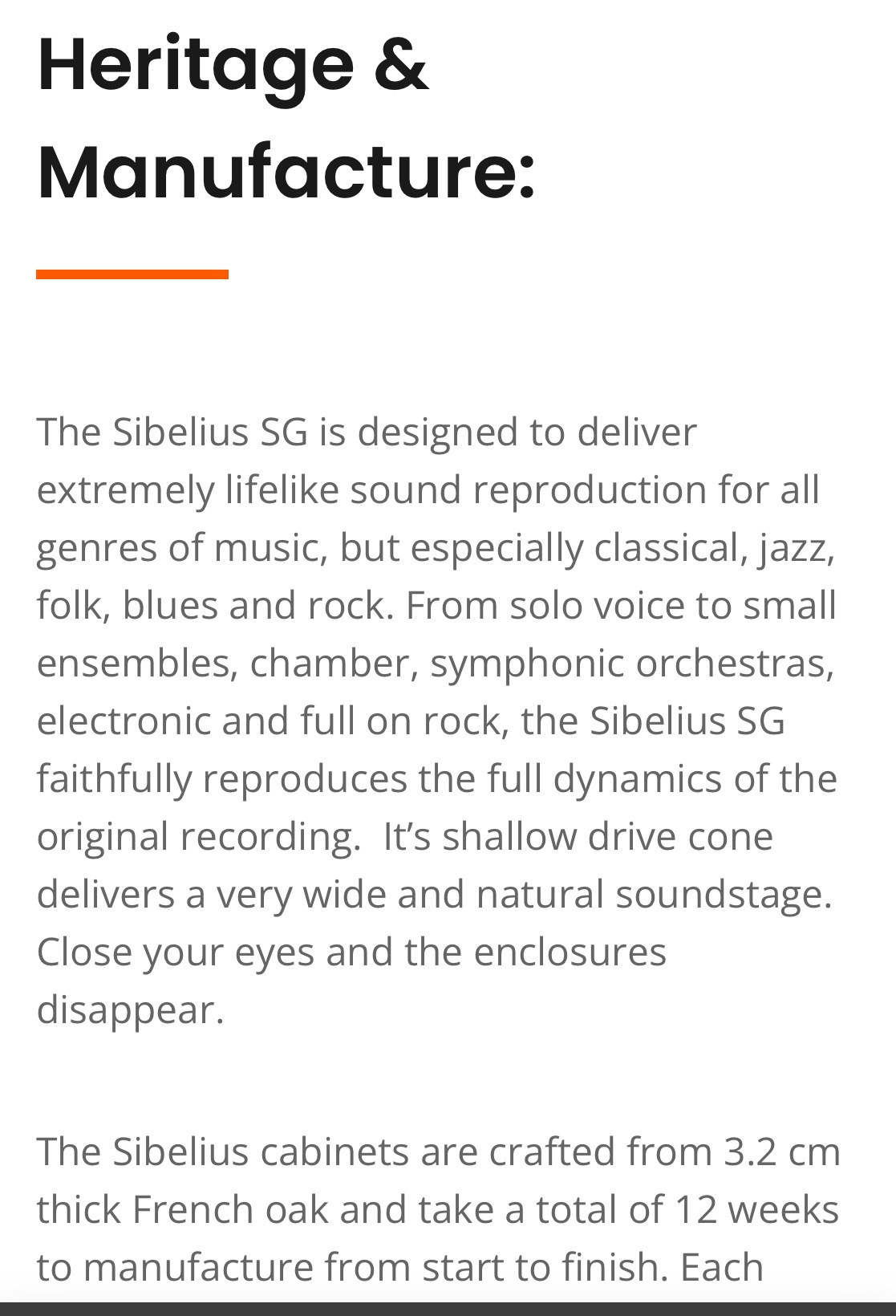

Not sure about this capability. The review videos for the Sibelius mostly playing single instruments. I will be getting mine in a couple of days. What sort of tracks would you recommend to test ? 🙂Can this kind of speaker really play an orchestra anywhere original sound pressure. It seems to have way to little Sd to get anywhere near... using such a limited speaker means that any equipment in the chain can probably not be fully evaluated/utilised/experianced in terms of dynamics and LF extension.

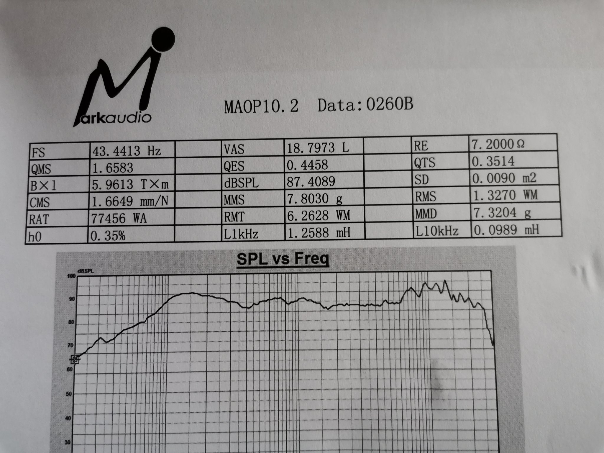

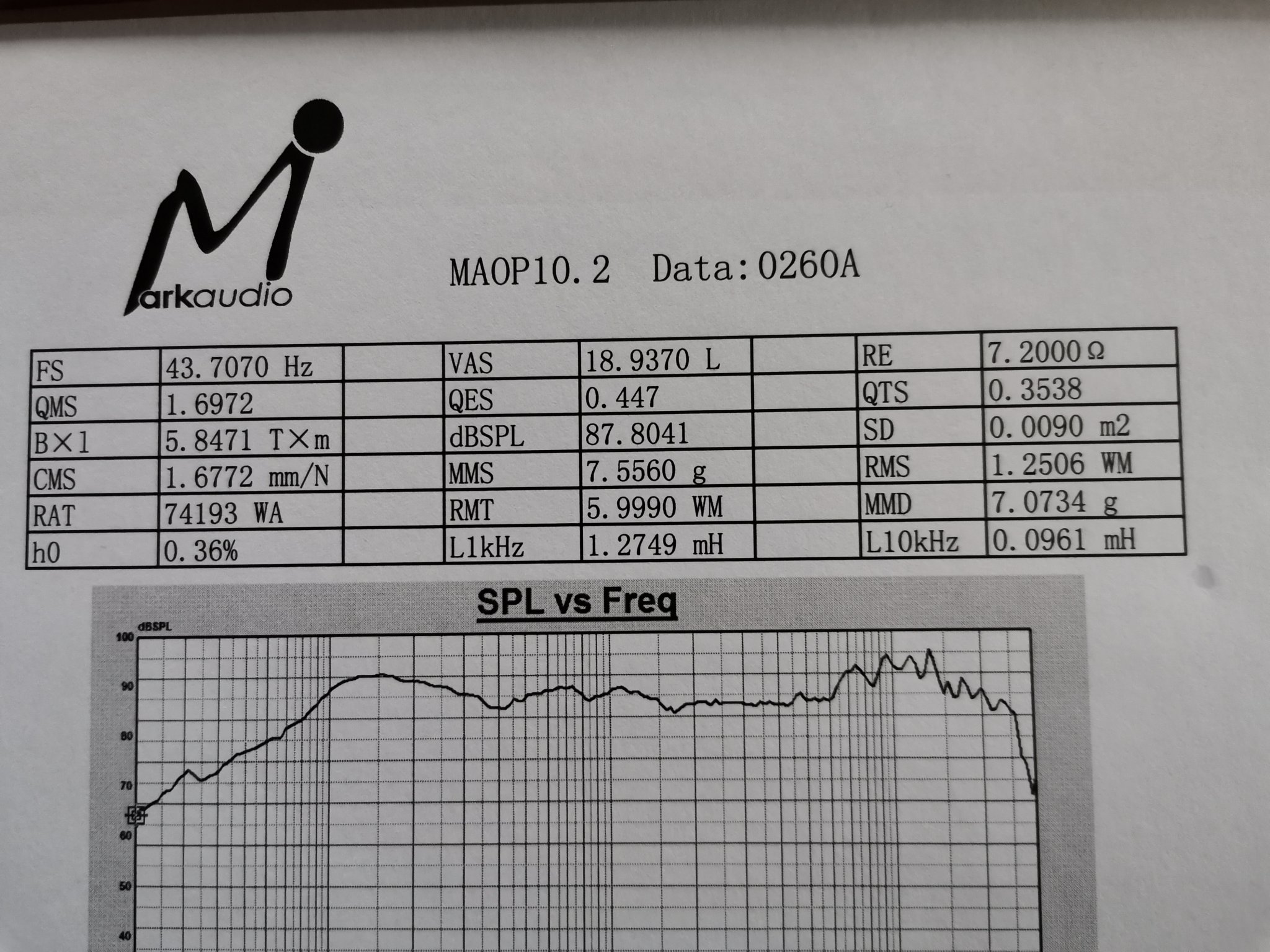

When you buy driver's model Maop, you will get everything you need to create your own box.
You get measured individual parameters for your particular drivers.
The parameters are very close to each other in a pair.
For me it really has to do with what you are after.Can this kind of speaker really play an orchestra anywhere original sound pressure. It seems to have way to little Sd to get anywhere near... using such a limited speaker means that any equipment in the chain can probably not be fully evaluated/utilised/experianced in terms of dynamics and LF extension.
But I'm sure it sounds nice...
Soundstage is not a single category that one speaker can outperform another. For example the clarity and precision of the separation that you can get with single driver speakers is amazing, but if you are looking for a big soundstage then multi-driver speakers can be more effective. Listening to an orchestra on the latter can give the illusion of being in the concert hall without the need to separate instruments as well. Open baffle and panel speakers can have a similar effect.
In my experience, the single driver speakers that don't need any crossover are much better at bringing out differences of the chain (DAC,preamp/poweramp..) compared to multi driver speakers (if the ability to drive the speakers is taken out of the equation).
Other than the type of music, parameters such as how the recording was mixed, room reverberations, placement, etc play a huge role in the sound and different speakers can lead to vastly different experiences.
Finally, frequency response even measured within the listening environment is only a small part of the equation and being flat does not always result in the best listening experience.
Excellent!, thanks Sir. So have to buy first in the case of MA
Interesting to see what sort of data comes with the Sibelius itself
Only for Maop drivers.

This is a warning re: my question...The review videos for the Sibelius mostly playing single instruments
Try Shostakovich 8th, III. Allegro non troppo on Naxos with Petrenko... I suppose you attend live venue performance of classical music so you know how it "sounds"!?
Orchestral music on concert levels with single 10 cm driver?? You guys are so funny

Some claims:Orchestral music on concert levels with single 10 cm driver?? You guys are so funny

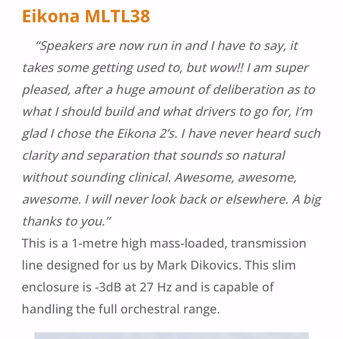

Claims is right (gigantic advertising graphics not required 😉 ), since like anything it depends what is meant. A 27Hz tuning arguably covers the full orchestral range, depending on what you include in that (64ft organ pipe racks need not apply). However, while it might cover the frequency range, it certainly doesn't cover the LF dynamic range of an orchestra at realistic (aka 'live') SPLs. Assuming you listen at 85dB at your listening seat, that means you need at least 20dB LF headroom to cover dynamic peaks, and that ain't going to happen. Remember too that since with a point source SPL decreases at -6dB per doubling of distance. So if you happen to listen at, say, 2m away (fairly close) and the speaker sensitivity is rated at 1m, then you'll need 4x the input power and double the excursion just to hit that baseline SPL, eating into the limited headroom available. There's a reason big systems with HE 15in woofers & compression horns exist. 😉Some claims:
