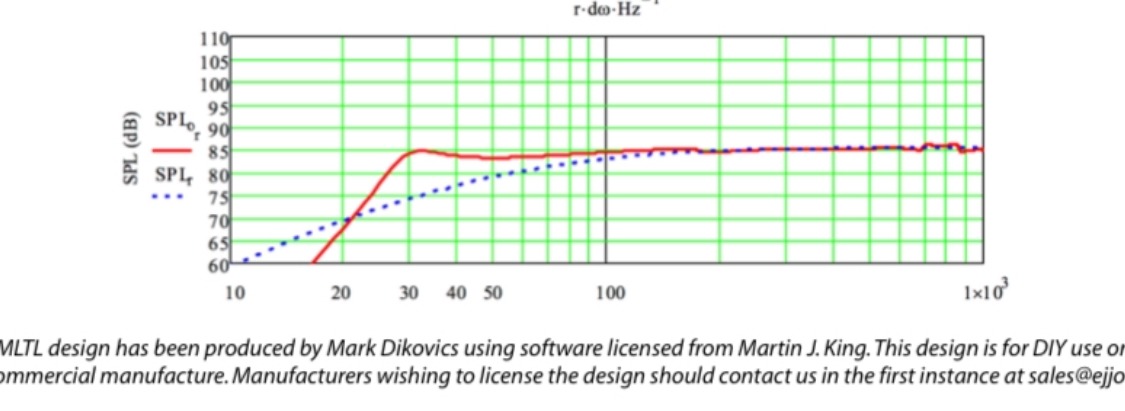

Why not much love for the Eikona II, especially in an MTL38 enclosure with Fb27 achievable? Price of drivers or any issues with alignment etc?

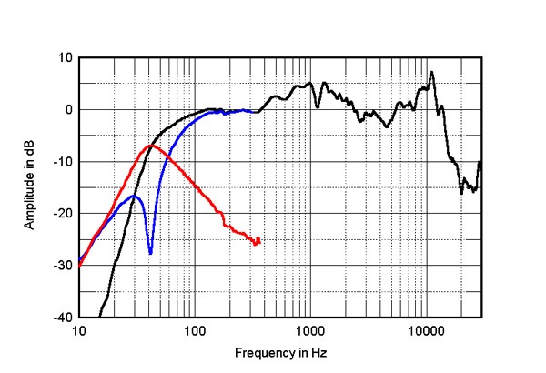

some scary measurements for the Marlow speaker that uses the eikona 2 (I think)....
1.2khz is mentioned as could be a side panel resonance (+5db ?)

(Marlow loudspeaker with eikona 2 from the stereophile article linked above)

The Marlowe's response is pretty much as you'd expect for a sub-compact bookshelf with no filtering; the peaking in the ~3 octaves from 350Hz is what you'll usually see (whether it's a single-driver based design or a multiway before [and sometimes after 😉 ] filtering). You end up with a more or less projective response in that region similar to, say, a Yamaha NS10. That's why I did a couple of LS series plans for MA with an optional parallel EQ that's well worth having (for that particular compact box) as you can can tailor the midband response to preference by adjusting the resistor value.

Doesn’t this somewhat match the actual driver characteristics?View attachment 1335421
Well, you'd expect there to be broad similarities, unless it was running a different drive unit. 😉 The main differences, as you can see, are in the LF and lower midband where box output & diffraction / baffle loading have the greatest influence.

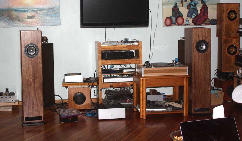

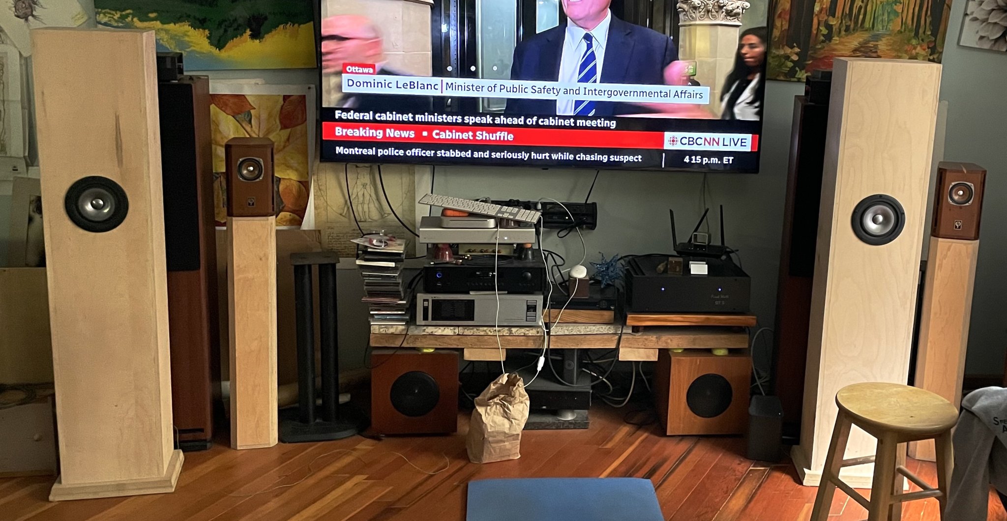

Somewhere there is the picture of all 3 together at teh diyFEST shootout. Eilona in Hawking Memorial Obelisk, A11ms in Seastack, A10.3eN in Pensil.
All 3 were auditioned together at the last VI diyFEST.
Eikona cam in last. A11ms stood out in most ways, A10.3eN provided the best 3D image/soundstage. Chris took Seastack and Pensil home, listened for a long time, kept the Pensils.
Chris was worried that the shallow depth of the HMO was hurting the Eikona, but hat wouldnot explain the top which i found had the same “somewhat painful” top end in the same way as the JX92s, and to a bit less extent the A10.1.
HMO cabinets are free for pickup, suggest adding a supraBaflfe, fairly easily adpated to A10.3 (& probably A11ms or MAOP 11), Over $400 of bits in the box plus Chris’ labour.
dave
