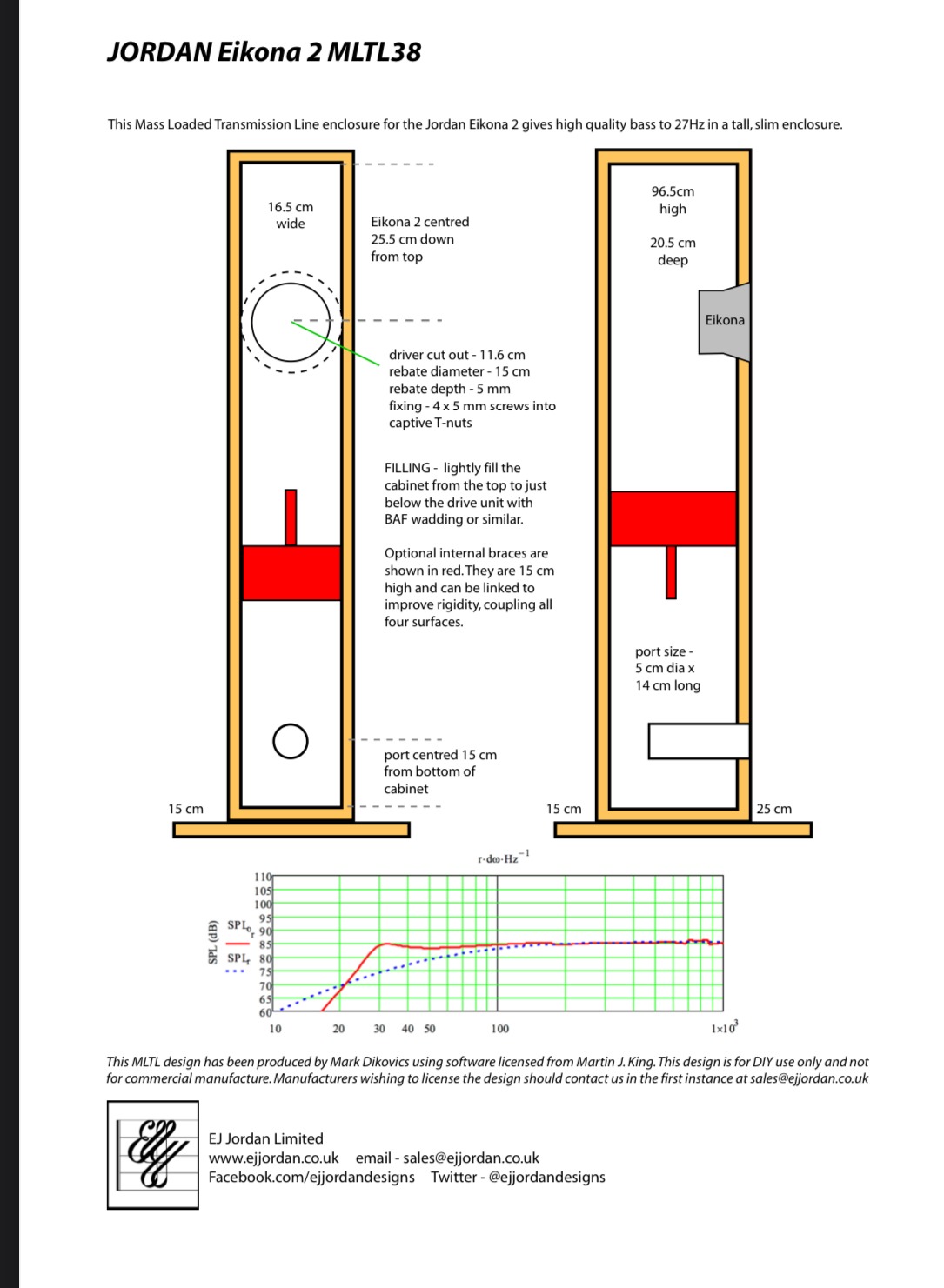

No problems, I will just enjoy watching your progress. I am sure it will be a great success! I sort of gave up on mine after getting a pair of Eikona II (brand new) and to do an MTL38 cabinet in the same way as the Sibelius construction. If you or anyone else interested in constructing something similar I will happy to give it away for free!

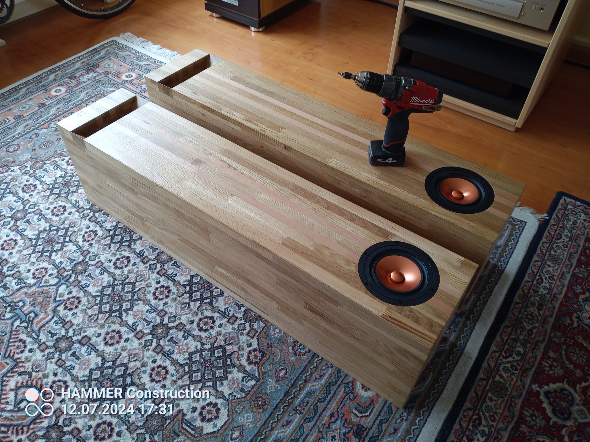

I’d put much better bracing in that box.
Eikona doesn’t do a ell as A10.3 being used by Hondasnl. At least IME.

Thanks Dave, yes noted the comparisons but good to test out. Besides, I don’t want these Eikona drivers going to waste just sitting on my desk, been 4yrs already - looking for a new home🙂
In regards to braces, looks optional and wondering if we could do away with these if 32mm French Oak or similar used. Here we have Tasmanian Oak and hardware shops sell ‘dar’ types. Not sure if good enough

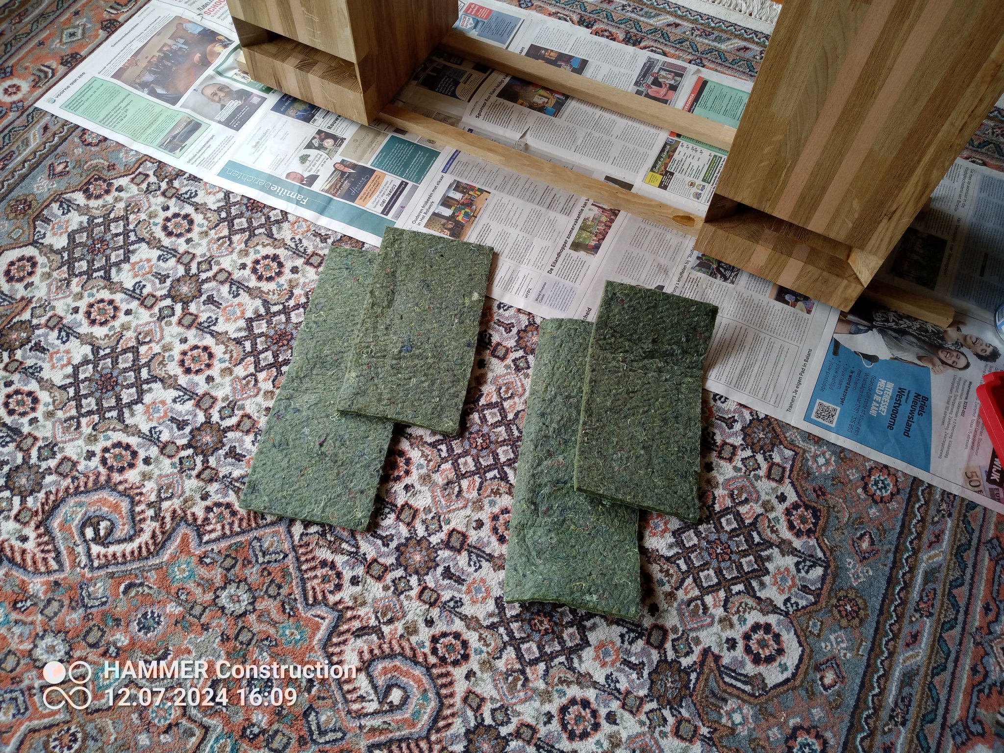

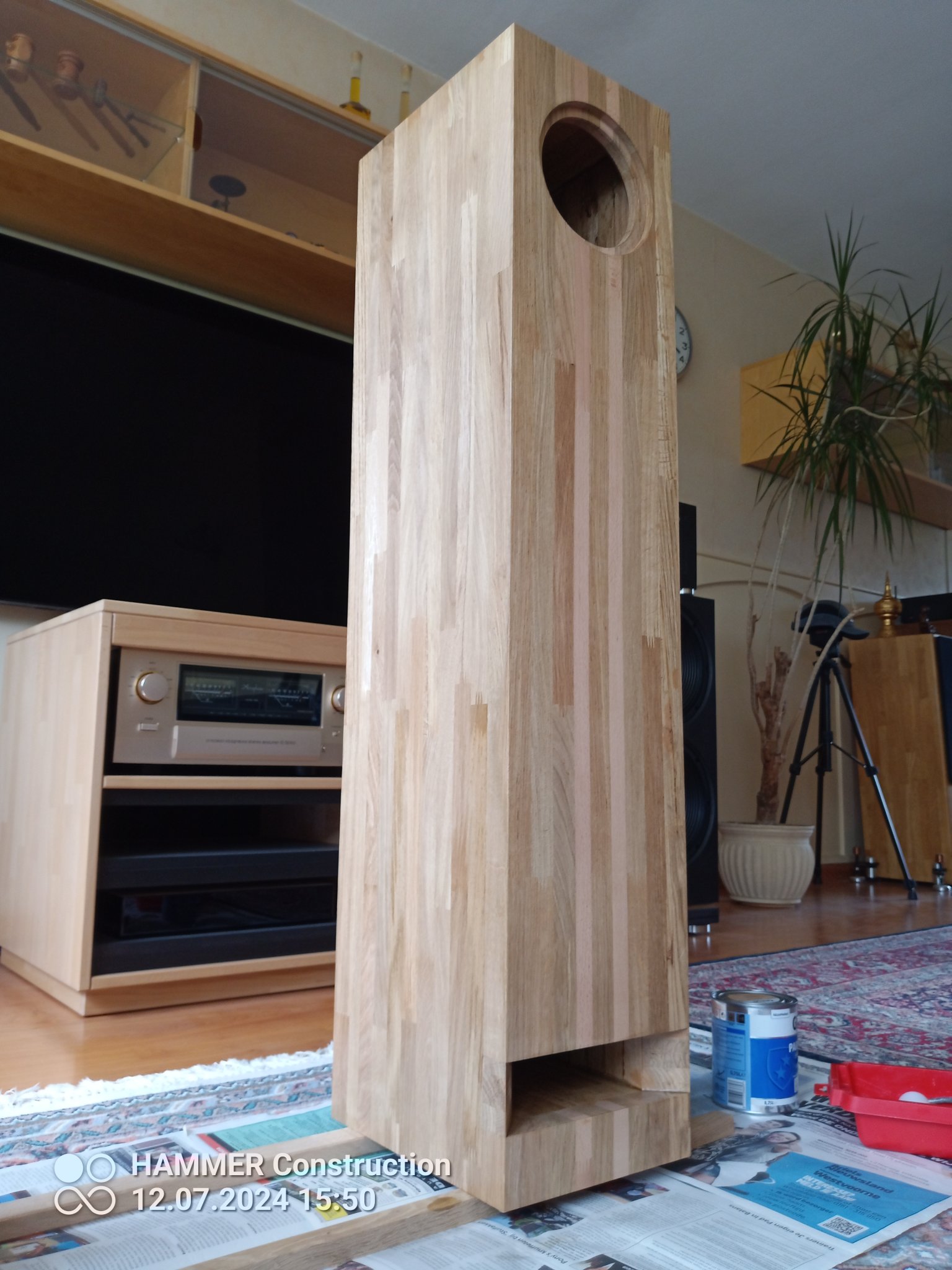

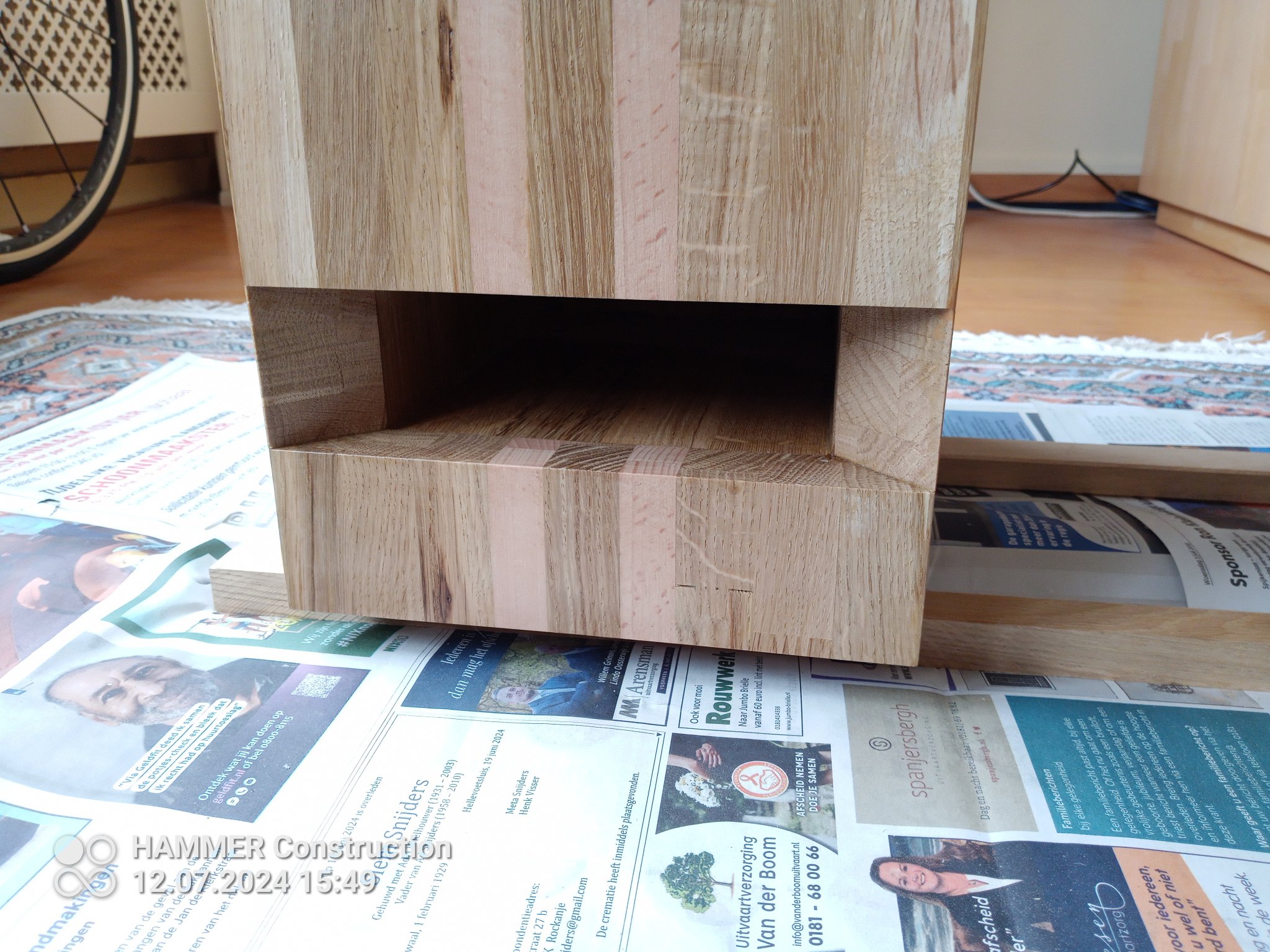

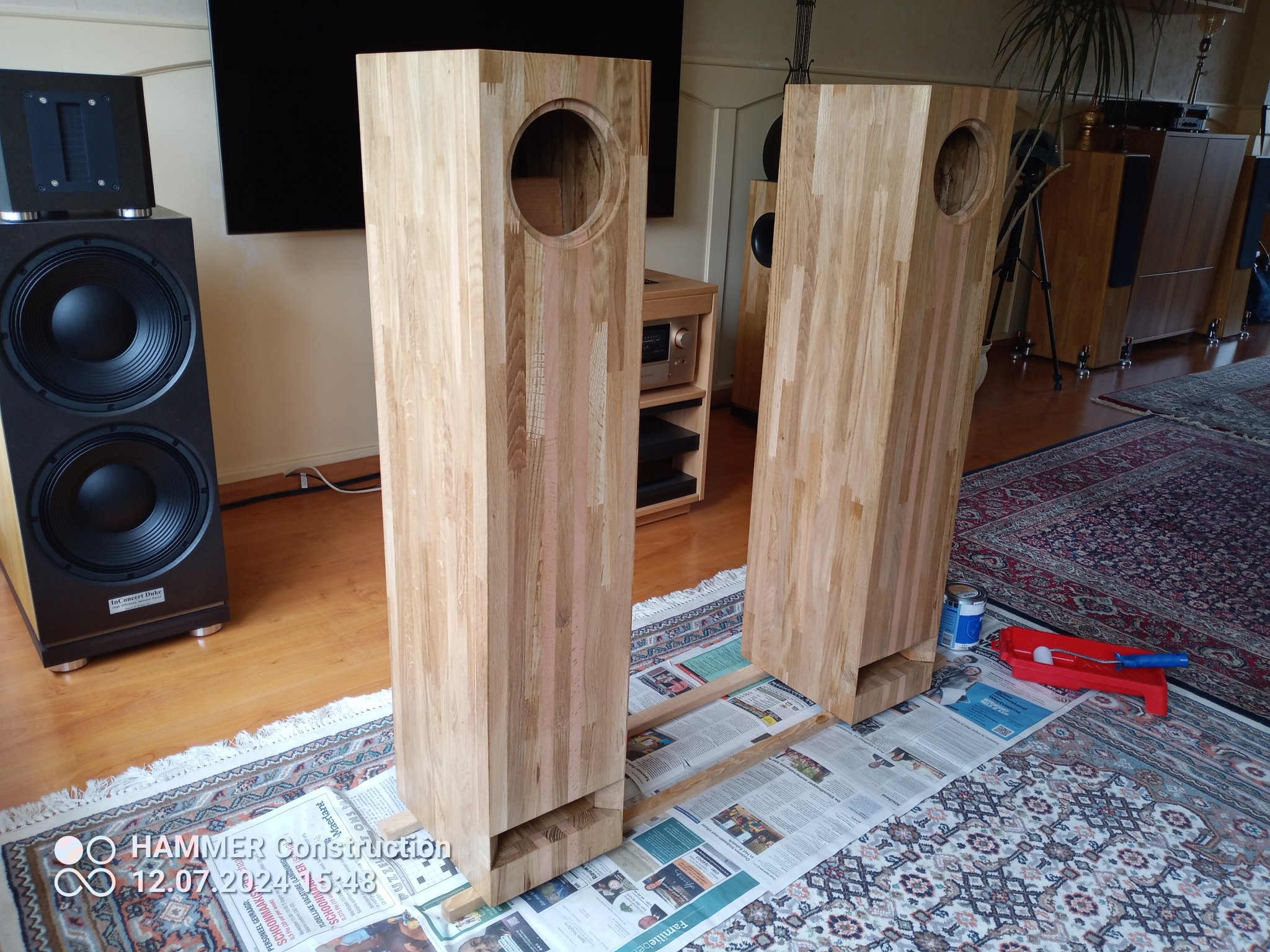

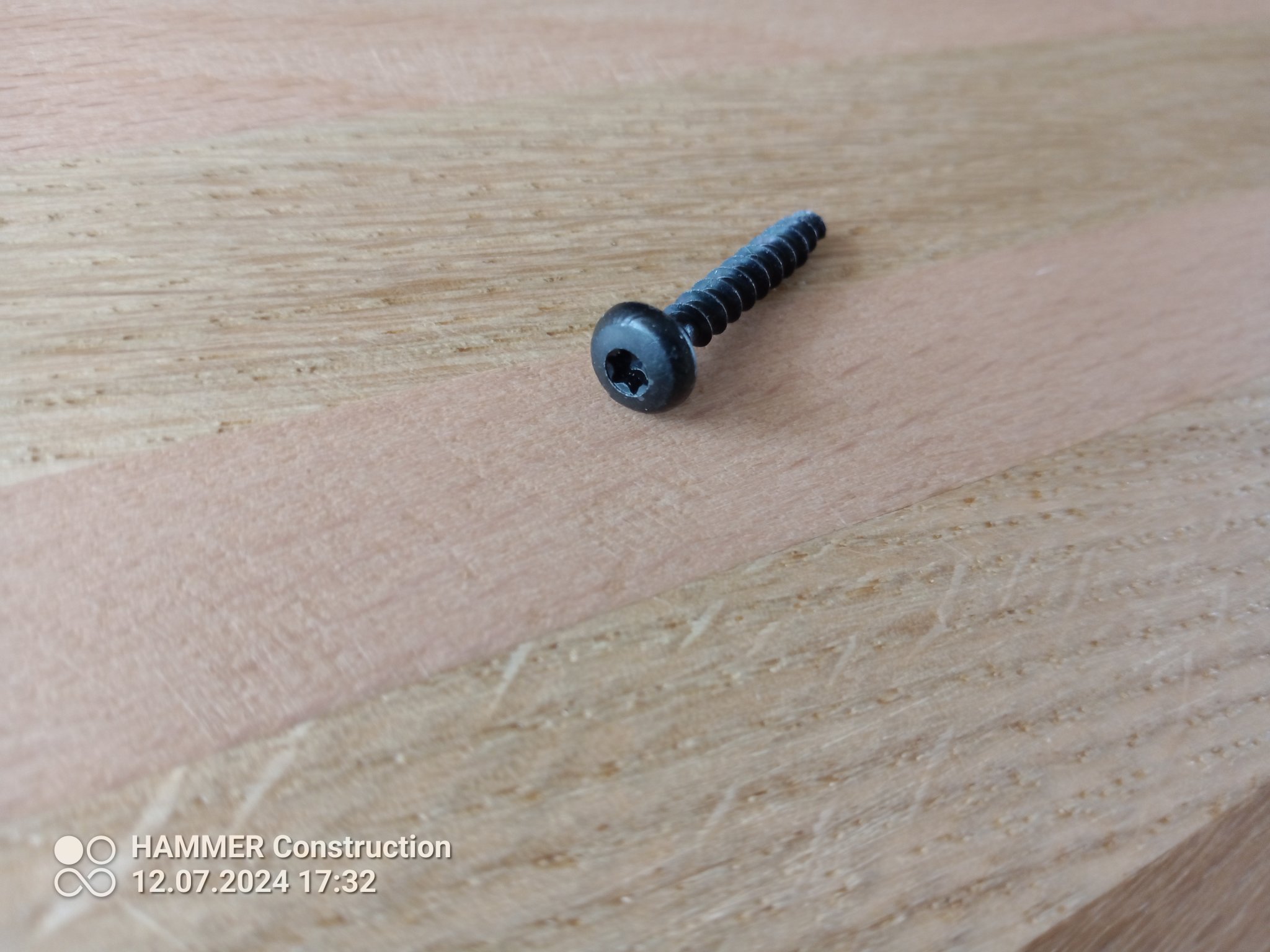

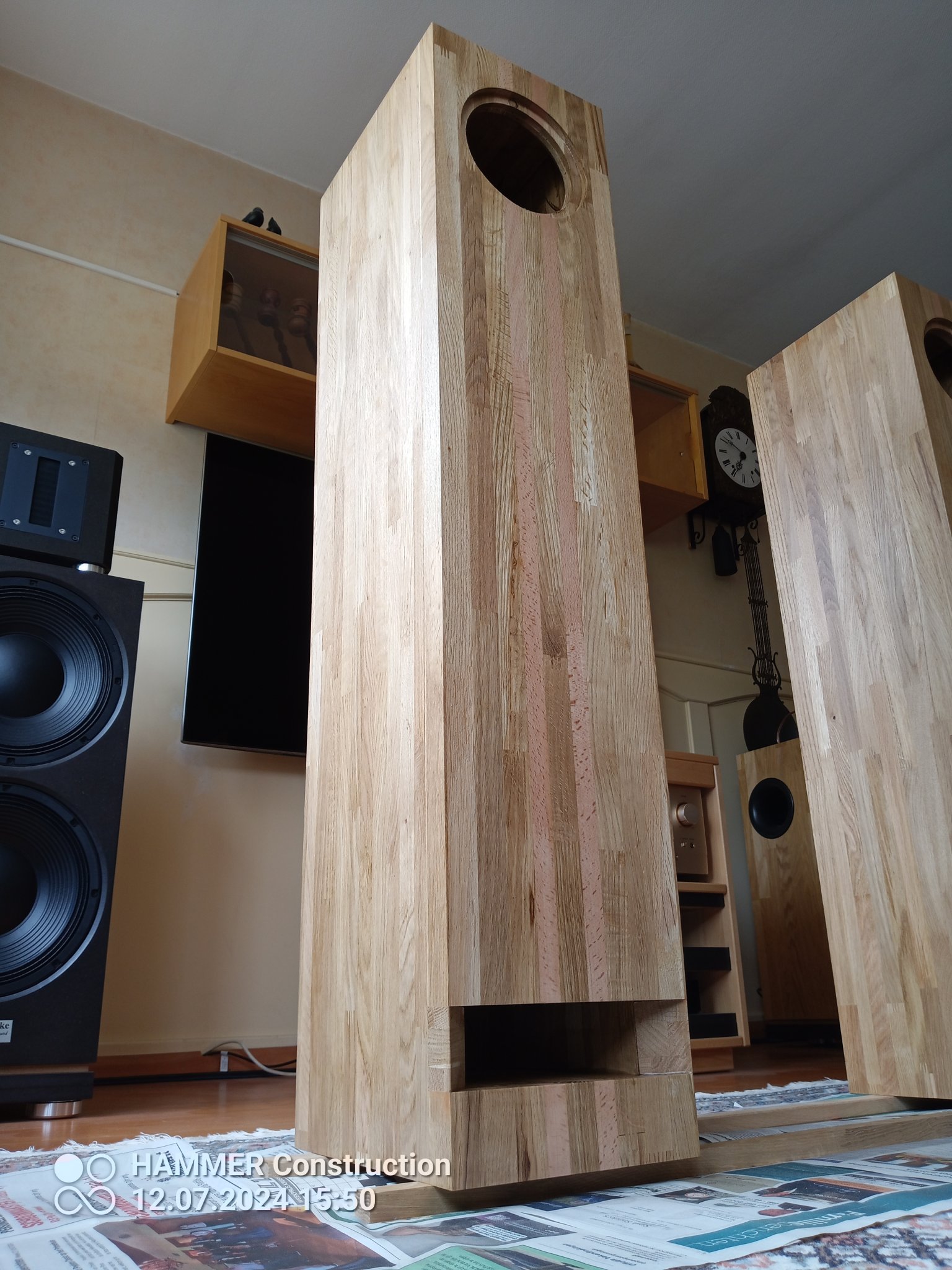

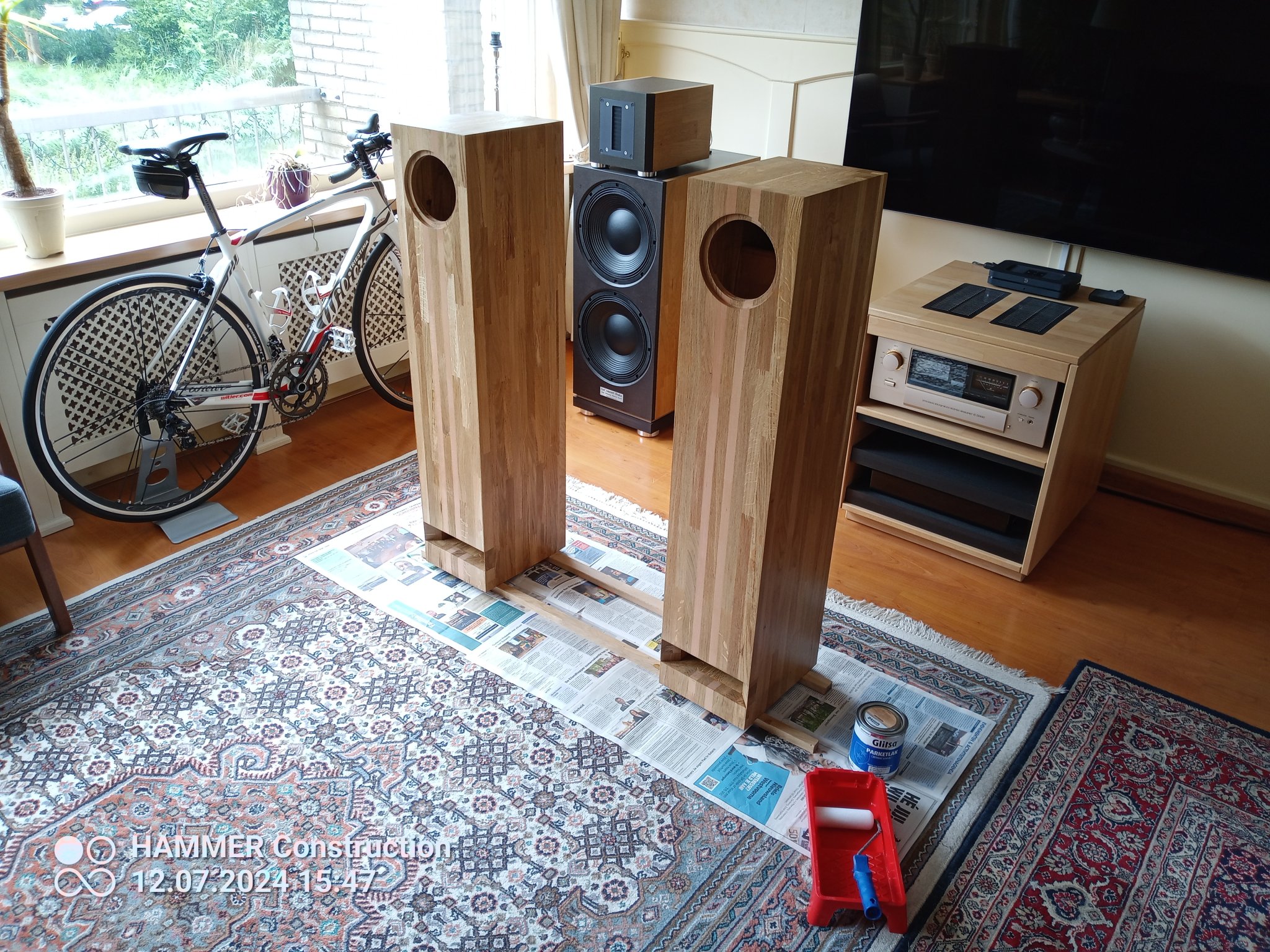

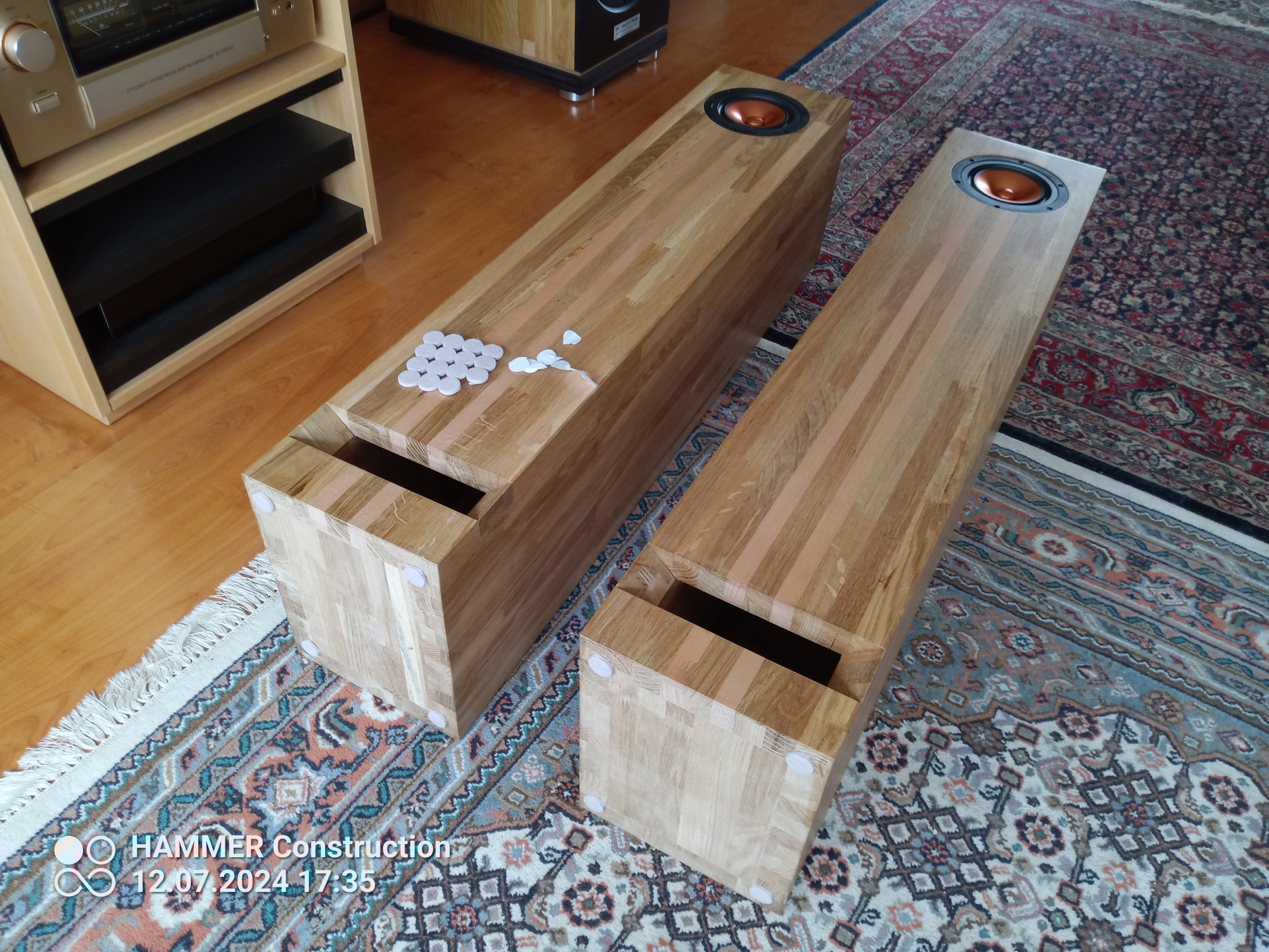

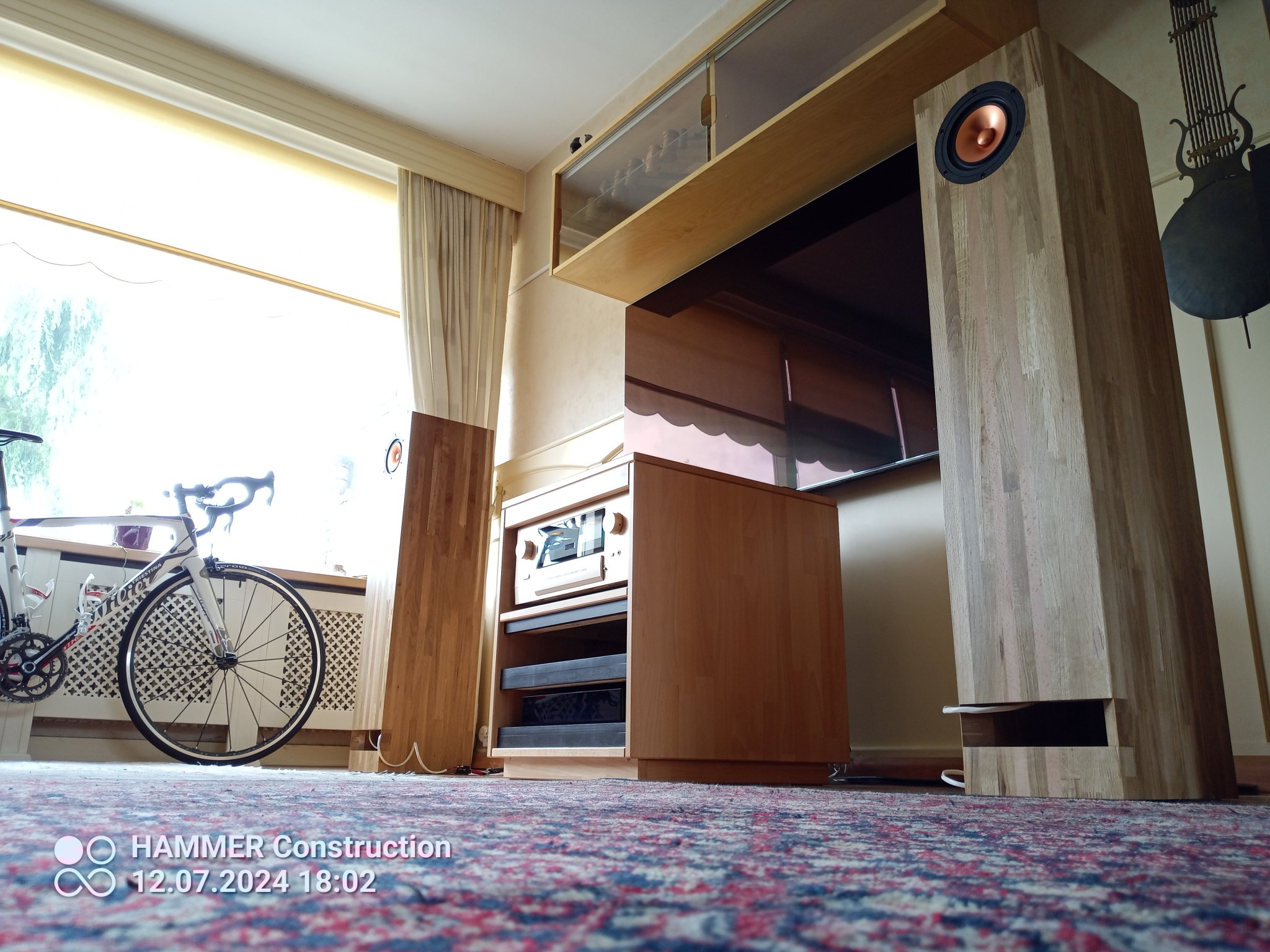

Part 1 of 2.

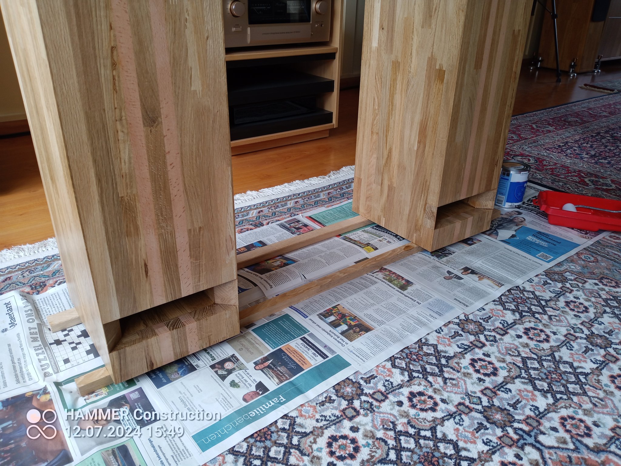

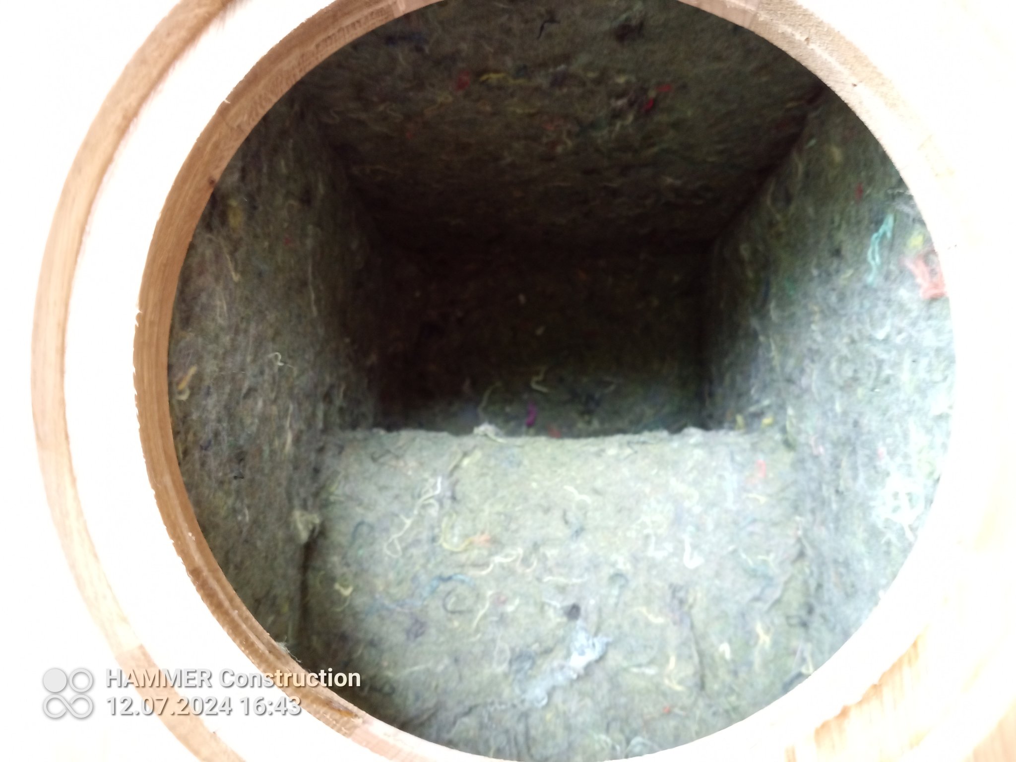

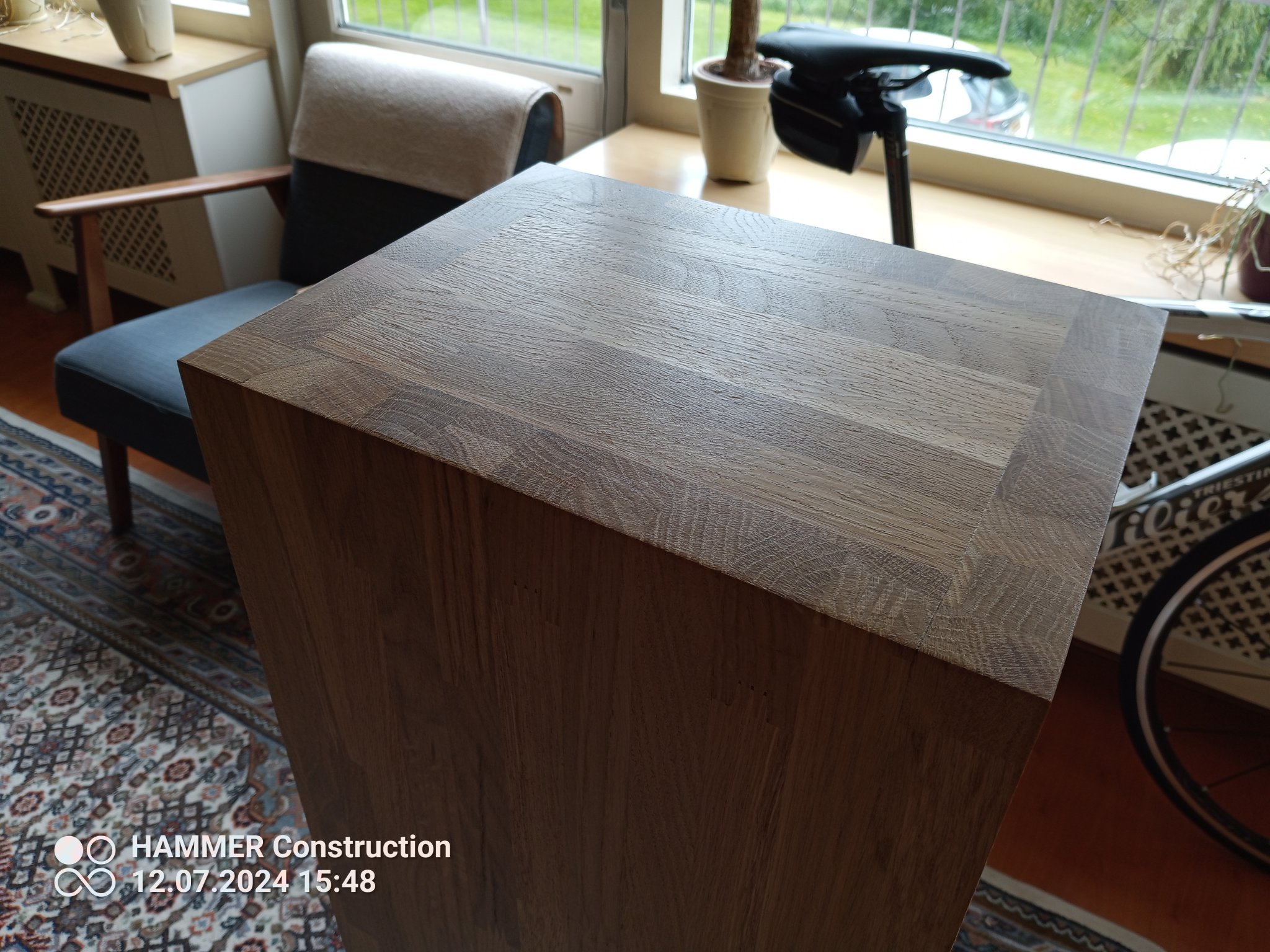

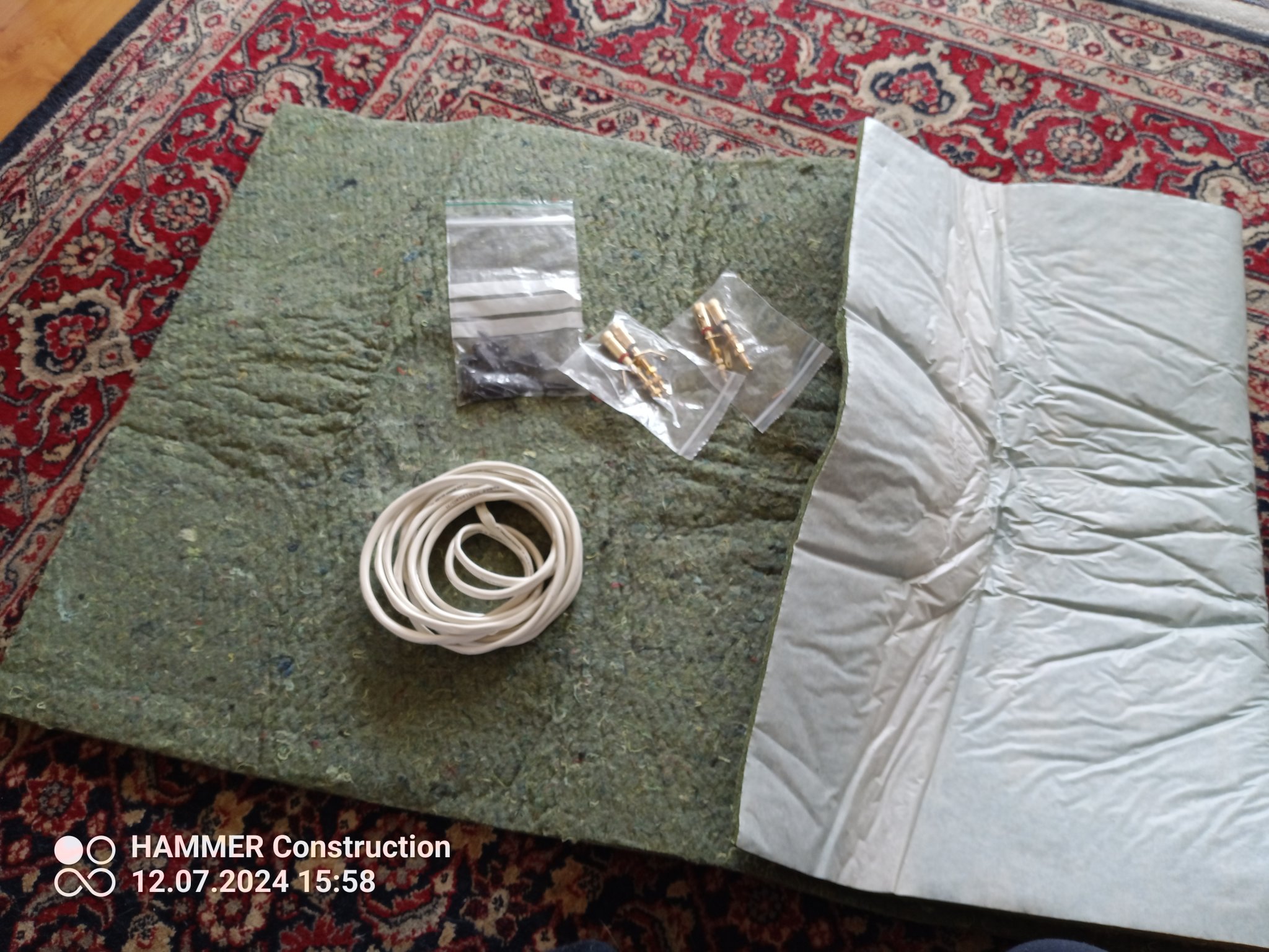

Today, after my short vacation, I sanded (120) the cabinets after the first layer and added the second final layer of coating.
This is enough for protecting the massive Oak Wood.

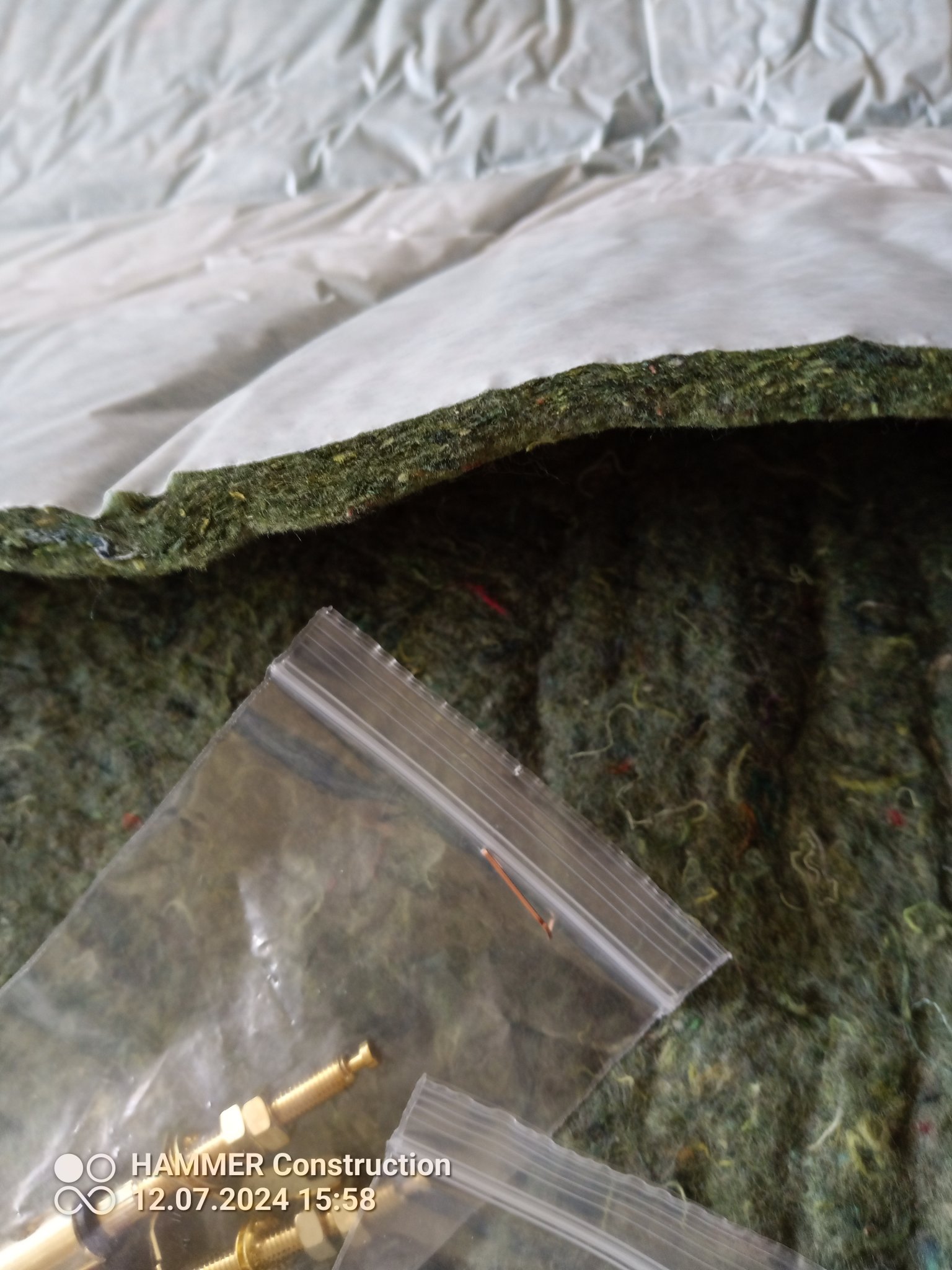

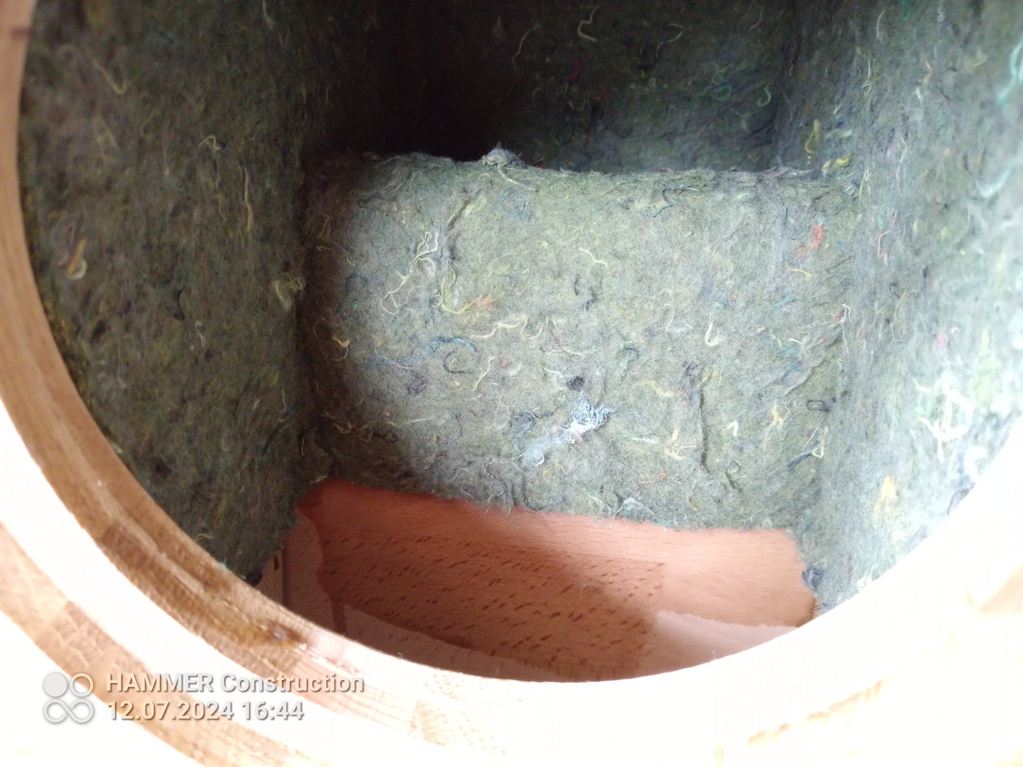

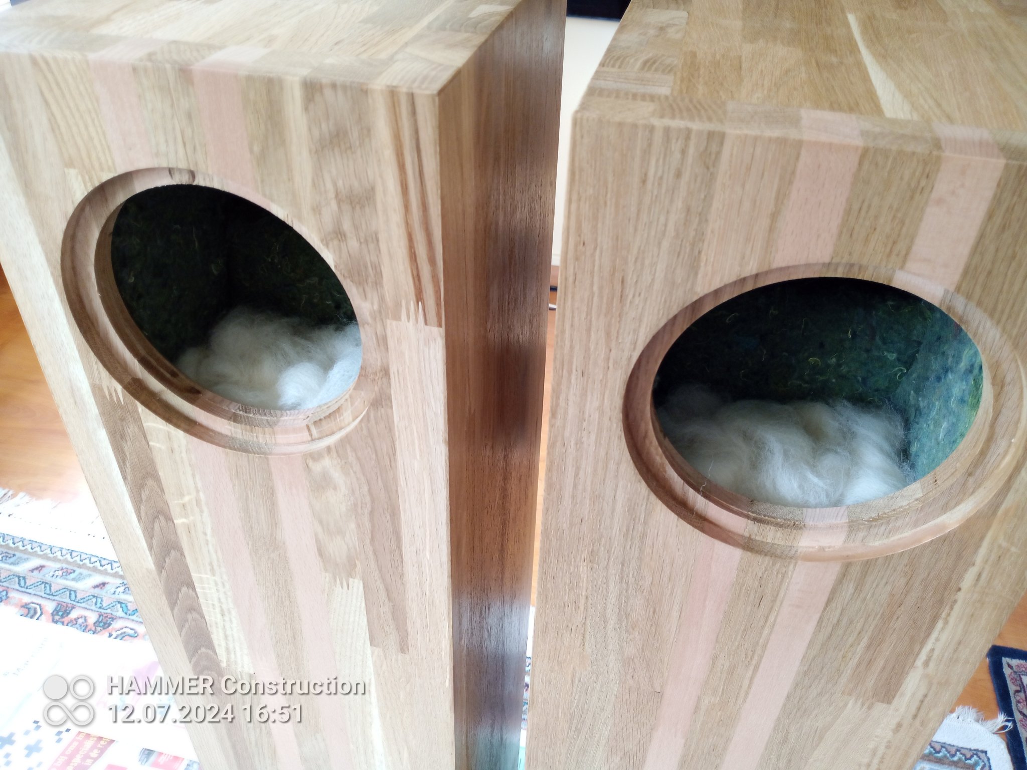

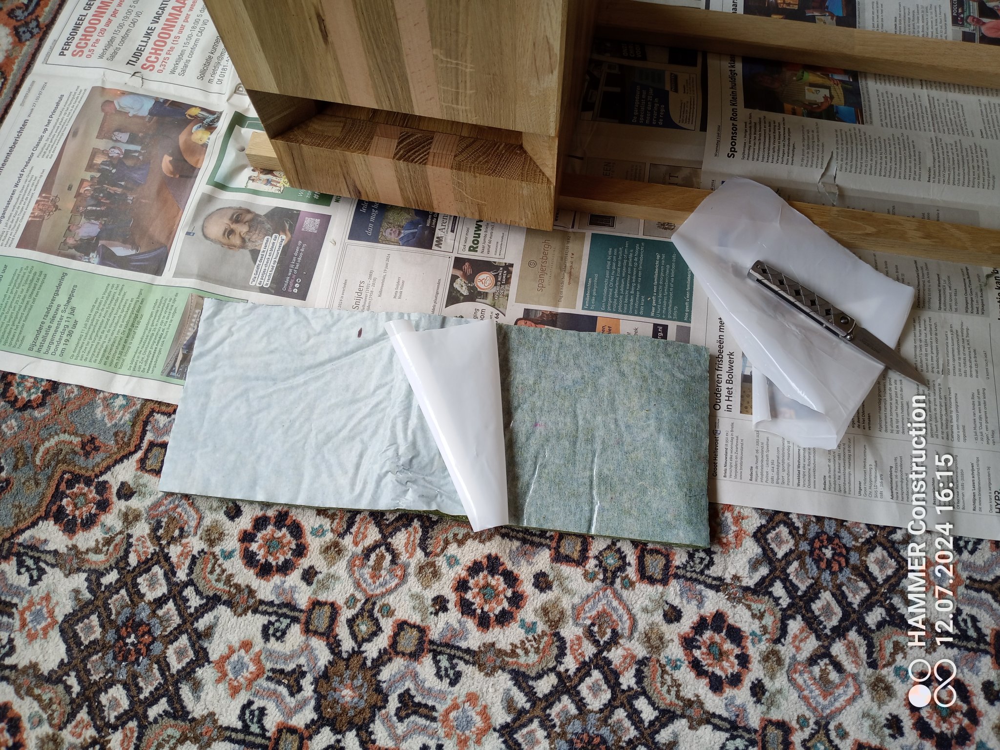

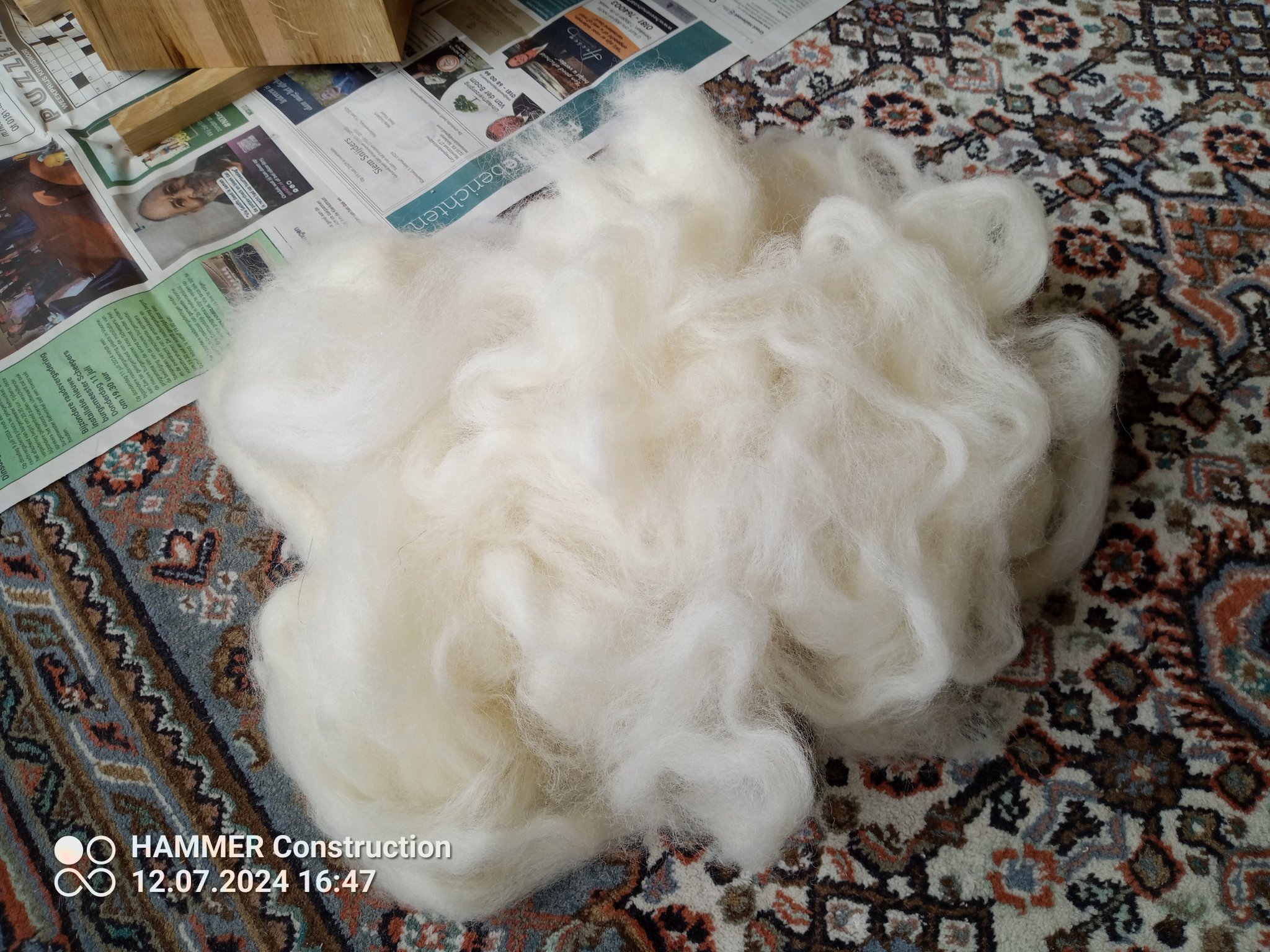

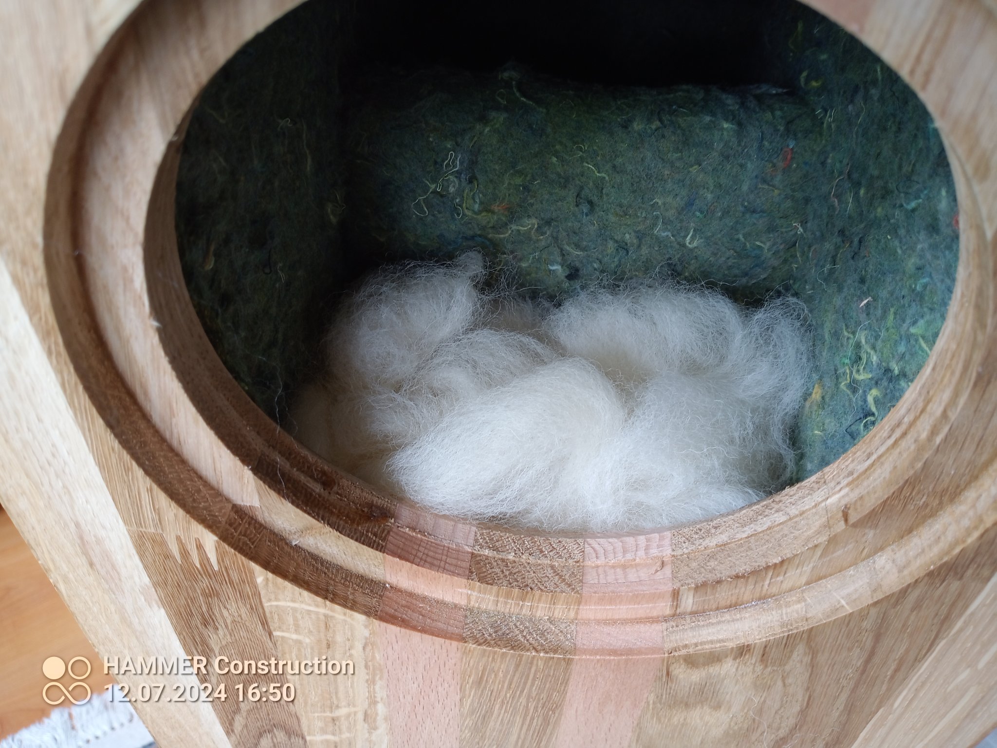

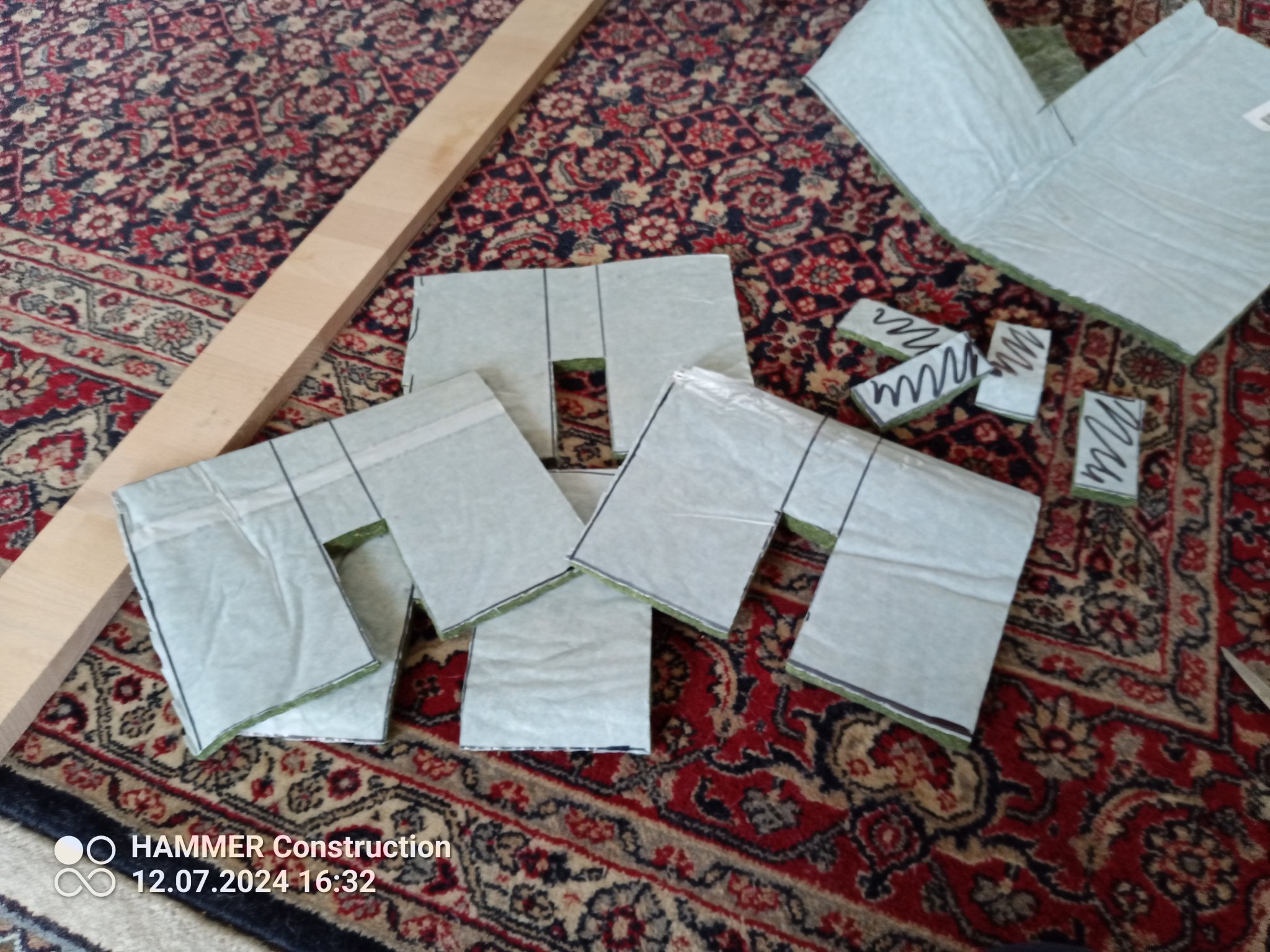

Also I added the damping materials, self-adhesive Damping 10 and Long Hair Wool.
Not that much Wool as you can see on the picture but enough for performing the first test.

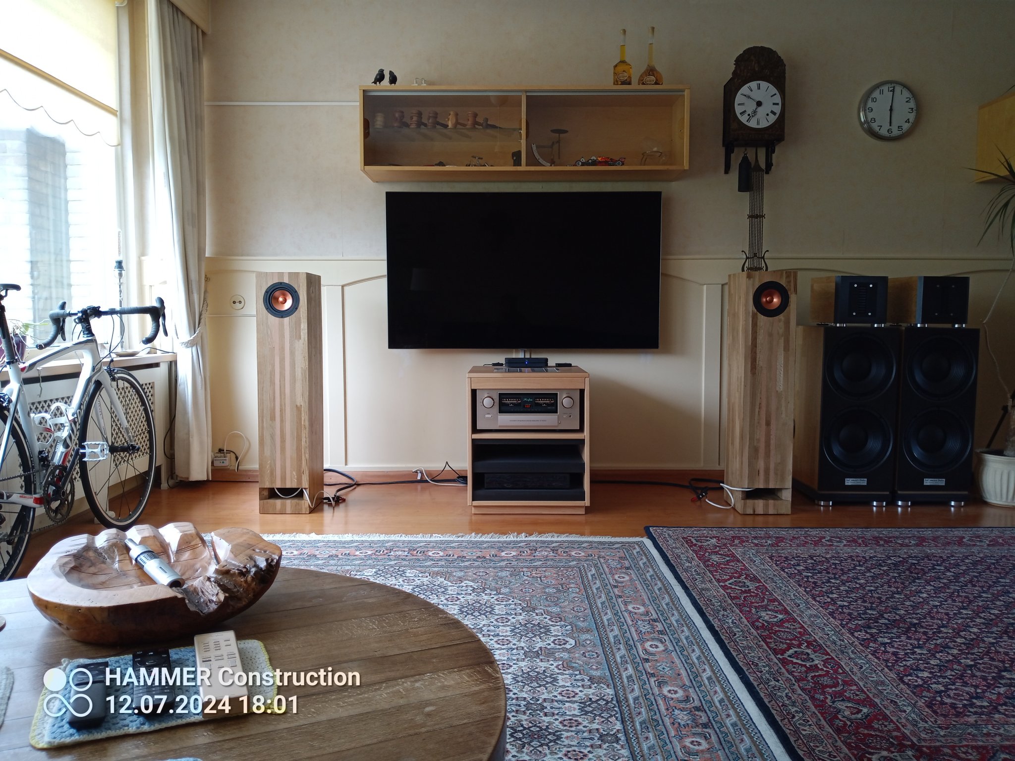

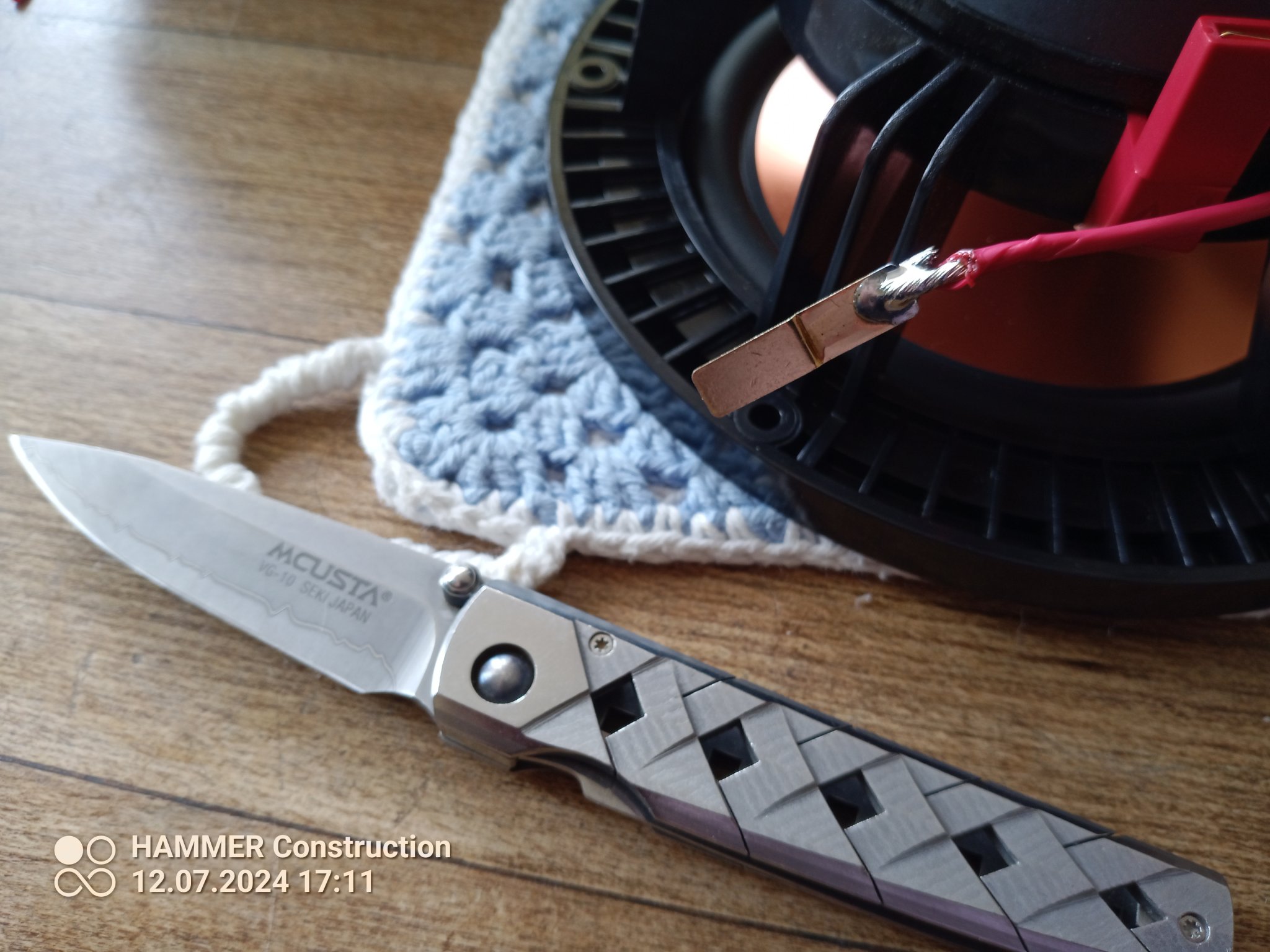

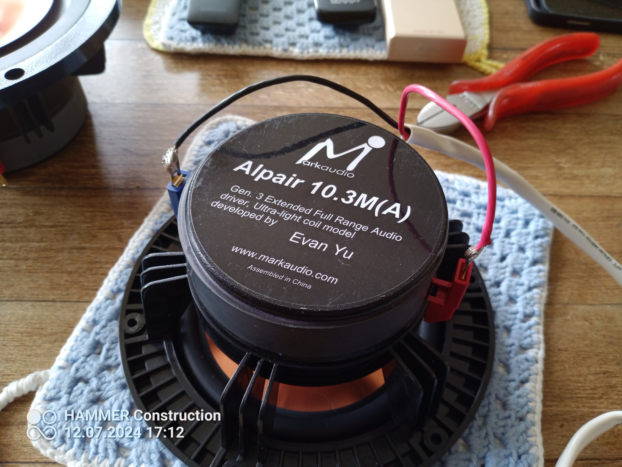

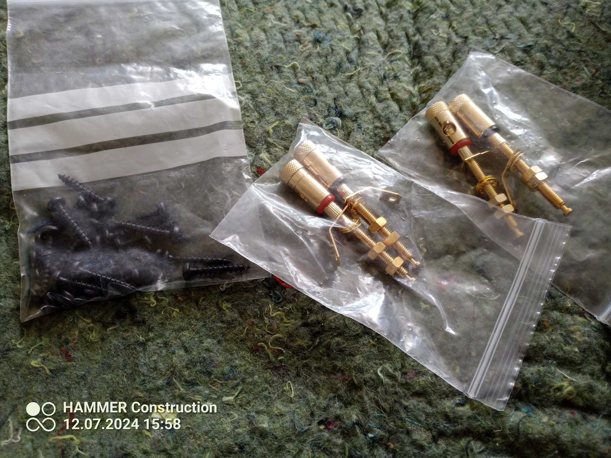

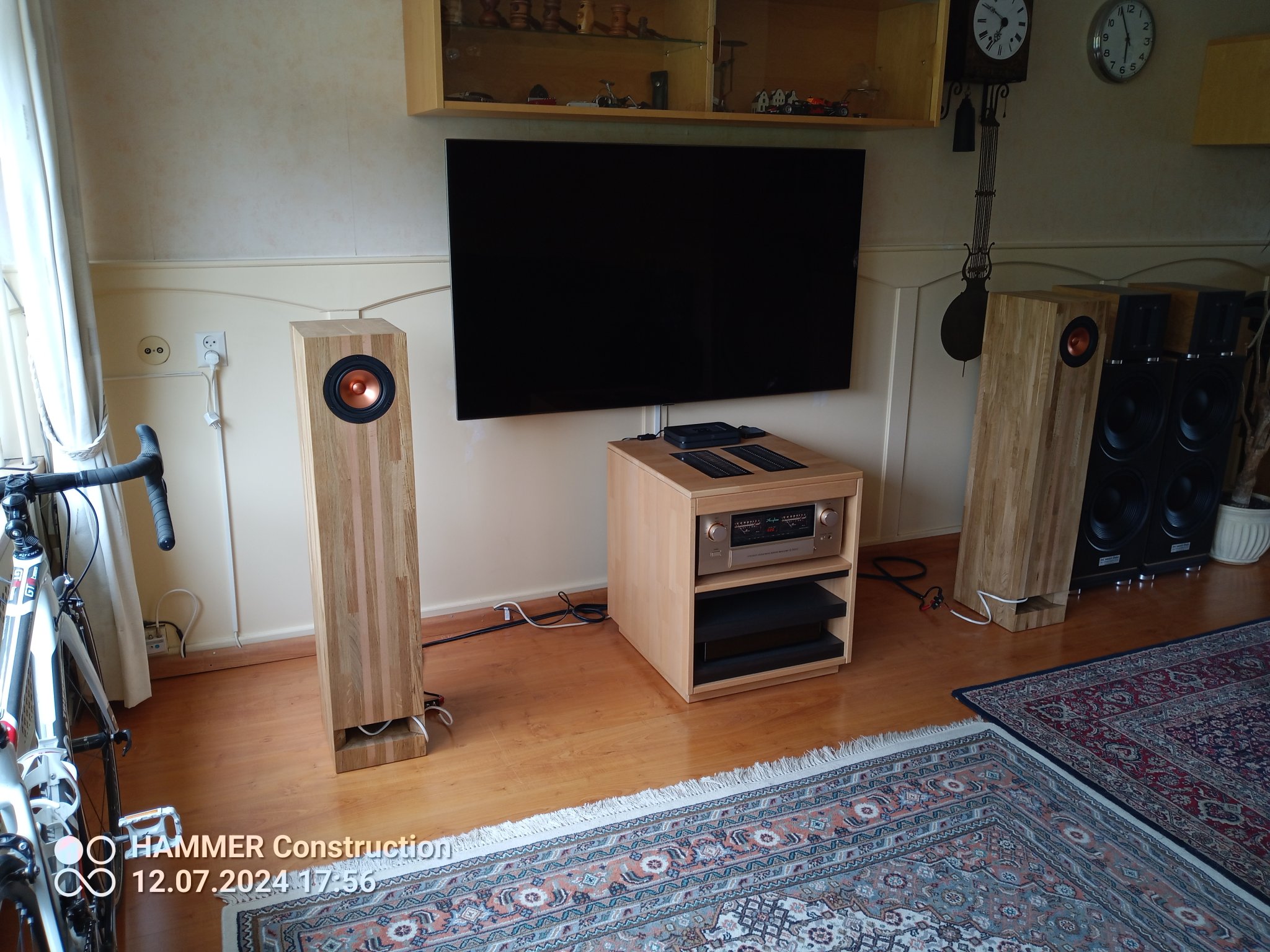

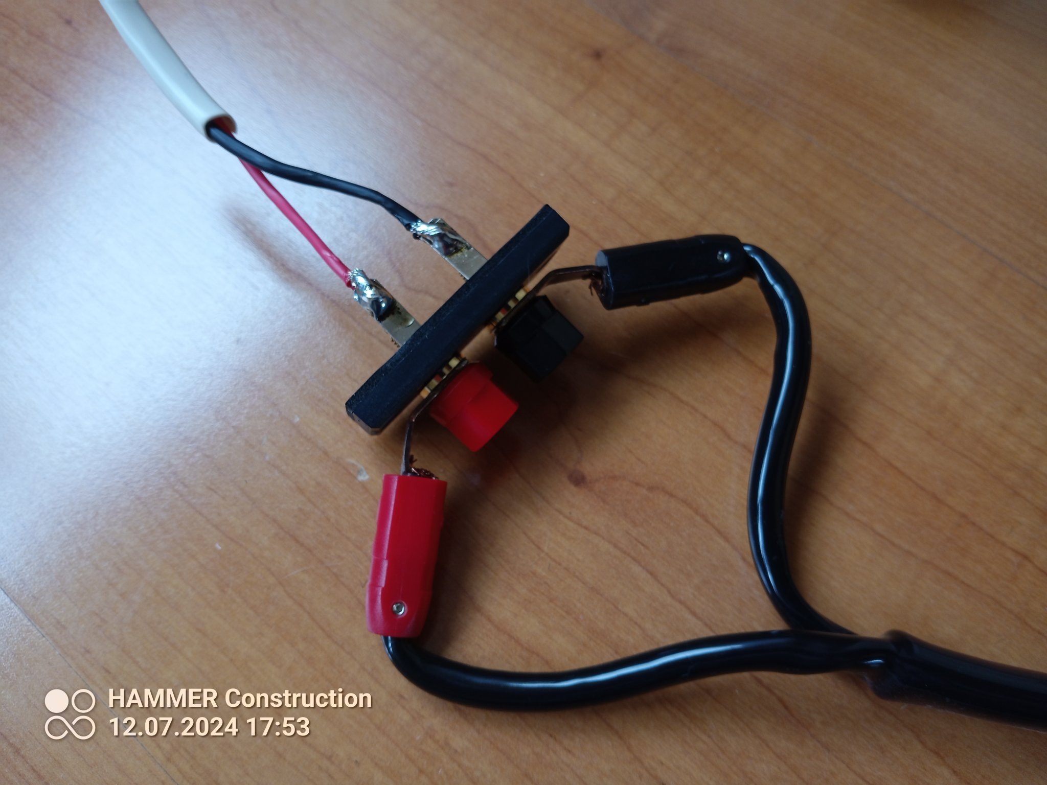

Internal cabling (OFC) (Oxygen Free Copper) also according what I mentioned before.

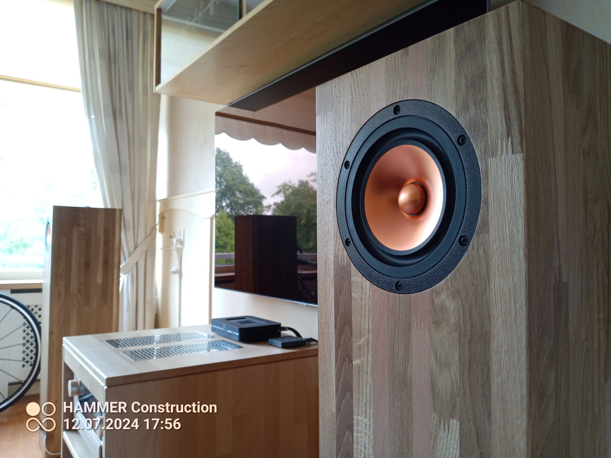

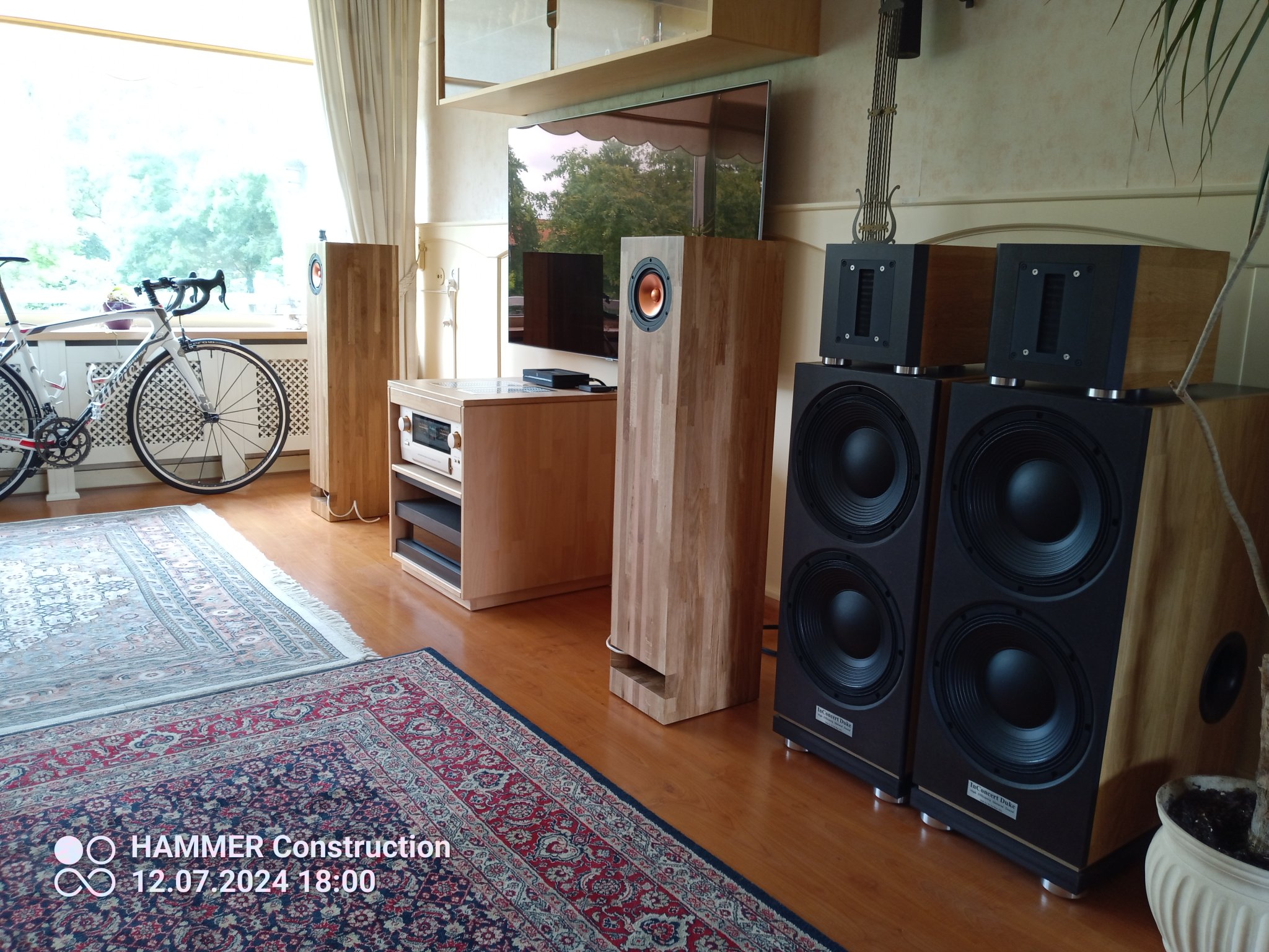

Now playing with temporarily terminals, perfect for testing.

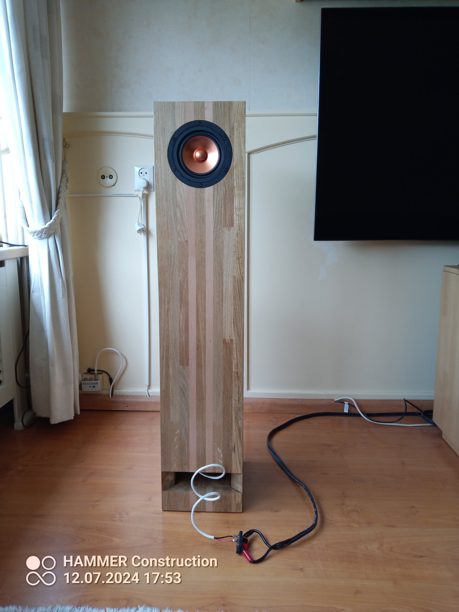

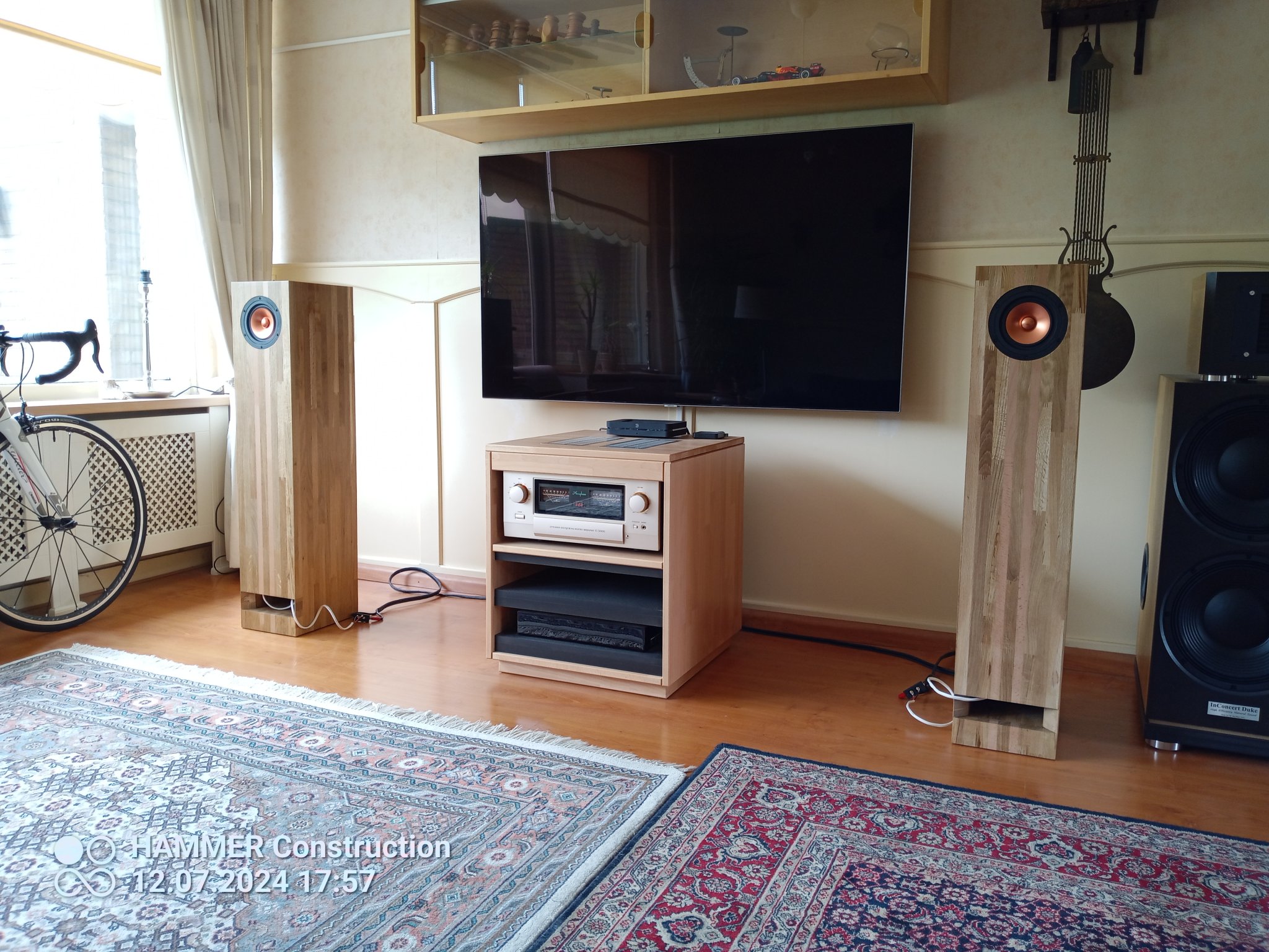

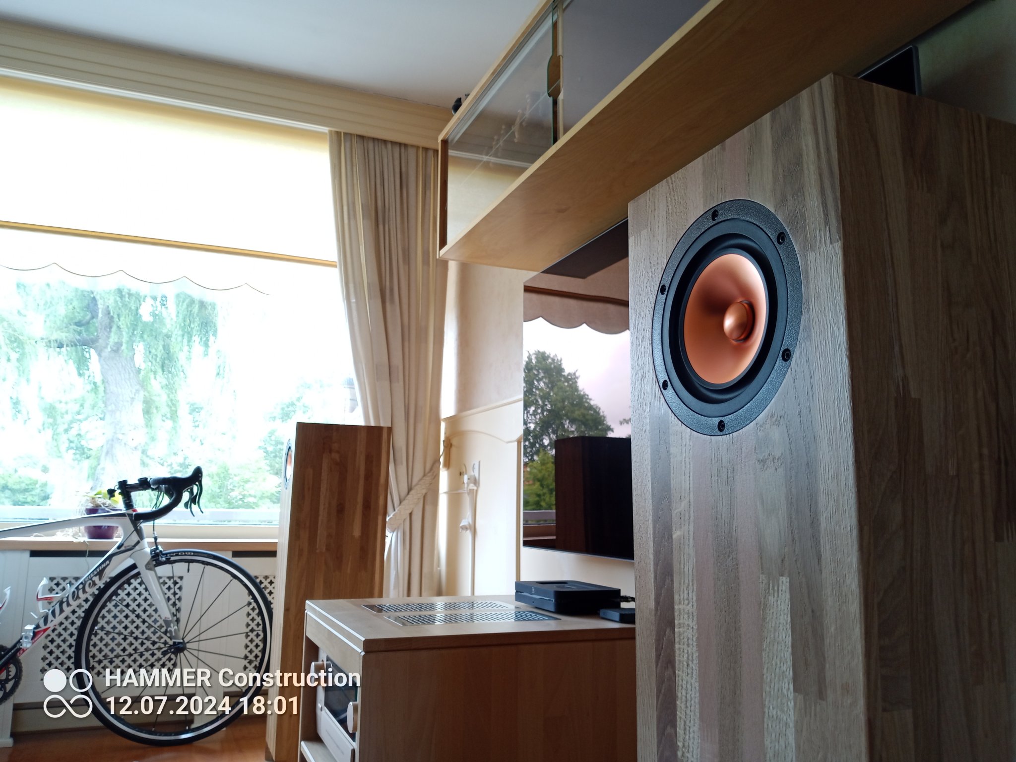

Not bad at all! Nice!
Let them play a couple of weekends and we will see.
Next step installing the final terminals, finishing the adjustable stands.
Very happy with the results! 👌 😍😍.

I always use removable binding post cups. Makes it a whole lot easier to wire and particualrily to rewire. Also allows for low metal connecters.
I’d also use solid core 24g (ish) wire for internal hookup. And i have a box of those MA slide in connectors. Solder the wire direct to the driver.
dave

Superior speakers with the 10.3! @ just 2 hours of listening!
You can build this speaker yourself and enjoy listening to it!
And i suspect (strongly) that the same driver in a box actually designed for it would work even better.
