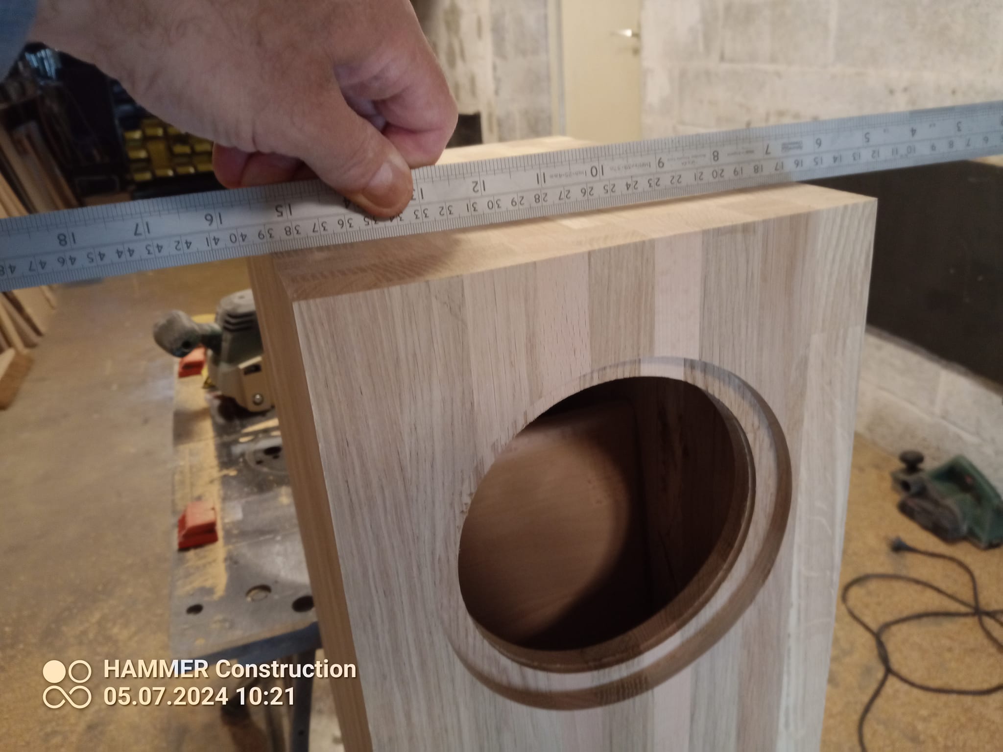

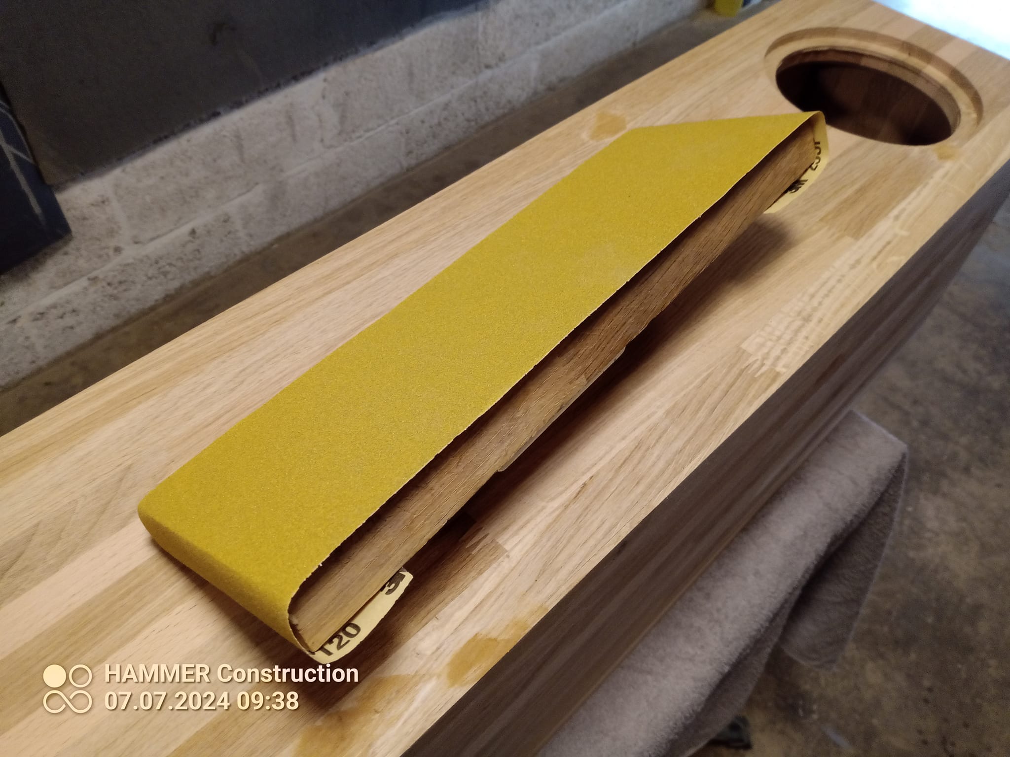

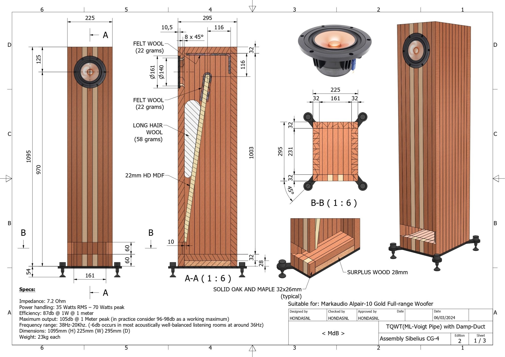

Hi Norman first try I will stuff it according the drawing.
Maybe also some felt to the side panels.

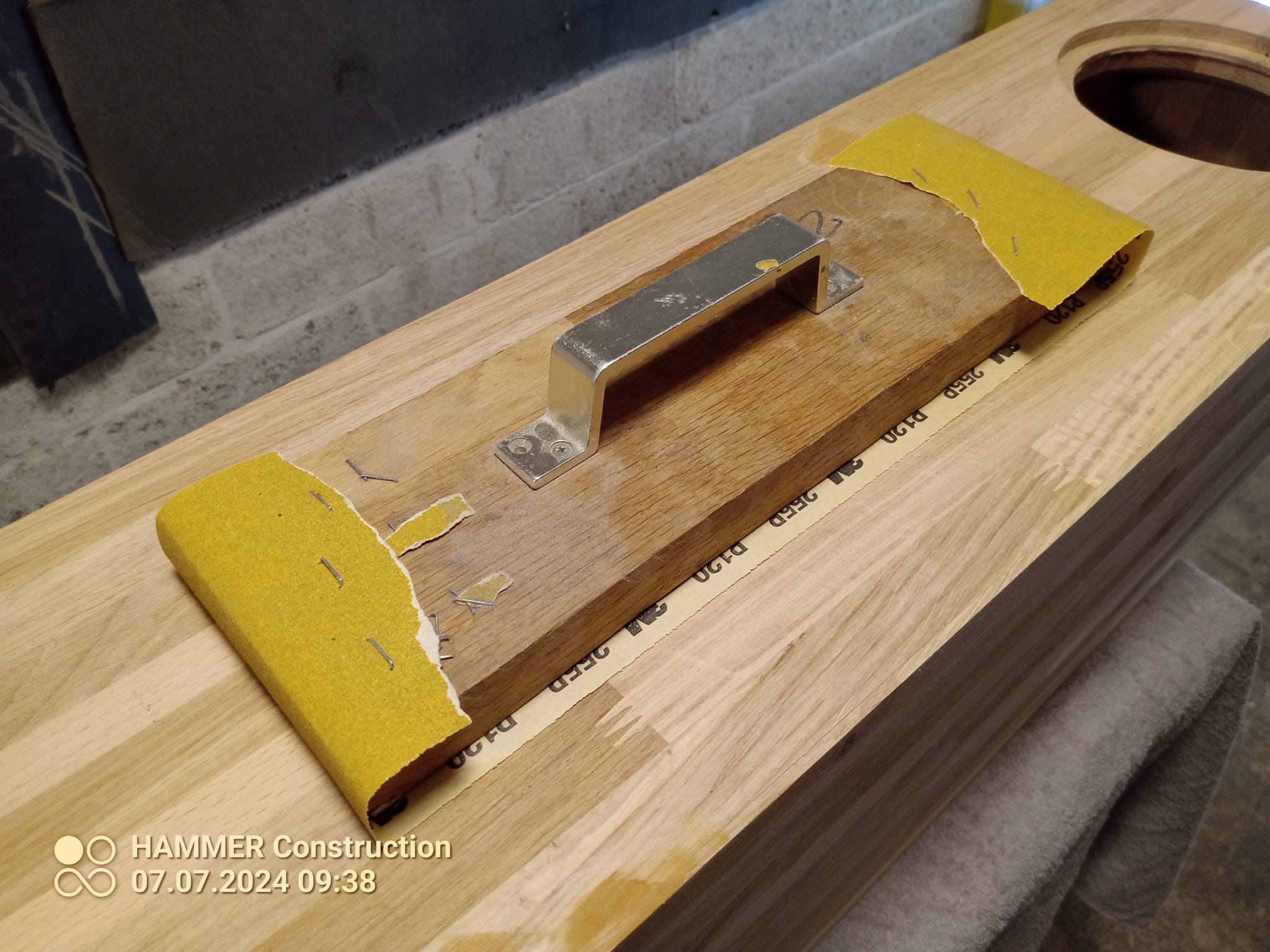

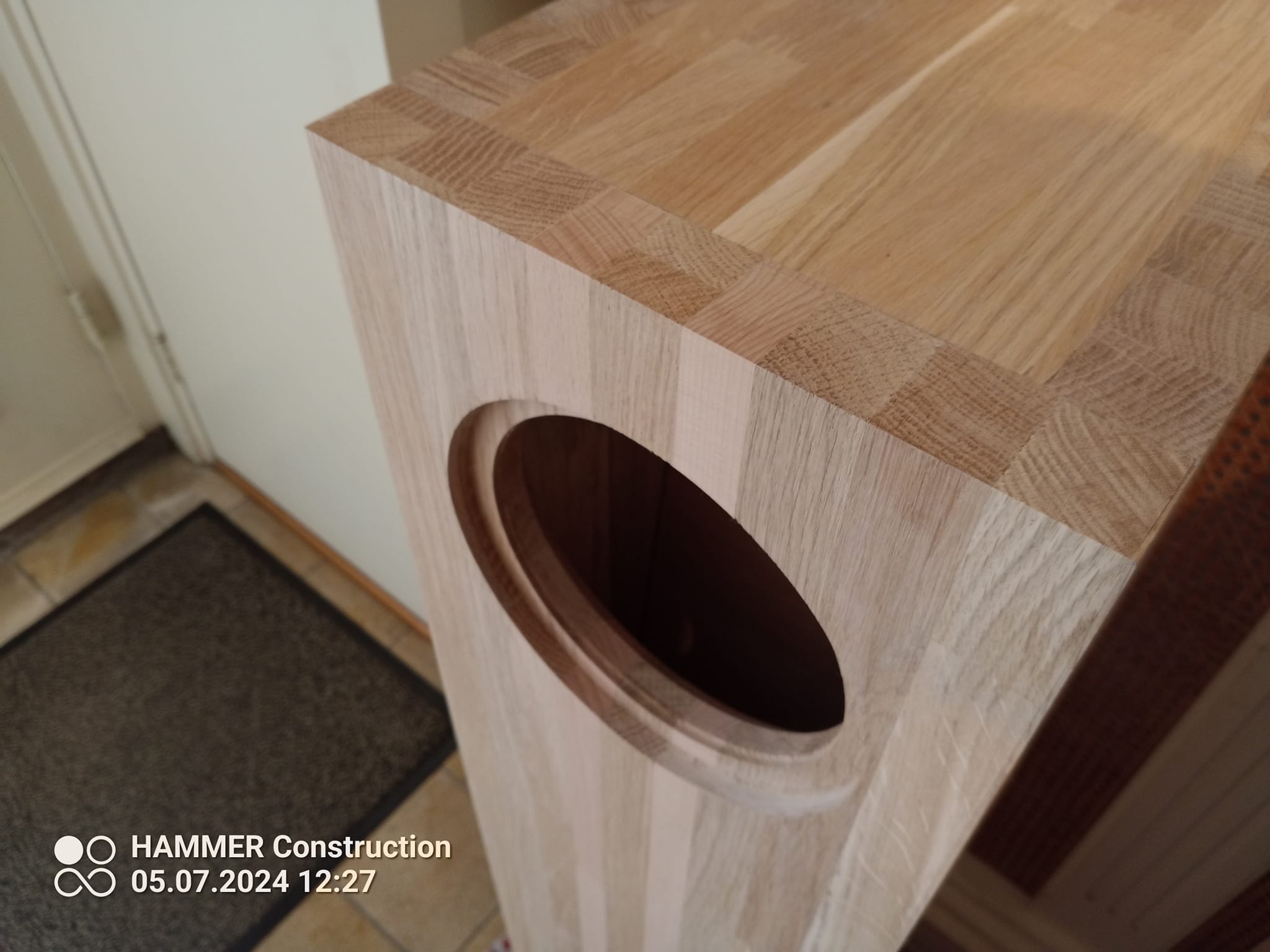

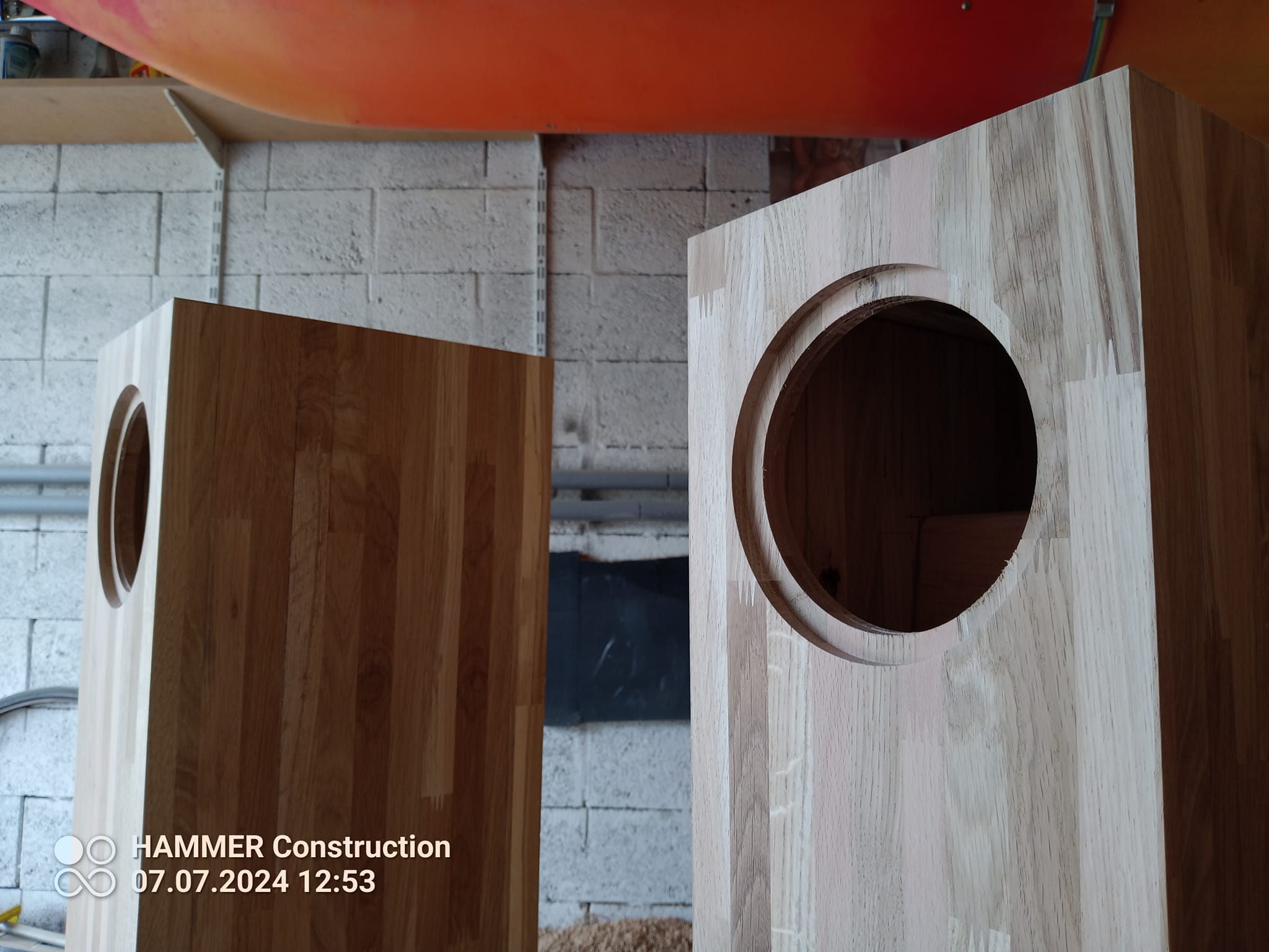

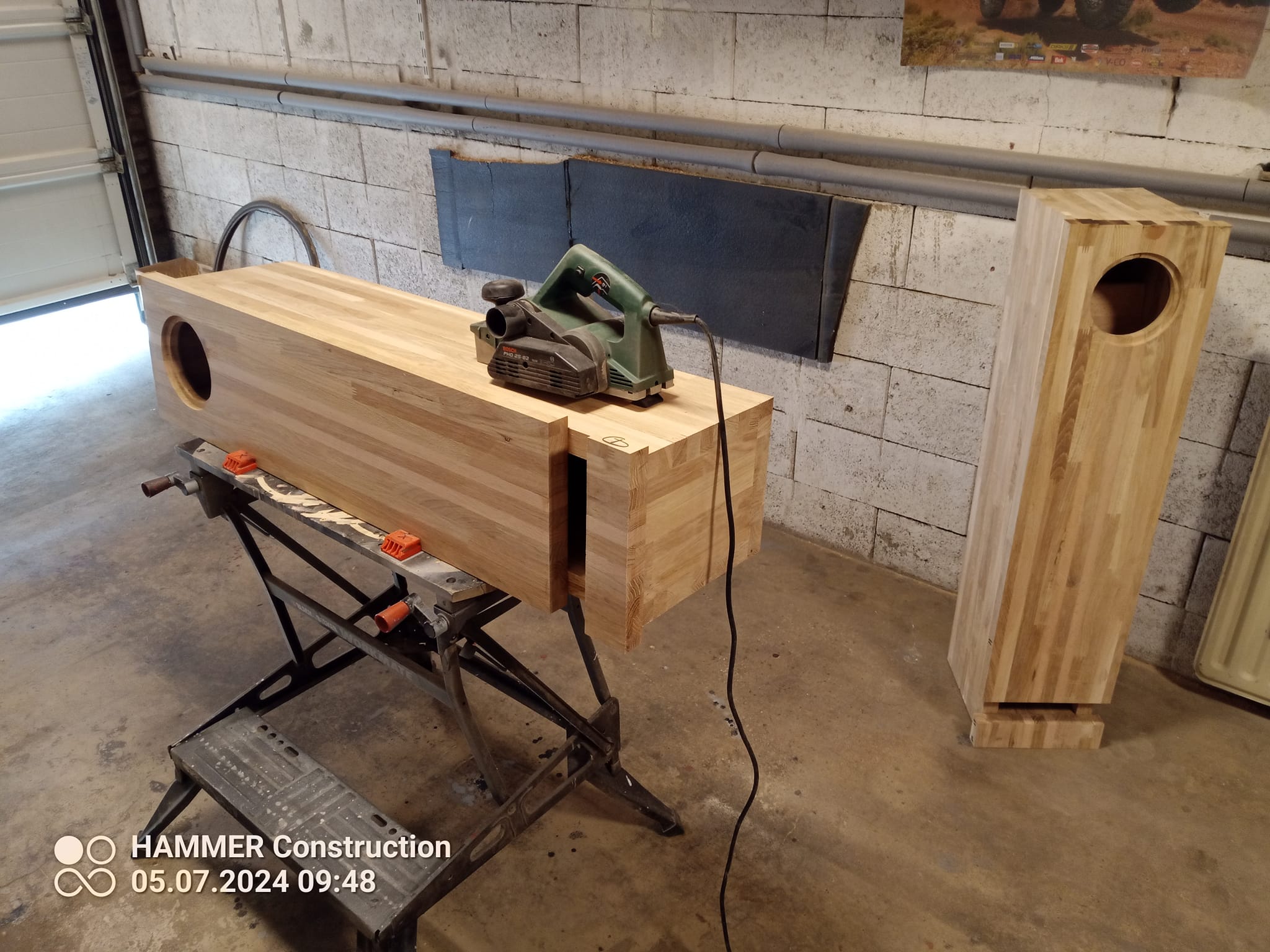

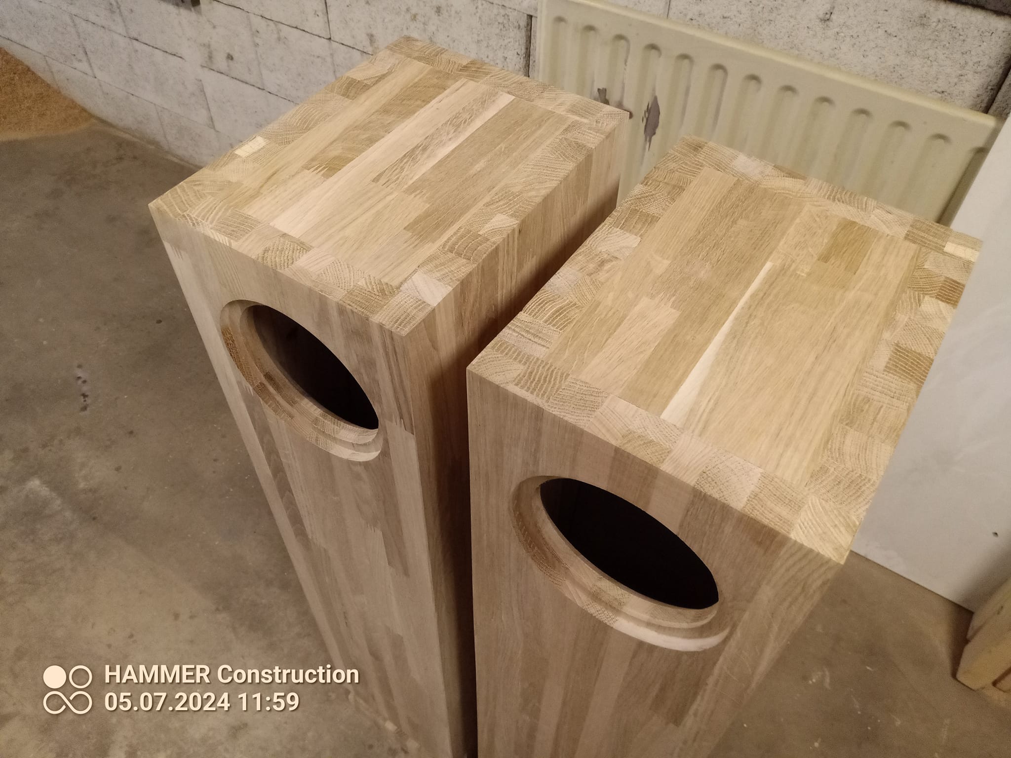

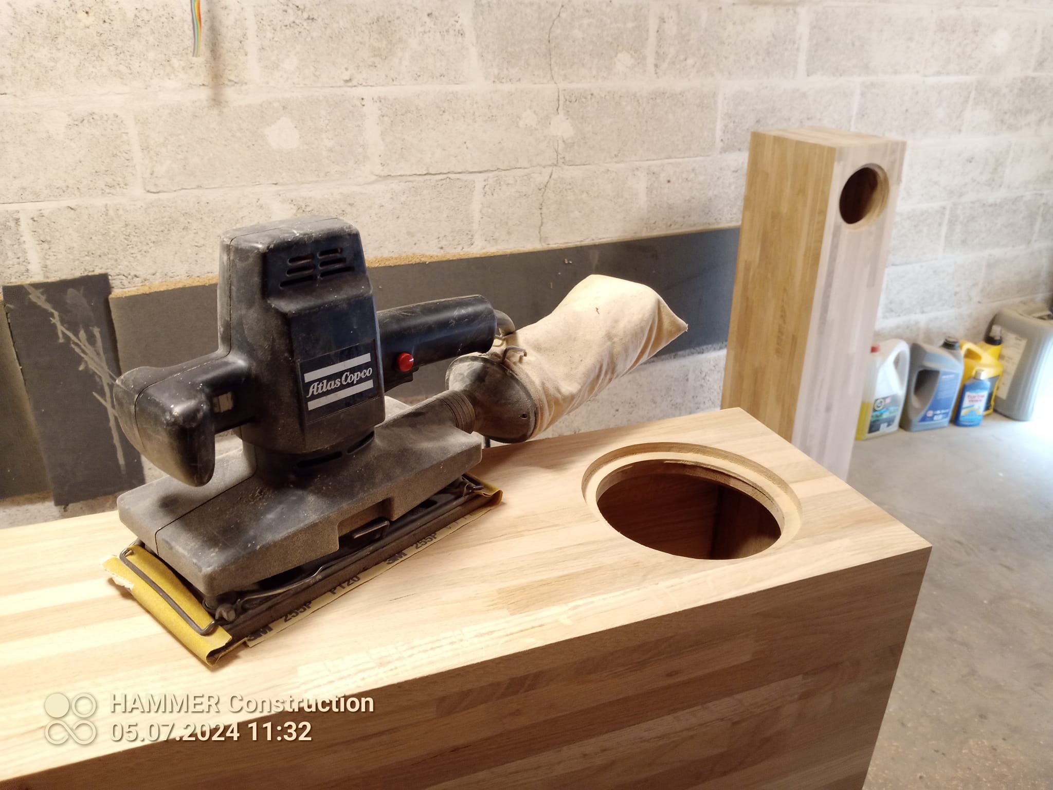

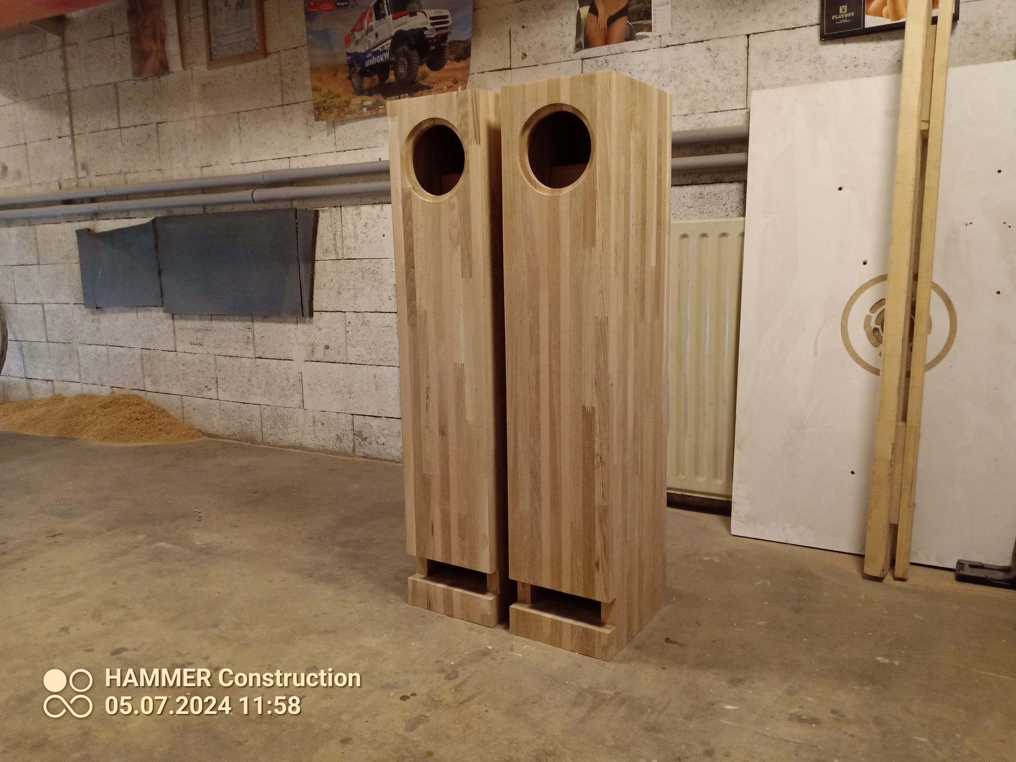

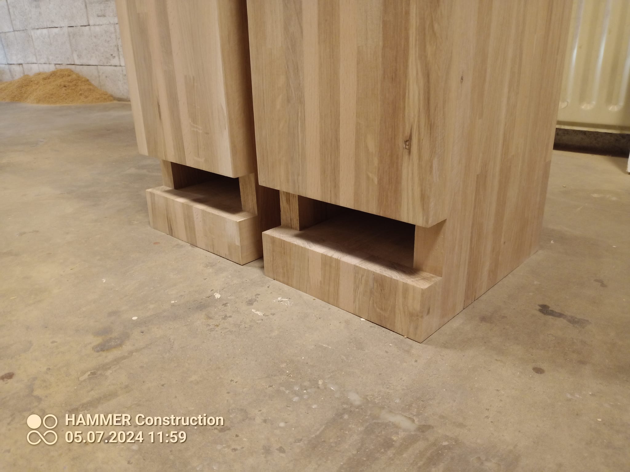

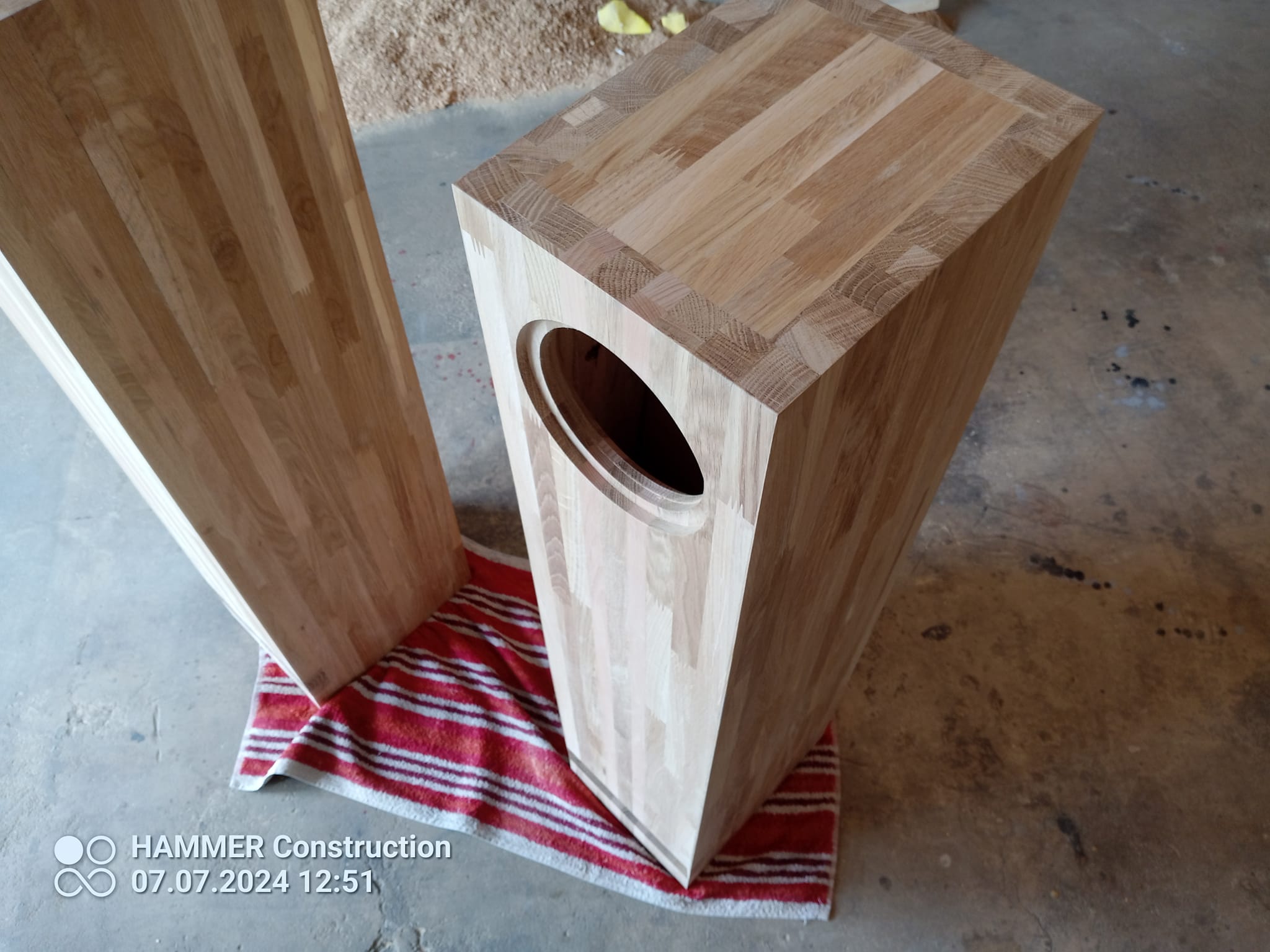

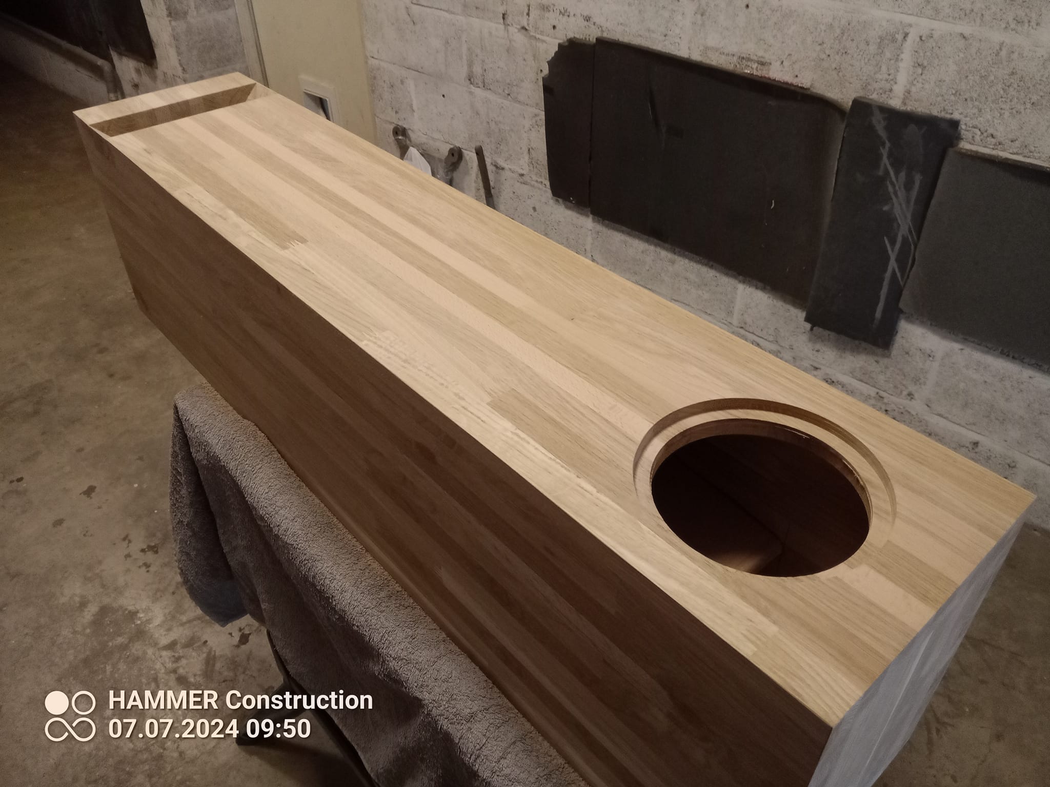

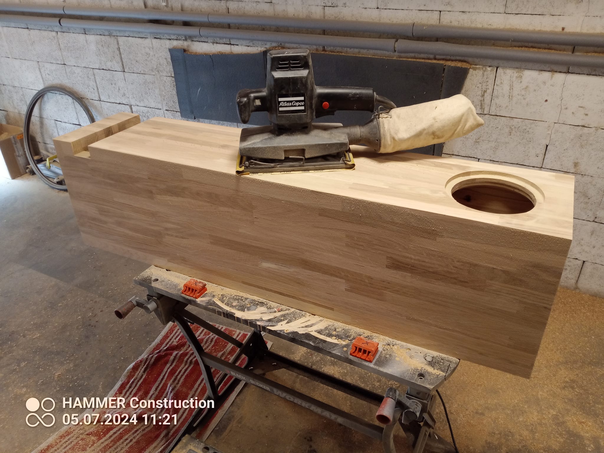

Today a very big step 👌 😍.
Now only the bevels remain.

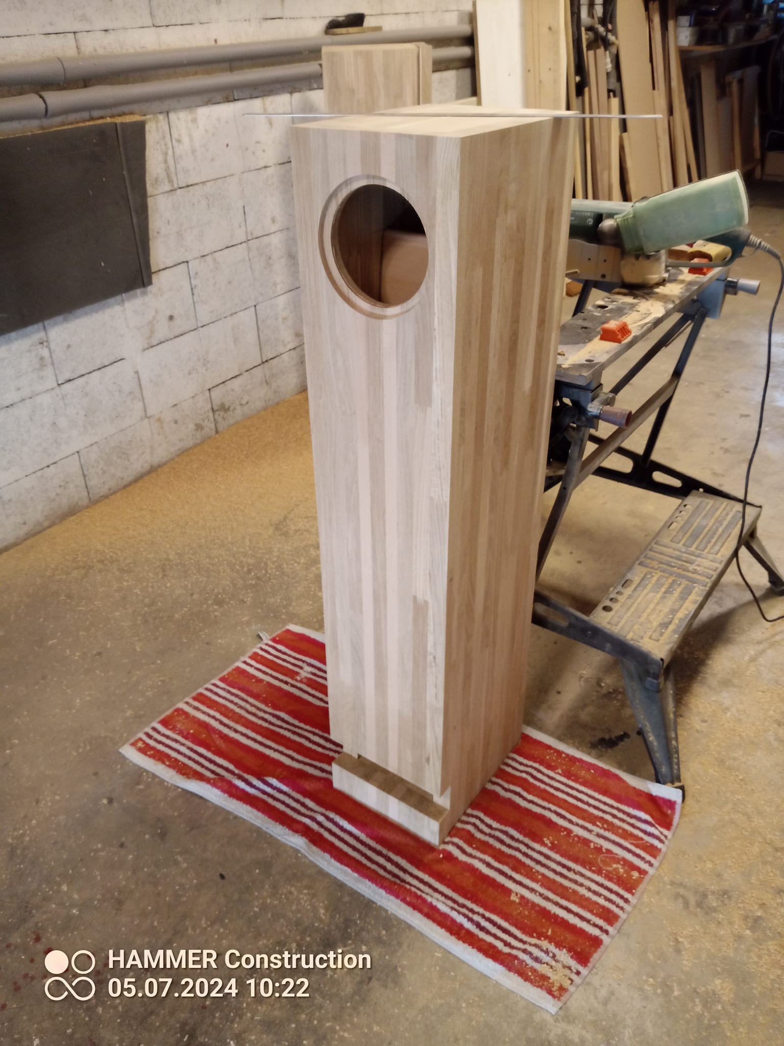

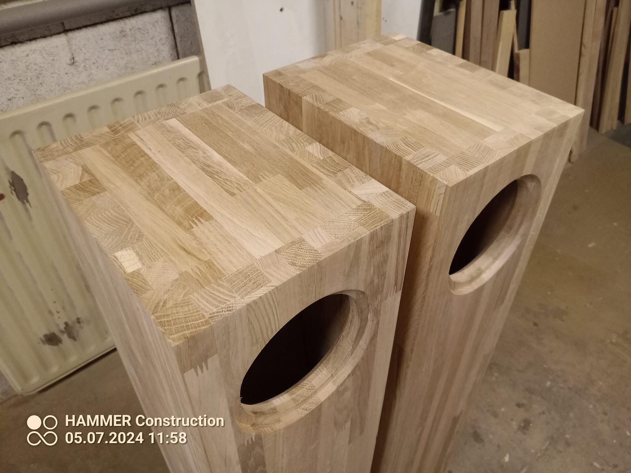

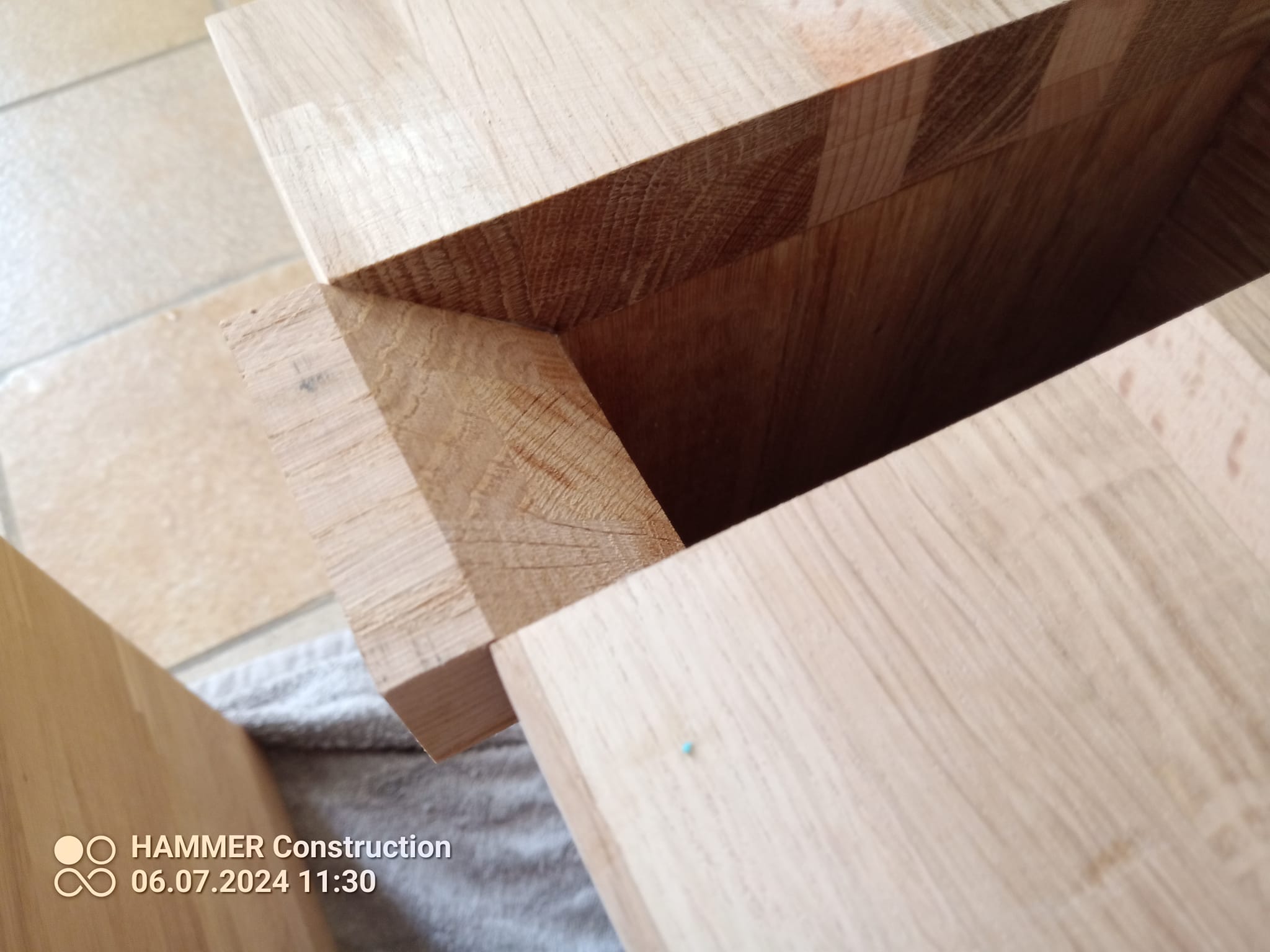

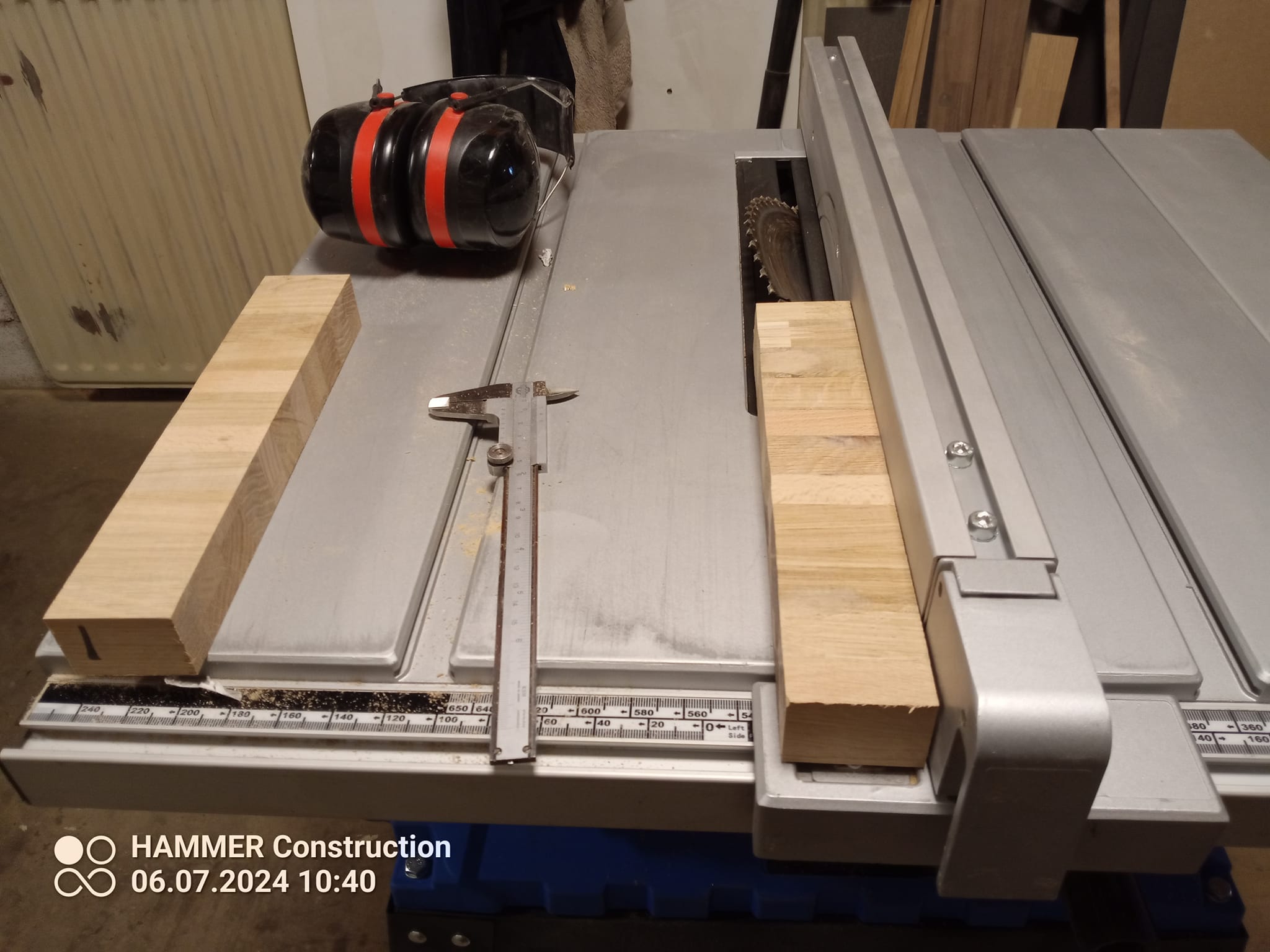

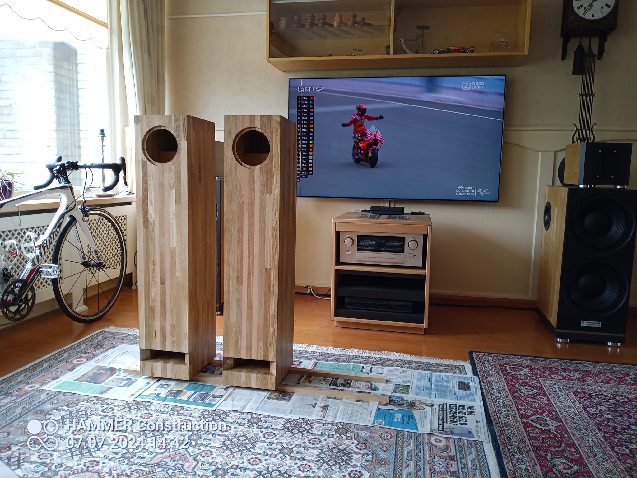

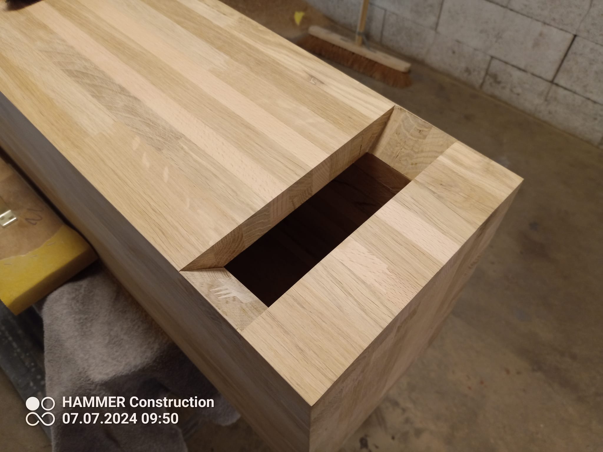

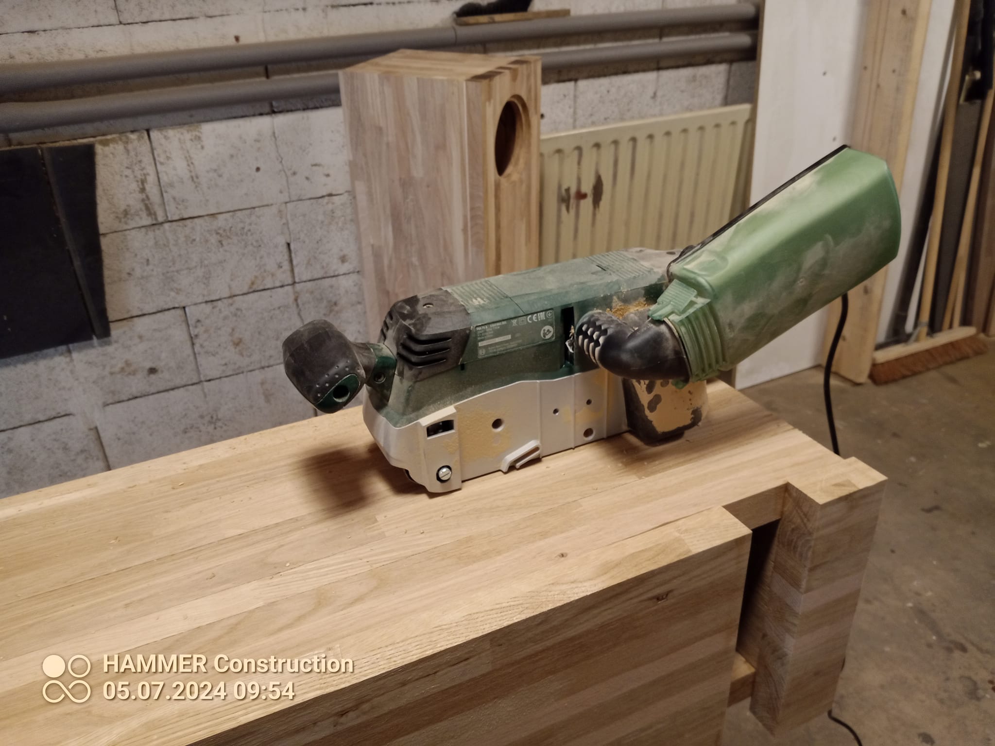

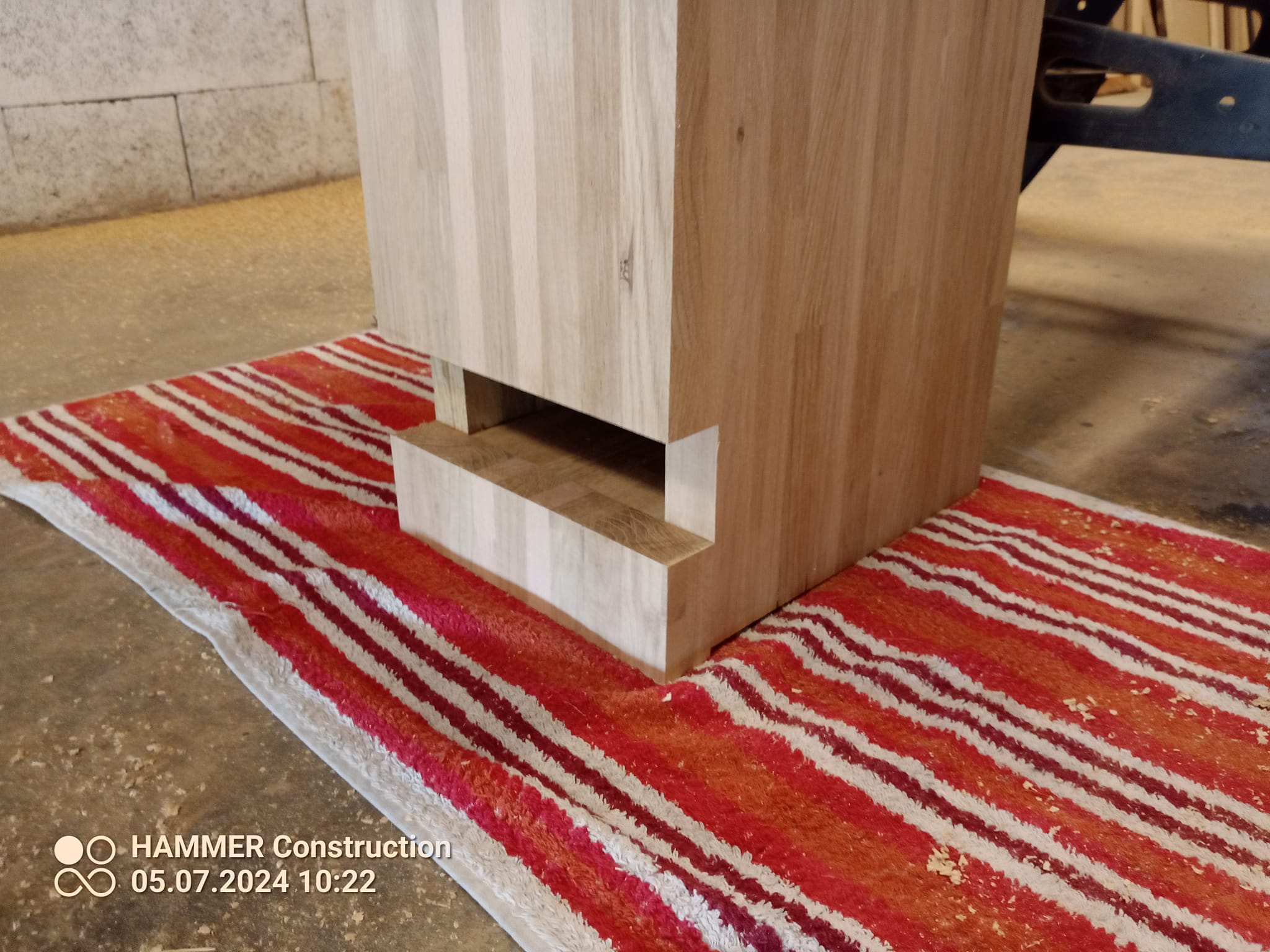

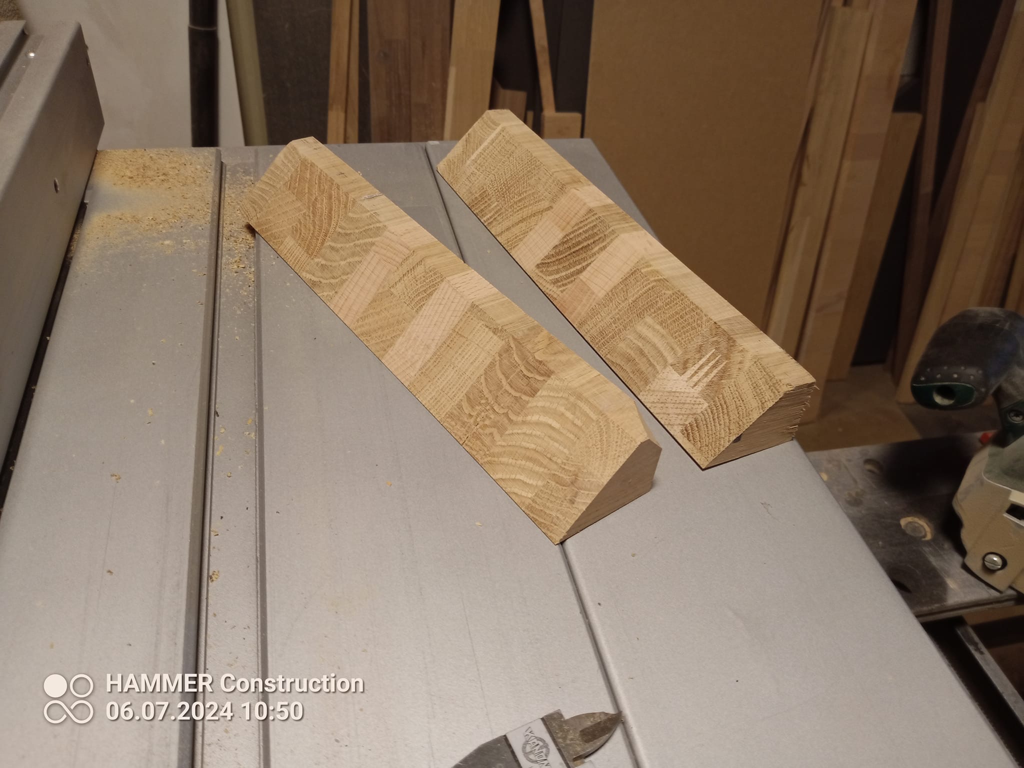

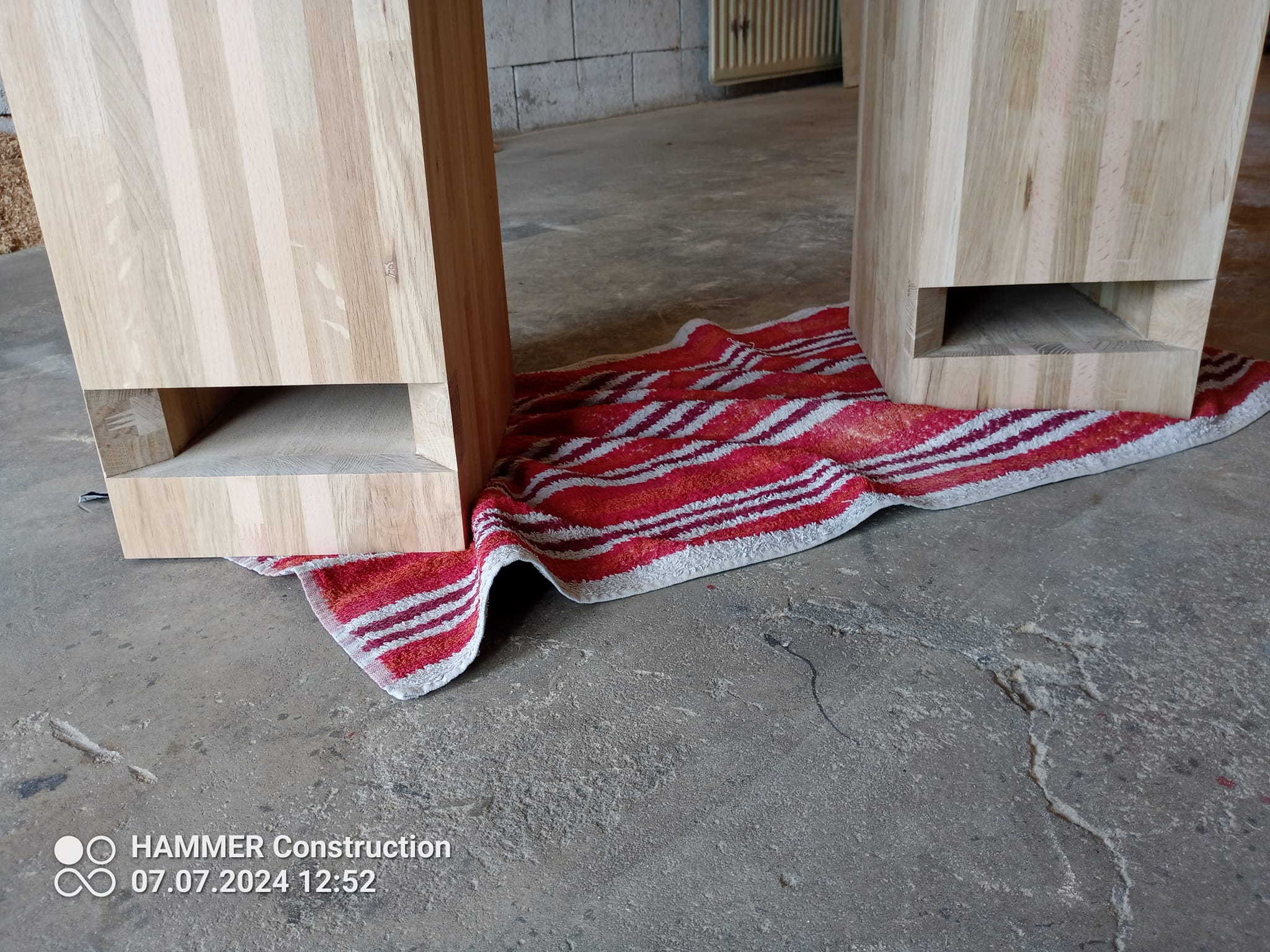

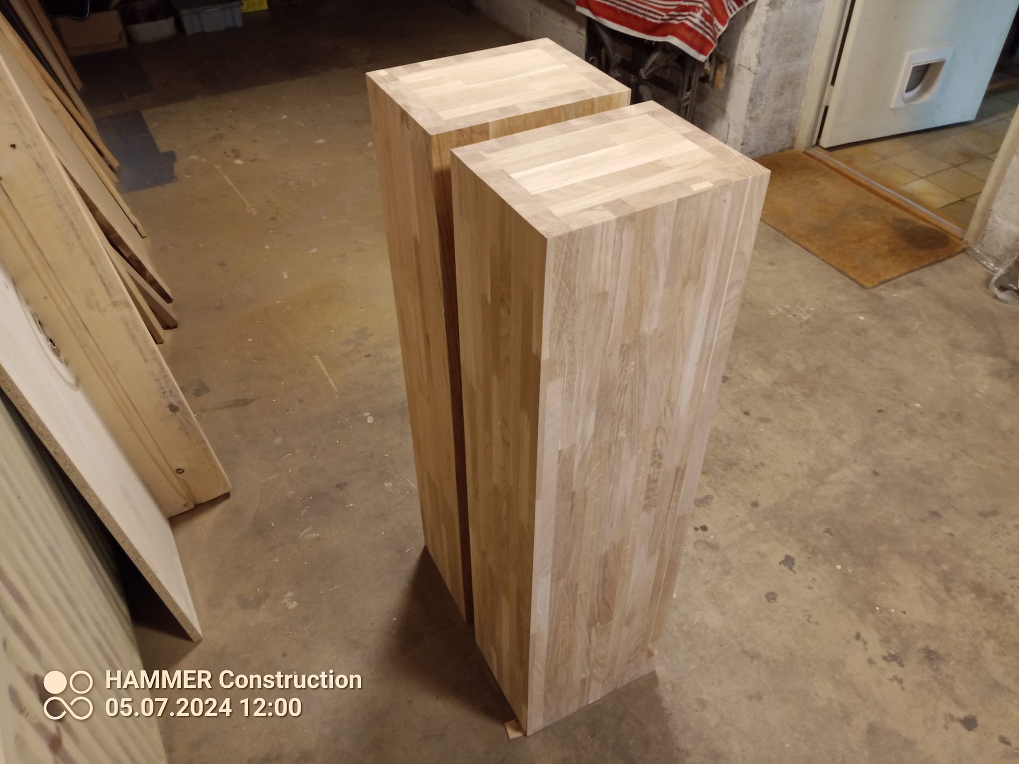

The residual wood does not go to waste. 👍 Beautiful and also especially for this a piece of end-grain wood, gives a nice effect and contrast 😍. Excessive wood will later go away flush with the adjacent panel 👌. Now let the glue dry and harden.

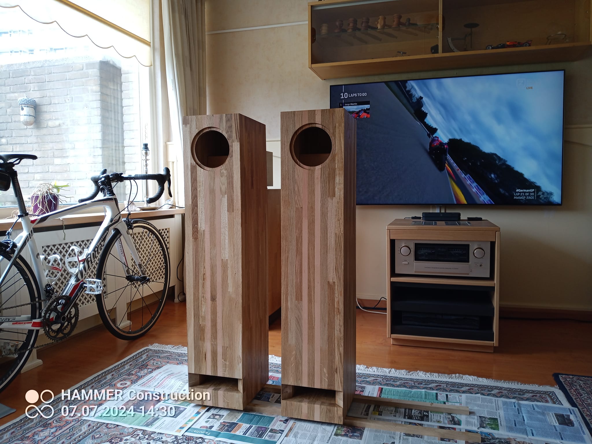

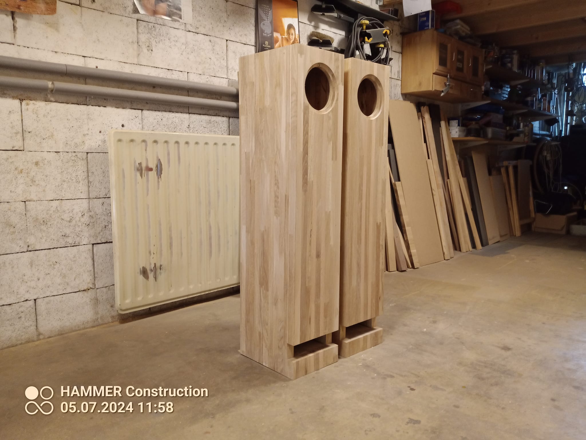

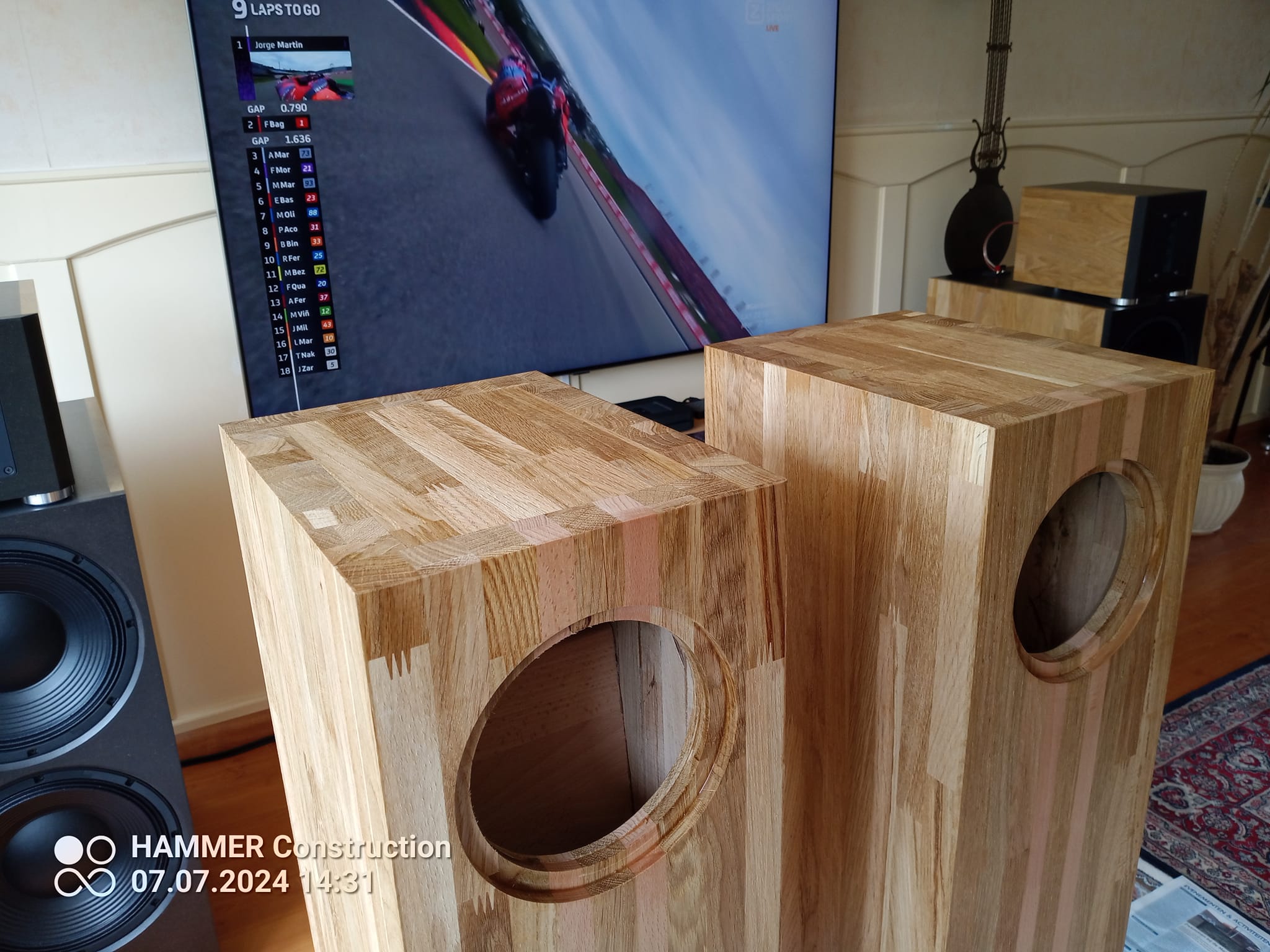

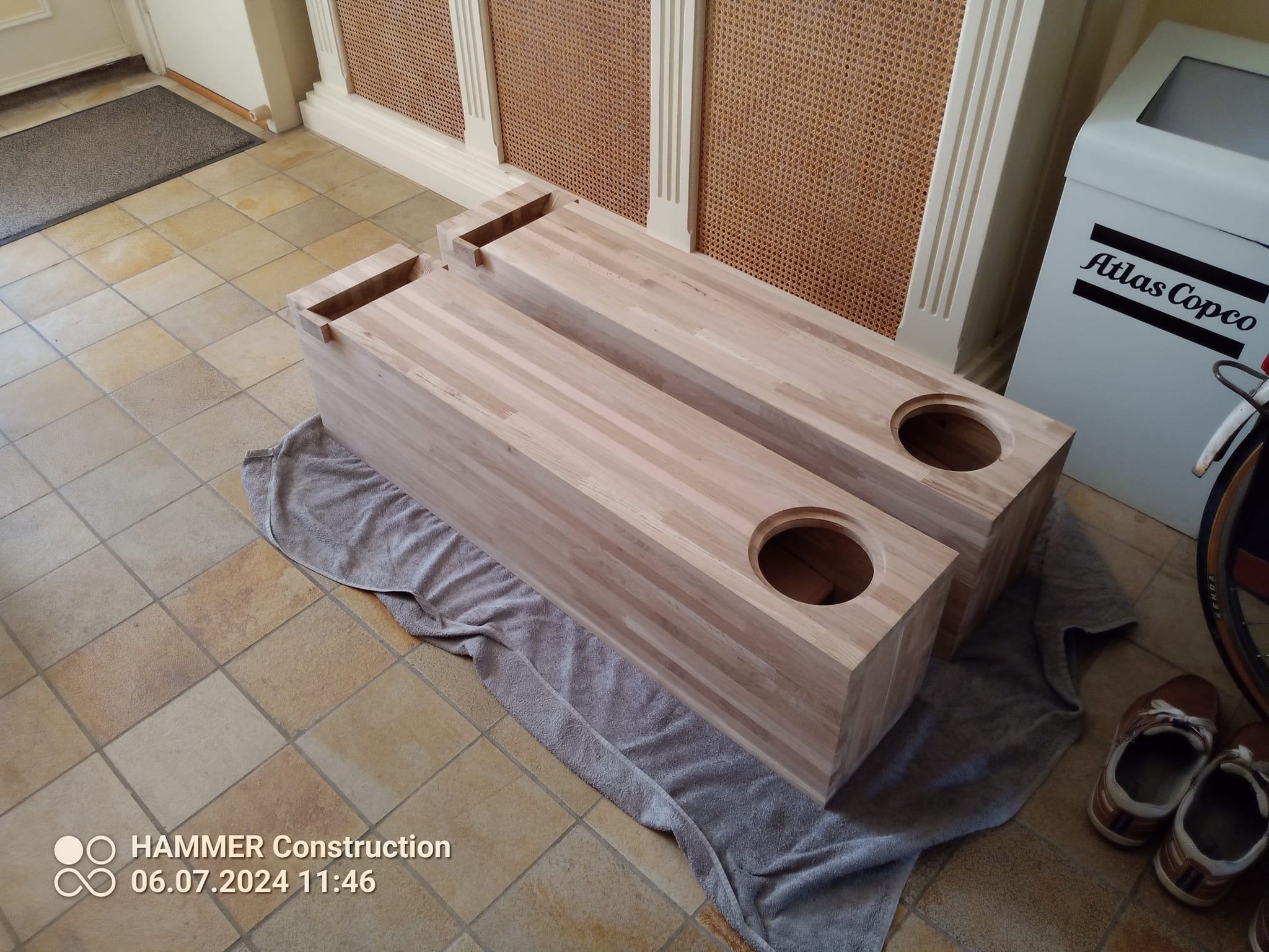

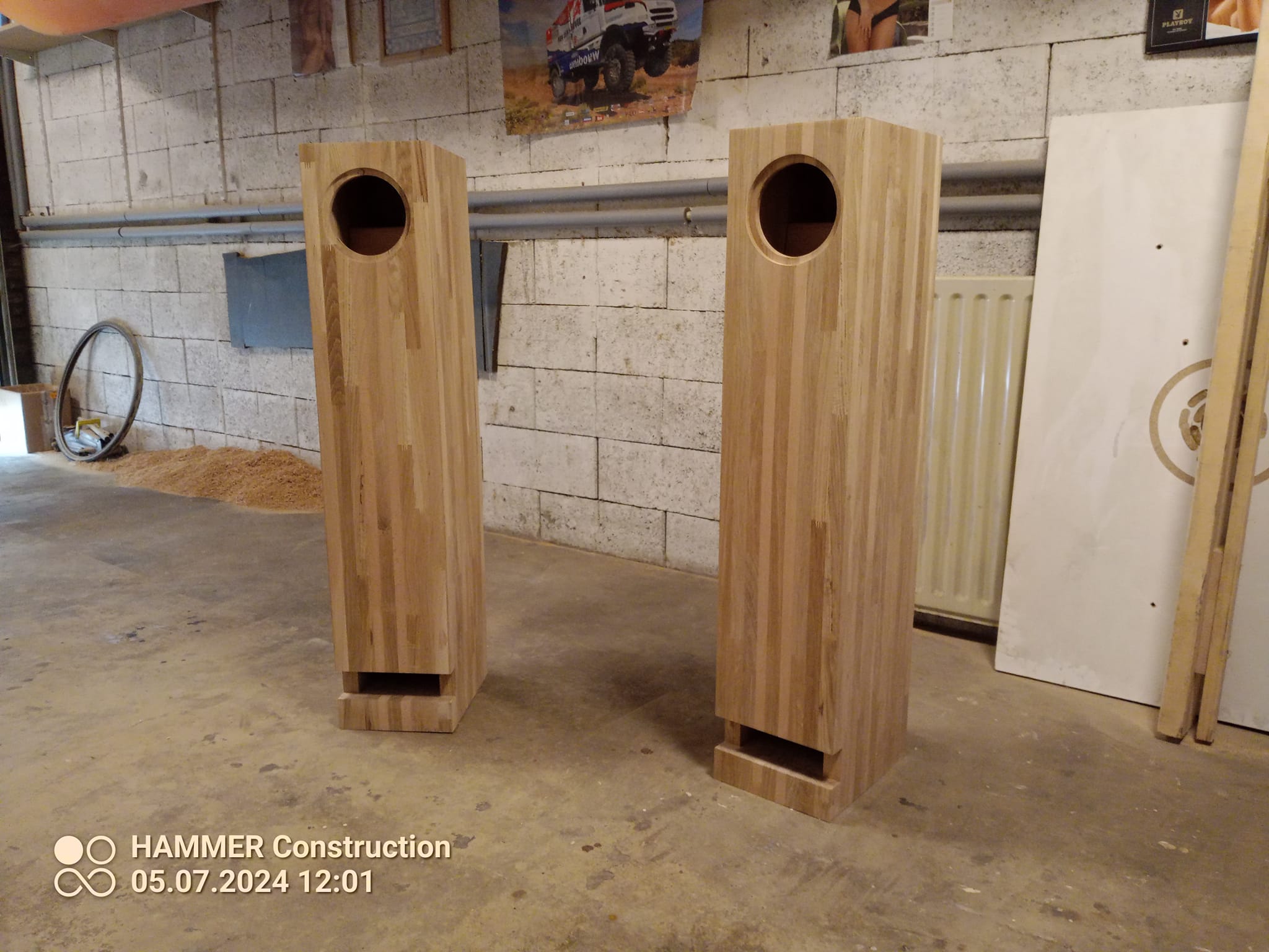

MasterPieces 👌 ready for the finishing touch. I like the fingers. But first a break 😀.

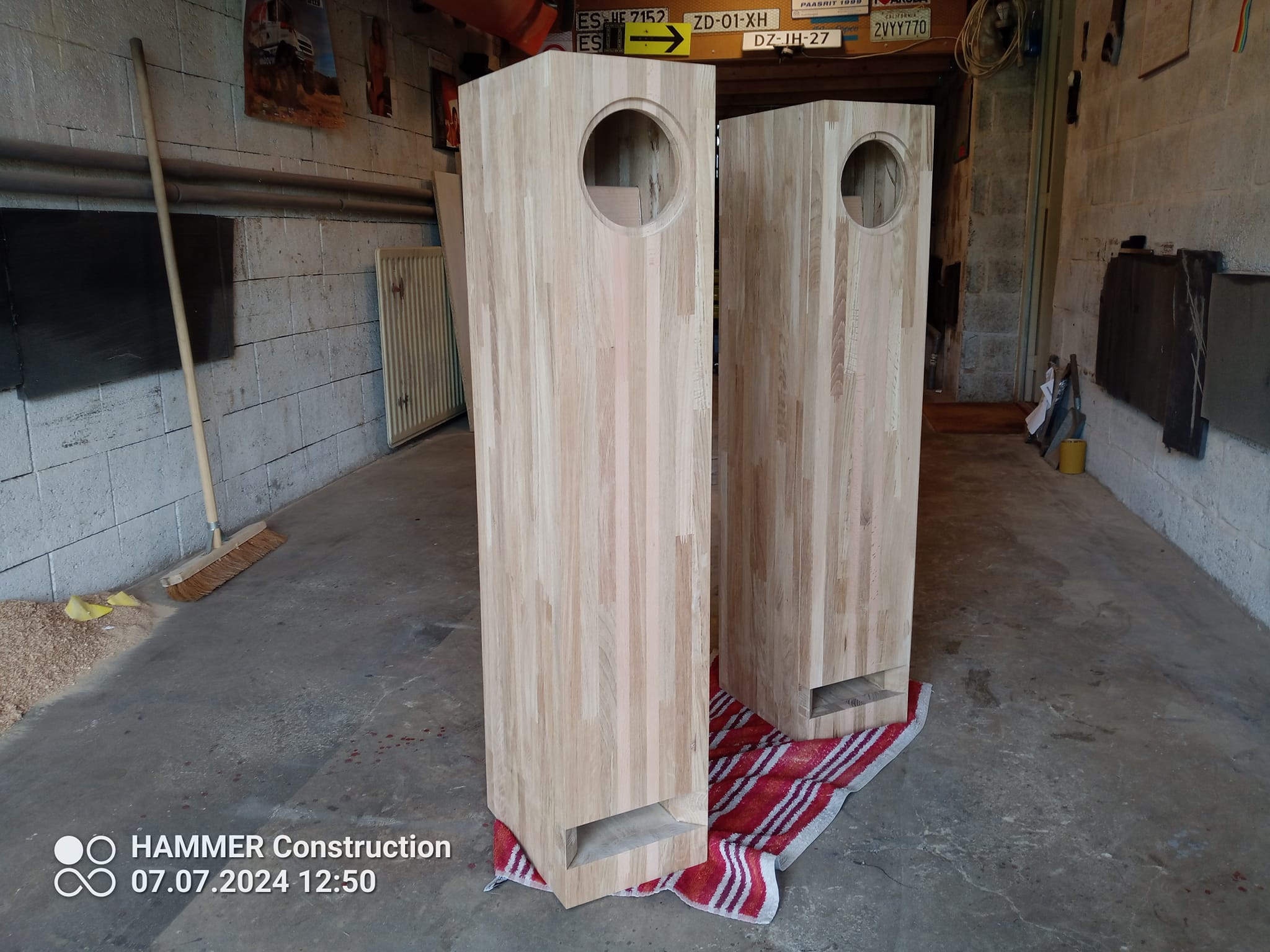

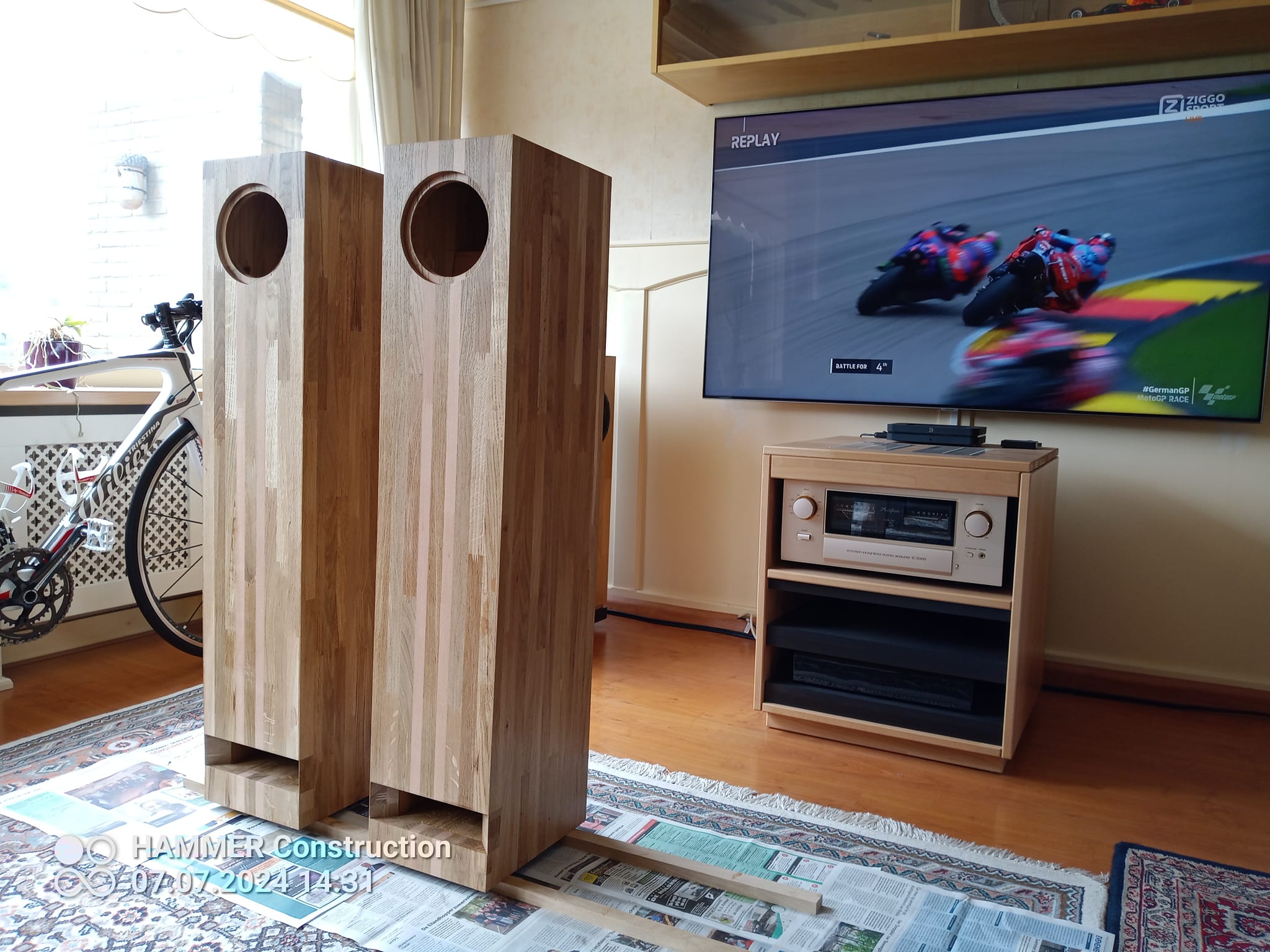

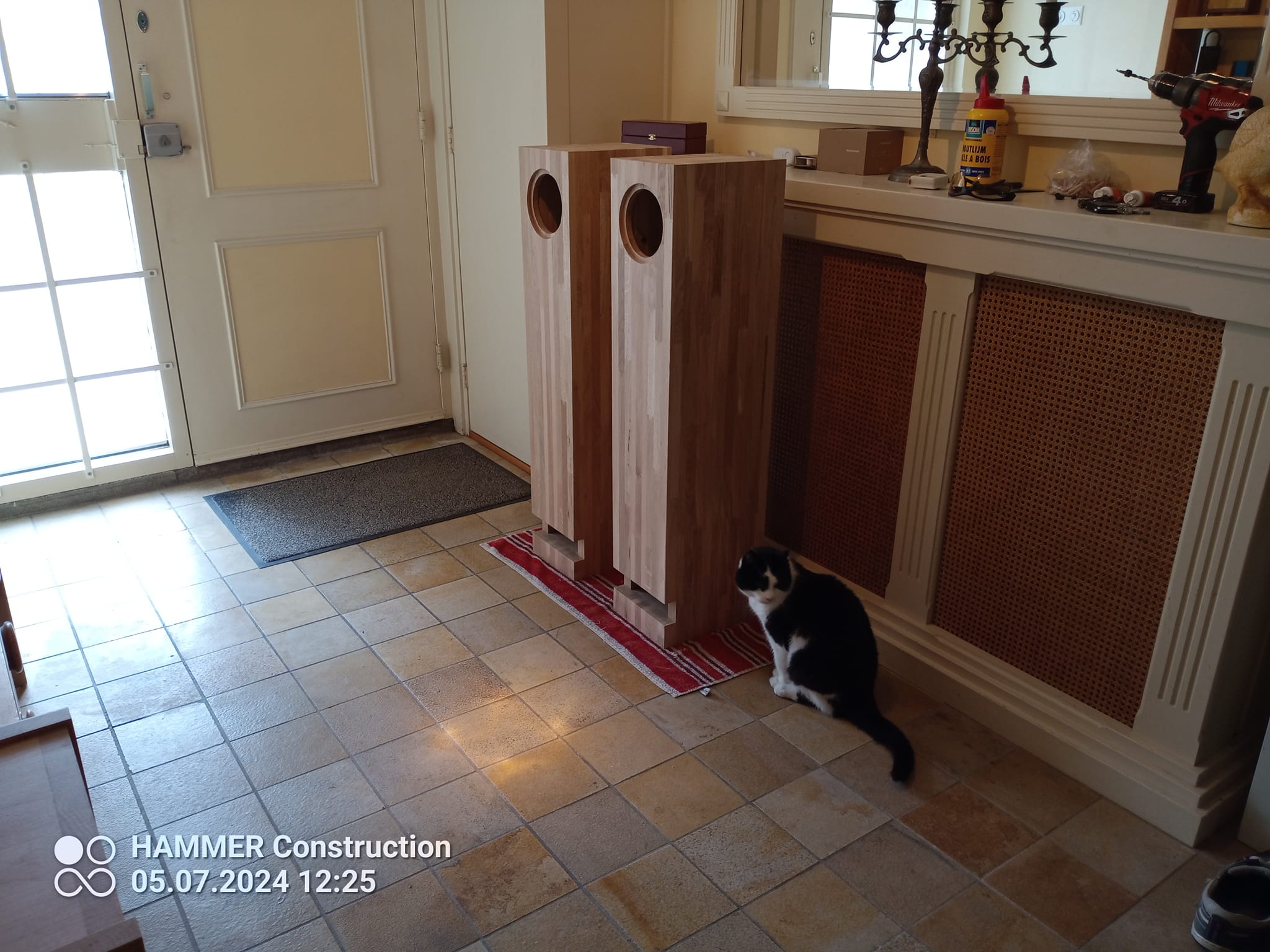

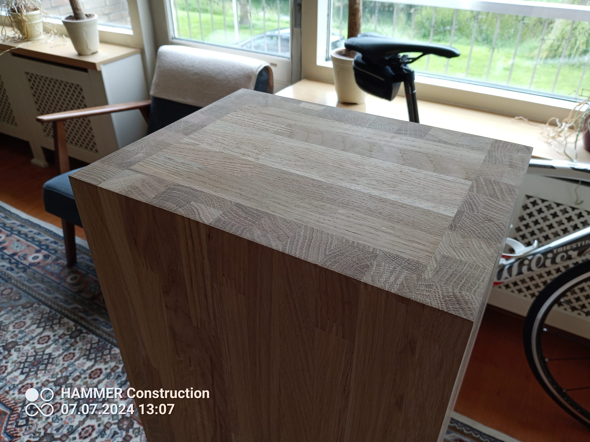

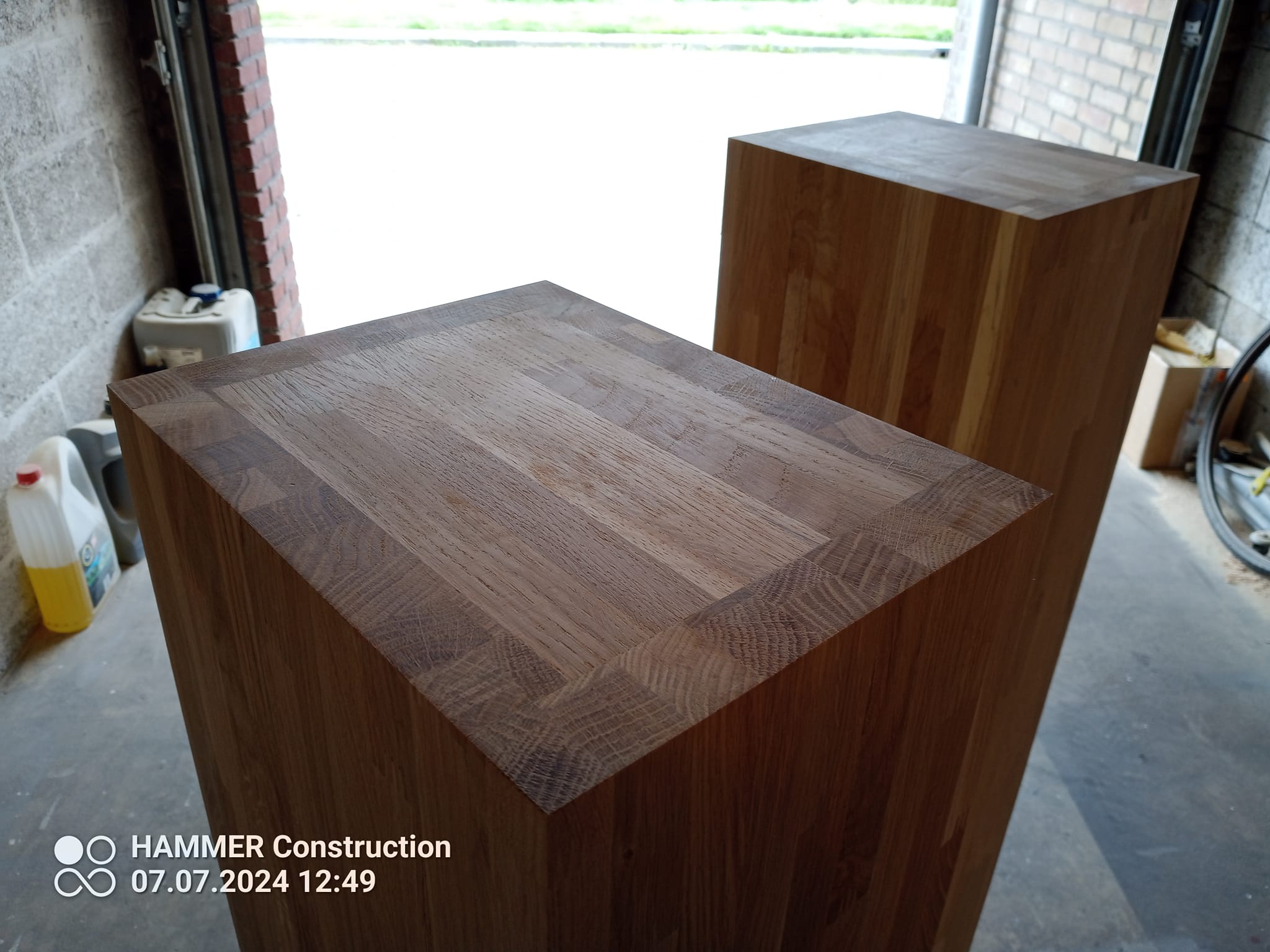

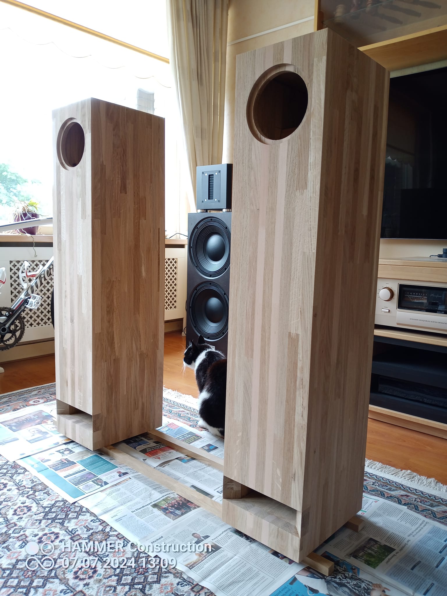

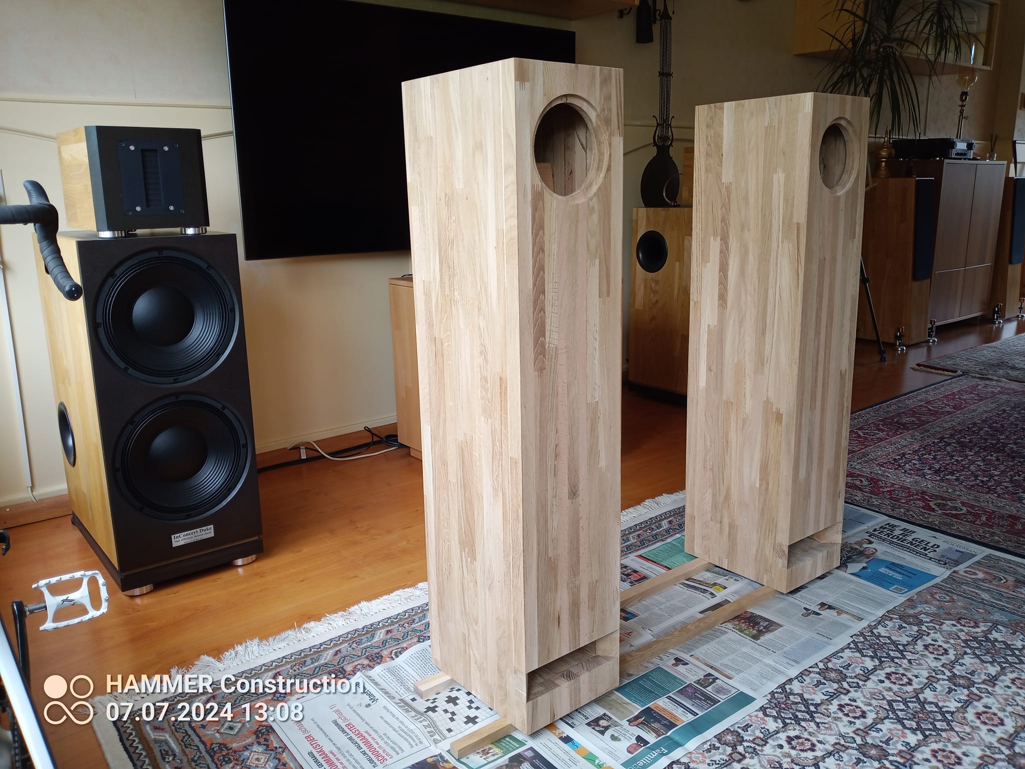

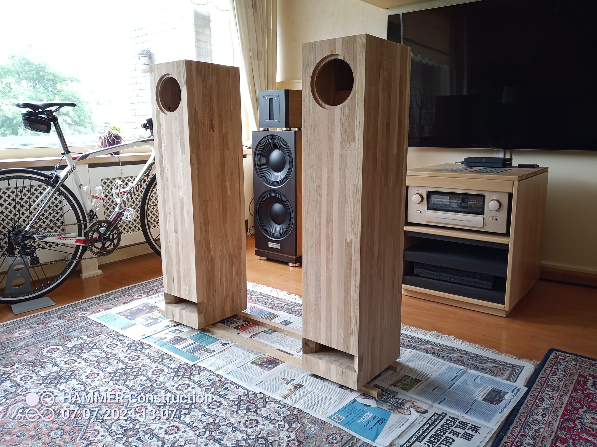

First layer of coating. Oh oh oh how I love color variation in wood 😍😍. This will get a bit warmer over time. But already a nice contrast 👌👌.
