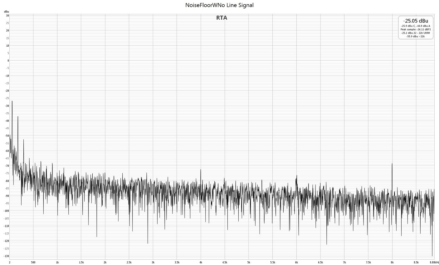

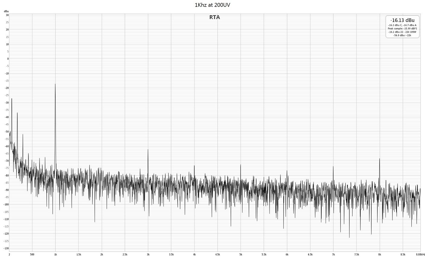

Was testing the input/output with TotalMix and was surprised at this high level. Started input out at 20uv and had to raise it to 200 mV to get the output to around -20dB.
Regardless, the tests were for noise and the news there is splendid. No harmonic distortion results were reported but the ones generated were very, very low.
@PierreQuiRoule and @Peppe : Thanks for the information.
Redid the tests on the other channel and it turns out the first ones were done on a blown channel -- had been doing earlier tests and, apparently, something took that first channel out.
Here are the Noise and 1Khz results for a working channel at 200uV. Obviously, these are completely different and much closer to what I originally thought the noise figure would be -- around -80dB. The system noise figure continues to be the much different -135dB.
The good news is that the 1KHz test tone is much better mannered with far less harmonic ringing.
SO SORRY about the confusion above.

Rising noise at lower frequency is normal (RIAA curve). Harmonic levels are still way off. Cf. measurements at Post #3166. Note that REW can show noise level: check the distortion display box.
Suggestions if I may: Make sure REW is configured properly (24 or 32 bit words, not 16 bit, and sample rate in sync with digital card, etc). This can be finicky. Displaying dBFS versus log frequency would make it easier for you to compare against others’ measurements. Don’t give up.

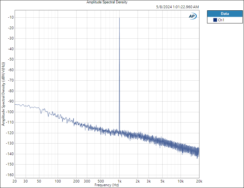

Hello,

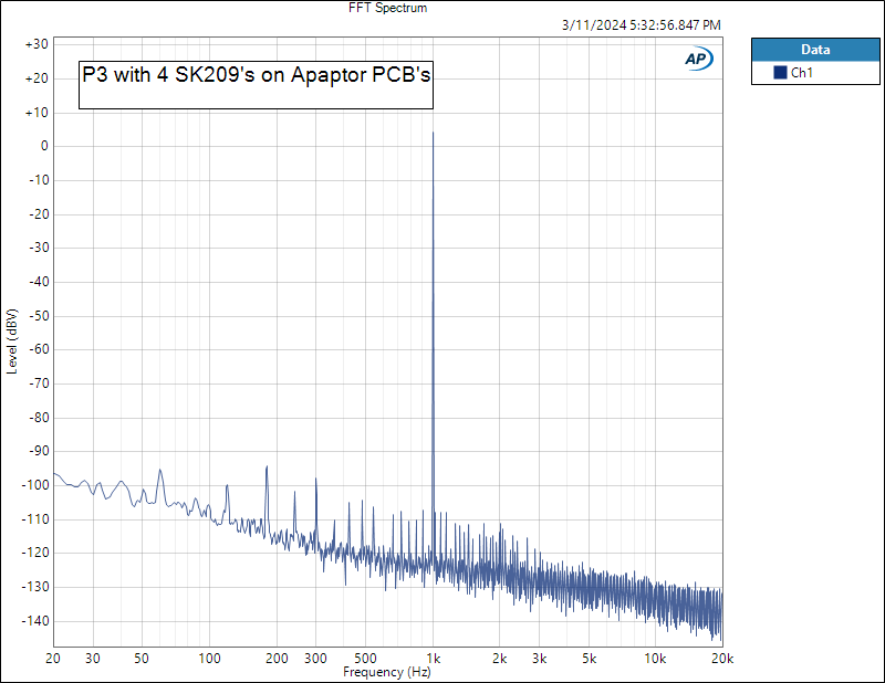

It is not a real value of noise we see at the "noise floor" of the FFT.
The FFT "noise floor" that we see in the FFT depends on the sample size and the number of averages. The windowing that the FFT math uses is much closer to a accurate value at the FFT peaks.
For the noise floor measure to be in the ballpark you need to use the root Hz math and scale.
Like in the Bugle FFT below.
This Pre Pre-Amp has 36db gain
This is my Pearl 3 with 50.4db Gain on the low setting.

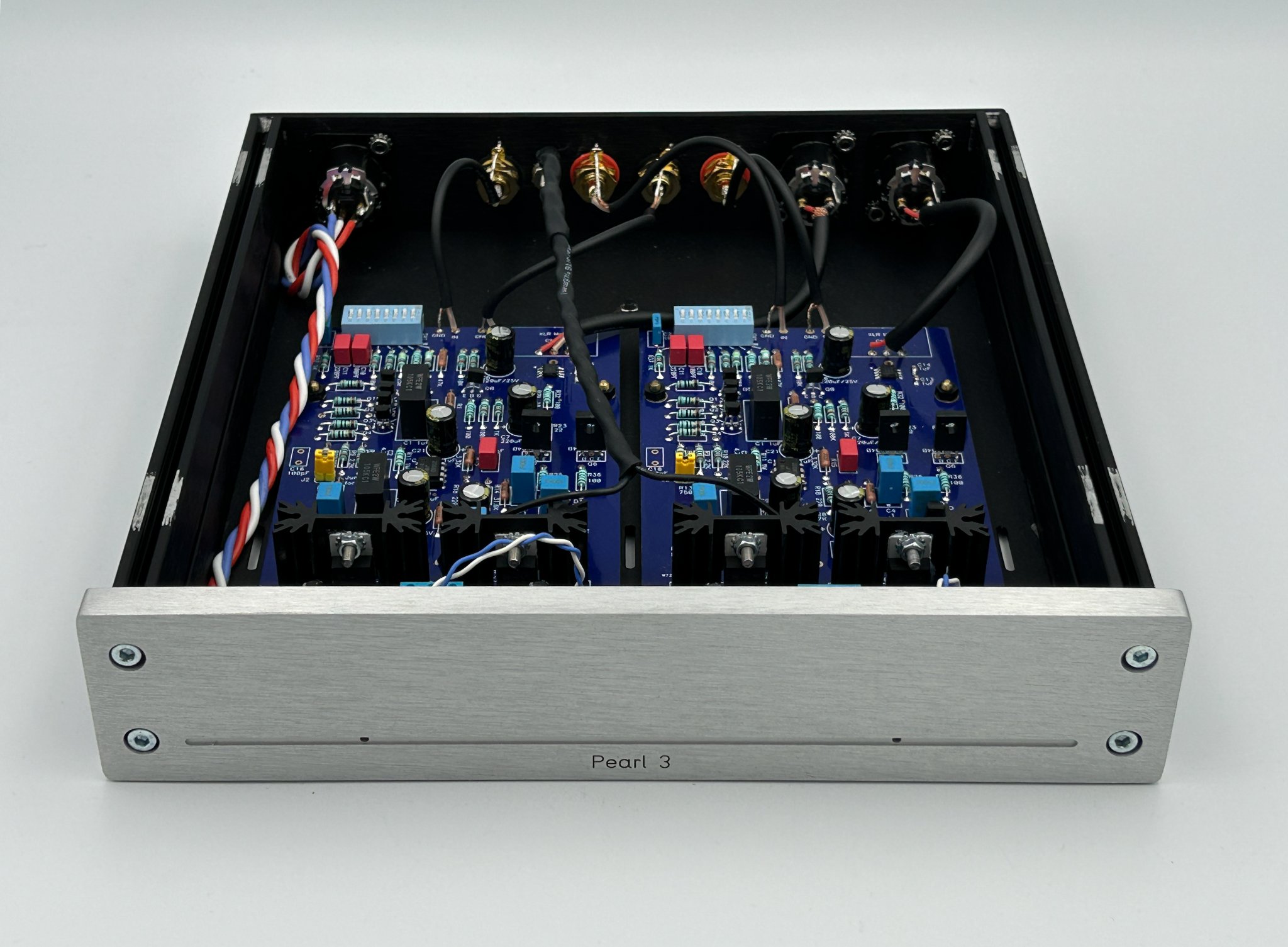

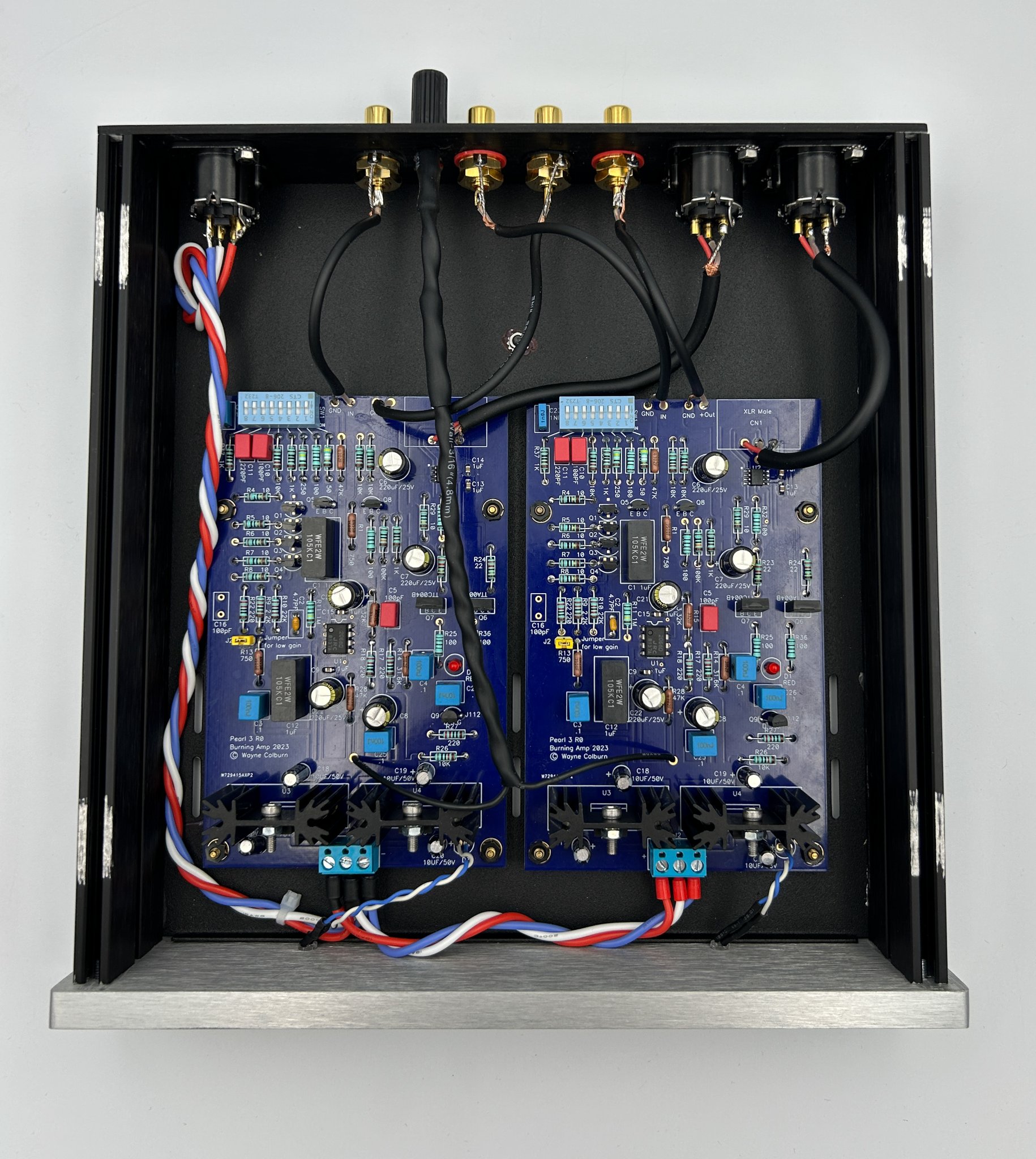

I did a thing!
I don't have a turntable any longer, but my brother still loves to spin vinyl. I'm not sure what gave me more pleasure, the build or learning more about turntables. Absolutely fascinating. Every TT I had in the past was simply set up by the "guy at the store". I never knew anything about RIAA / cartridge loading etc., and I still don't know much. I had to look up my brother's cartridge to set this up for him. Hopefully I got it correct.
It's an Ortofon Blue - Best indications are that 47k and 220pF is the best bet. Any advice is appreciated. I will triple check with him b/c I am not sure if it is a "2M" Blue or not. I got it for him as a gift sight unseen years ago.
https://ortofon.com/products/2m-blue#specifications
It's going in the carry-on today for a trip to the Carolinas.
A HUGE thank you to @wayne for creating amazing projects for DIYers, and to @6L6 and @rhthatcher for the expertly curated kits and amazing build documentation.
Some pics for fun. Off to the airport.
Enjoy!
