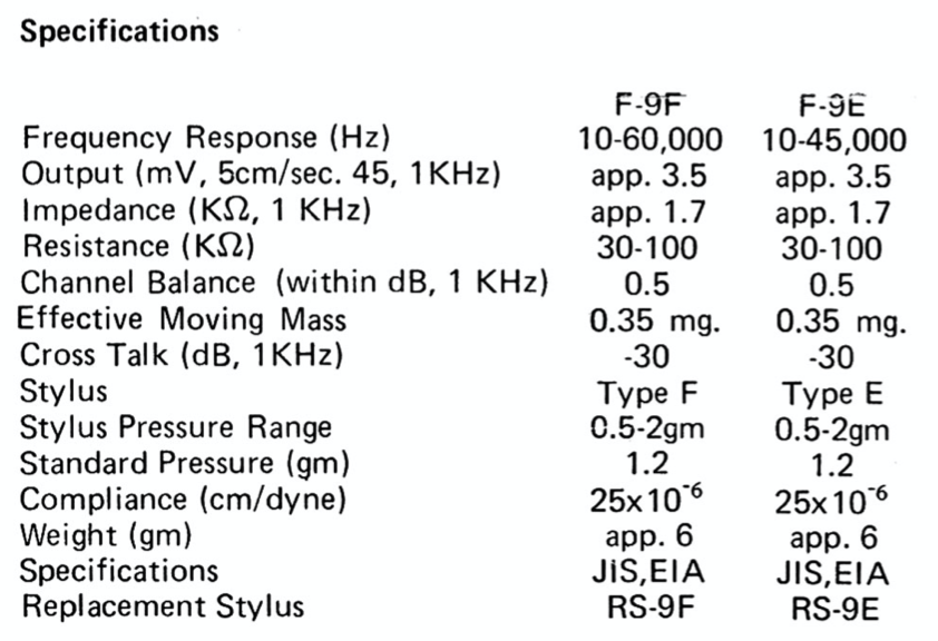

I've searched and haven't found specific descriptions of how to accurately set the cartridge loading. Any recommendations on dip switch settings will be appreciated. My F-9E specs are as follows:
This says 100k for the F9-F; just an Internet source:
https://www.vinylengine.com/cartridge_reviews.php?make=Grace&model=F-9
High output MMIs that a moving magnet or a high-output moving coil?

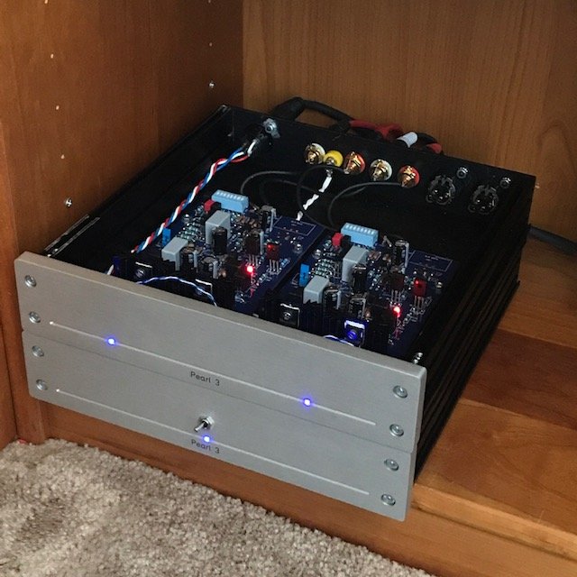

Wow! I knew it was going to be good. I had no idea it would be this good!
Thanks Wayne, for this incredible design! The bottom end seems tighter and better balanced than my Pearl 2. I never did switch the phase on the P2 however, maybe that's in part why. The sound stage is the best I've heard from vinyl in a long time. The detail on Smith & Mudd's Blue River is unbelievable!!!
Also, thanks to 6L6 and Olen and the others who guided me along the way.
I can see it's going to be a long night spinning vinyl! 🙂
