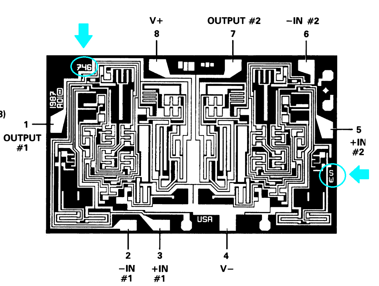

Perhaps one dual opamp that might appeal to some Pearl 3 listeners, is the AD746. It's the dual version of the AD744 singleton opamp, designed by Scott Wurcer. M2x builders recognize the AD744 as the opamp used in the wonderful sounding "Norwood" daughter card. Here's an image from the AD746 datasheet.

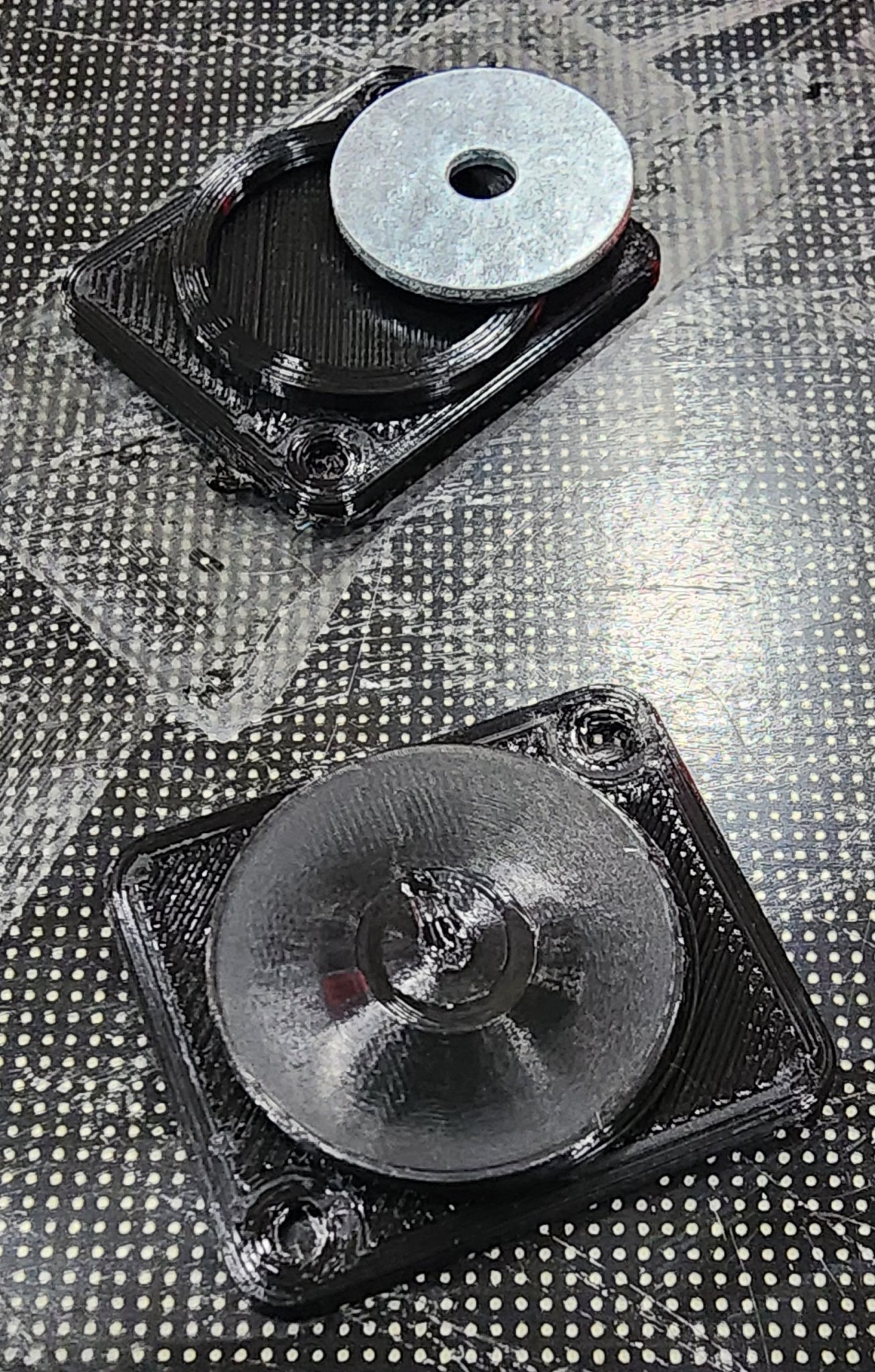

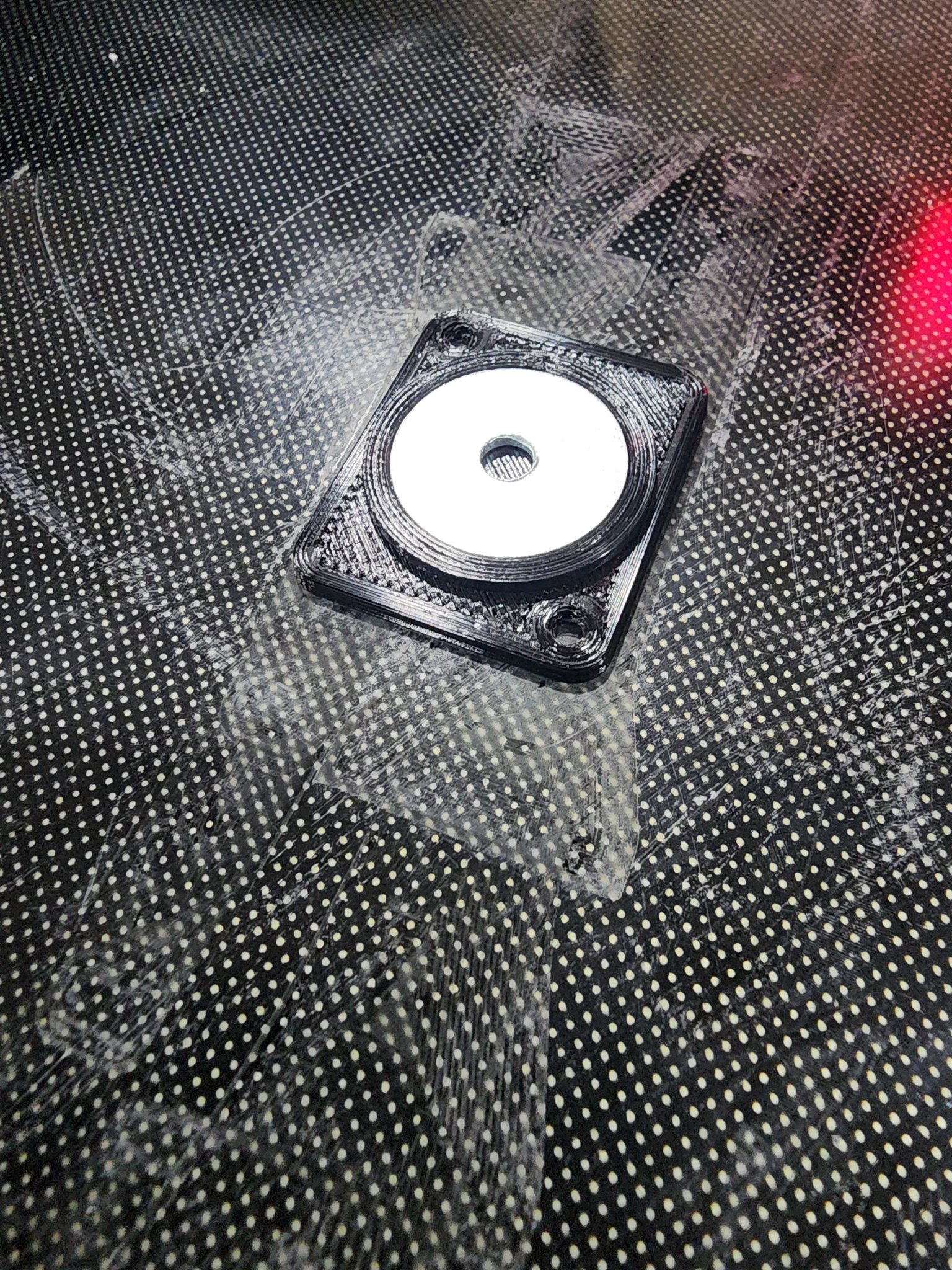

Are the Nuetrik XLR blank plates metal? I made some 3D printed plates, but obviously not gonna help with EMI.
I created a XLR blanking plate design that incorporates a washer into the 3D printed plate with the intent of helping "shield" the internals from EMI, however, it's just a washer inside the plastic blanking plate. Since it's not connected to the actual chassis in any way, does this provide any benefit to EMI shielding, or is it now just an antenna collecting and emitting EMI since it's not grounded to the chassis?
Obviously machining an all metal blanking plate that has no holes and is grounded to the chassis would be ideal. Just curious if having the the washer in the XLR pocket/hole does any good, or is just a waste of time.
though, if closing XLR hole in preamp case, even if MC, is making any difference ............ then there is a problem ............ and dealing with XLR hole means ignoring that bigger problem

While 3D printing is fun and DIY and all that, I think one could get better results from a solid piece of thin brass sheet from the local hardware store. Cut and shaped to cover both openings, then bolted in place with a pair of M3 machine screws.
Well the design is extremely sensitive to noise as I have learned empirically. A metal blanking plate is ideal. Casting a plate is not practical. My question remains. I'm getting the impression that the answer is..."ground to chassis, and skip the washer ".
Additionally, we have cooling slots allowing noise in.
