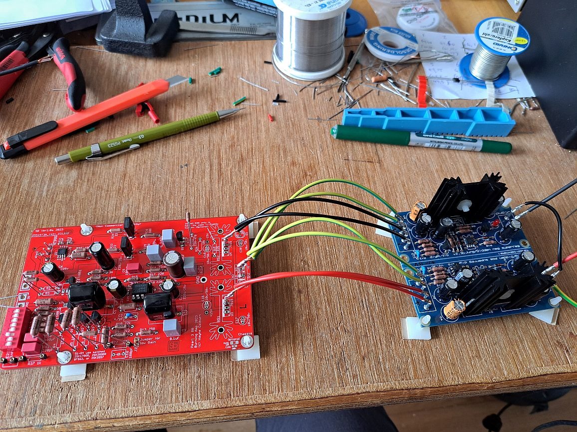

One channel ready for testing:
In short: it works, music comes out. Bit of hum with the ear to the speaker, but that is to be expected as it is completely unshielded.
I've soldered in some resistors provisionally, those that might have to be changed for a different value. R27 is 777R here, to get 4mA bias. Q1-4 are 2SK170BL with Idss around 9.3mA. And just as they did in a previous build of the Pearl 2, they cause a bit of trouble here. I get 3.6 mA across each of the source resistors, 13.5mA across R8. As a result the voltages around Q5 are not what they are supposed to be. Vc = 3.439, Vb = 4.058, Ve = 3.432. Other voltages are close to what has been posted before, so they seem allright.
What would be the best solution for this? Change the value of R4-7 to 15R, 18R or 20R? Does R8 have to be the same value as R4-7? Would there be a penalty in gain/noise if I do this?
I prefer to use my matched quads of 2SK170BL, but getting 2SK209 would be an alternative. How closely matched are they? How much of them would I have to buy to get a 2 closely matched quartets (or 1 octet)?
