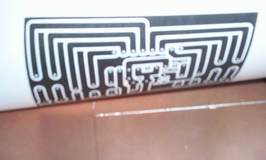

Error in PCB layout!
Hey sousmielie,
The PCB layout has an error. Check out what happens to LM386 pin order when you make an mirror image!
The layout here shows the traces "through" the board. Flip the text so that it is readable and then make a mirror image out of the whole thing. That should fix it.

Hi teemuk,
The layout is correct, I just checked it again. Maybe I made a bit of confusion, with my clumsy word order. You should print the bottom side of the pcb like it is, don't mirror it, place the layout so that the printed surface is against the copper side of the PCB. Then you should be able to read INPUT OUTPUT and WL on the bottom of the board.

Hi Sousmielie,
Hmmm... Maybe i'm still confused. Isn't the copper/solder side of the board suppose to look like this?
Teemu K

Hello
I made my PCB by taking a lasercopy of the layout, the copy cant be inverted as ordinary.
Then you place the copy on the copperside with the print against the copper and heating it for about 10 minutes with a flat-iron...
After that you put the pcb with the paper on and placing it in a bottle of water, so you can get rid of the paper but not the print on the copper...
NOW you can etch youre pcb so it looks exakly like the original print...
Hope you understand what im saying 😉
//Elias
Hi teemuk,
No, I know what you are trying to do, most magazines publish PCB's which look like that. Try this, print out that file, just like I posted it, look through the back side (white part of the paper), then you will be able to read the text. I am posting a photo of how you should put the layout to make the PCB.
Werner
