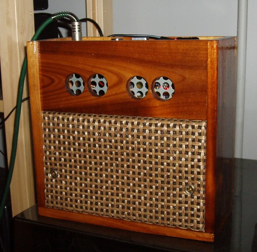

can anyone trace slowfly,where is he?what has been the result ofhis project.................................................etc.
HELLO!!
Now im back!! I have got other things on my mind😉
BuT now i think the projekt is ready!
So now i have build a amplifier based on a LM386 with a pcb from a projektbook from school...
And i took a old PC-speaker and builded a small speakerbox that woorks really good 😀
Here is a picture :
Thanks again for all the wonderful help !!!!!!!!!!!
//Elias

good work slowfly,great looking.
congrats!keep the good work goin

I wouldn't bridge LM386. I did that and blew two of them in seconds after playing really loud 😀
BTL with 8 or 16 ohms on 5V is OK, but NOT on 9-12V 😱
LM386 is a good little chip though. Makes a good headphone amp too.
For more power, get a cheap 12V BTL car stereo amp chip, and with some good batteries, it will be plenty loud, put a few good boomboxes to shame!
