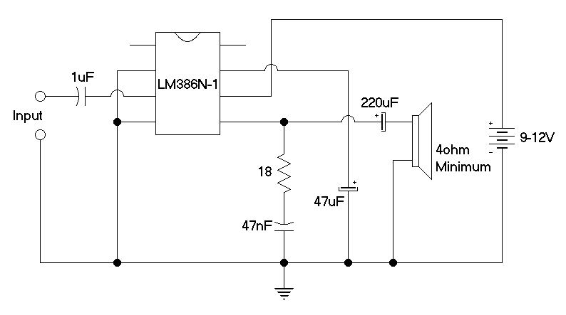

Hi Slowfly,
Here is my schem for the amp, I built it years ago, and it is still running almost everyday at my dads office. 🙂
Nordic, where are you from? I see you have a RSA flag. I'm from Jo'Burg. It was raining the whole night yesterday. 🙂
Anyway, Slowfly, let me know what you think/happens? I'll post a pcb later.
Cheers for now,
Werner
Cheers for now,
Werner
Thanks !!!
Im from one of the nordic countries called Sweden.
And if you wanna now im living in the city Nyköping 😉
To morrow i will try to build amplifier! Hope it works...
THX Elias
THX Elias
