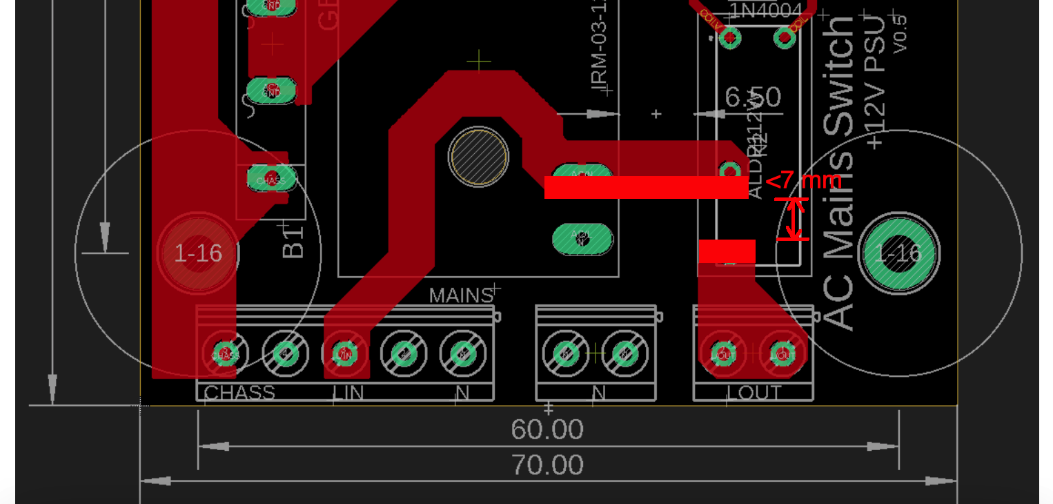

As for point 1: copy-paste the traces from the top to bottom layer on the L, N and Chass traces? JPS's PCB seemed to go that route, Digikey's trace calculator for 10A seems to suggest 7mm traces, so duplicating them on both the top and bottom layer "kind" of gives that area on both traces. Seems reasonable. Any reason NOT to do it?
I'm not sure what you'd accomplish with that.
You don't need 7 mm clearance between traces around the relay, so I would beef those connections up a bit so you get a stronger connection to the relay pins. You only need 2.5 mm between traces there (assuming 400 V peak, according to IPC2221B).
The 7 mm clearance is between any metal connected to chassis (PE) and either of the two wires connected to the mains (L, N). You also need 7 mm between the primary (mains) side and the secondary (12 V) side. That's for safety.
The minimum distance for two mains-connected traces should be set according to the voltage between the two traces.

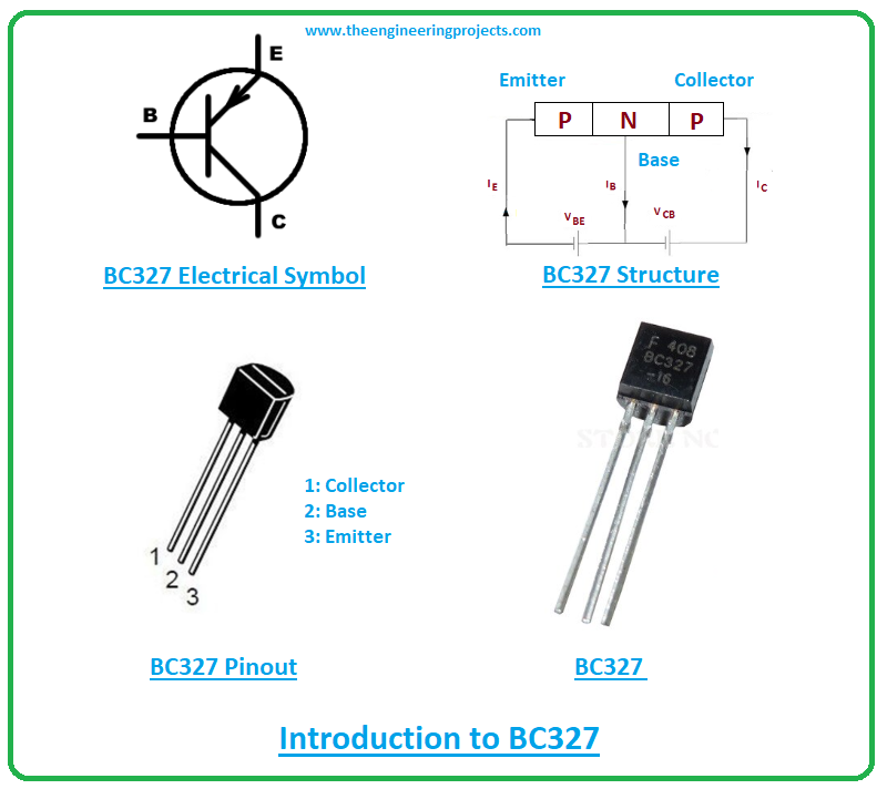

BC337...NPN since ages. Why a BC337? Because even though BC549 is able to drive the relay apparently "lighter" transistors go defective prematurely.

Once mounting the PCB in your enclosure don‘t forget to use spacer >= 10mm.
Yep. You then want 7 mm from the tip of the longest component lead to chassis, so a >10 mm spacer is appropriate.
Tom, Rafa is talking about duplicating same traces L and N on both side for 2x 35um copper.
Ah. I suppose if you can ensure that the current is shared evenly between top and bottom (and all the other constraints are met) that could be an option.
My bad. Both BC327 and BC337 are NPNs.
One would have to check the data sheet, but I'd expect a 12 V power relay to draw around 50 mA. That's within spec for collector current of a BC549, but allowing for some VCE(sat) you quickly get close to the 100 mW limit of the BC549. The 625 mW of the BC327/337 will come in handy.

BC327 is since ages a PNP transistor just like BC337 is the NPN version 🙂 That is a second correction, sorry. Rafapolit needs the BC337.

...Rafapolit needs the BC337...
Thanks jean-paul! And if I can abuse your helping hand, how do I determine if I require the 16, the 25 or the 40 version? Is there a way to know / simulate / guess, before hand, or do I need to test it in circuit and see which hFE values I require?
No worries. If I'm wrong it's entirely fair to correct me. Or is there a limit on the number of corrections I'm allowed? Sorta like a three-strikes rule?
I can't decide whether I should blame inattention (i.e., looking but not seeing), old age (my birthday is next week), sleep deprivation, or working too hard for too long. 🙂
Thanks for setting me straight. It's rather important to get the NPN if the circuit is supposed to work.
