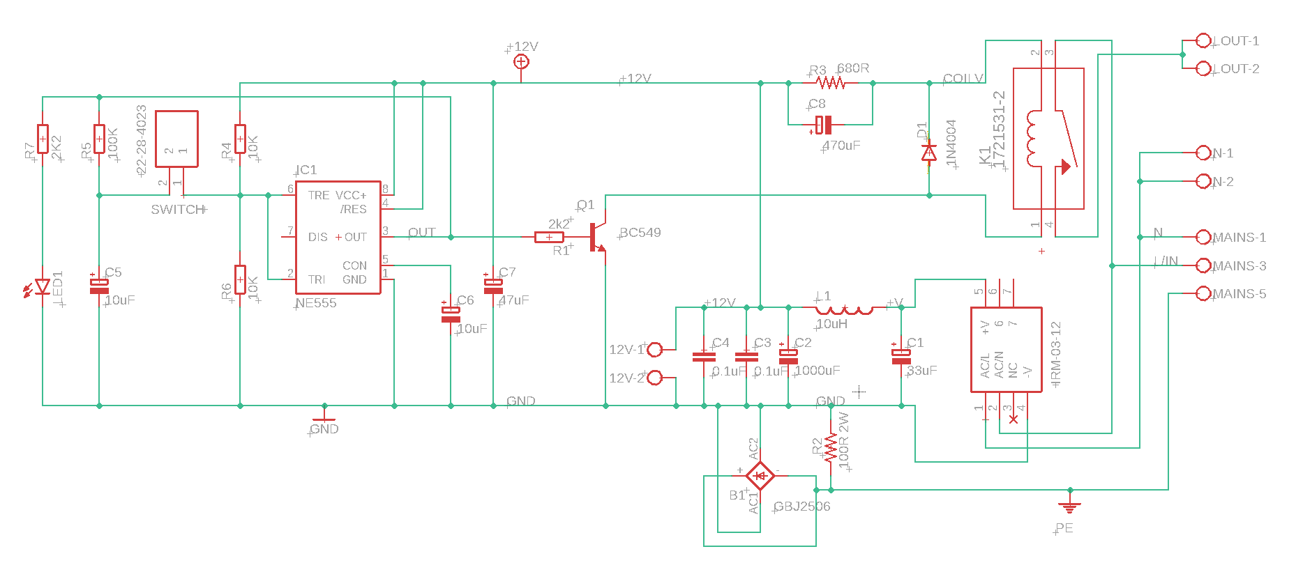

Relay driver (and optoisolator driver for the "soft start" function you are not implementing) are both MOSFETs on the board linked below. It might give confidence that such things are possible to get right.
Nchannel MOSFET (datasheet) here.
PCB: low voltage On-Off switch drives AC mains relay \ includes soft start .. H9KPXG

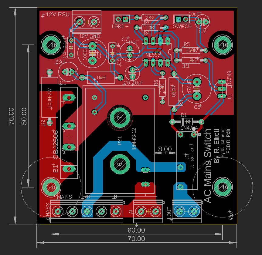

That's about it for the BOM. I have gone over the PCB once more and adjusted some spacings according to the selected parts (most notably, the smaller electrolytic capacitors went from 2.54 mm spacing to 2 mm spacing.
Also, I have tidied up the part numbers, so I'm attaching the schematic and PCB layout so there is no confusion.

Hi, I think you have designed/composed a nice and good working device and a good PCB. Just build it and report back how it works and if you are satisfied.
Don't let the well meant interference and noise (to use some familiar terms) created by us influence your self confidence. It is vast framework of small rules and interconnected things that one will master when learning stuff step by step with an open mind and care for details.
Most of us started with copying stuff designed by others as the knowledge was not there yet. Normally that phase ends one day. As long as you don't sell boards commercially there is nothing wrong with copying/composing. Therefor the names of the people other than yourself on the PCB serve no purpose IMHO as the list should be longer with Edison, Tesla, Bell, Volta, Mr. Ampere etc. When you buy bread the bread does not have the name of the farmer that grew the corn and/or the guy that made the recipe for the dough on it does it?

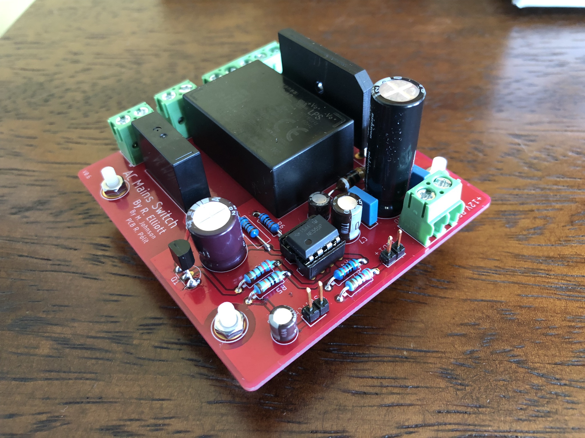

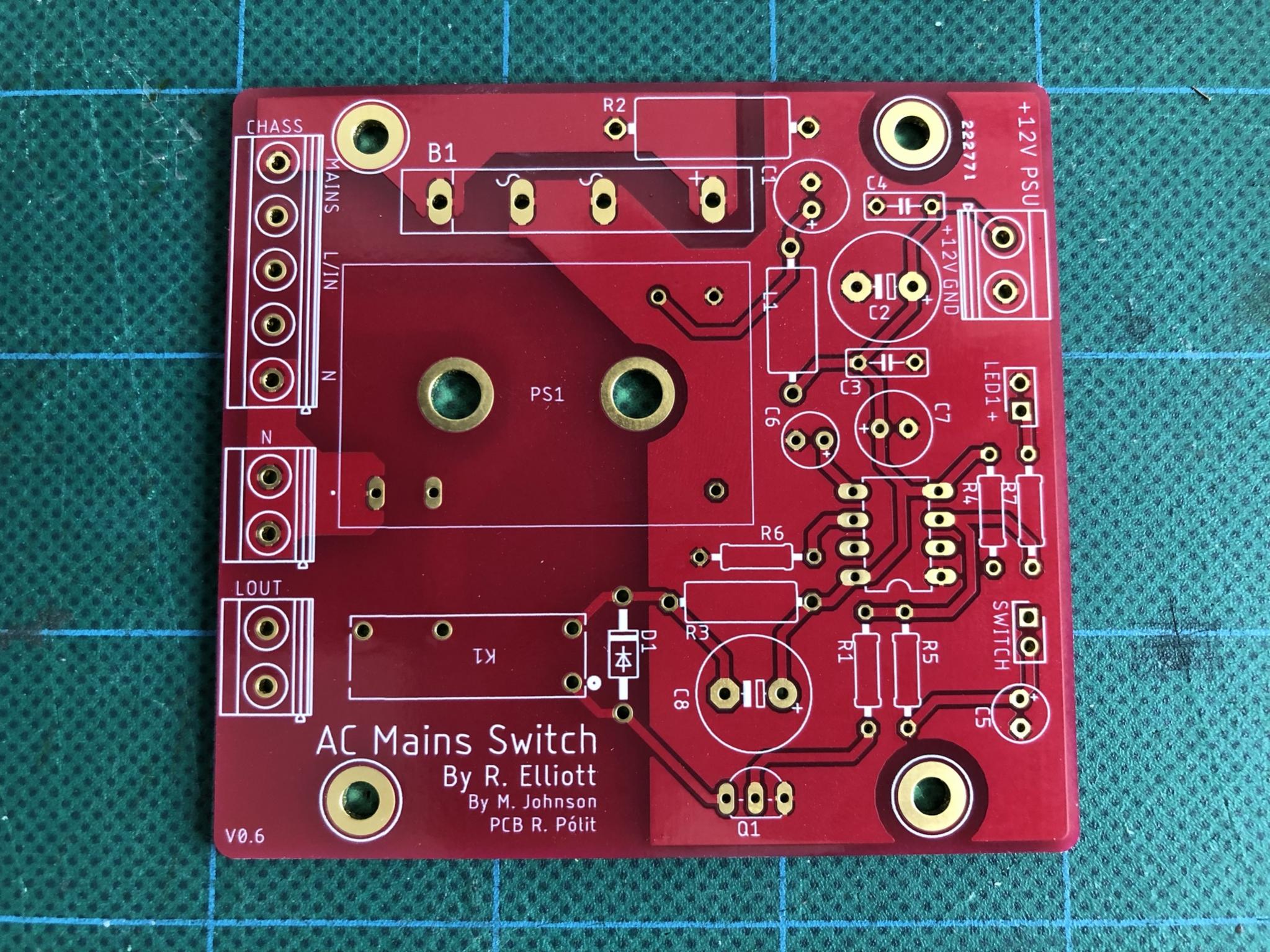

Well, it's been almost a month, but the PCBs from DigiKey have finally arrived, along with all the components from Mouser!
The PCB went really well, I think, the parts purchase as well. Long journey to Ecuador, that's for sure. 🙂
Here's the PCB:
And here it is with all the parts populated:
If 16v caps are enough, the very tall 1000uF capacitor can be switched with a much smaller one that will fit with the overall proportions of the PCB, but this 25v is good enough, I guess.

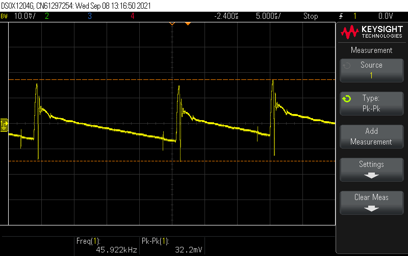

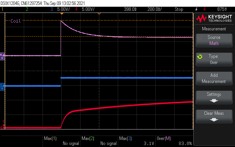

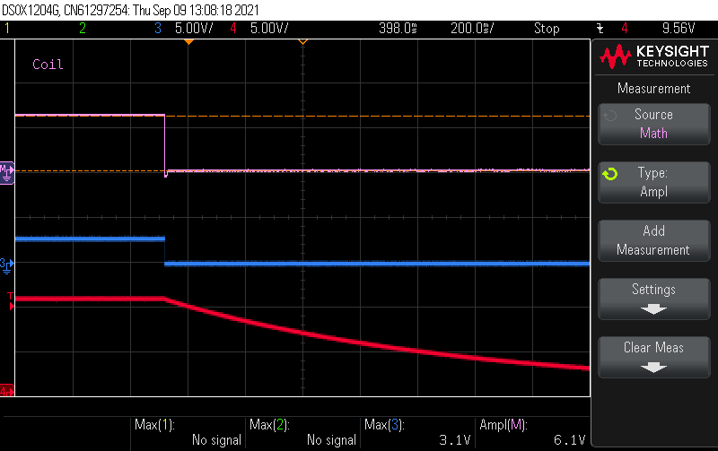

Also, I did some measurements on two key areas: the coil and the actual 12V psu.
Coil Voltage
The voltage in the coil is a very clever solution as implemented by Mark, in my opinion. The coil, when on, does not see the full 12V, but, depending on R3, a nice fraction of it. If matched with the coil, half the voltage (I failed to see this before, it is quite obvious now), so it will nicely extend the life of the relay.
Here are then voltages across the coil upon start and stop:
As you can see, the relay is triggered quickly, and then slowly settles to half the voltage during ON status. When Q1 stops conducting, it is a clean cut back to 0V. Really nice. The blue trace is the voltage on the LED+ pin, and the red is just my trigger on the SWITCH leg.

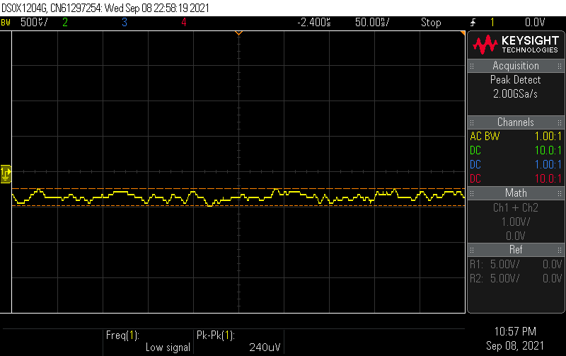

The PSU implementation is also really nice. I measured as best I could the ripple of the PSU alone and then after the implementation of the filtering system. Please note that I don't have the knowledge nor the equipment to do 'accurate' PSU measurements, these should be taken simply as 'referential' value to see the improvement, rather than claims that PSU ripple is X or Z.
I measured around 30mV of peak-to-peak ripple / noise onto a 120 Ohm load (100mA current) of the SPU without any filtering applied:
After implementing the filtering with the inductor and the caps, I measured 240uV (which is below my test implementation's limits probably):
Again, that is not to say that ripple is 240uV, or that the original ripple is actually 30mV, that was already better than the manufacturer's specs! So, this is just a 'before and after' type of comparison for me to learn and to show that the filtering is actually having a positive effect in the system, not to claim such specs of the design / implementation.
So, this looks rather reasonable to me, I'm quite happy. I'll look into implementing it on my 24V external PSU for the ACP+ and see how that turns out.

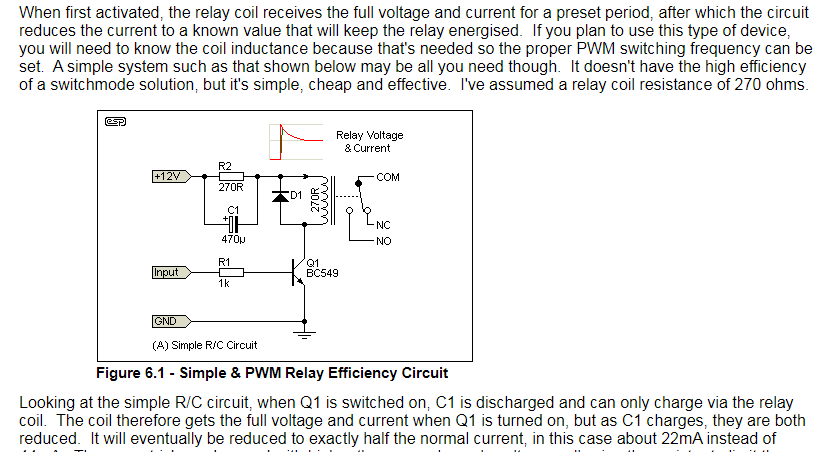

Now about the clever solution to reduce coil power.... I don't think it will extend relay life as that is mainly destined by the times the relay switches. How often does one see a defective relay coil? My opinion is that it will result in the opposite and I will defend it:
I would call it clever when switching voltage as in input switching of for instance amplifiers but I would never use it for current switching and definitely not for mains switching with "normal" relays (I deliberately avoid latching relays here). I may be wrong (I am pretty sure I am not) in this but using half the voltage results in less contact pressure. The manufacturer does not mention the relay having a 12V coil without a reason. It IS a 12V relay specified for 12V, for 6V a 6V version would have been needed. I would use a wire jumper here for the resistor and omit the cap. Please note that even with exact 12V the relay already will have lower voltage because of the transistor. While you can lower the voltage after the relay has switched half the voltage may result in contact pitting certainly when the relay is in the region of minimum holding current.
So it seems the clever trick is useful in voltage switching but less clever in current switching. A more clever trick is to choose a relay version with higher coil resistance that is still rated for the current one wants to switch OR to switch 🙂 to latching relays at the expense of a higher price and added complexity.

Yes I was careful but I was pretty sure that the "clever" should be substituted for another word 😀 Oh oh the tone...
Now if you have used the type ALDP112 then at 12V the coil is 720 Ohms and current is 16.7 mA. Not so long ago LEDs needed that current to glow 🙂 The power is 200 mW nominal. What is there to gain with regards to power reduction? The device won't be switched on 24/7 I hope.
Premature conclusion: the relay will live shorter and possible failure.

Note: for a complete view on this matter I asked Rod Elliott for a reaction. Since his website is the modern encyclopedia for audio DIYers it maybe handy to have this schematic explained more clear and the exact use of it.
Rod Elliott replied that the 'efficiency' circuit showed (his version) works perfectly if the components are selected properly. Also that it is not his invention and that it is used in countless products... Mmmm.
So this application is copied and again copied and now it turns up in a new design 🙂 Now there are manufacturers that describe methods to reduce coil power. All in context but this is then not about 200 mW relays and it is only about reducing power at the expense of higher sensitivity for shock/vibration and there is not a word spent regarding extended relay life. A relay coil specified for 12V is meant for 12V with a +/- margin as specified in the datasheet. One may gamble with voltage switching but why? Modern relays consume little power when compared to their older cousins. Their reputation is already tarnished and this circuit does not make it better for them.
I recommend strongly against the circuit when mains circuits and/or current switching is done but maybe it is better to forget the circuit completely as it may be copied by DIYers. So please let's stop the cycle and aim for reliable and safe circuits with relays.

Next is the holding vs turn on voltage. This is because the magnetic circuit closes when the relay is energized boosting the flux and holding force vs the initial unenergized state. A better holding circuit is an initial high voltage on a capacitor that takes seconds to charge and a diode to a lower holding voltage.
Relay power can be a real problem and many commercial devices resort to latching relays that require zero power to stay in the current state, but that then requires a pulse to turn them off.

If the PCB design includes a microcontroller, then the uC can easily provide all necessary pulses and timing to operate a latching relay. As member steveu points out, latching relays dissipate zero power when not switching.
Interestingly, there are commercial examples of push-on, push-off, mains switch boards which DO include a microcontroller, but DONT use latching relays. Launching the Google search shown below, will find one such board ($169 + shipping).

In this circuit "as it is" C8 should be removed and R3 replaced for a wire jumper to avoid any inconvenience and correct behavior of the relay.
Of course latching relays as I suggested are nice (but expensive) and microcontrollers are toys for the engineers (and they're "ifs") but do we need all that? No we just omit the "efficiency network" and don't worry about the 200 mW/0.2W we use a few hours a day certainly compared to the power hungry, inefficient class A devices some build without blinking an eye 🙂 The ALDP112 relay can switch 5A/277V AC. Now we keep a safe margin so let's say we switch 1A consuming devices so 230V x 1A = 230W. The 0.2W of the relay is simply not counting in the whole picture. There is simply no benefit to think of against the negative points the RC network brings, no more no less.
Latching relays can be switched reliably with simple circuits. If we would need latching relays AND an ARM CPU (over-engineering 101) for this then maybe a real sturdy mains switch is a better choice as these separate mains and devices 100% when switched off, almost never breaks down, doesn't need a switcher permanently powered on and adds no complexity. Please note the circuit is developed as momentary switches are cheaper but are they really when everything is added up?
