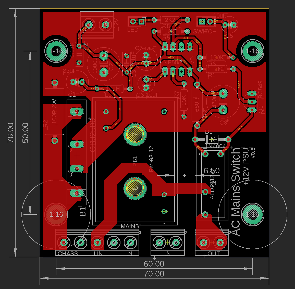

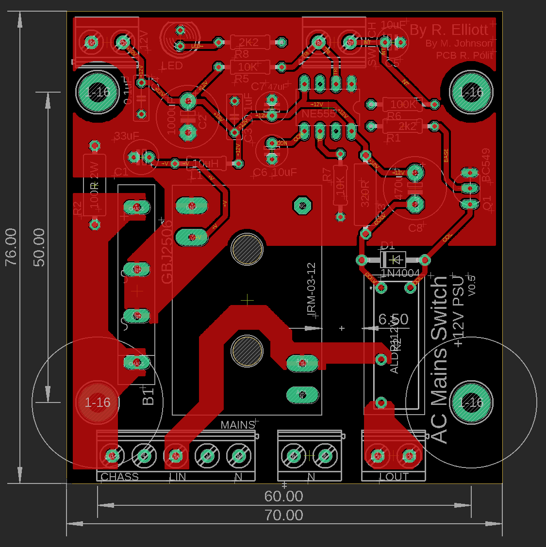

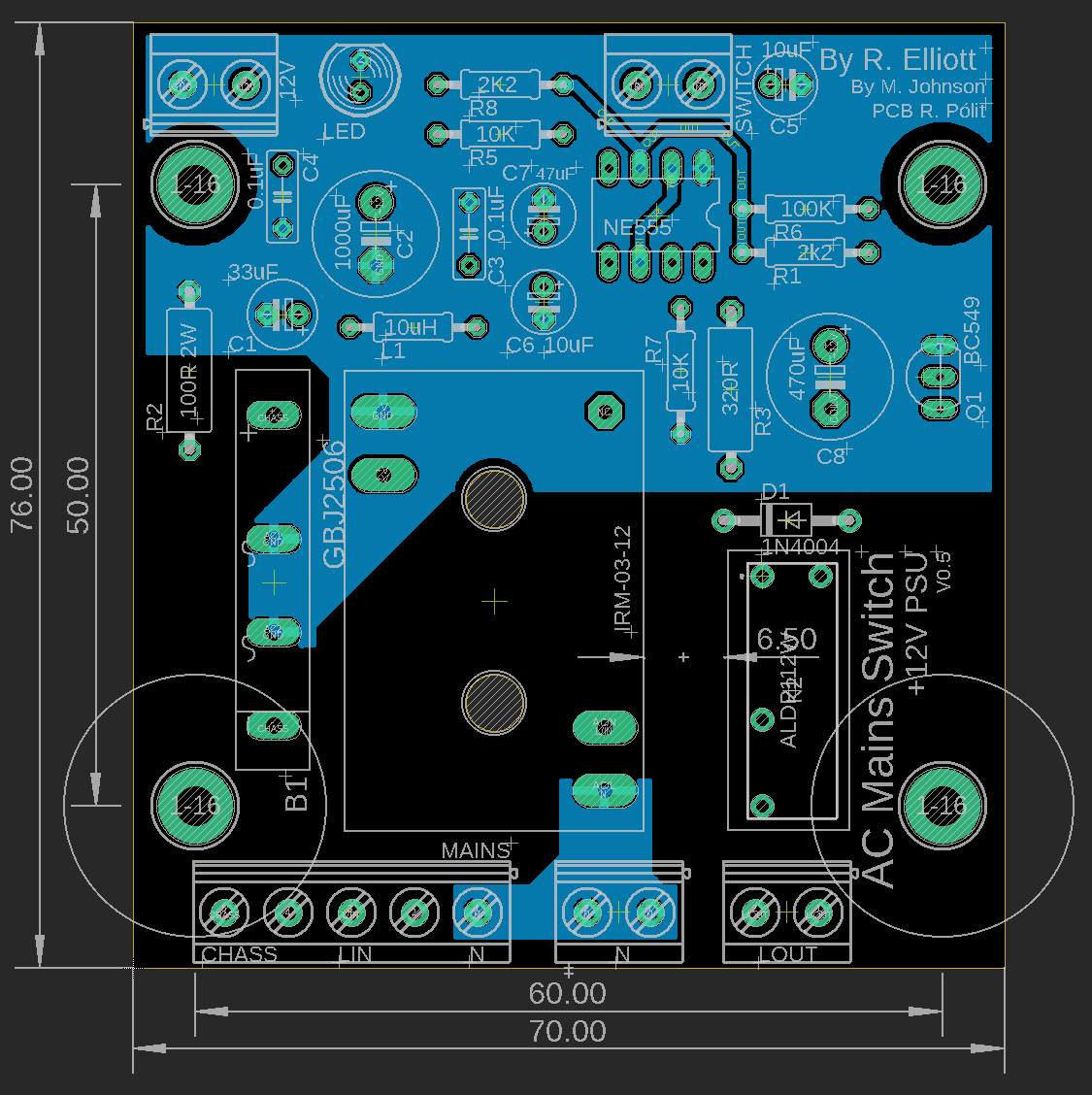

The bottom part looks like this now (I am slowly working into adding all parts instead of two boards, not there yet).
I did replace the Relay with JPs suggested part, I always thought that 16A or even 12A was overkill here, for those requirements, I'd probably go with H9KPXG. So 5A is more than enough.

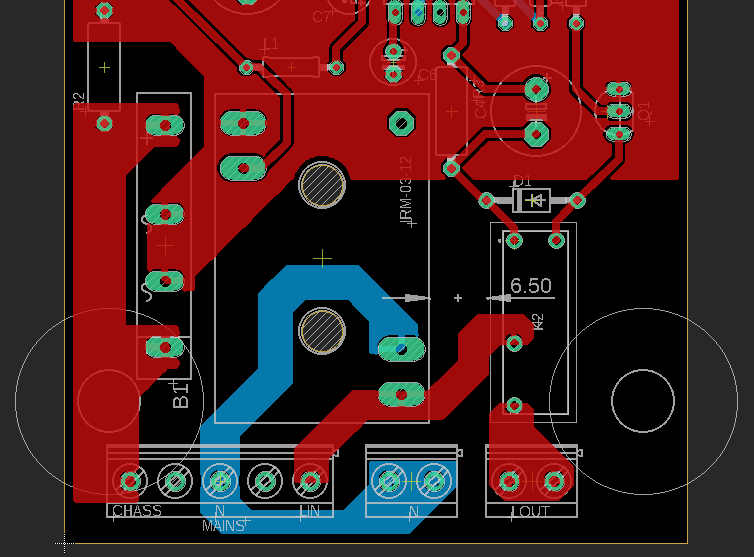

I do still want to keep the 10mm separation, so, since I cannot seem to fit this in 50mm, I have a bit more front realstate, so I believe I now observe the full 7mm without the need of the "ditches" in the PCB to the chass line. I did use top and bottom layers to separate L from N, but 3mm are observed everywhere as well between L and N.
I like the idea of making the left mounting hole actually chassis connected. One could always Isolate that bolt if you want it not to be.
If I follow Jean-Paul's suggestion and invert L and N on the IRM module, then I can even move the connectors all the way to the front and do without that blue trace "in front" of the connectors, which I like a lot better.
What do you think?
Now on to work on the 'top' part of the PCB, I'm incorporating all the logic into the board as well.
Thanks once more,
Rafa.
That is continuous current. The relay will switch on/off what kind of load? Resistive, inductive or the worst ... capacitive...
Some devices/loads present a way larger inrush current. Some devices like some electrical motors even 12 x I nominal. It is a good habit to dimension relay contacts to the possible load and then over dimension them a tad. Just some info. It helps to limit currents to the maximum admissible current when the mains current is limited to a relatively high 16A. The aforementioned fuse is a good means.
The design looks much better like that.

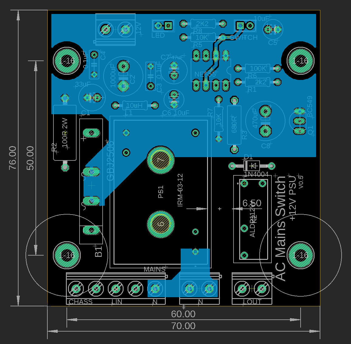

Thanks for the insight Tom! Yeah, I think at this point, the polarity of the IRM module adds only about 3mm to the board if I don't switch. So I will research a bit, and then just go with one or the other.

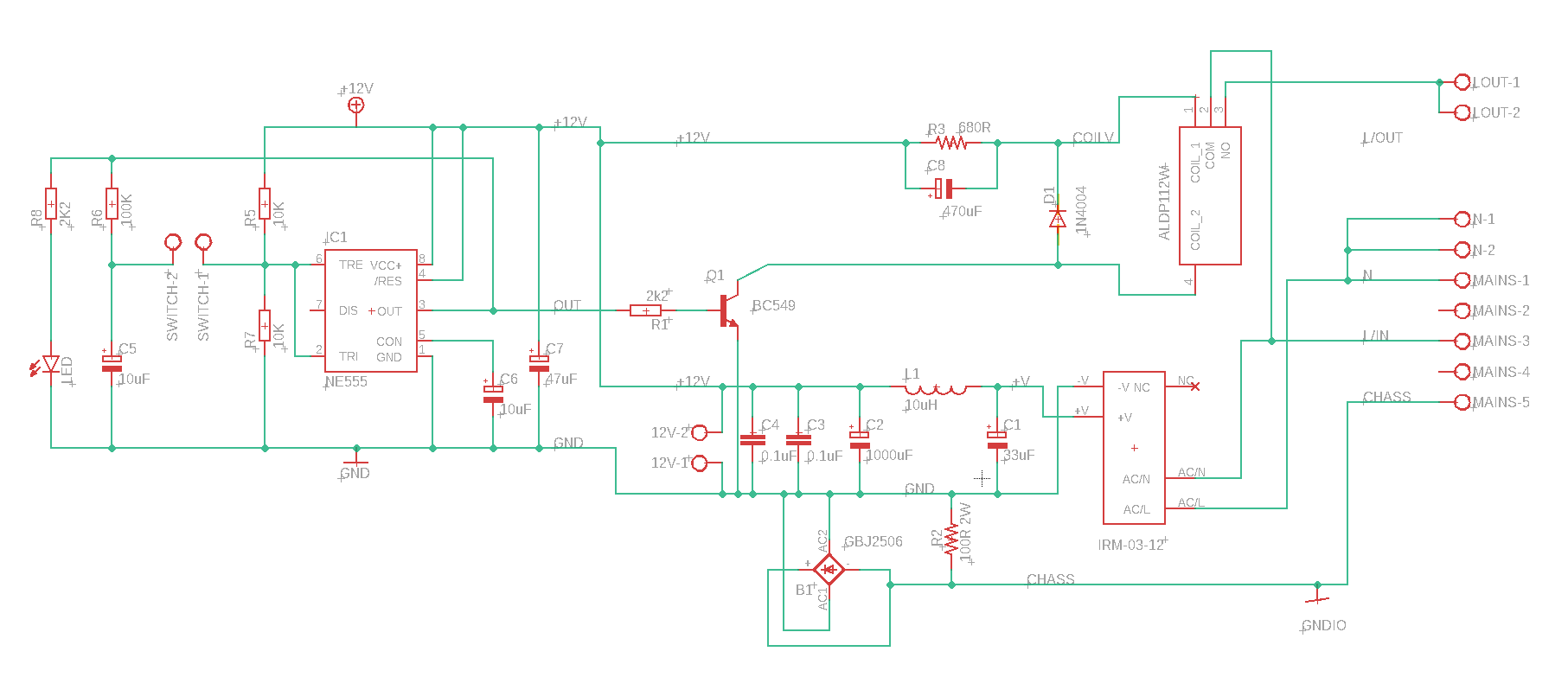

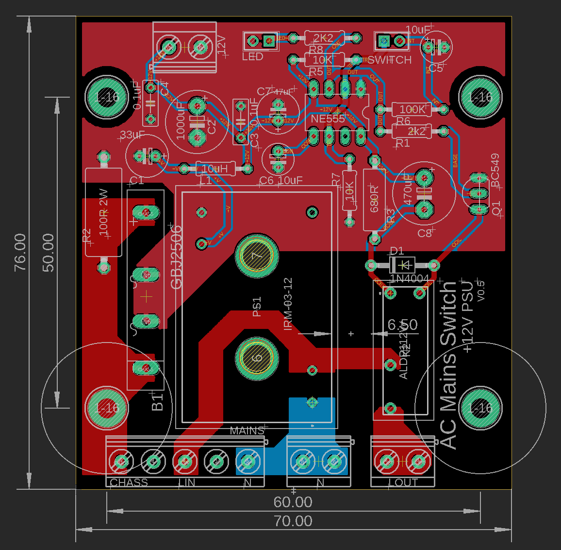

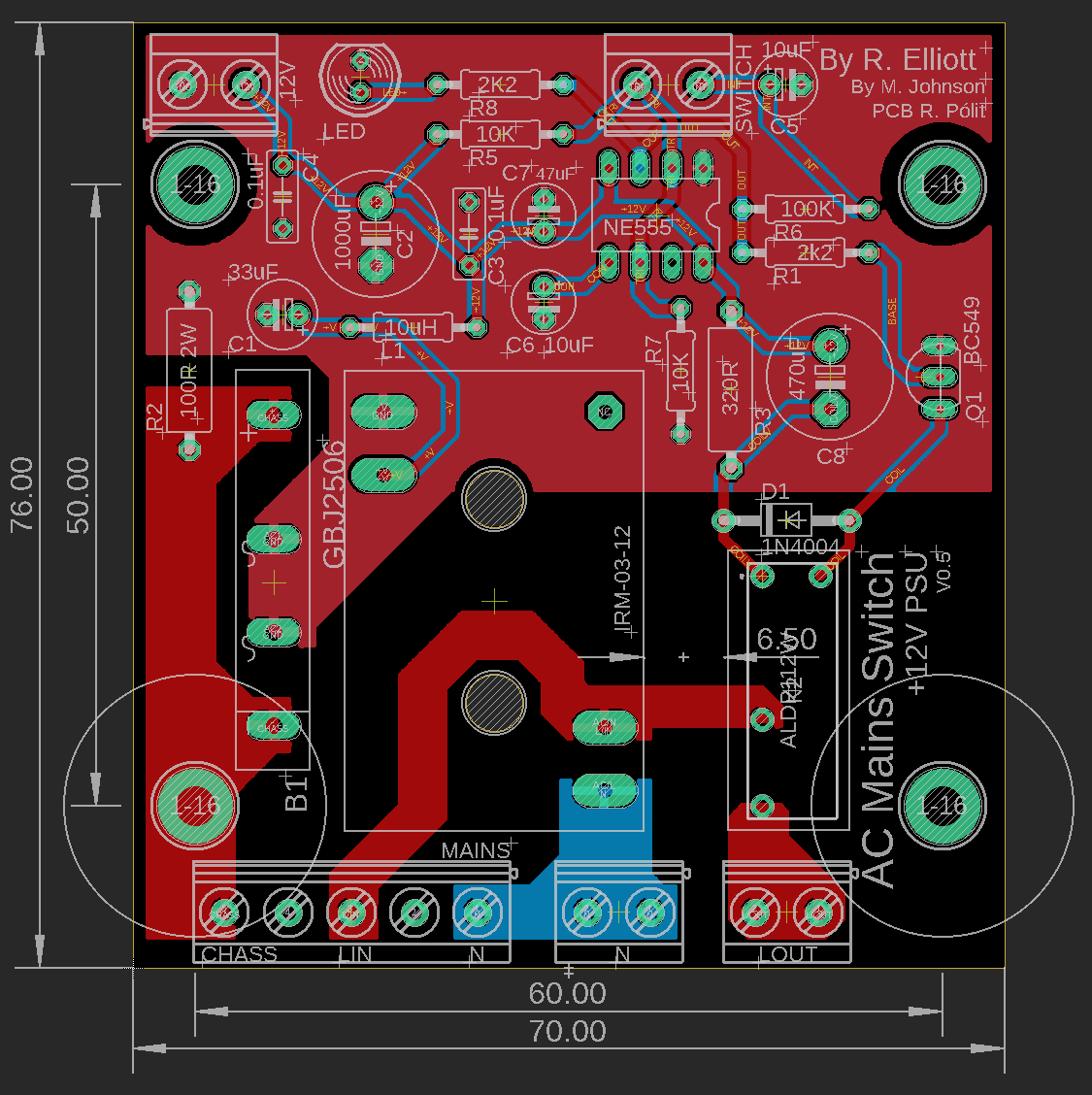

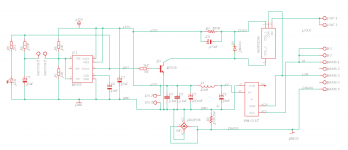

Here is the full board and schematic with the reversed L/N on the IRM:
What do you guys think? Any crucial (or minor?) errors still present?
I added a 12V out terminal, it was always part of the intention to get a 12V PSU out of this. In the previous iteration, that was accomplished by the "breakout" connector that accepted the control out back. In this case, since that is already built into the system, I have now added an extra terminal.
Of note:
  • Now that all is on a single board, I removed the extra 10K resistor suggested in post #2 by Rayma. I hope that was the right move?
  • I added a extra 0.1uF capacitor next to the 12V output, mimicking Mark's 3x0.1uF placed on different places. I did comment on the original post that my initial research pointed that these were spread out to prevent oscillations, but no one either validate or contradicted this assumption / research. Perhaps this addition is a good place to ask again?
  • The new relay has a 720Ohm coil, so I have upped the resistor value of R3 to 680 on the schematic, the PCB still shows the old value, but that is just a marking.
One additional question: on JPs PCB, he has doubled the traces for L/N/Chass on both top and bottom layers (as I have done with the ground plane). Is this a wanted addition to double on the layers in order to have more copper area for the lines? Or is it "safer" to have them like this version 0.5 I am presenting here with them "alternating" one on the top layer and one in the bottom?
They do adhere to the 7mm / 3mm spacing discussed previously, so they could also be a single layer solution for the L/N/Ch traces.
Thanks once more! Best regards,
Rafa.

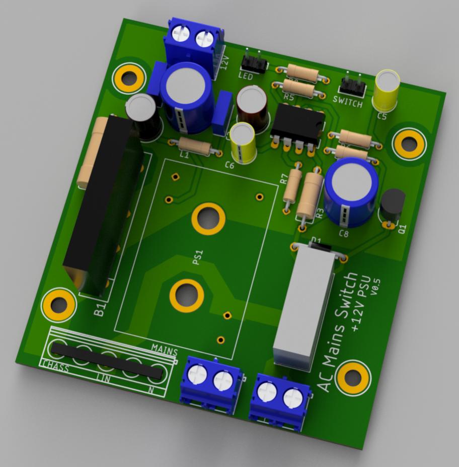

Rafa, the board looks good. The 12V connector is at a "corner" which is unusual. Also uneccessary as the connector for the switch can be moved to the right a little, just like C5, R8, R5. You could consider to use SMD resistors 0805. Gut feeling says to use a somewhat more sturdy transistor to drive the relay like BC337. As the LED will serve as a power LED it serves little purpose on the board as mains voltage boards are usually at the back of a device. A molex KK connector (2.54 mm pitch) for a 2 wire cable assembly with a front panel LED seems more appropriate. Or, if it only serves to show correct functioning then an SMD LED could be used. Or both, in series!
The connector for the switch could also be a Molex 2.54 mm KK connector. Since no current is switched there will not be any thick wiring necessary. For some reason I think it is pleasant to use Molex KK for low voltage purposes and Phoenix MKDSN for mains voltage purposes. One can not make a mistake then.
I am sure the guys at Mean Well will have a laugh when you ask if L and N can be reversed.
Thanks once more.
I think the KK connectors make for a nice improvement. For this particular design, I am going to avoid SMDs. Regarding the transistor, is BC337 a direct replacement in this circuit? Or do I need to recalculate the 2K2 resistor and potentially other places to have it working correctly?
Since that part I am following the P166 to the letter, I haven't yet studied such alternatives.
With that pending, here is the board with some of the suggestions you made:
I ended up using 0.8mm traces everywhere on the "top" part of the circuit (not the mains and chassis, we have discussed that already, those are fine 😛 ). Is it better? Should I revert to 0.4mm? It doesn't matter?
Thanks for any feedback, best regards,
Rafa.
ps: the large IRM PSU brick is omitted from the rendering as to be able to see something! 😛 And I haven't yet found the nice 5x euroblock connector model, so it's a boring block there in the bottom. 🙂
