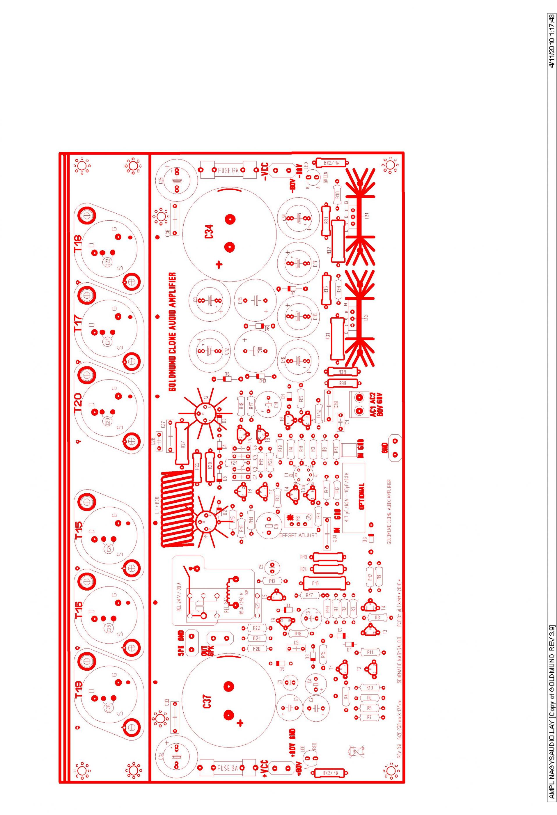

I have get files from Alex and everything are OK. But it seems that we are experiencing a bias problem (If you are following the main thread all the way thru, you should have noticed it in the main link). Guess what we can do is wait now.
BTW, I have tried to change Alex's work a bit. I have printed the components ID instead of the value on the pcb : R15 in stead of 100k. Wonder which would you guys prefer?
We are now definitely going for the TO-3 version. If any buyer is not in favor of this, please state. Like I said, if there are enough TO-P votes, we may still be in business.

Bigpanda - The BIAS resistor is R23 in the schematic. Goldmund uses a fixed resistor because it sounds better. Since we are using TO3 MOSFETS, the BIAS resistor should be 330 ohms. If they were plastic, it would have to be lower. As it is now, it takes the guessing out of the equation. Of course a variable resistor can be soldered in and adjusted in order to have a specific temperature on the MOSFETS, then measured and a fixed resistor could be finally soldered in.
Bigpanda - The final pair of boards should be mirror image? Correct? Otherwise one channel's speaker output wires will always be longer than from the other's...
Hi Nagys,
As far as I can remember about adjusting the bias for my previous projects, I always measure the current flowing into the outputs not the temperature of the outputs. This is beyond my experience on this subject and it's better you have a more detail explanation of the procedure . Even if you had adjusted first with a pot, you might not be able to get a fixed resistor with the exact same reading on the pot.
There is only 1 pcb layout. I never thought about the question you have raised : the difference between the length of the path from board to speaker output terminal.
Here is what I had done with the value of the components. Haven't yet seriously check for error but will do it before Friday.
