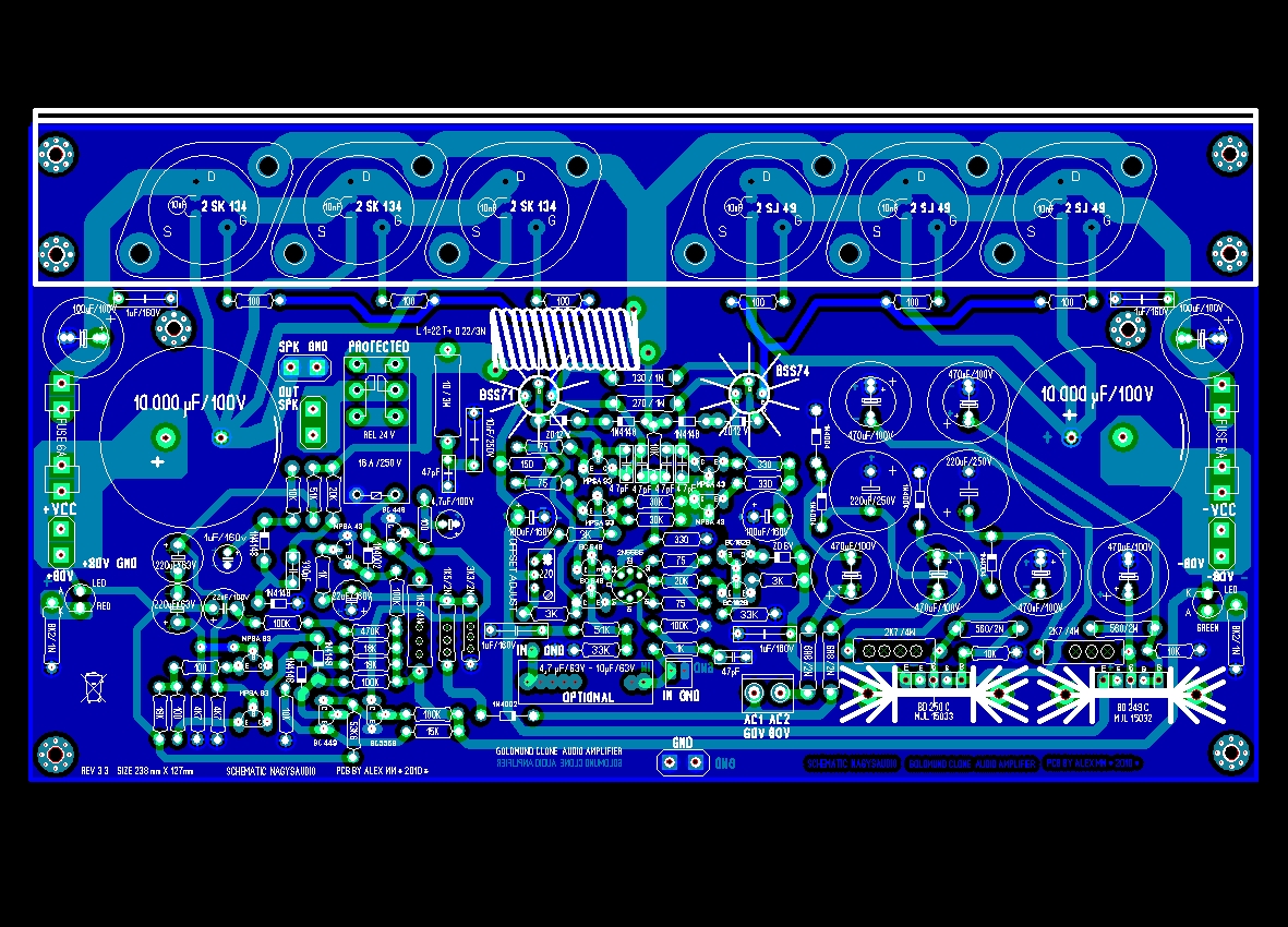

Nagys,
Do you think it is better if we have components' ID on the board rather than the value itself. If I have the sprint files, I can change into that. Let's leave alex out of this tedious work. Should take me less than a day's work to do it.
Bigpanda - I really have no preference one way, or the other. Go with whatever you think will be easier for most builders.
Alex has created his latest PCB which will now use TO3 MOSFETS. He has done an incredible board. Unless anyone objects, I strongly suggest that we go with the TO3 PCB. Metal can MOSFETS sound significantly better than plastic MOSFETS. These are readily available from nearly all electronics distributors including Newark and Farnell. Here's a list of some readily available equivalent MOSFETS to the Hitachi 2SK134/2SJ49:
Magnatec BUZ900/BUZ905
Magnatec BUZ901/BUZ906
Exicon ECF10N16/ECF10P16
Exicon ECF10N20/ECF10P20
Here's the latest beautiful PCB from Alex:
