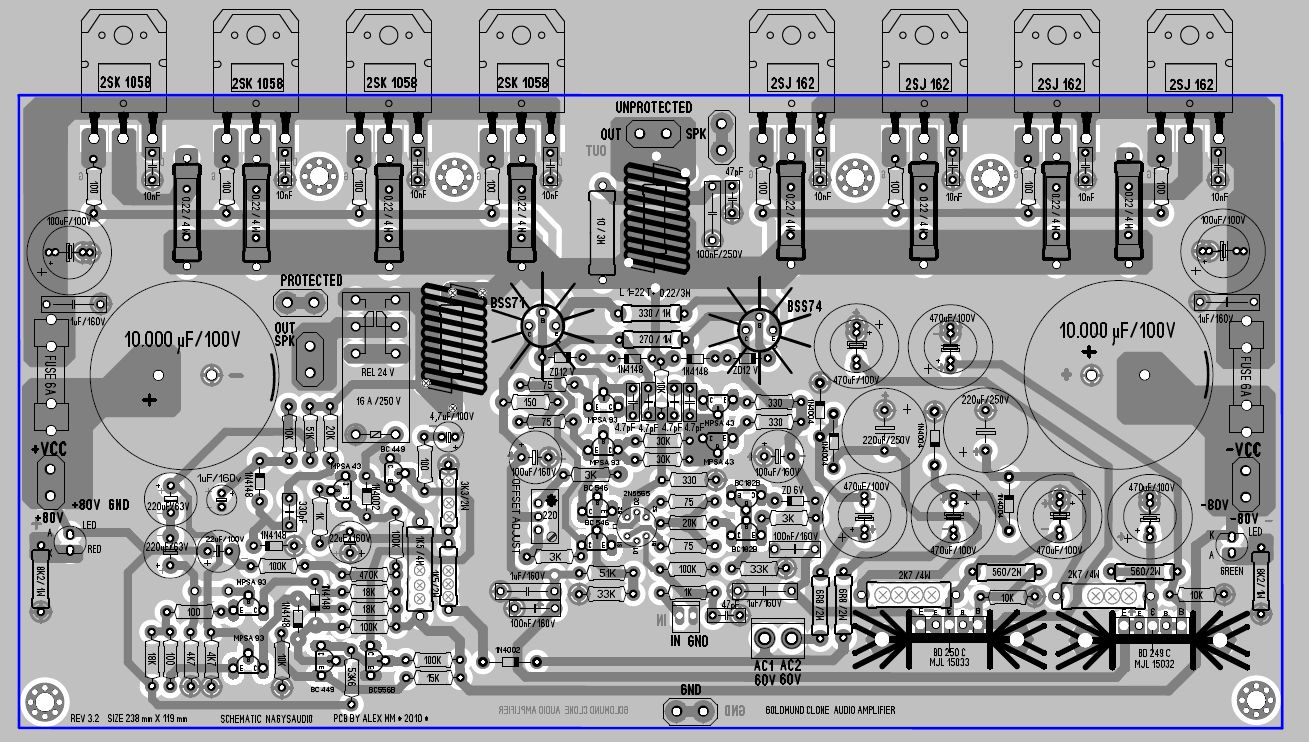

Here's the latest PCB layout from Alex. Everyone who's on the group buy list, please compare it against the original schematic (see attached) for mistakes.
I personally think this PCB is done. The only concern is the grounding scheme. Will everyone be satisfied with all ground points going to the ground plane?
If you see any mistakes, or want anything changed, please speak now.
i think better to use optional Hole for capacitor 10.000 uF/100v on schematic..can fit other type caps leg. thanks
Looks as though the design has finally settle down.
Material : 1.6mm FR-4
Copper : Double side 2oz
Finish : Tin Plated
Silkscreen : Black on top layer
Resist : none
Cost : $35 / pair
Shipping : $6 / pair
If you found any information missing from the above, please notify me.
