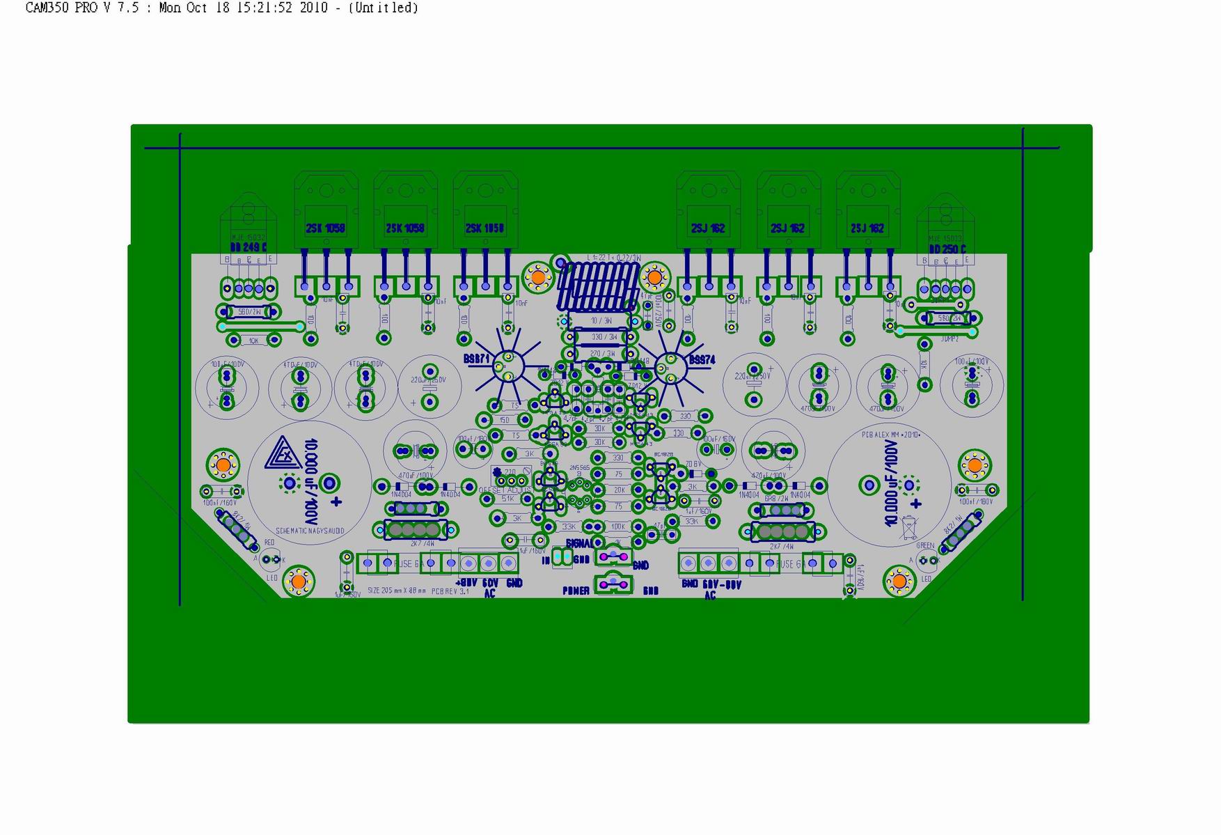

I am having some progress in the top copper layer now but I am still stuck with the bottom copper layer. The gerber it exports cannot be read by my CAM350 and the program just hangs while reading the gerbers.
ground plane for pcb
Here is the result of my weekend's work. Sorry it is in pdf format because my print-to-jpg software (Polestar Virtual Printer in case if you want to know or see how it works) is crazy. It sometimes give me the wrong color or some missing lines. Anyone can suggest a better software for that purpose? The grey area (not in your brain) is the top copper plane. Take a look at the 4 red squares.
There are still some problem with the bottem copper layer when exporting to gerbers. Hopefully I can solve that in 2 to 3 days time.
in Post#698, Godfrey talks about the long power ground path. I think I will take that off too (the red and the light green paths) so that every components would go to the power ground (it will be a ground plane after admendment) thru one of their leads and right at where they are located.
I am just wondering what I should do with the signal ground. If it is going to be the way I show in my attached pdf, it will be all (signal and power) connected together, not exactly like what was first intended.

You said you have to solder things onto the ground (power) plane. Just what exactly are those. Can you enlighten us with any photo. As far as I can understand, we are not soldering (or not necessary) things onto the plane itself, just the thrugh pad on the soldering side. Would you be talking about some additionals. Just want to know what is bothering you with a top soldering mask. It will be easy not to include the top soldering mask, it's just unusual to do so.
bigpanda - Goldmund does not separate signal ground from power ground. As a matter of fact, every single ground point is soldered directly to the ground plane in the Goldmund amplifier, i.e. transistors, resistors, power supply from the bridge/transformer, negative terminal on the speaker output, negative terminal on the signal input, etc. Everything is soldered to the ground plane. Without the solder mask, it would make thing a lot easier, The ground tracks on the bottom of the circuit board are not even needed, but they are nice to have. It depends on how each individual builder wants to use the ground. I will probably only use the ground plane and nothing from the bottom of the circuit board.

bigpanda - I would leave the ground traces on the bottom of the PCB. Everything can be soldered to these ground traces, the power and signal ground can be connected with jumpers, and the ground plane can also be connected to the power ground and signal ground. See, this way there are a lot of options, because each individual builder might want to build their amp differently.
If you do take the signal and power ground traces off of the bottom of the PCB, then the ground plane would have to be preferably modified slightly. All the ground places should have the metal going all the way to the components leg, so that it can be easily soldered from the top.

bigpanda - I thought about this would like to request that you please leave the signal ground, separate from the power ground, plus the ground plane just like in Alex's original PCB design. I think this is important because it's more flexible and will give more options to potential builders. Some people like the signal ground separated from the power ground, those who don't like it can connect it with jumpers. This way it makes everyone happy and gives lots of options when building this amplifier.
bigpanda - Sorry for so many posts. I would do the ground plane like in the .pdf you posted in post #24, in the red boxes. That's exactly how Goldmund does their ground plane. Even though this connects signal and power grounds together.
What do you think about also leaving the signal and power ground tracks on the bottom of the PCB board? I think we should leave them there, for more options. Builders who want to separate either power, or signal ground, can scrape off the little metal PCB tabs around the components holes. What are your thoughts?

I would say top ground plane will be power ground (as I had done) and the signal ground remains as alex's design. 2 connectors at lower-mid board (as in alex's design also) which can be connected or seperately connected to outside. Not really necessary to keep the power ground trace. Should be able to finish them by to-morrow.

I would still keep the power ground trace. Simply because of more options that can potentially make it easier to build. For example, I can easily solder all the resistors and transistors to the ground plane from the top, but what about capacitors, especially the big power supply capacitors? It might be difficult to solder those to the ground plane from the top. It can be easier to solder to the power ground trace first and then connect the power ground trace to the ground plane, if one choses to do that. I just think more options are better.
Also, can we leave the solder mask off from at least the ground plane?

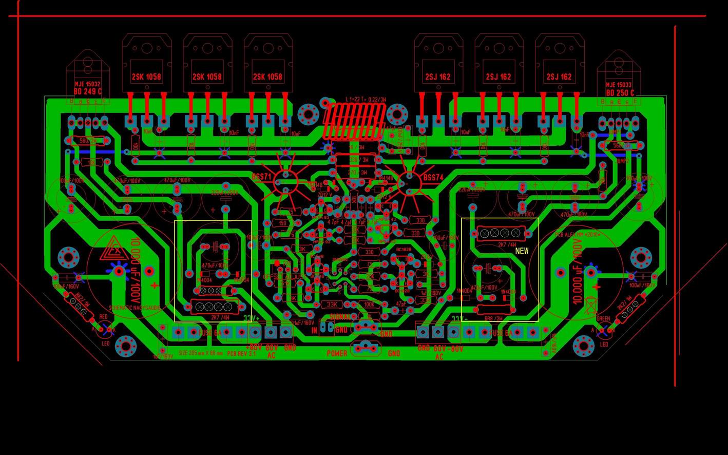

Board layout 90% ready
Result of 2 days work :
Please also comment on the very last one. I found the traces are more clear cut but not as artistic as Alex's.

Bigpanda - Here's what one of the members wrote and I completely agree with him.
"I've had just a quick look, the fuse on the PCB is ON FRONT of the big cap (4700uF) (not between C31 and C32) - on switch-on it could burn - unless a "slow" type used (?)"
This fuse should definitely be between C31 and C32 like in the schematic and it should be 10A. Can you please see if you can fix it. Thank you!
