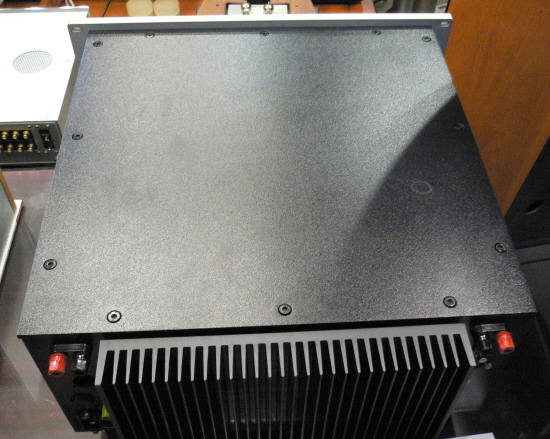

Heatsink of the Mimesis 9 : www.novosite.nl/editor/assets/highender/Goldmund Mimesis 9-1.jpg
Fischer SK56, the most frequent used heatsink type in these parts by both pros and sick home builders.
12" wide x 6" high in the Mim9 : 0.36 C/W
80V rails x 50mA x 12 devices makes 48W quiescent heat.
Enough to push the heatsink to +40C, without playing a single note.
The early Goldmund models had massive steel cases : high mass => high damping.
Anyone who ever made something in steel knows it's a pita to get a decent finish without visible scratches, the reason why Goldmund gave the amp cases the classic Eeew Mucus look : www.kaudio.co.kr/Gnu_Base/data/cheditor4/yongsan/1141616498.jpg
Downside of that stuff is real bad thermal conductivity.
Goldmund tops that off by hatching out the back of the chassis, and attaching the heatsink to the case poorly, in a thermal sense.
Again primarily vibration damping motivated, not thermal.
Plus, not a single hole in any side of the amp.
Great for keeping any dust out, but also prevents any heat to gently flow out : each Joule generated within the case has to invade the chassis for a chance of escape.
(the Gold Cubes were an entirely different ball game, but how many are willing to shell out a full size sedan for a pair of Rubik blocks)
