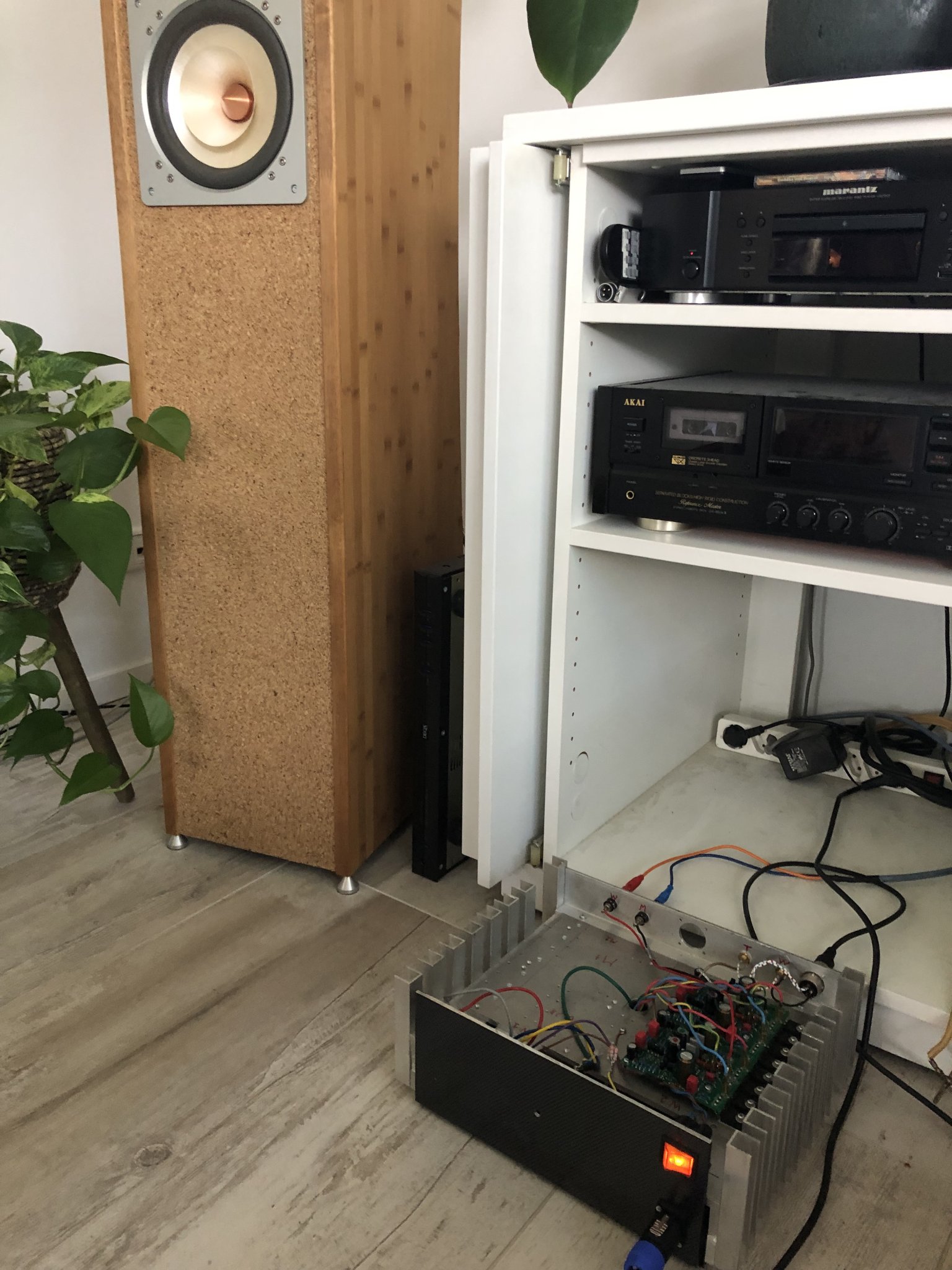

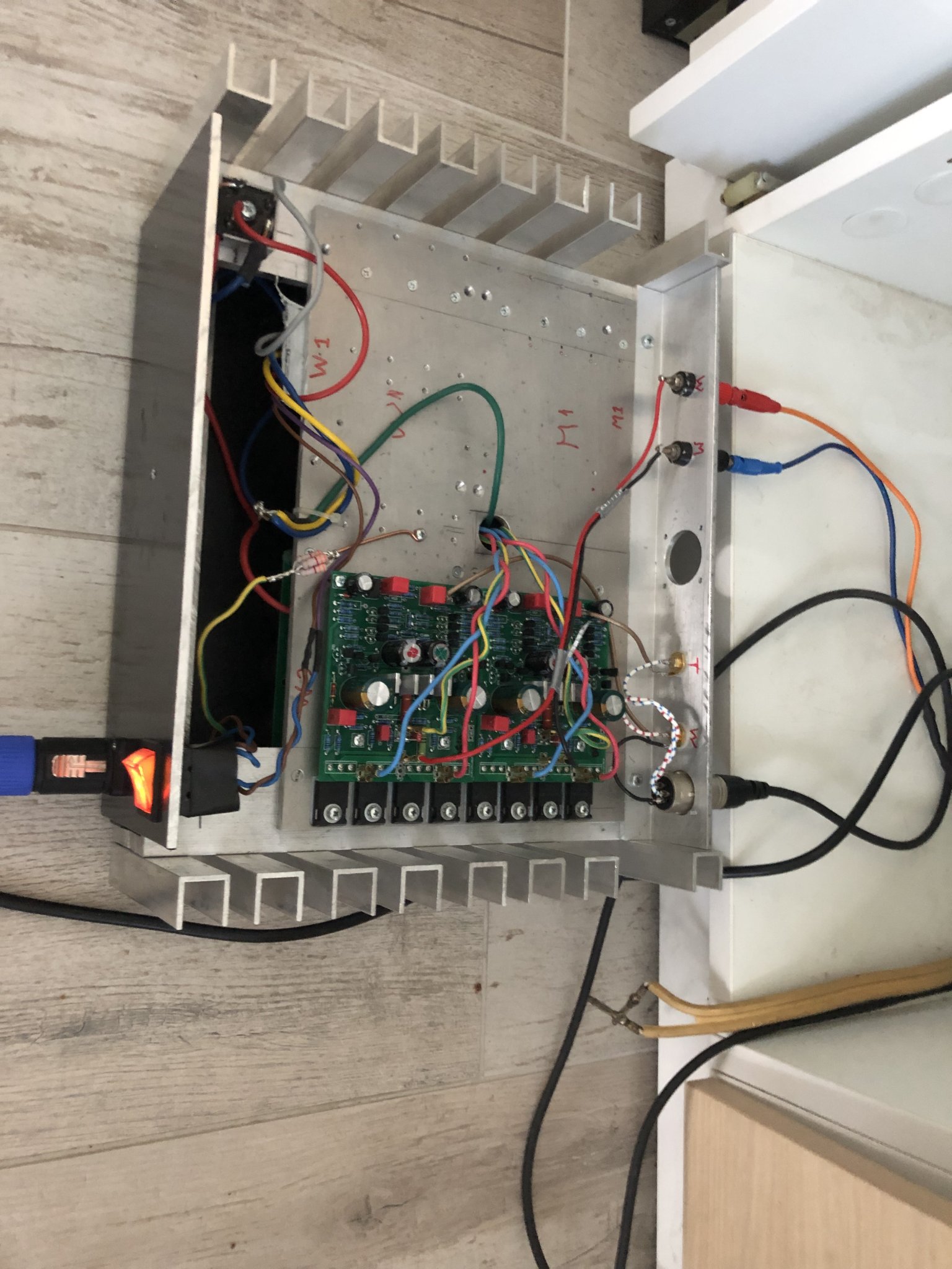

All…I have redesigned the pcb and corrected thr mistakes as well as the mistakes that were in the design from John (Hawk).
I build test channels and they are working as designed.
The amp is a big step up from my previously A18 implementation. More space, darker background and better definition.
The improvements implemented.
1. Corrected the orientation of some parts
2. Increased the space for some caps
3. Added the option to switch between class A and AB by meder relais.
4. Changed the hole diameter to snugfit the amp connectors and better fit for the FETS
5. Removed the connections for the Toshiba fets. These fets have a high Gm and i found it to work less well in an amplifier without feedback.
6. Now used 2mm FR4 boards instead of 1.6mm
7. Now used 2 oz copper instead of 1 oz
8. Corrected and recalculated the servo loop and added a required ground connection.
9. Changed the supply for the servo loop to accomodate higher supply rails.
10. Corrected the artwork to correctly connect the current source fets (J112)
See my new and fully build board:

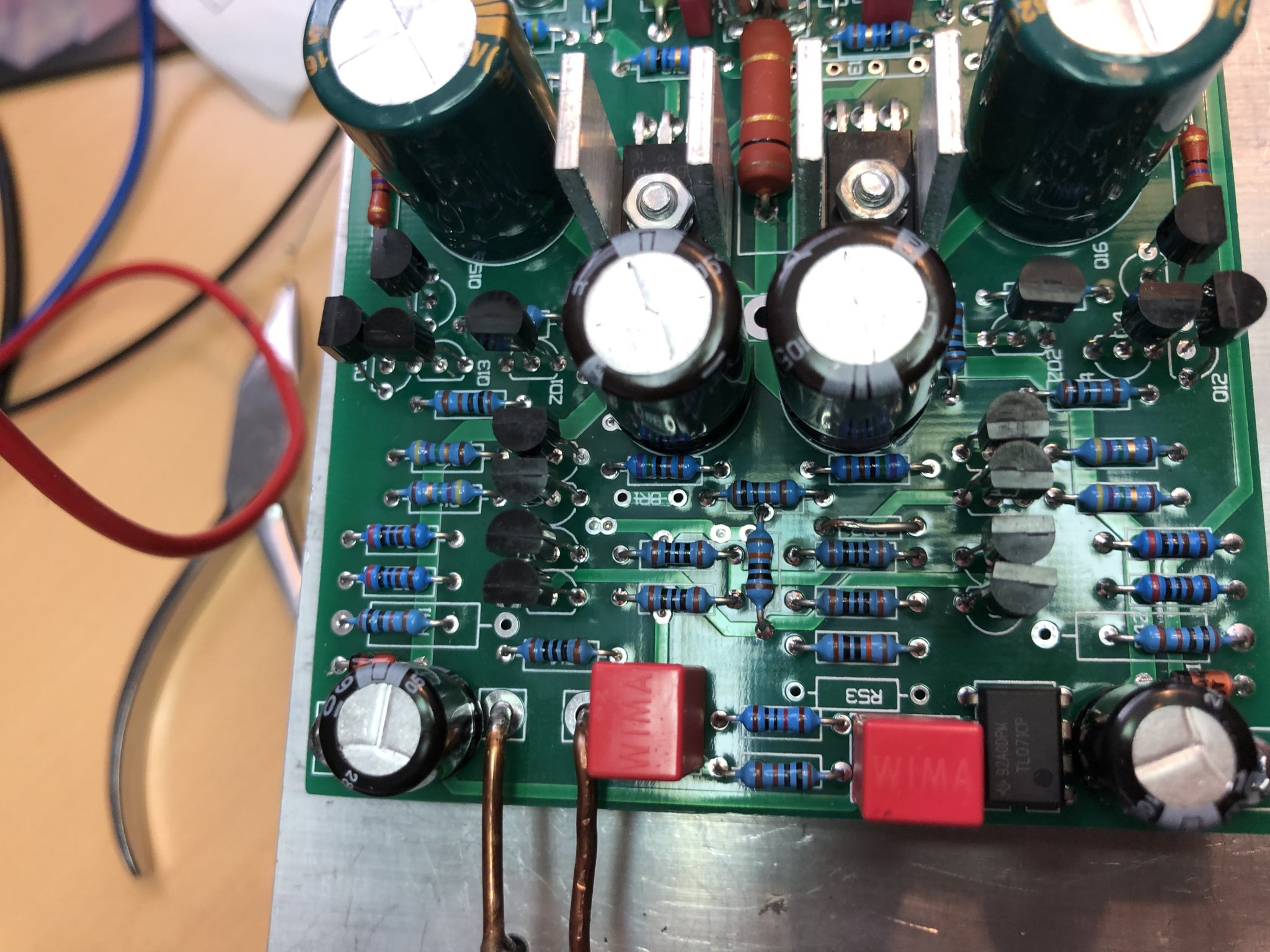

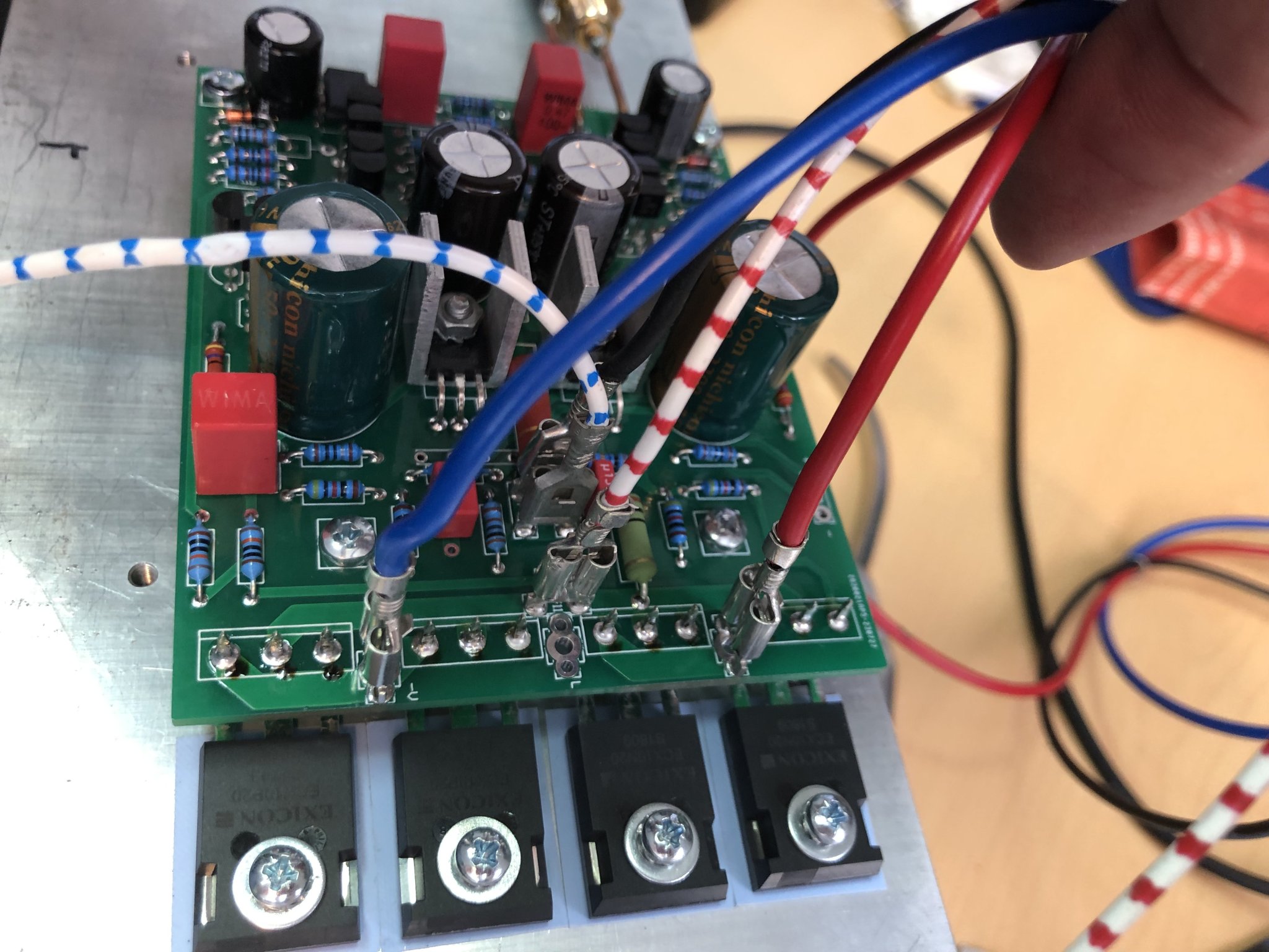

The EXC20N10 and ECX20P10 are used as you can see on the photo.

In the files that were included with the boards I saw on the drawing of their board that Hawk Audio, just like you, only used 1 resistor and 1 capacitor on the cathode of the BD140, and none on te BD139. So I am satisfied. By the way, there was a small error in your schematic ; for the positive voltage to the opamp are the zenerdiode and capacitor upside down.

The zener is correctly implemented on both versions of the pcb.

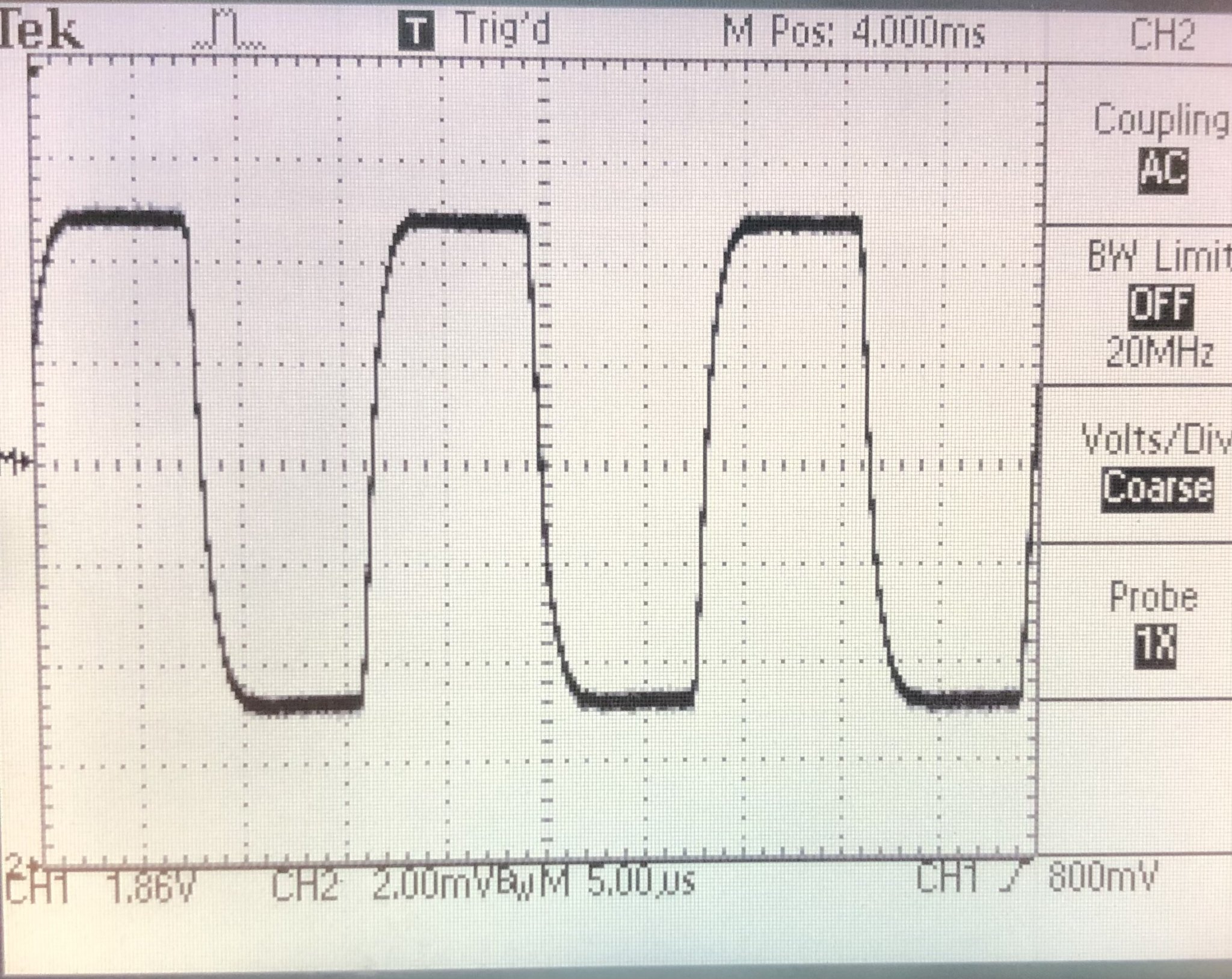

I also looked at the a version with 2 collector resistors and 2 caps and tested in real life. with 2 resistors the dynamics is a tad lower and the BW is a bit lower as well. Tot that that matters a lot as the 60KHz square wave was still quite nice.
