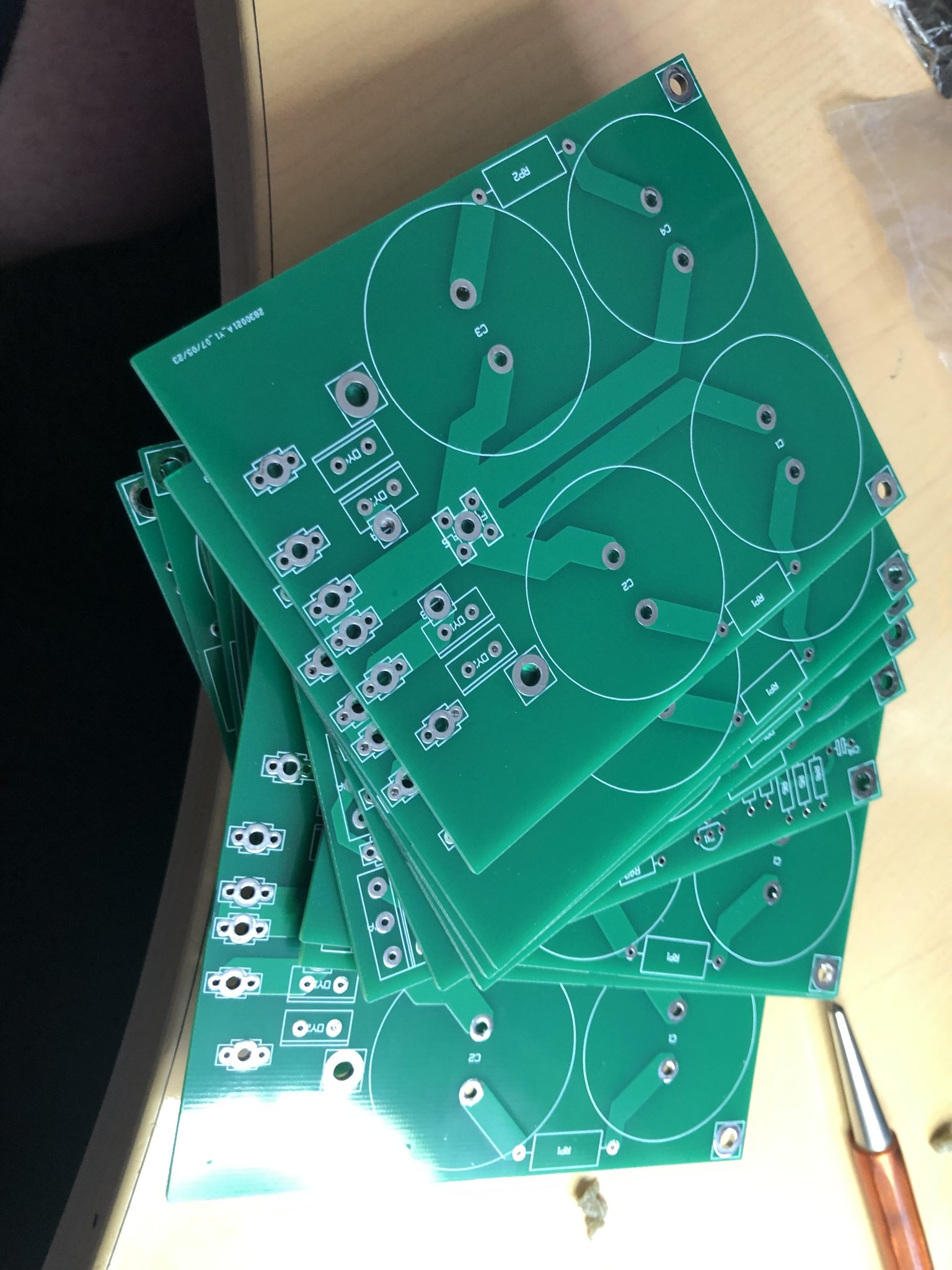

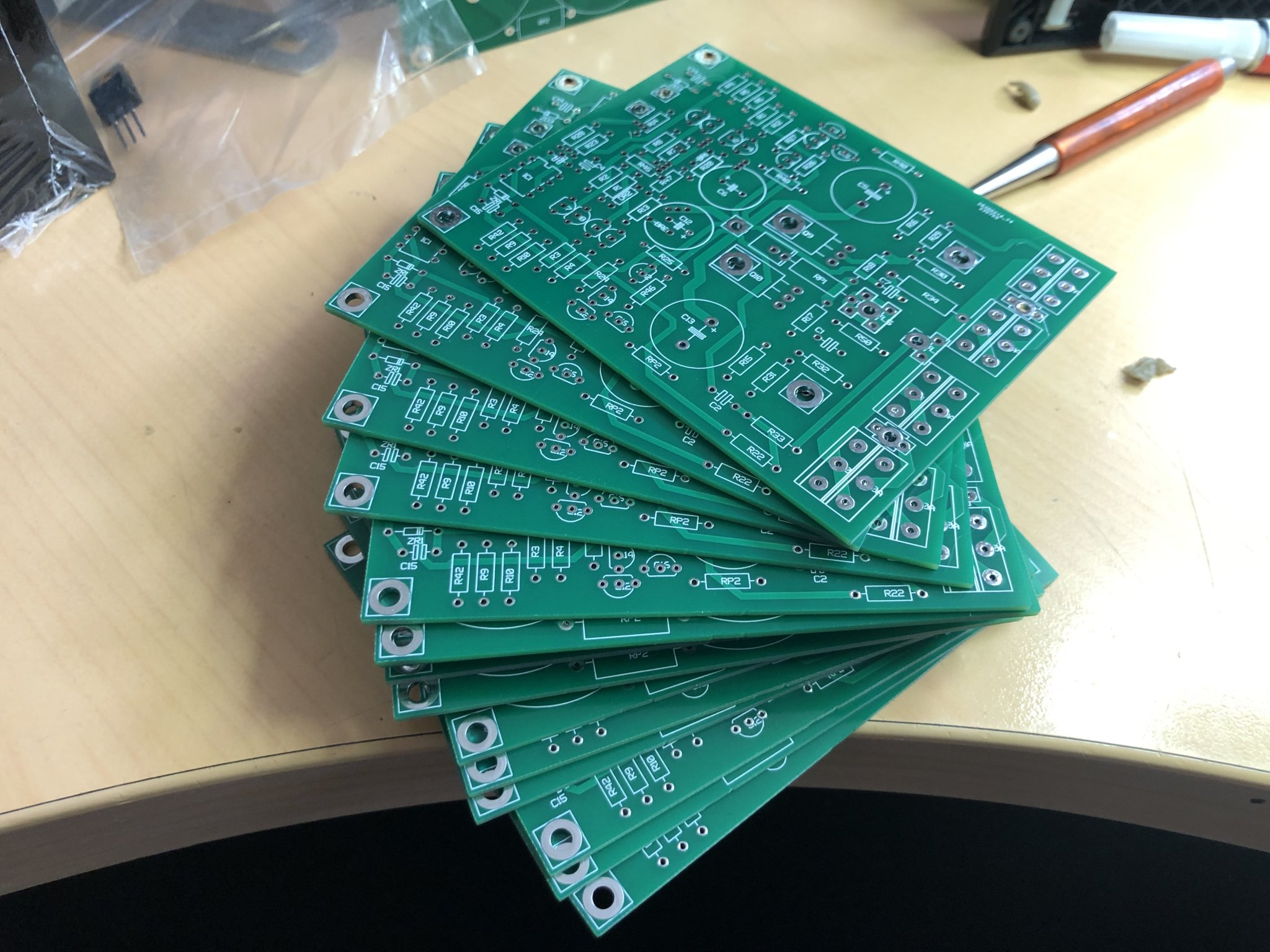

Well Vunce, nice to hear from you. I see the seller has not responded here in this thread - but I can add something. I know you are not the 1st person to ask about the discreet regulation and I have not seen any response to that from Marcel. With regards to the second part of your question - I can help out members here as I ordered a set of boards as per posts #116, then post #122 where Marcel says the board was checked.
Then I got some PM's from him after the boards were shipped as below:
Gary,
There is an error in the orientation of the bc transistors, the lm329 and the j 112.
So pls chek the orientation before placing the components
Marcel
I sent Marcel a PM and asked:
How many components in total have the wrong orientation, as I don't have any documentation and I assume the documentation you sent with the pcb's will not have these corrected updates, it is essential you email me the clear details on every component that is wrong and how they should be inserted in the pcb for correct operation - you obviously need to send this to the other members who purchased the pcb's.
Are you going to correct these mistakes and send new pcb's out?
Marcel's answer:
Q1, Q3, Q2, Q4, Q5, Q6, Q7, Q8, Q11, Q13, ZD1, Q14 en ZD2 need to be rotated 180 degrees. Sthey will still fit the PCB.
So there are at least 13 component orientation errors on this new pcb, and he has asked me to check once I receive the pcb's and documentation to see if I find any more.
You will notice he has gone silent in the tread - so I would be very wary with this.
If you look back earlier in the thread, you will see he made the same type of mistakes in the 1st design, which I might add were highlighted by another member and not Marcel himself.
Overall a very bad experience, buyer beware!!!!

Unfortunate there are some small errors in the silkscreen. Gary forwarded the specifics. There is also a small error in the pinout of the 2 fets in the voltage stabilizers and the track layout. This is because i mixed up the j112 originally specified and the 2sk246 that i intend to use.
