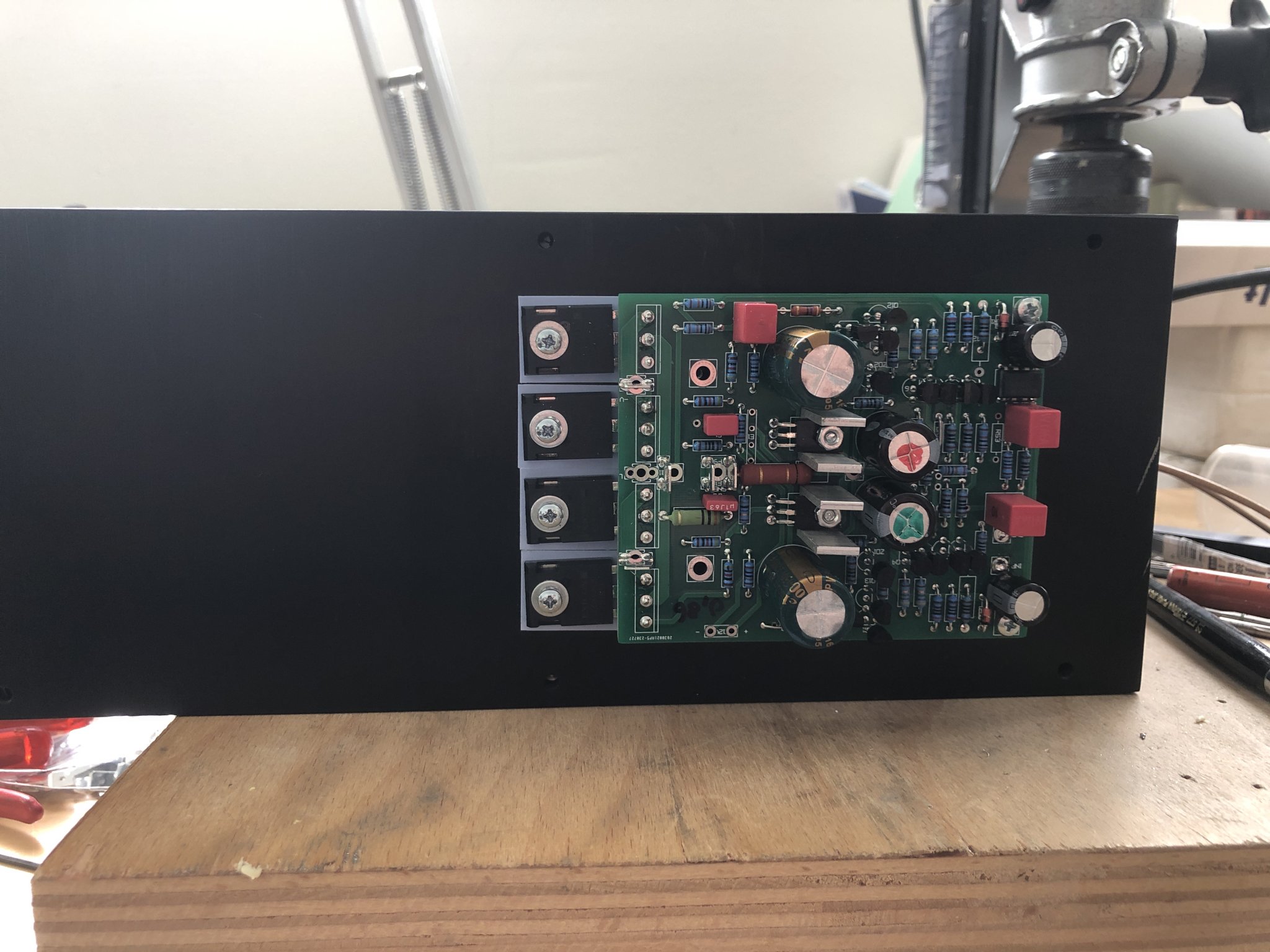

Me again, sorry,
On top of the schematic you wrote ; for Exicon fets R17 + R18 = 240 ohm. IQ = 0,3 A/fet
Does this mean if we use Exicon fets each resistor is 240 ohm , or together 240 ohm ?
It's quite different than the values on the list; R17 is 1600 ohm and R18 is 80,6 ohm.
Please explain
Jurjen

The resistor numbers: I have changed the resistor references so now the PCB references are matching the schematic references. R28 is no longer on the board.
The two bias resistors R17 and R18 are on both the versions of the PCB's. R18 is 80,6E and the other is defined by Hawk as 1k6. However that puts the amp in deep class A (~1,6A per fet) with the Exicon fets. The max dissipation of the fets that I'm confortable with is around 15W per fet. Given the fact that I'm using 35V supply's, the max bias I want to apply is ~0,4A per fet. For my fets that comes down to R17+R18 to be 240E
I've build a channel where I used a 1K pot instead of R17 and adjusted it to the value I intended to use when the amp is on normal working temperature. In my case this was 160E for R17
