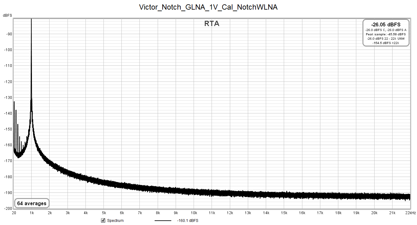

The reason for reducing the resistances in the filter was noise: as per LtSpice, filter with 10nF has in the freq. interval 10Hz-20kHz an integrated noise of 1.04uV, whereas the one with 100nF has 332nV, i.e. 10dB less.
In comparison with the input noise of Groner's LNA (0.39nV/rtHz), filter noise clearly dominates, and the net noise floor reduction at the LNA output is thus 9.8dB.
Enclosed is a THD measurement of the Victor's oscillator at 1Vrms, followed by my 100nF Hall filter and Groner's LNA.
