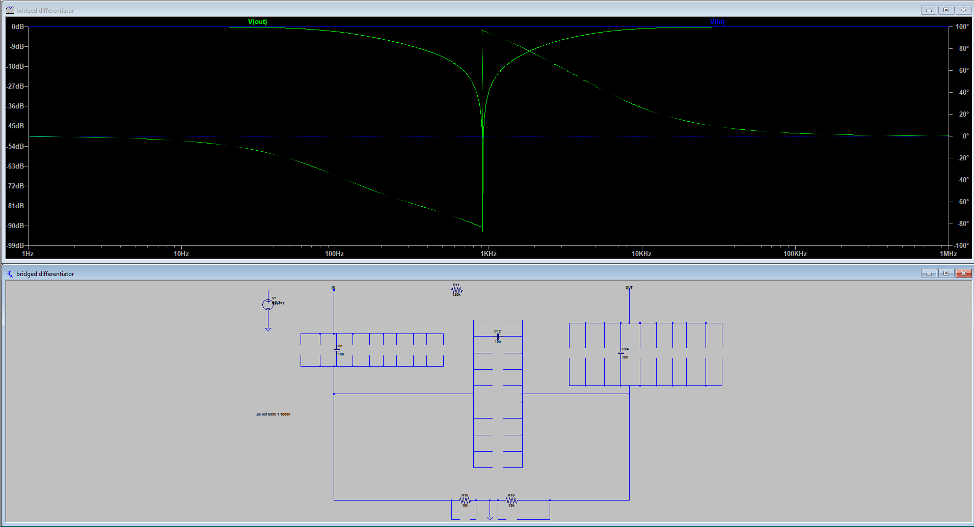

I built a stupid little spreadsheet based on Ken Kuhn's article on Hall Networks
http://www.kennethkuhn.com/electronics/design_and_applications_of_the_hall_network.pdf
interesting to play with before building

I'm afraid the Excel formula in the cell G6 is not quite correct - if you use =1/(2*PI()*D5*(C5*0.000001)*SQRT((3))) instead, it will give you the correct notch frequency of 918.88Hz for the untuned filter.I built a stupid little spreadsheet based on Ken Kuhn's article on Hall Networks

Braca
I don't follow the assumptions you have used
are you referencing the Kuhn article and equations?
( with the scaling you use you should use C6 not C5 )
FYI I am using open office calc to write this, not supposed to make any difference on simple spreadsheets, but....
OK, still not sure of your assumptions, probably you're better at math than me and reducing equations (not surprising). But I did find two stupid mistakes in my original file (since corrected)
one was notational about PI and the other was me being stupid. No, R*R is not 2R, oops.
Hey, if you want better coding have my sister write it, she writes code for Fermi Lab.
Anyway, I fixed my errors and the formula now gives the same results as DNI's while maintaining the original form of the equation.

I apologize for not having explained the expression I posted. It is a mathematical equivalent to Kuhn's Eq. (3) for the case C1=C2=C3 and R1=R2.OK, still not sure of your assumptions, probably you're better at math than me and reducing equations (not surprising). But I did find two stupid mistakes in my original file (since corrected)

I've been programming all my life and when I see a mathematical formula to be programmed I instinctively simplify it for faster execution and a shorter statement.
The full formula will be needed if the effects of components' tolerances upon the filter performance are to be studied.
Incidentally, there is a neat tool for calculating resistor combinations that will be needed for tuning this filter. It certainly saved me quite a lot of time:
