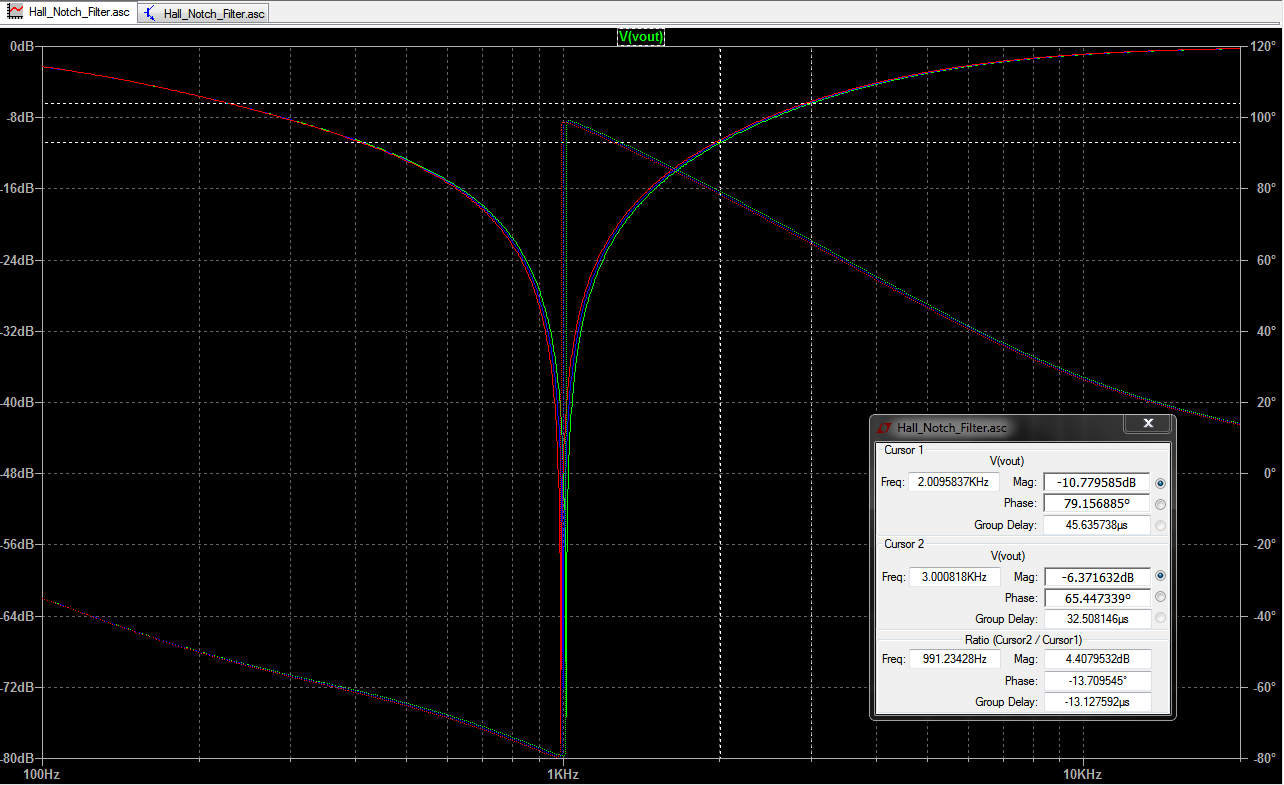

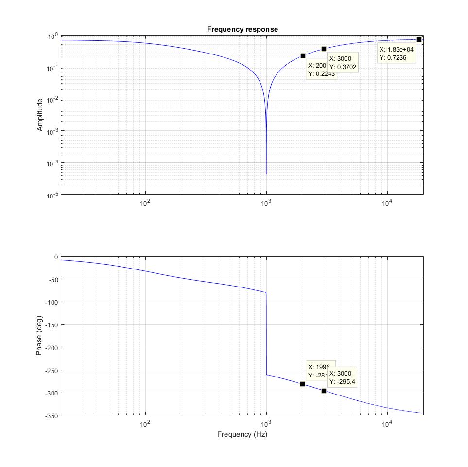

Well, to give it a push, here are the simulated and measured transfer functions of the variable (990 - 1010Hz) version of this filter, set at approx. 1kHz.
The measurement was made by feeding band-limited (20Hz to 20kHz) white noise signal from my B&K 1405 Noise Generator, and acquiring a long record of both the filter input and output with an audio card in 24/48 mode. The transfer function was then calculated in Matlab over a signal length of 500 seconds. The goal was to estimate the attenuation of the higher harmonics (needed for the THD measurements), and compare them to the simulation results.
The agreement between the results is very good. If the measured filter insertion loss of -2.8dB is added to the simulated value at 2kHz, i.e. -10.8 +(-2.8) = -13.6, the difference between the measurement and simulation is only 0.6dB, which is not bad given the modesty of the measurement setup.
I wish you all success with the filter!
