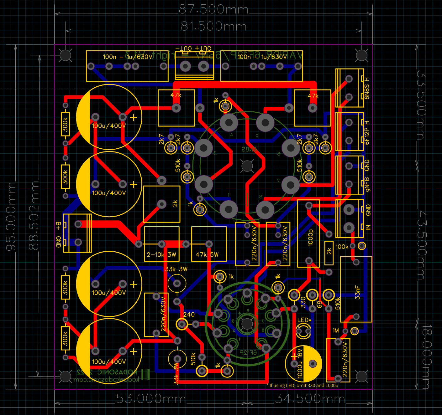

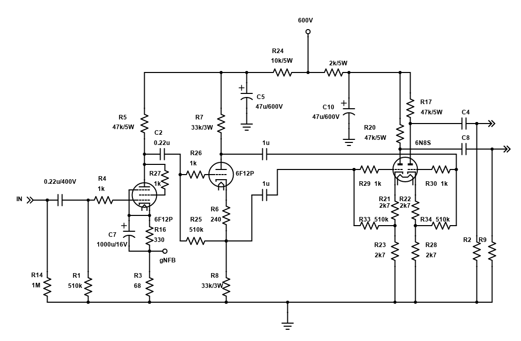

I'm weird. I lay my schematic out in SchemeIt (Digikey) but draw the PCB in EasyEDA.
So this:
Turns into this:

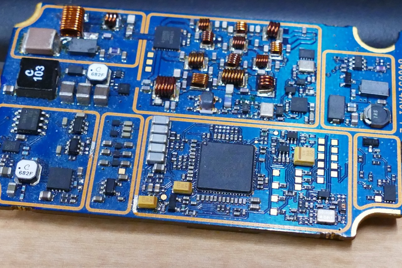

I did PC boards at Motorola on Mentor Graphics tools for about 20 years until they decided to switch to Cadence. I did exactly one board in the Cadence system before retiring in 2014. It is the RF deck for a two way radio prototype and is seen here. There are over 600 components on a board roughly 6 square inches in size. This board is a 10 layer 2-6-2 HDI board. High Density Interconnect technology uses a conventional board in the middle (6 layers in this case) and two (in this case) or more layers of what is essentially photomask with laser drilled holes for high density routing for the outer layers. This is often the only way to route to every pin on a small BGA chip with say 144 balls. The purpose of this board was to evaluate the super secret custom CMOS RF chip that our group designed in a real working two way radio. The chip it the one with no markings in the center of the first photo. Another chip was developed after I retired to replace the hybrid modules in the brass cans and their controller chip. This technology is now a full fledged product.

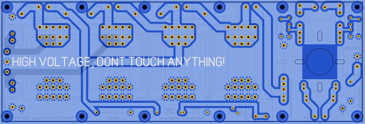

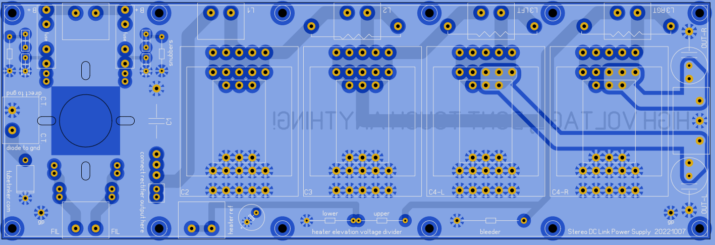

Here is my latest, a power supply LCRC (to split LCLC stereo) filter train that uses DC link capacitors, vacuum tube rectifier with socket over an open hole, on board quasimodo snubbers, on-board heater elevation voltage divider reference, fuses to protest the power transformer secondary, bleeder resister, etc.
Bottom side (note tube rectifier mounts on this side over the open hole and oval mounting screws for saddle) it will accept octal or 9 pin rectifier, I managed to do this board with only two traces needed to go on the top side to do a hop:
Top side

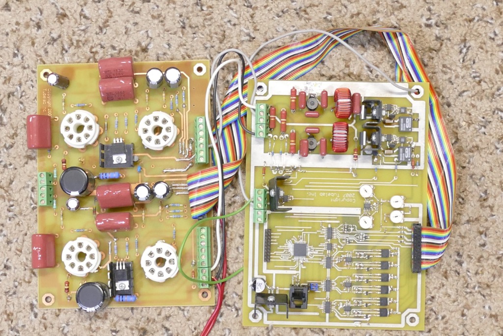

Back in 2008 I submitted a complex electronic design to a contest that ran in Circuit Cellar magazine. It involved a single ended vacuum tube audio amplifier with a modulated high voltage power supply all controlled by a Microchip dsPIC chip for a serious improvement in operating efficiency. This won a prize in the contest and a published article in the magazine. These concepts were taken from some high efficiency RF amplifier work I was doing at the time and were largely ignored or shunned by the vacuum tube amp aficionados.
There were two PC boards in the design, one contained all of the vacuum tube circuitry while the other contained the low voltage opamps, microcontroller and isolated modulated power supply needed to transform a class A SET into a class H SET. Both were done using Eagle in 2007. I have recently awakened these boards from a 15 year sleep in a closed cardboard box for a possible redesign using more a modern and powerful controller paired with one of my newer SE amp designs.
It would be easiest to do the tube amp board in Eagle since I have several existing designs to start from. The digital board is a different story which will likely be a learning experience for Kicad or possibly another tool if I hit a roadblock.
