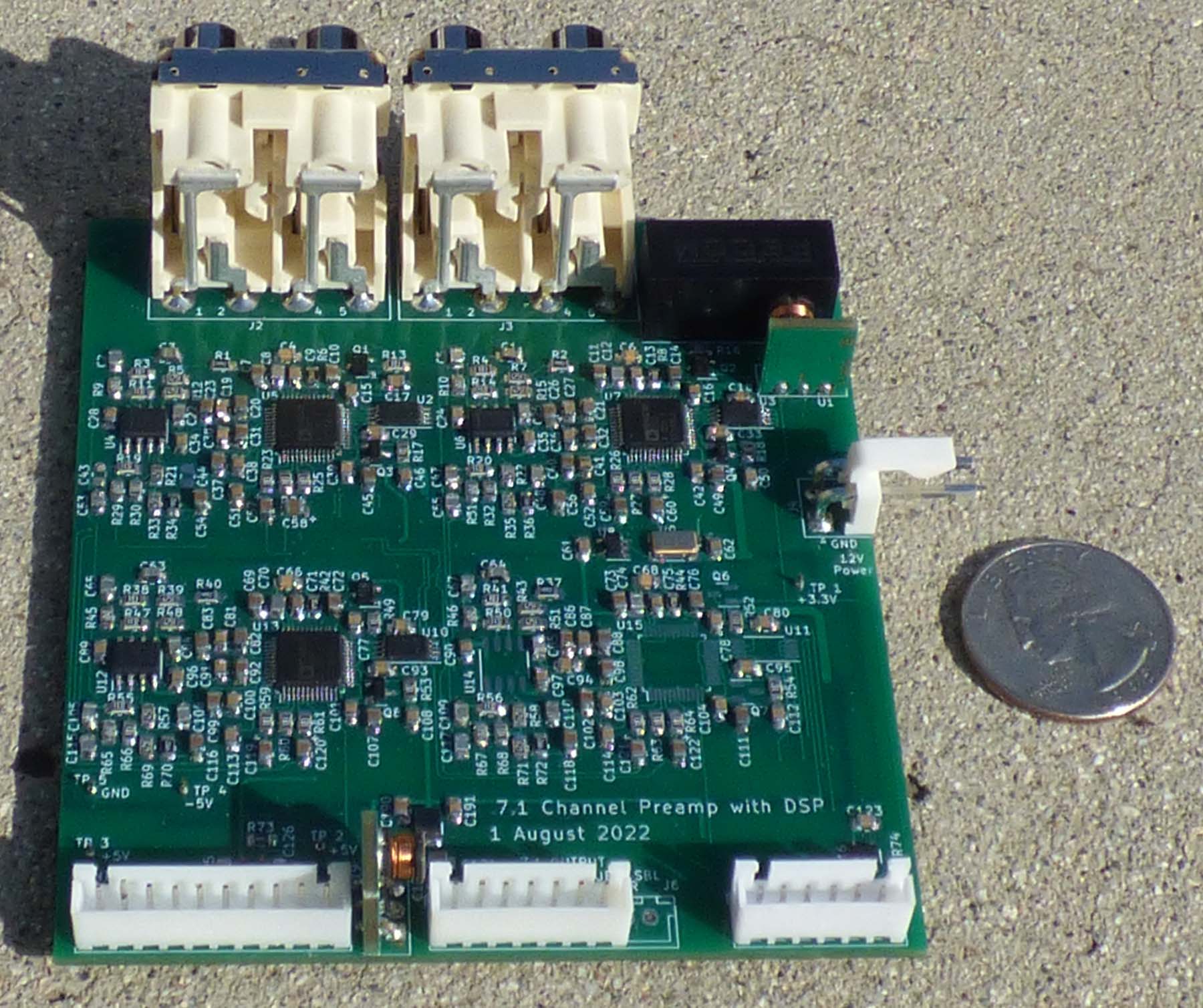

One of my first PCBs was totally by hand as it was designed BC (before computers). It is WAY tooThat's not a good workflow, though. It's way too easy to make a routing mistake that way. And you'll route from a schematic anyway so why not just draw it in the CAD tool so you have access to forward/back annotation, LVS, etc.?
Tom
easy to make a mistake and not see it. You just decide it is right and keep missing it. I swore I
would never do another PCB because it's too intense to keep everything straight without someone
else to double check. Then I got Tango in '89 and tried another board. A netlist is your best friend
along with clearance checks then renumbering so it can be assembled by a human. I partly automated
it in Tango and could manually renumber a board of 950 parts by lunch. KiCad 6 now includes
renumbering that takes seconds.
Your workflow encourages no mistakes and if you do, it's a LOT easier to get the next revision out.

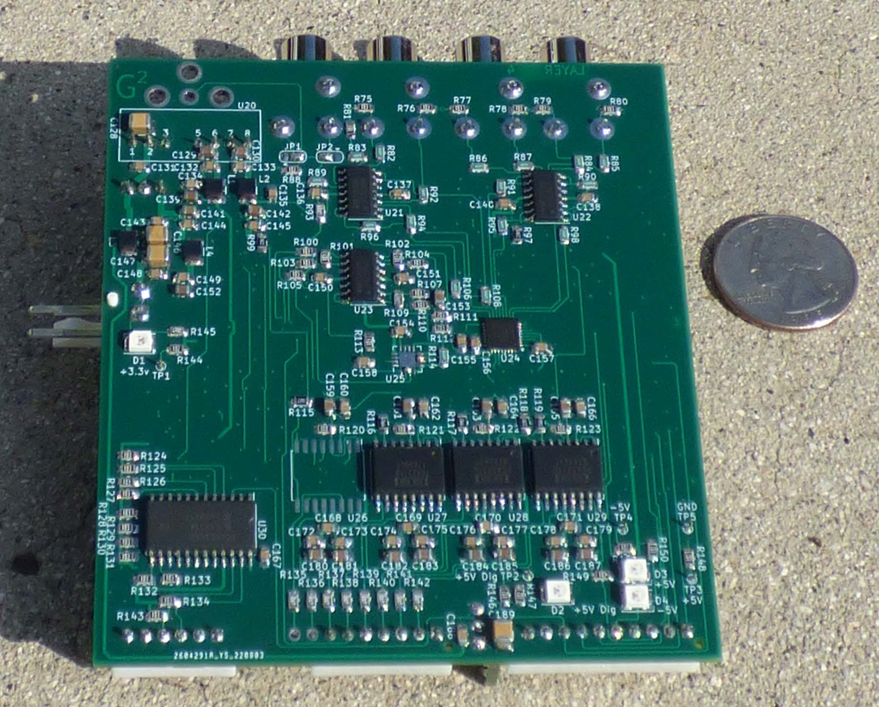

I only do 4 layers. That ground plane gets rid of lot of loop problems. The other
inner layer is for power and control lines that are known to be no chance of
errors. The outer layers are for parts, lately both sides to the point I have to
be careful with heat. 3.3V wastes least power as SMPS, basically those 3 term
replacements. Latest board would be 5-6 Watts with linears but less than 2 Watts
with switchers. 6 Watts in 100 cubic inches is a problem. 2 Watts is OK.

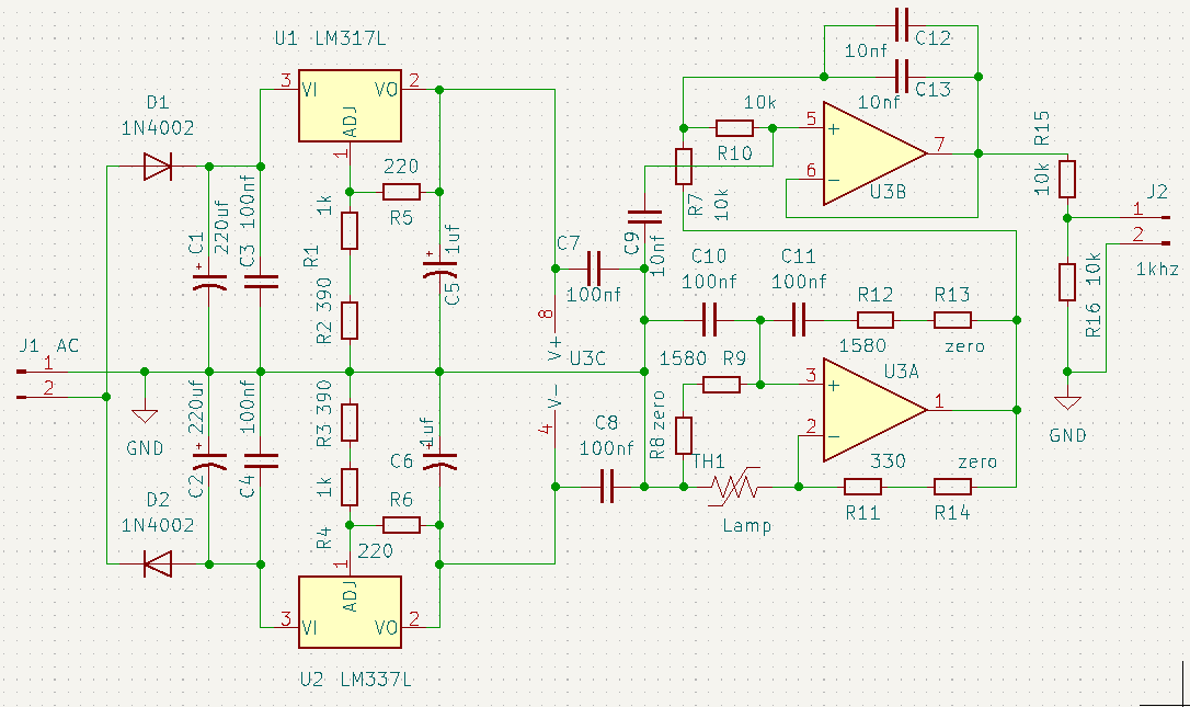

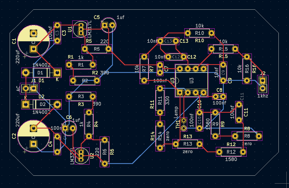

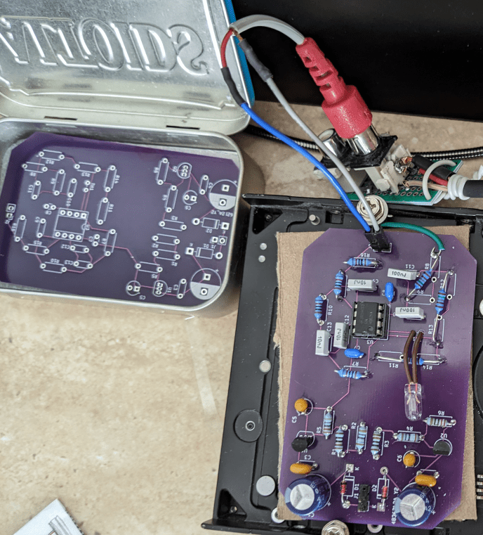

I recently started using KiCad 6.0 after having used Eagle. Here is a simple example that fits in an Altoids tin for storage.Hello all
What are the forum recommendations for PCB design software
I sent the Gerber to JLCPCB. Five PCBs arrived a week later.
I usually make the PCB look like the schematic and then spend most of the time trying a couple of satisfactory layouts.

I added some pix of the latest project to get the idea of silk screen
