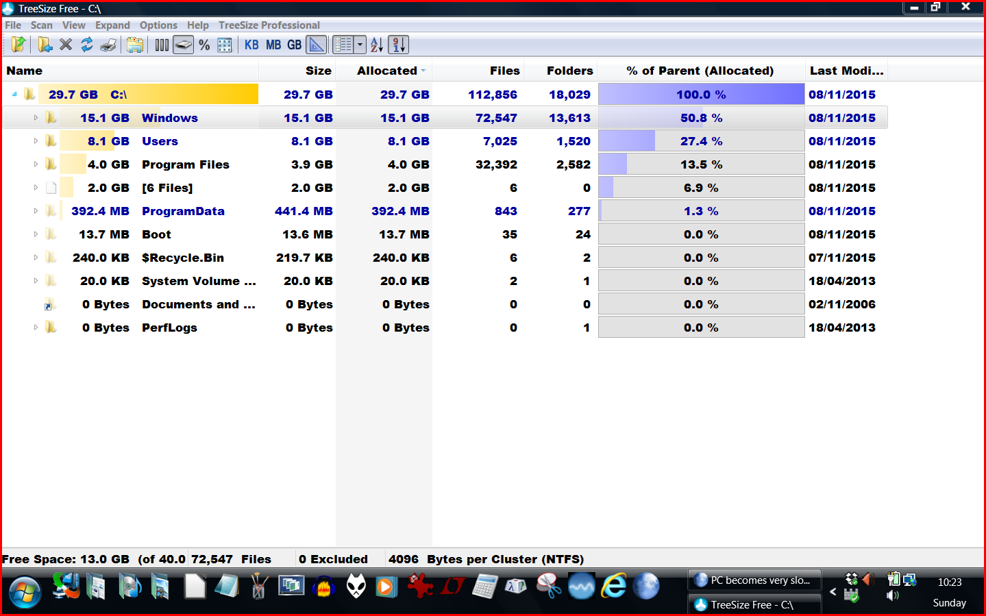

Have you manually clicked your way through the C drive to see if anything odd is there or any obviously large folders ?
You could try 'Treesize'
TreeSize Free - Quickly Scan Directory Sizes and Find Space Hogs
When you run the program, right click the desktop icon and run as admin.
You can expand the results on the left as shown to see the exact problem folder.

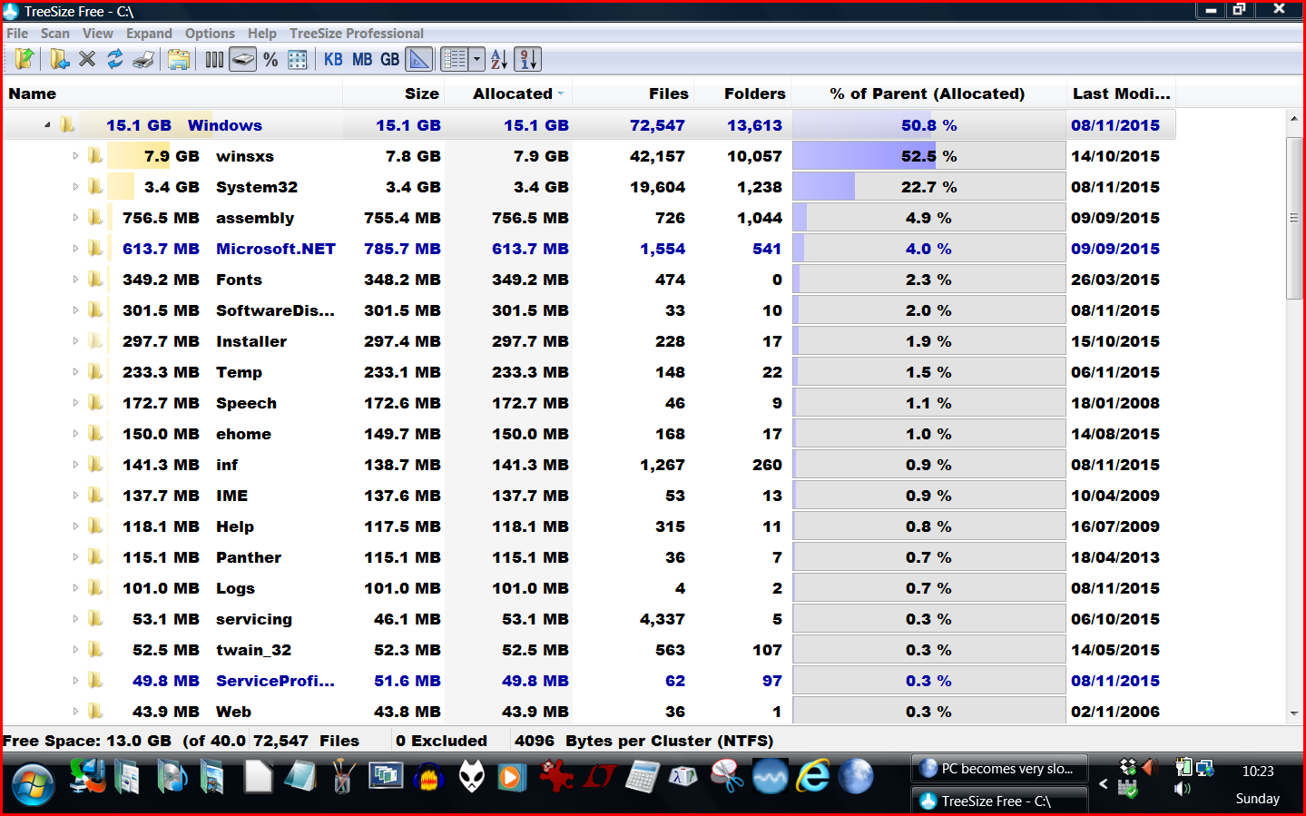

treesize is reporting C:
40.9GB C:\
_ 26.1GB [4files]
__ 14.9GB pagefile.sys
__ 11.2GB hiberfil.sys
__ 376.0KB bootmgr
__ 8.0KB BOOTSECT.BAK
_12.8GB Windows
__ and all the window files
and it also tells me that backup of 6th still exists on E; but they are only 55MB and 50MB

Have you a lot of RAM ?
Hibernate - Change Size of hiberfil.sys File - Windows 7 Help Forums
If you don't use hibernate then you can delete the hibernation file via disk clean (I seem to recall). You can always recreate it again if needed.
The same really applies to the page file. This is an area on the HDD that is used automatically when there isn't enough RAM. I think its set at around 1.5 times the RAM capacity. You can reduce it though.

Treesize says the hiberfil is still same size.
Tried a restart in case it needed that to remove the hiberfil file.
It is still there.
Tried to delete from treesize (as administrator) and it came back can't because it is in use by another program.
How do I delete the now redundant 11GB hiberfil.sys file
