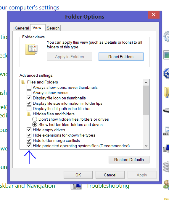

38 Gb is an awful lot, far more than Windows should be. To give you an idea, my W8.1 install (which is pretty similar to W7) is occupying 25Gb, but that is complete, fully updated and with all my software plus around 7 to 8 Gb of personal files added.
Try this.
Go to control panel and select 'Folder Options'. Now UNTICK 'show protected operating system files' and apply the setting.
Now see if you can locate whatever is taking up the room on the C drive.
The two obvious possibilities are 'windows old' but that shouldn't be more than 3 or 4Gb for a non updated XP install. The other is that you have somehow backed up to your C drive with AOMEI (if you have then those backups would not be restorable unless you move them to a separate partition)
Try this.
Windows .old should already be gone when I did the first clean with system included.
And that was when C: became ~12GB. I think it cleaned out ~7GB changing from 19 to 12.
It;s my last Backup that seems to have caused the jump from 13GB to 38GB.
I'll try that tick box in case the backup is hiding.
It would be nice if all I had to do was delete the wrongly filed backup, but the change is twice what the fist backup (1) is
