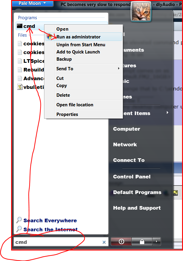

Right Click !That sounds a bit odd.
You type cmd into the search box, then right click and run as admin.
Then paste the command,
powercfg -h off
and press enter.
That works when I know where to right click on and if right click is needed.

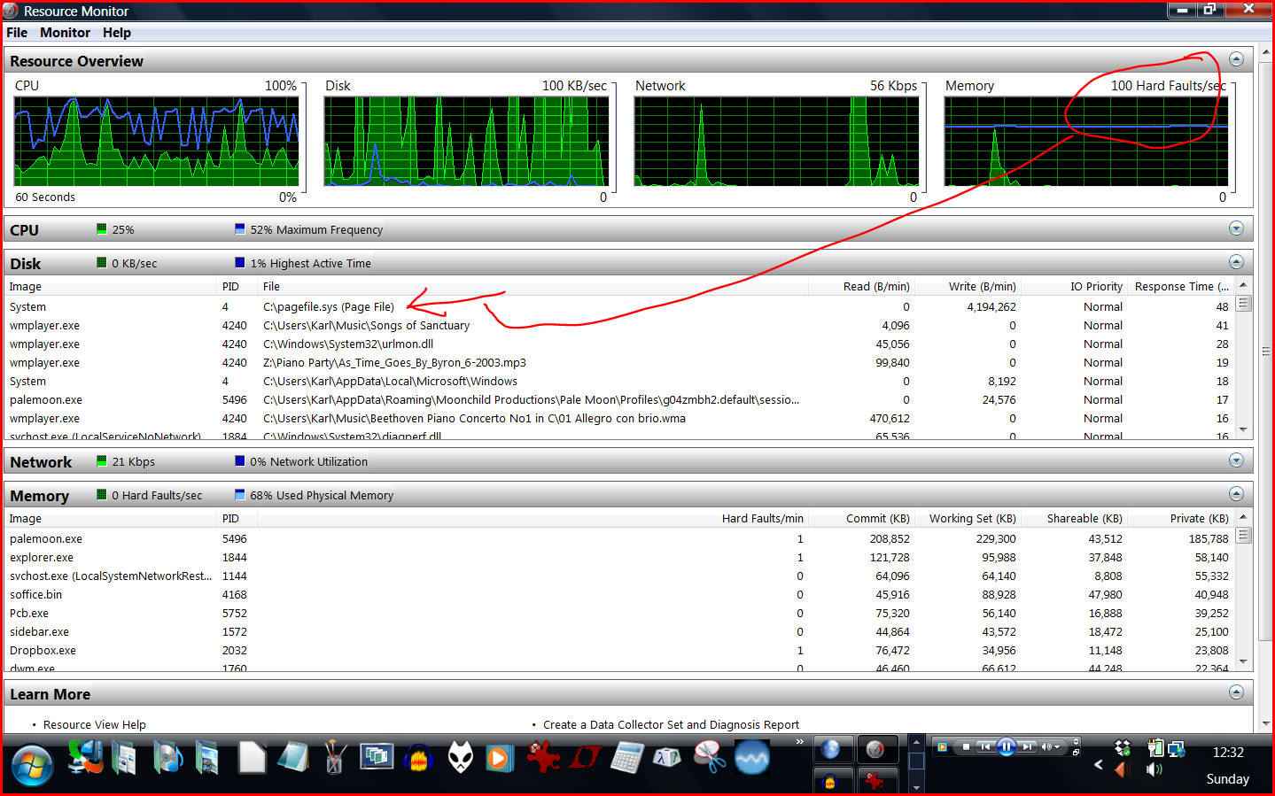

You can check the page file in Resource Monitor. Its being screwed here 😀

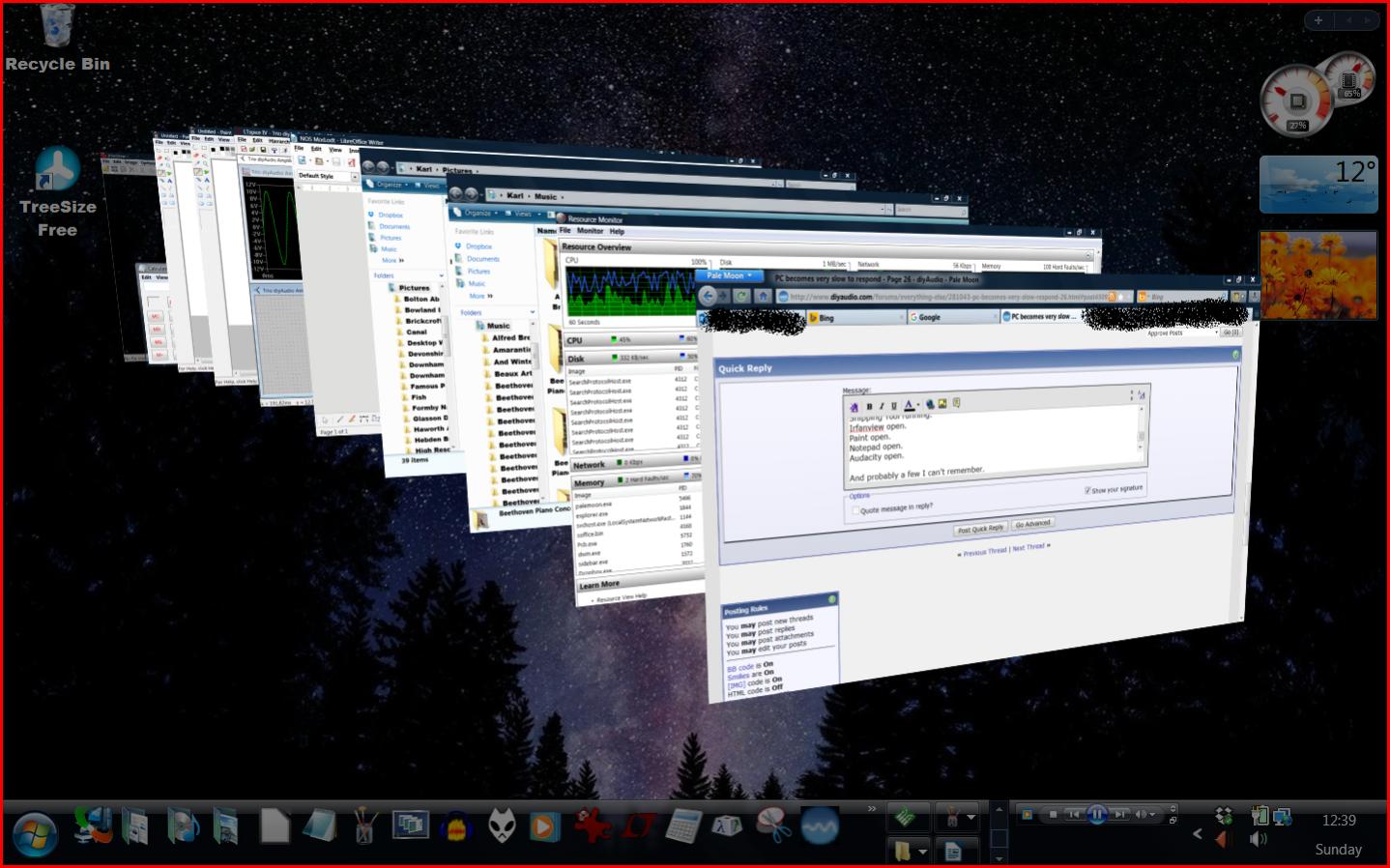

2Gb RAM/Vista.
Browser Open with 6 tabs.
Media player playing.
Libreoffice open.
LTSpice running.
Diptrace running.
Snipping Tool running.
Irfanview open.
Paint open.
Notepad open.
Audacity open.
And probably a few I can't remember.

You are right clicking 'cmd.exe. to run as admin. Post #502

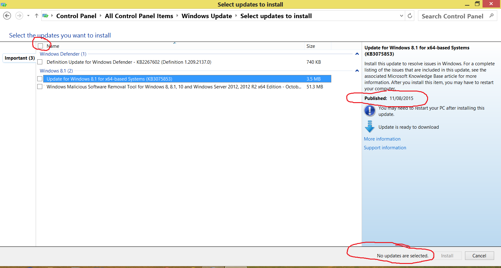

New problem.
I did update and selected SP1 alone.
It installed a file of ~18MB
Did updates again and install new definitions for MSE.
Did updates again and it offered another SP1. Installed that one, a big 89MB file.
Now updates does not work. It told me that I need to update the windows update program.
So I clicked on Ok.
Now it just keeps searching for updates, been almost an hour, so I shut it off.

That sounds very like a problem I had ages ago with Vista where SP1 was offered, and although it seemed to install, it was just a 1Mb file and 'installed' in under a second.
What I did was get SP1 directly from MS as a download and then ran the installer separately (just click the saved file).

Update is working again.
It took about 40minutes to find the 161 important updates and 67 optional updates. 750MB
But the vast majority are after 2013. Only 4 of that 161 list are before jan 2013
They are roughly in 3 main groups:
Security update for .NET framework
security updates for Win7
updates for Win7
Do I avoid all updates after 2012?
updates for Win7
That sounds good.
If you bring the update screen up with all the updates and use the cursor arrow keys to whizz up and down the list then you will see dates at the right.
Untick them all first, then click on the top one to highlight in blue, check the date and move down to the next. Find the earliest month and year (it doesn't matter if you miss an odd one or get them out of sequence, just include it in the next set) and then tick the first (say) 3 months worth of updates and install just those.
Always always confirm that you have deselected all but the ones you want before clicking install. After it asks you to reboot, then look at the optionals in the same way picking the same monthly blocks. Again MAKE SURE you have the importants deselected again because they will keep defaulting back to install given the first opportunity.
