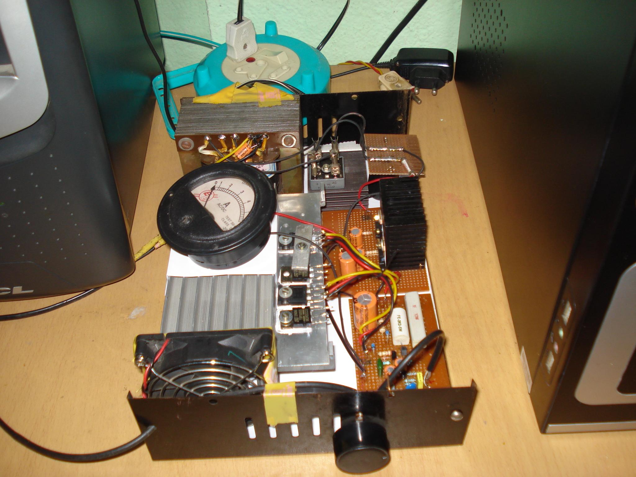

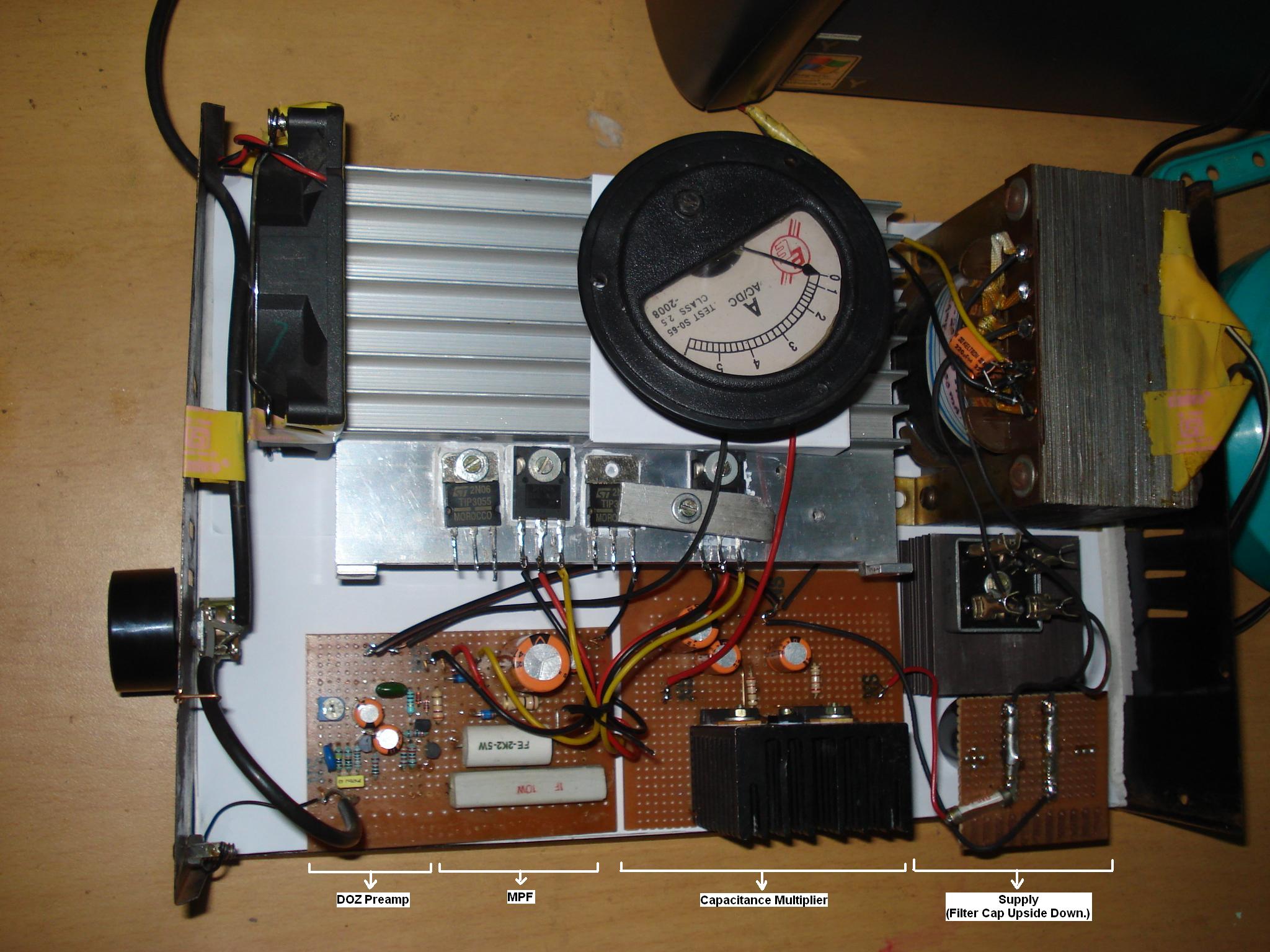

Photo of my build. Finally a Pure MOSFET Follower. LOL
Hello Everyone!
So, here it is. New MPF with FET Current Source(Sink). Actually the old MPF with ONLY the darlington replaced by a MOSFET. The gate stopper is default 270 ohms as was in the original with No oscillation for 8 days! 😀 😎
The TIP3055 BJTs seen were used in the DOZ power amp I made and dismissed. 😉
My cam is film based so had to borrow a digital one from my friend. Sorry for the delay.
Hello Everyone!
The connections are made exactly as the picture shown in the very first post of this thread. I wonder what made it oscillate so bad then. I think there was some wiring mistake.

Hi Bigun!
This is the case with most(if not all) Class-A designs, that's why there is a Capacitance multiplier here. Connected in series with the supply this only dissipates about a couple of watts. But, all PSRR problems are solved with a $5 circuit. Better than a 33000uF cap. Yes. Truly cheap, truly wonderful. Give it a try if you haven't already.
Link-> Capacitance Multiplier Power Supply Filter
