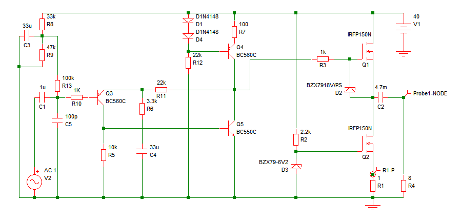

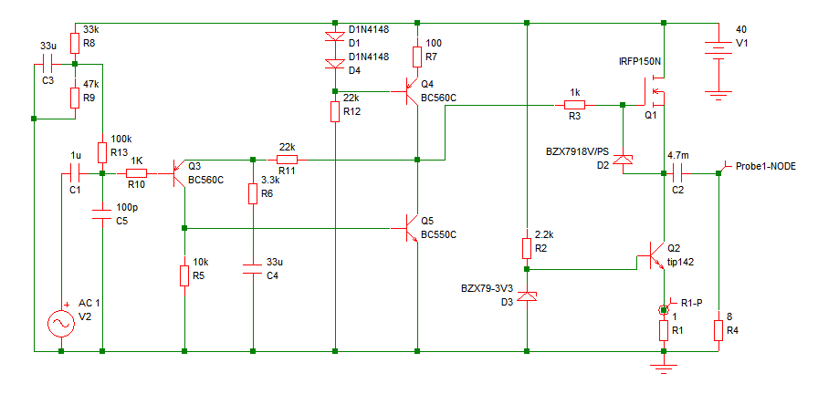

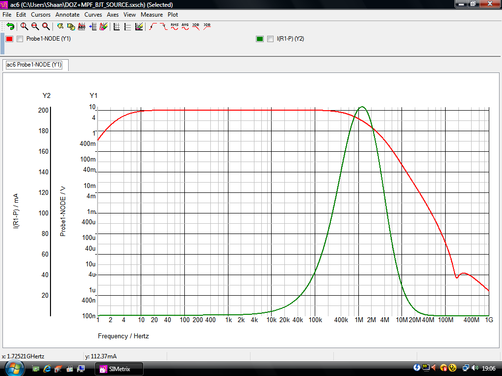

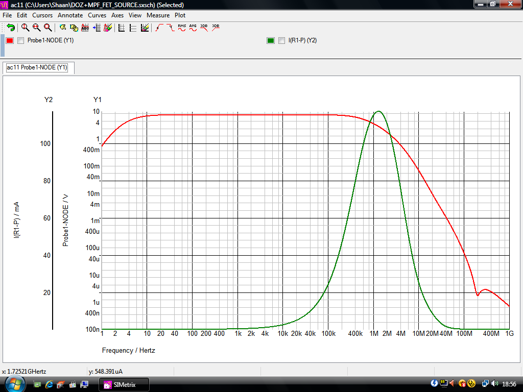

Today I connected the MPF again and was thinking about the MOSFET CCS for the last time. At the same time I ran some AC analysis of both BJT CCS and MOSFET CCS at the positive of the 1ohm CCS load. The results of both simulations are shown below.
The main change in these schematics is a 1K gate stopper for the gain MOSFET instead of the default 270ohm. The analysis showed a lower magnitude AC at the +ve of the resistor in the case of the MOSFET CCS MPF. I tried it out of curiosity. It is working and is stable and after about 3 hours of music still no oscillation; all FM channels are alive and noise free 😀 and the turn on click is gone too.
I don't know exactly why it is working without oscillation but I think it's the 1K resistor at the gate of the upper fet. As shown in the schematic the CCS fet has no gate stopper.

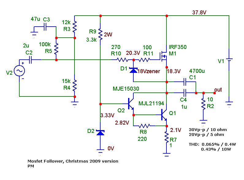

once again please have a look where the R11 is placed - this is the correct position for the gate stopper. You still have not implemented it well.
I think what you are saying is right. But, with my limited knowledge of audio engineering I cannot do more than what I have done.
I used to place a 270ohm resistor between the preamp output and the upper MOSFET's gate and everything seemed to be ok. This was the suggested config in the ESP pages. I did what was said there and the result was great indeed. In the case of the MOSFET CCS I saw in the simulator that the AC in the CCS load resistor is decreased if I increase the value of that 270ohm resistor to 1000ohm. There I tried it in real world and here it looks like it is working. At the same time, the simulator also shows decreased AC in the CCS load in the MPF with darlington CS; much less than that with the default config suggested in the ESP pages. This made me a bit curious and I could not help it. But as it is stable and not oscillating(the fm receiver is ok with this config), I thought it would be a nice idea to tell other people about it so that they might test it out for themselves and tell their own stories and I can be sure that I am not day-dreaming. 😀

Yes it was, in the year 2001. Please believe me, the correct position of the gate stopper (R11) is between the zener cathode and gate of the MOSFET. The additional R10 only helps.
I believe you. I will try the circuit with an additional 100ohm resistor in the way shown in your picture of the circuit. 🙂

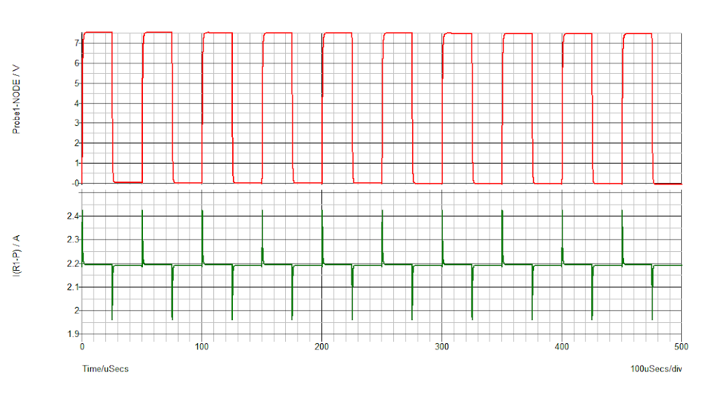

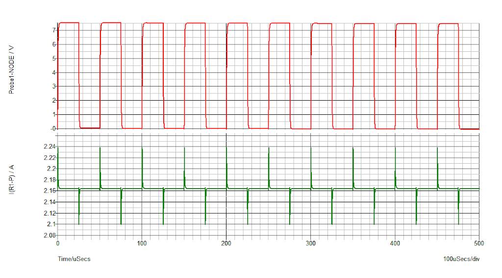

I ran 20 KHz squarewave tests to both circuits and here are the results.
With 20 KHz squarewave the current fluctuation in the load resistor of the BJT CCS is more than 400mA, while in case of the FET CCS it is about 140mA. This looks like an advantage of the FET CCS over the Darlington CCS. Besides, the MOSFET CCS sounds just as good as the old one, equally in bass, mid and treable.
With TIP142 CCS
With IRFP150N CCS
With IRFP150N CCS
