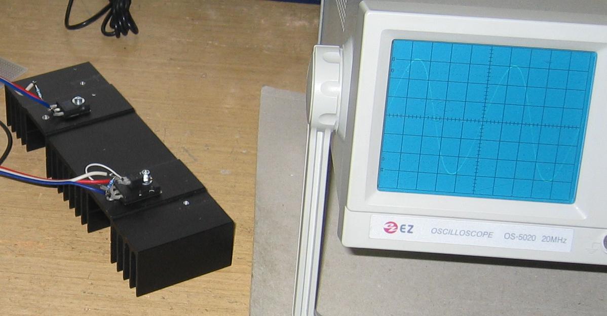

just screwing TO3-P packages onto heatsink 😉

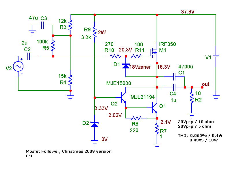

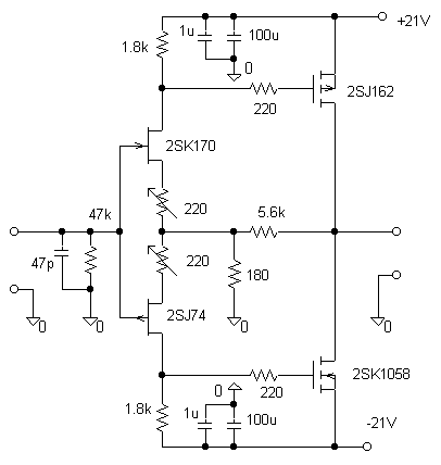

MOSFETs have one principal advantage over BJTs in this sort of application - no secondary breakdown, i.e. as Hugh said, better thermal robustness.
They, however have a lot of issues that can be solved, but you should not take the MOSFET for granted:
1) Predictability of current versus the gate reference is worse, because treshold voltages vary much more than the proverbial Vbe of bipolars. From this standpoint, the current source shown by Lumba Ogir is more precise. However, it's a two-device feedback system, so 180deg phase shift = oscillation, is possible even if the devices were perfectly first order (and they are not). The cure is putting a capacitor across C-E of the control BJT, but see below.
2) Cgd is a real issue. Because it's non-linear, it changes the transient behaviour of the CCS with amplitude. When Vds becomes low, about 5-10V depending on the type of MOSFET, it rises quite abruptly. This means that the spikes shown by PMA become higher for output signal amplitudes closer to the maximum, and indeed very high at clipping. Again, a lower gate stopper and capacitor mentioned above can reduce this.
Because of this it's actually quite difficult to make a good MOSFET CCS for HF - lots of residual capacitance. Fortunately, since it's driven from a follower, it's not a great issue, but it is there.
3) Wiring and layout are critical, as well as some part selections - for instance, consider wire or resistor inductances in the gate line - charging and discharging Cgd will be greatly slowed down (spikes!) if these are excessive. Now, consider an inductive resistor in the source - if you have considered carefully, you may notice that it may not be the best policy to use perfect noninductive resistors everywhere!
4) MOSFETs can work down to Vds near zero volts. At first looks, this is very nice, but be advised that the reverse capacitance issue actually may result in the output of the follower 'sticking' to the ground rail when it clips, in feedback CCS types like Lumba showed. The feedback will try to increase Vgs in order to attempt a constant current with 'no voltage left' across the MOSFET and it's current sense resistor. This will charge the input capacitance (now grown due to low Vds) to a much higher voltage than at normal conditions. Once the input of the follower starts rising, it will take a lot of time to discharge Cgs||Cgd through the gate stopper, resulting in a transient in current. There is no simple and complete cure but keeping things simple, there are two strategies to reduce the problem:
a) Chose a MOSFET with lower Gm and appropriate current, voltage and power dissipation capability in order to minimize Cgs and Cgd. For instance, DO NOT use a random part from the bin, say a 40A part for a 2A current sink - when a 10A part will suffice, because the 10A part will likely have 1/4 of Cgs and Cgd (remember, this is a CCS so it's maximum current is 'constant' - no need for much headroom). Because transconductance is lower, it will require a little more Vgs to get the desired current, lowering somewhat the output voltage swing before the nonlinearity of Cgd becomes a serious issue - but this is likely to only be a volt or two for a 4-fold reduction in capacitances.
b) Use a clamp to prevent the gate voltage from getting out of hand. Simplest is a zener to ground, a bit more complex a diode string to the output (drain) of the sink. The current spike will remain as you must have some overhead for maximum gate voltage to account for MOSFET, temperature and clamp tolerance variations, but it can be signifficantly reduced.
A final word should be said about simulations of such circuits. When simulating with square waves at the input, the generator should be set up with realistic rise and fall times. By default, these are very steep, far steeper than real life - and if such were present in real life, cable effects would be a problem before spikes in the current source would. Also, be mindful of MOSFET models - these tend to be notoriously bad, amongst other things, capacitance nonlinearity is poorely modeled, and in some cases, not at all.

Looks like MJE+MJL in the CCS. Nice. Waiting for the schematic.
Did you try any MOSFET in the CCS?

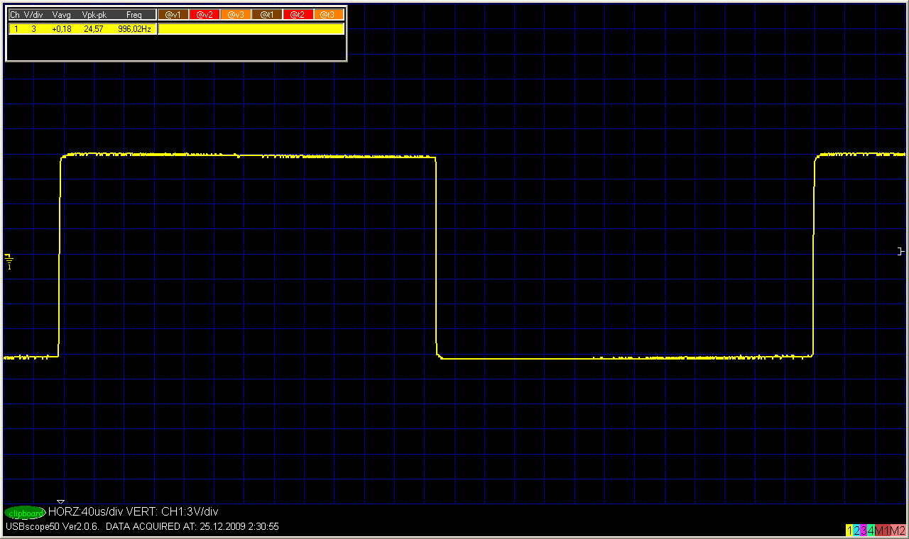

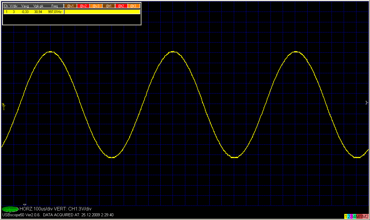

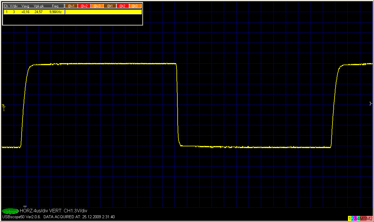

And several measurements of sine and squares, into 10R load.

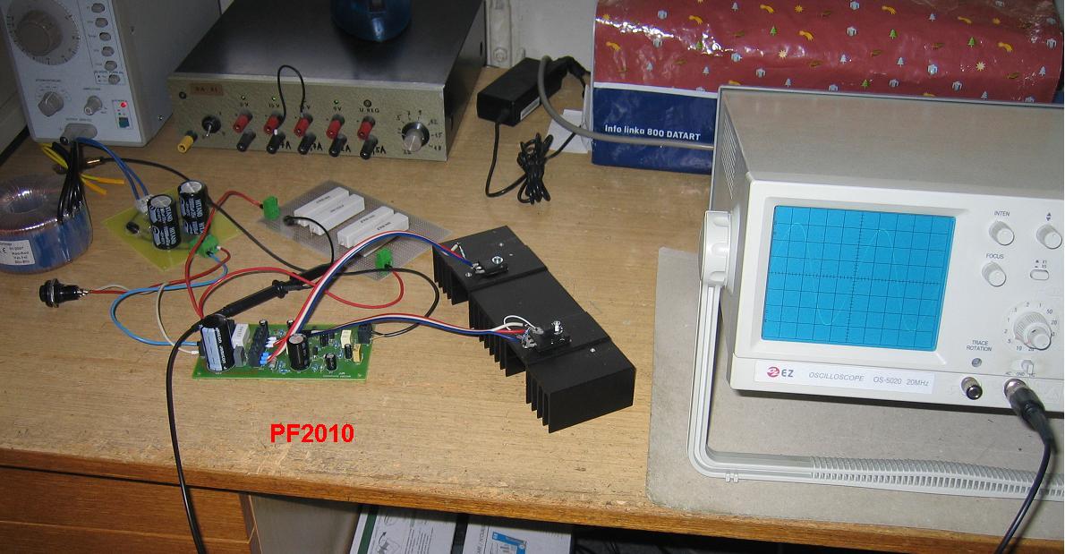

Hi Shaan, Pavel, guys.
As usual, I lost this interesting thread: I have bought all the necessary to build the power follower. I only lack time...
I was about to suggest that maybe the perceived difference in sound between Mosfet and Darlington was due, at least in part, to the monolytic Darlington and that we should consider a homemade one with "audio" bipolars. 😀 PMA is faster than me...

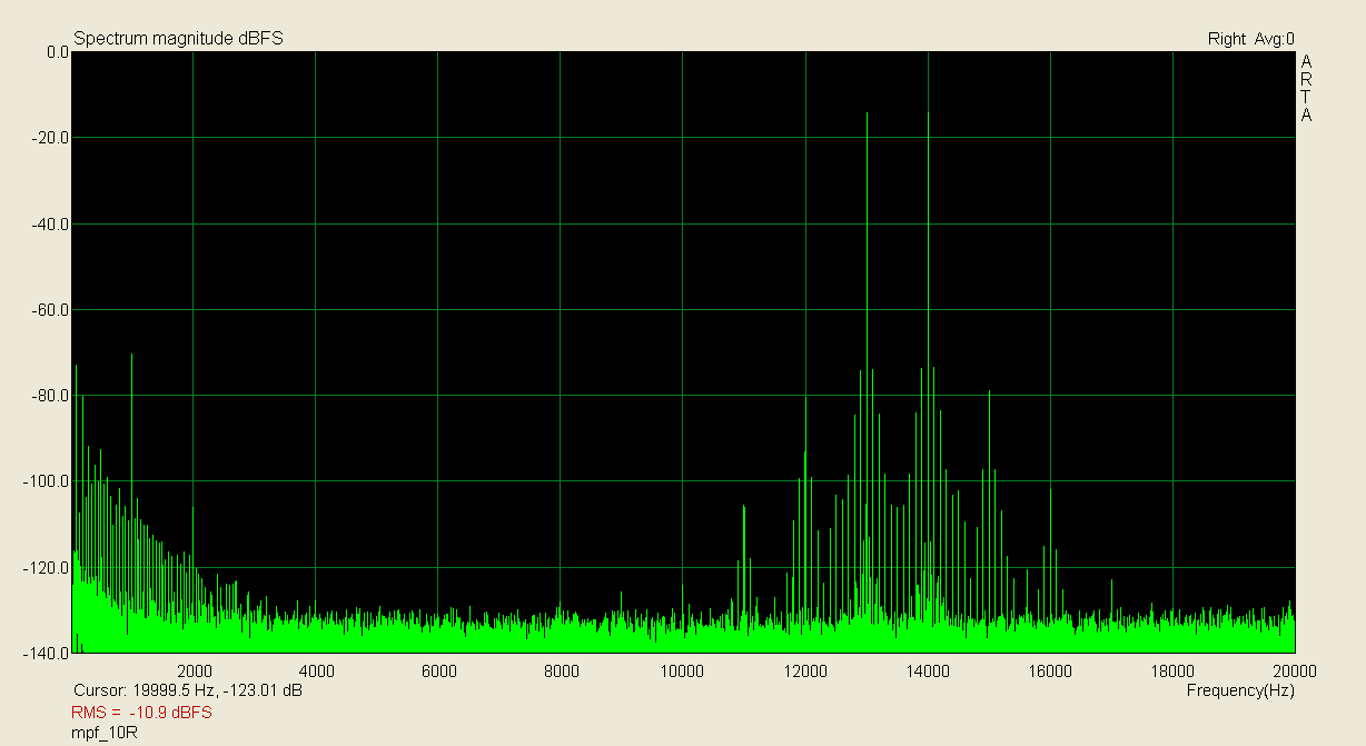

Now, it is a high time to mention that this kind of circuit needs very clean power supply. Let's explore the record of CCIF 13+14kHz distortion. We can see that it is not that bad for such a very simple circuit. Only low order harmonics to be seen - 2nd, 3rd, 4rd and 5th. Quite clean bottom background. BUT - a lot of intermodulation with 50Hz components. This is for the reason that the power supply used has only 5000uF filter cap. So, you would need 10-times more capacitance, or regulated PSU. As the current consumption does not change much, the regulated PSU, rated at some 5A, is the right choice.
Edit: I have not read your post as I was writing mine. You are of course right, maxlorenz, regarding power supply.
