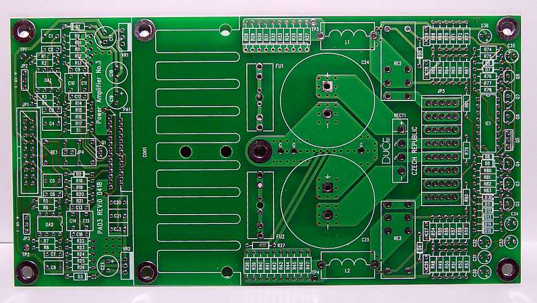

Each modul, connected in parrallel, give 120 W/ 2 ohm. If you need ( theoretically ) 240 W/4 Ohm, you must to use two modules, which each will be connected in parallel, but one with " inphase ", second with " reversed phase " and load connect between both outputs. So for subwoofer you need two modules, for stereo operation four modules. I don't make kits, because in this amp are used commonly available devices, which you can to buy in every stores.

To PMA : Typical peak current of each channel ( guaranted by manufacturer ) is 11,5 A , so in parallel mode it is 23 A. I mean, that for 240 W/ 4 Ohm it is enough 😉. To darkmoebius : Better is to drive it from preamp ( with crossover on the way, certainly ) than from PA - you get lower distortion and better SNR. And any expenive components ? Good results make mainly good circuit design and sophisticated PCB, not " for Titan's developed " devices, what is often declared on amateur pages and kit's magazines. 😉
Pavel,
we both are circuit designers, and as friends and colleagues I assume we should speak in a serious manner. The value 11.5Amps is output current limit for tON=10ms, typical. The guaranteed value is 7A (just look at the datasheet column at right side). 240W/4 Ohm means 7.74 Arms and 10.94Apeak, for purely resistive load. This will be increased for the complex load as speaker is. And the peak value you speak about is meant for output limitation in 10ms, not the continuous output current value.
There is another diagram in the datasheet, page 13. It shows 160W/4 Ohm in the parallel mode for 1% THD+N. Also, page 14 shows the safe operating area of the chipamp.
Frankly speaking, I would not recommend this 240W/4 Ohm, regarding the thermal load and safe area of the chip.
Pavel
To PMA : Sure, you have certainly thruth, this circuit isn't " heavy duty tank " 😉 , 240 W of output power is rather theoretical value. For long time reliability is better in this case to use this circuit up to cca 200 W ( in parrallel / bridge configuration ), maybe little bit less ( I haven't long time experience ). 😎

This is photo of PCB. Do you like it ?
