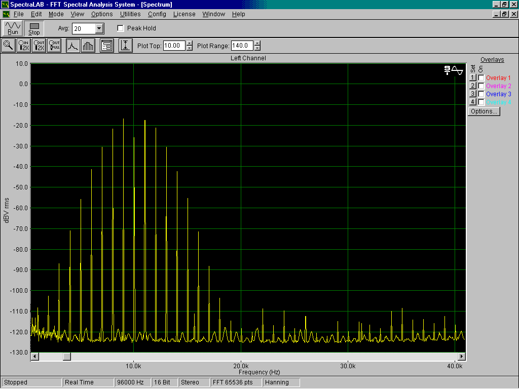

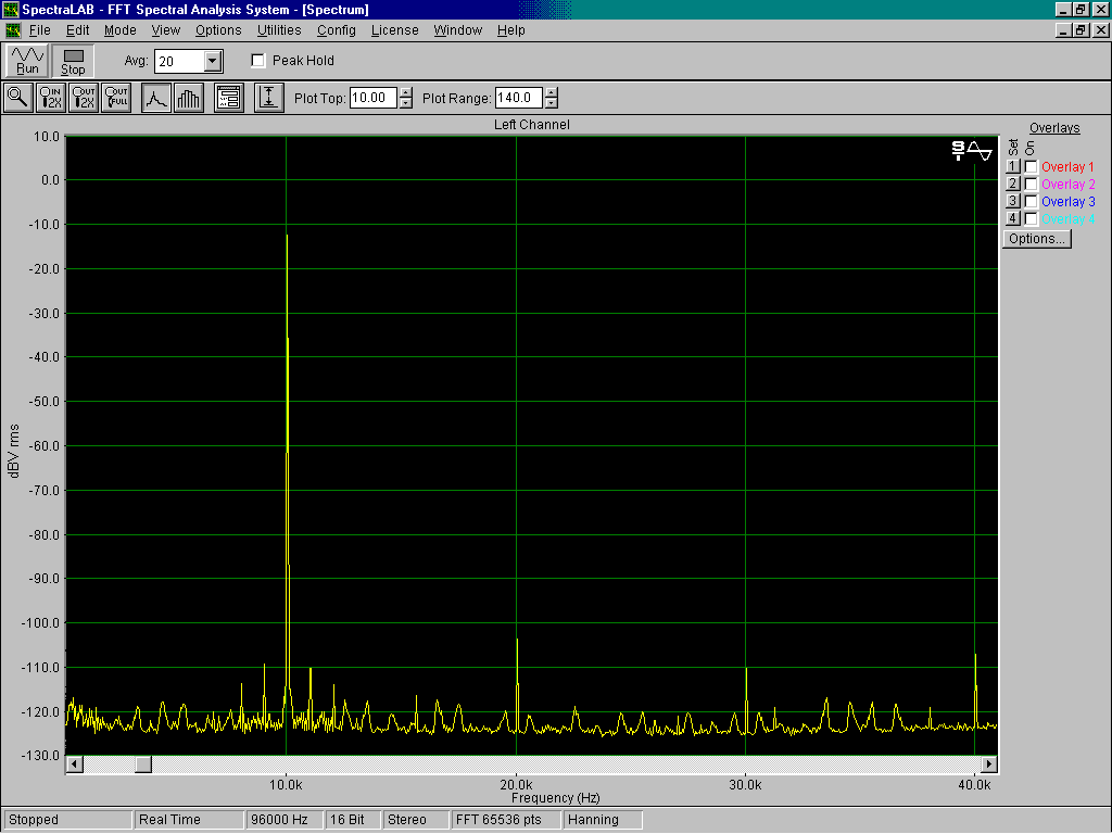

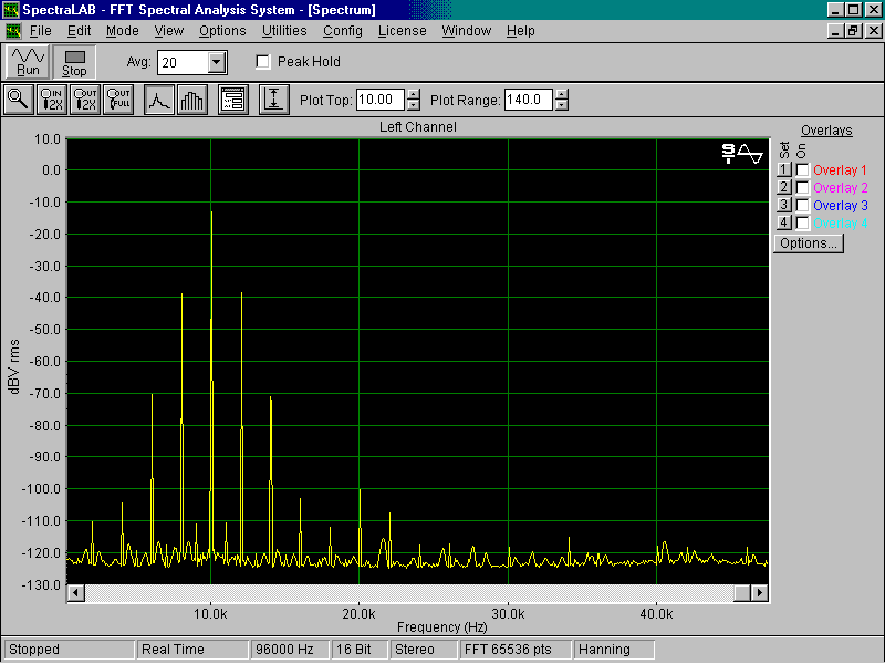

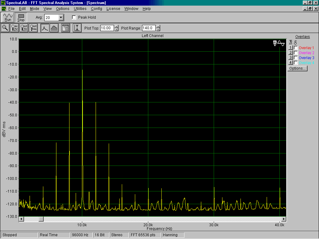

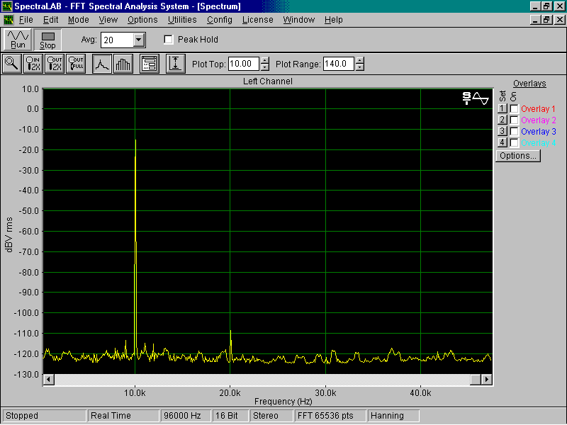

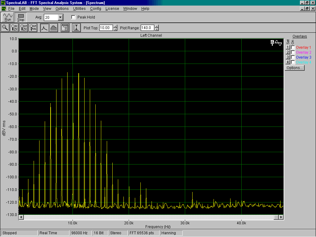

Thanks to PMA you can see measuring results of distortion LM 4780 in PA 03 module, measured by his multitone method. You can compare distortion of generator with distortion of complete amp. All is measured by output power 5 W / 8 Ohm and results are surprisely good. At first distortion of generator by 10 kHz :
peranders said:
....-100 dB approx for the 3rd tone......
100dB with 16bit measuring resolution?:scratch:
from Spectraplus help:
"An important factor in determining the quality of the sampled sound is the number of bits per sample. This specifies the number of discrete levels that are used in the analog to digital (A/D) conversion process and directly affects the dynamic range of the measurement. The theoretical dynamic range is shown below:
8 bit sampling precision = 48 dB
16 bit sampling precision = 96 dB
In practice, the achievable dynamic range is less that the theoretical maximum due to internal noise and other factors. Refer to your sound card documentation for the actual performance figures."
