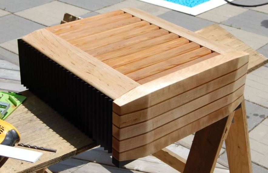

Now that the front is finished, I can work on the top. My original idea was to use 1/2" aluminum tubes (which I have a pile of) to do the top but I have reconsidered. Sticking with the wood theme, I just made these:
The idea is to make slats to go across these to fill in the middle. Space the slats 1/4" for ventilation (and to peek inside).
I have also decided to paint the heatsinks flat black, so I'll do that when I dismantle it before I install the front.

I painted the heatsinks black and I think it looks better. I attached the front and finished building the top.
I didn't have enough black walnut to do the slats for the top, so I used a particularly dark piece of cedar I had, thinking the it would be close enough to the colour - wrong! I don't like it so I've decided to paint the slats black, just the slats, not the maple side pieces.
Getting to the end of this project. a long time (for me) in the works.
It was a good choice IMO, the black looks good. I have most of it done:
Front is attached, feet are on front and back and the top is finished (just one more coat of clear urethane on the maple left to do). Ready to put back in service.
