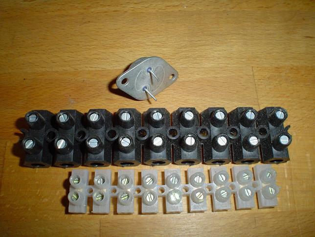

It seems that these connection blocks are so hard to find?
Here in Belgium (and Europe I suppose) they are to available inevery DIY store. Cheap and in various sizes.
Strange you do not find them way back there.
Maybe the jury whas right, then back in the time...
I have to build a Home Entertainment Center wih seperate amps.
This looks like a nice model to start with.
Cheers, Tarzan
Over here those terminal strips are common electrical items, often used for joining together flex and such like. You also find it in some types of light fitting. It's also used a lot for in-car work.
It's really handy to an electronics DIYer, i'd be lost without it!
Pingrs said:
terminal blocks
The bigger ones are nice.
I prefer the dual in-line screw types (4 screws in a row), can't ficking find a piccy on the hard discs just right now.
