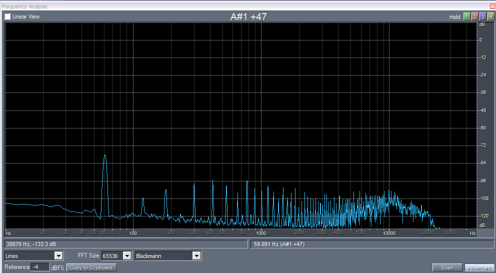

AndrewT said:
your sound card shows a significant 3rd harmonic at 180Hz and another at the 9th.
Why does your amp show hum and buzz all the way through the spectrum?
Is this a test set up artifact or is it coming out of the amplifier?
Hi Andrew,
The soundcard noise is shown below. This is the soundcard itself. Everything is lower than -100db.
The hum or buzz you refer to may be some interference - the DCX2496 is still connected to the remaining channels of the amp and powered, the connection cable is a 2 metre piece of unshielded telephone cable. The amps are very quiet, so no discernible hum or buzz.
I could do everything all neat and scientific, but the picture is clear enough - the amps are performing as predicted.
Compare it to the recent tests of my finished K10A - the magnitude of the hum and buzz is much stronger in that one, yet it is very silent. These peaks are way down.
